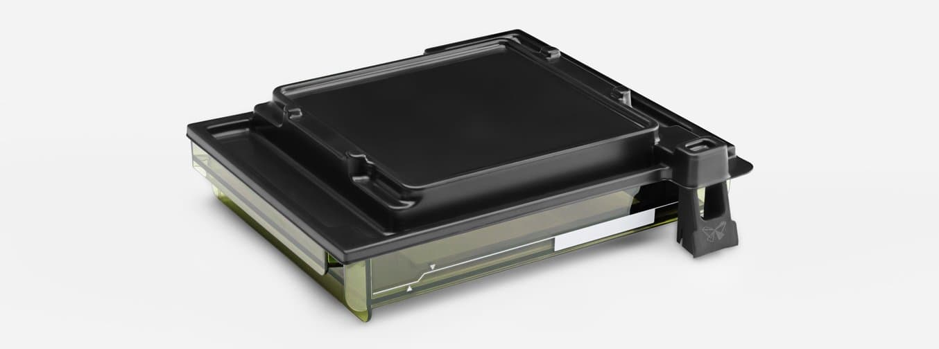

Storing Resin Tanks
Unopened resin tanks can be kept in the box. Once a tank has been used to hold resin, it must be protected from ambient light. Keep the black tank cover to protect resin and stack multiple tanks. The orange acrylic will also block light for tanks stored outside of the Form 1+. It is best practice to keep all resin tanks out of direct sunlight.
When storing a resin tank in the printer, and if the printer is not in use, the lid will help conserve and protect liquid resin. Use the scraper to fully mix the resin before printing, so that the fluid is chemically consistent throughout and the silicone layer stays optically clear.
Used resin tanks should always be stored with the lid installed, empty of resin or filled to the maximum line. Resin may require aggressive mixing or agitation outside the tank if resin is stored in a tank for more than 3 months.
