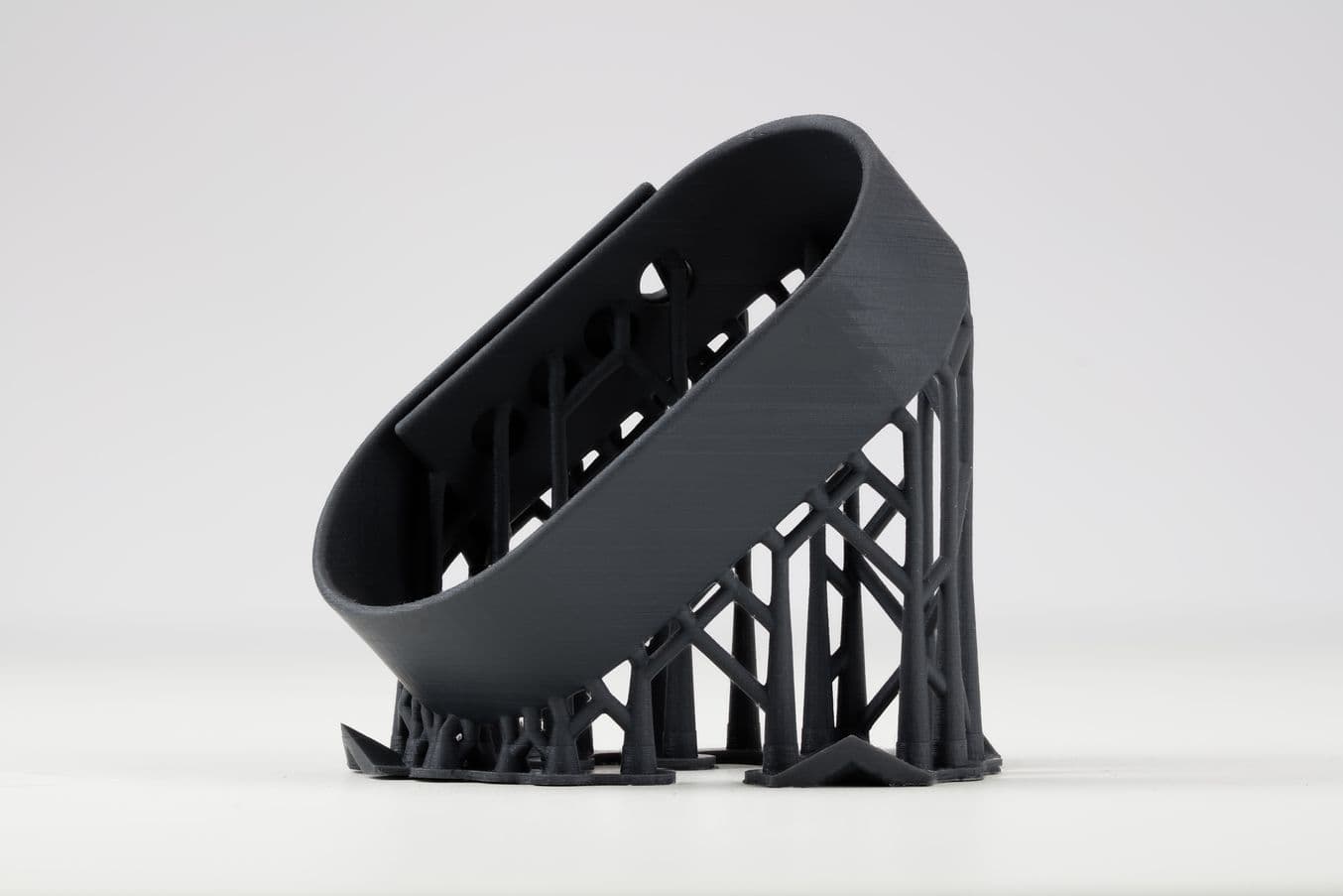

When setting up your part, make sure that your model is in its final shape. For example, if you are printing a watchband, it should print it in its circular form, not as a straight line.
A Flexible watch band printed in its final shape.

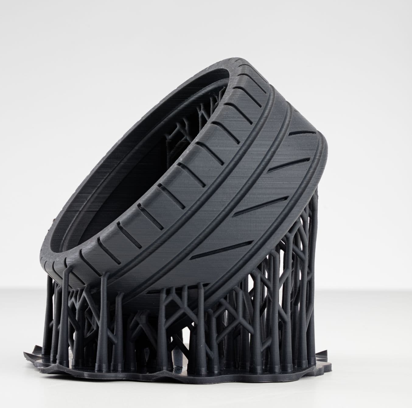

Tall, thin features are harder to print because the material will naturally flex during the peel process. If possible, orient your part closer to the build platform but no flatter than 20 degrees. You can also reduce this effect by manually adding additional supports.
Model of a tire in PreForm demonstrating appropriate orientation
Optimal orientation for a Flexible model.

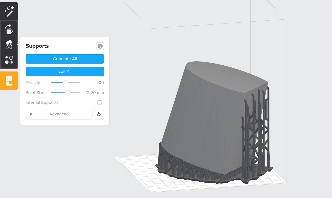

Use "Advanced Support Settings" to adjust supports for printing in Flexible Resin V2. Issues may occur during peeling if you move from a layer of large surface area to a layer of small surface area or vice versa for example, if printing thin features like embossed letters or extrusions on a large, flat surface. Try to match the touch point size, and choose an orientation that will minimize this.
The base thickness for printing Flexible pieces should be at least 1.25 mm. The default touch point is 1.60 mm, but 2.20 mm is recommended for larger pieces. Increase the support density for Flexible parts with a large cross section.
Model of a heel in PreForm illustrating proper touch point size and density
Touch point size should be at least 2.20 mm for dense, large models such as this heel.
