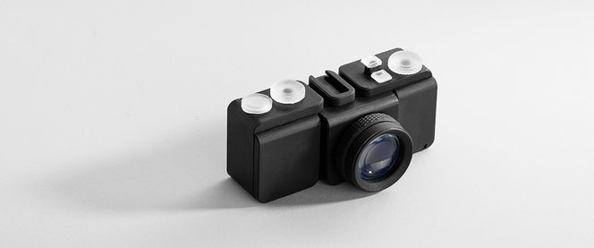

The idea for a fully 3D printed camera—a machine with many complex components—has been floating around Formlabs since the 3D printed lens blog post. Our applications engineer Amos Dudley took on the challenge and created the first fully 3D printed, interchangeable lens camera, produced entirely on the Form 2.
A 3D printed camera
The first fully 3D printed, interchangeable lens camera was produced entirely on the Form 2.
