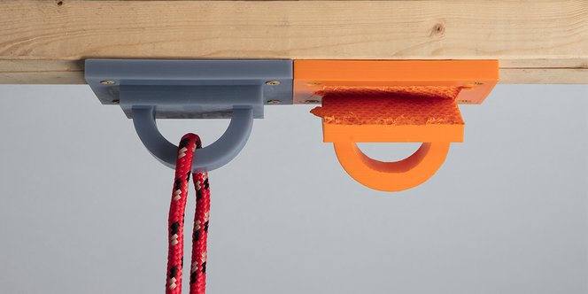

A broken hook, printed in FDM
FDM prints are anisotropic–when weight is applied, FDM prints can fail if they aren't oriented correctly or modeled in a way to account for anisotropy.
In short, FDM parts are not equally strong in all directions, and cannot be isotropic, meaning that orientation matters when designing and printing load-bearing parts.
