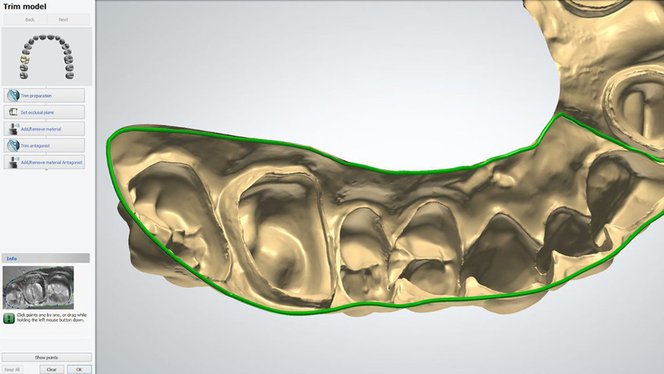

2.2 Trim scans - both preparation and antagonist
Use line marking or area selection tools to remove erroneous scan data and select only the portion of the dentition that will be printed.

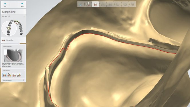

2.3 Section the scan and mark margin lines
Select each tooth that will be converted to a die. Carefully edit the margin line for accurate marking. Check the insertion direction for each die.

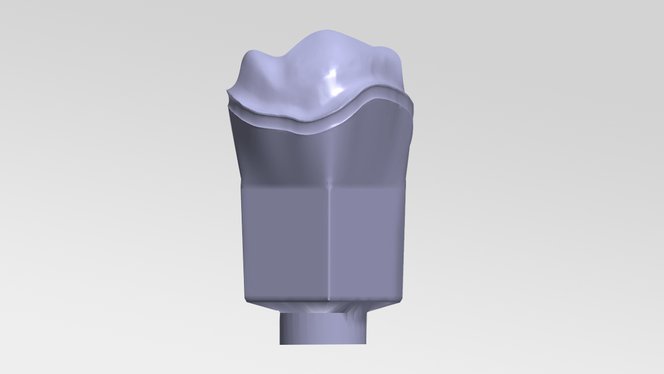

2.4 Generate dies
Generates dies automatically, based on user-input die and model settings.

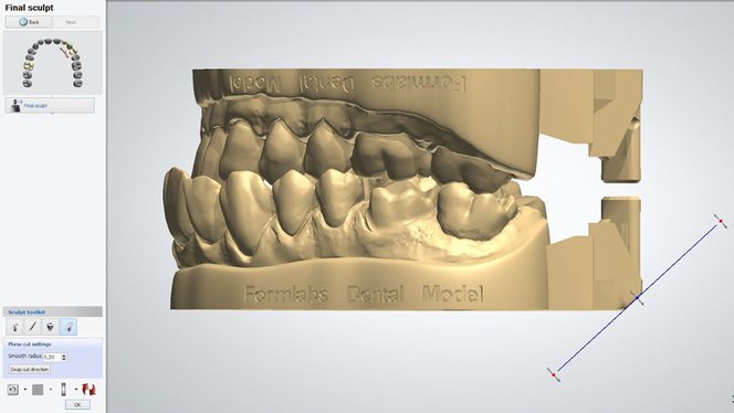

2.5 Model generation and final sculpting
Automatically generate the model, with either hollow or solid model settings. Final sculpting is optional: to make support removal easier, use a plane-cut tool to cut a chamfer in one end of the model.

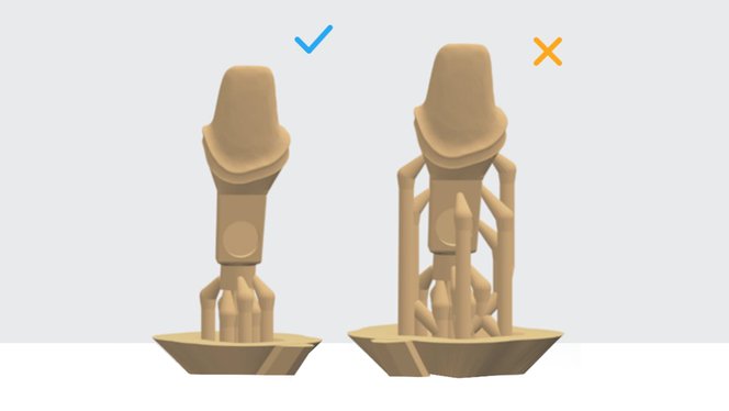

Print parts directly on the build platform to decrease print time and save resin. Both hollow and solid models can be printed directly on the built platform. To snap the flat bases to the build platform, use the “Select Base” feature under the Orientation menu.
Printing on supports is also possible, and is recommended in cases where dies have small pin diameters (less than 3 mm).
If printing with supports, ensure that:
1. Supports only touch the base pins on the dies
2. Supports do not touch the inside of the die sockets on the arches

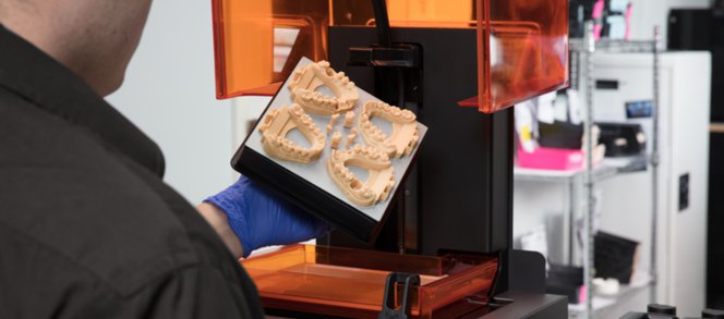

4.1 Remove parts from the build platform
If a chamfer feature was added to the models, remove models with part removal tool. In cases without chamfers, use flush cutters for easier removal of the parts. Wedge the flush cutters into a corner of the model, gently squeezing and rotating the handle to pry up the print until it pops up. To remove dies, slide the included metal spatula across the build platform.

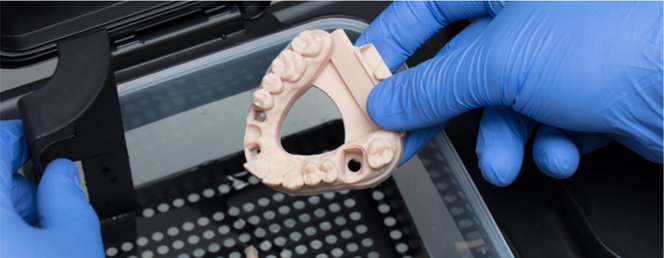

4.2 Wash the printed parts
Rinse parts in isopropyl alcohol (IPA, 90% or higher; 99% recommended) until uncured resin is fully cleaned from the parts. For best results, use two Form Wash units, with one initial wash for 10 minutes, and a subsequent 5 minute wash in cleaner IPA. Alternately, use one Form Wash for 15-20 minutes and quickly rinse parts in clean IPA for 2 minutes afterwards. When using the manual Form 2 Finish Fit, rinse parts consecutively in two buckets of IPA for 10 minutes each.
Leave parts to air dry completely, or use a compressed air hose to blow IPA off of the parts. Inspect closely to ensure all uncured resin has been removed from the parts.

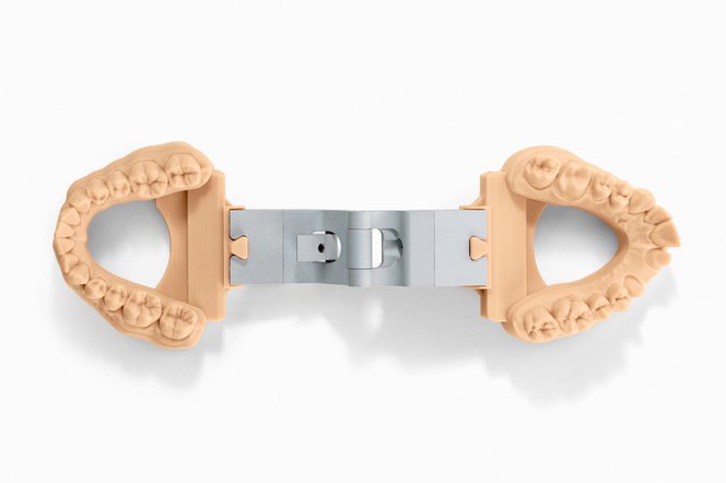

Finally, assemble the dies into the models to complete the case.
