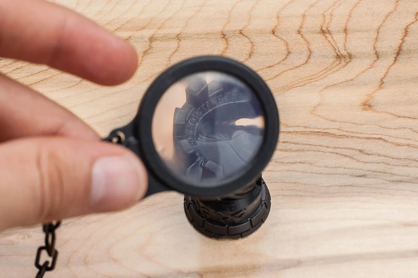

At this point the convex side of the lens was optically clear and I moved on to the flat side. I remove the lens from the drill coupler by clipping the connectors with a wire cutter. I then pressed the lens into the other drill coupler so that I could polish the flat side in the same way that I polished the convex side. Once complete, I popped the lens into the monocle and my project was complete.

Final version of the 3D printed lens
