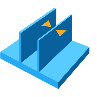

Minimum Supported Thickness
Minimum Supported Wall Thickness
Recommended: 0.4 mm
A supported wall is one that is connected to other walls on two or more sides. A supported wall smaller than 0.4 mm may warp during the peel process.

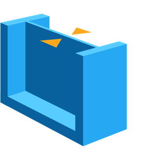

Minimum Unsupported Thickness
Minimum Unsupported Wall Thickness
Recommended: 0.6 mm
An unsupported wall is one that is connected to other walls on fewer than two sides. An unsupported wall that is smaller than 0.6 mm may warp or detach from the model during printing.

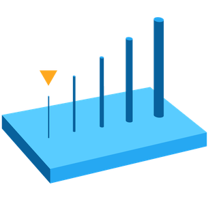

Minimum Vertical Wire Diameter
Minimum Vertical-Wire Diameter
Recommended: 0.3 mm (7 mm tall) to 1.5 mm (30 mm tall)
A wire is a feature whose length is greater than two times its width. The ratio is key to printing wires; at 0.3 mm thickness you can print up to 7 mm tall before you start to see waving. 1.5 mm wires can get up to 30 mm tall without defects.
Note: Washing Small Wires
Similar to washing thin walls, extra care should be taken when washing small wires, as they are weakened by IPA and can easily be damaged. Minimizing the time the part is immersed in IPA will limit this effect.
