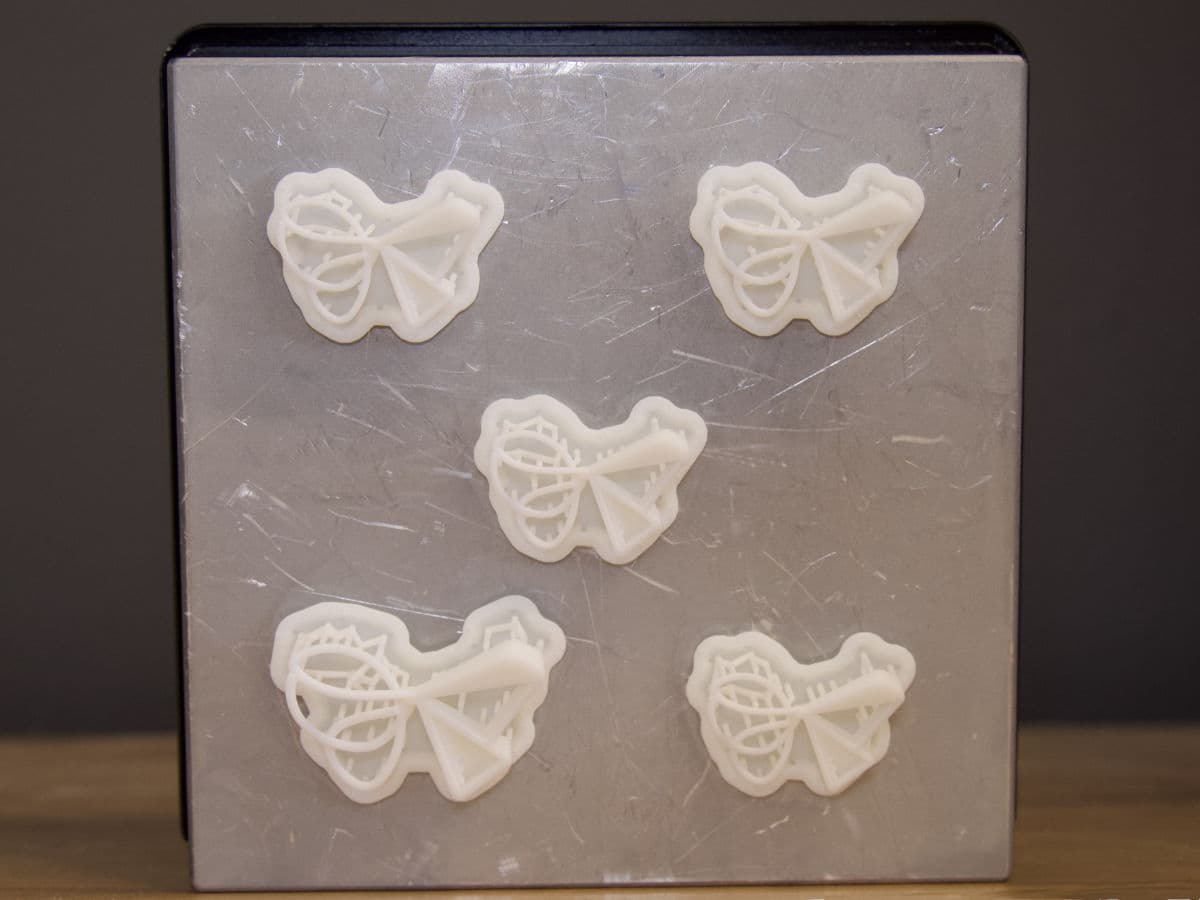

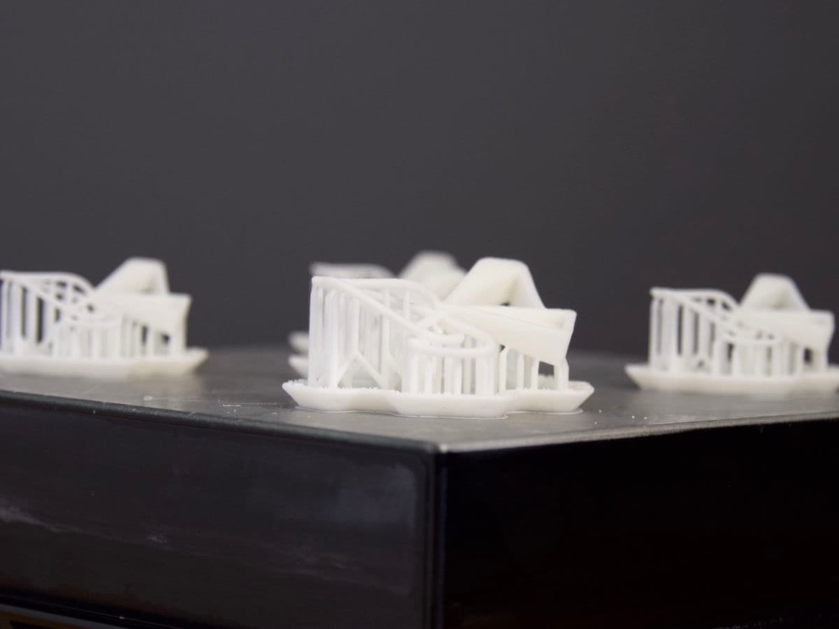

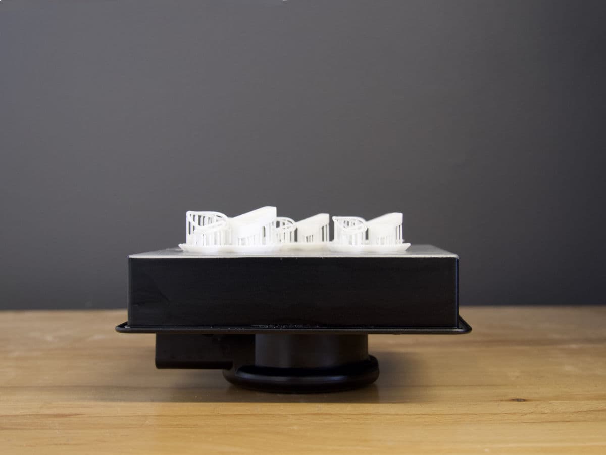

Make sure to take clear, focused photographs of your test print so Formlabs Support or your authorized reseller can best diagnose your printer's issue. It is most helpful to see the following angles of your test print on the build platform and then fully post-processed:
Side view of the supports and bases.
Top view of prints on the build platform.
45 degree close up of print details.

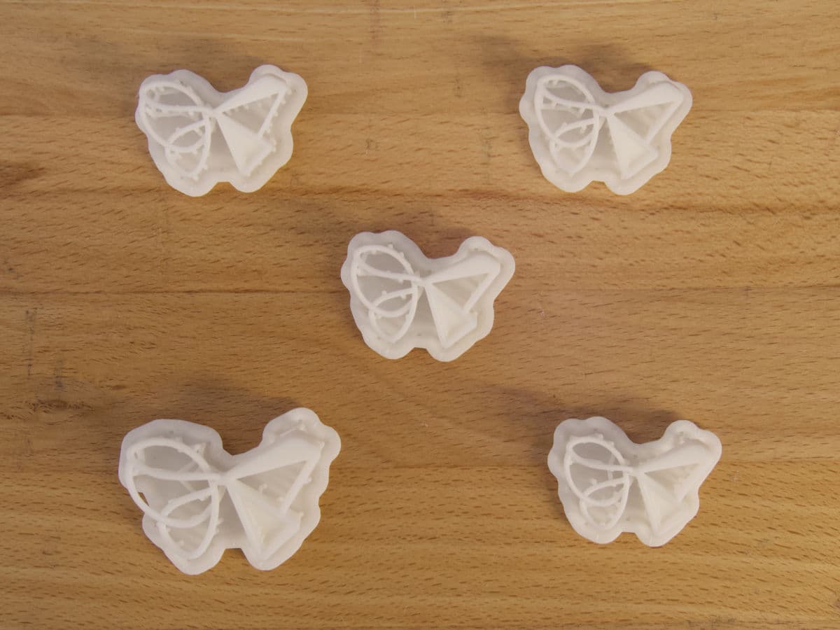

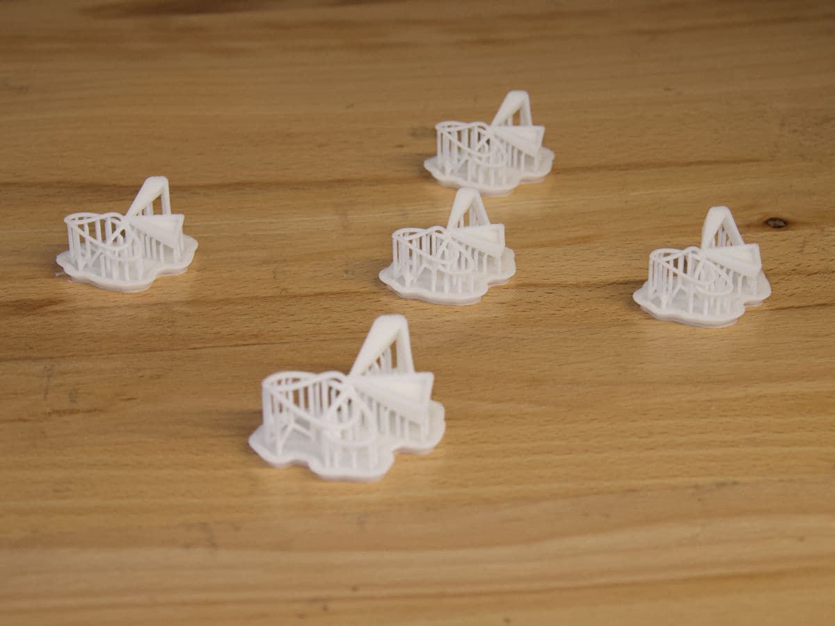

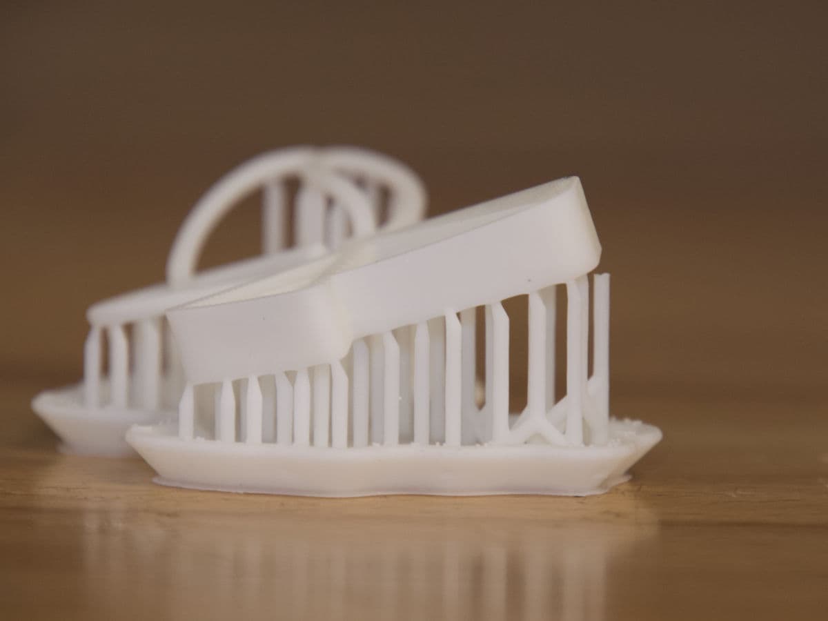

Top view of finished prints.
45 degree closeup of finished prints.
Closeup of print failures.
Close up of any specific print failures.
