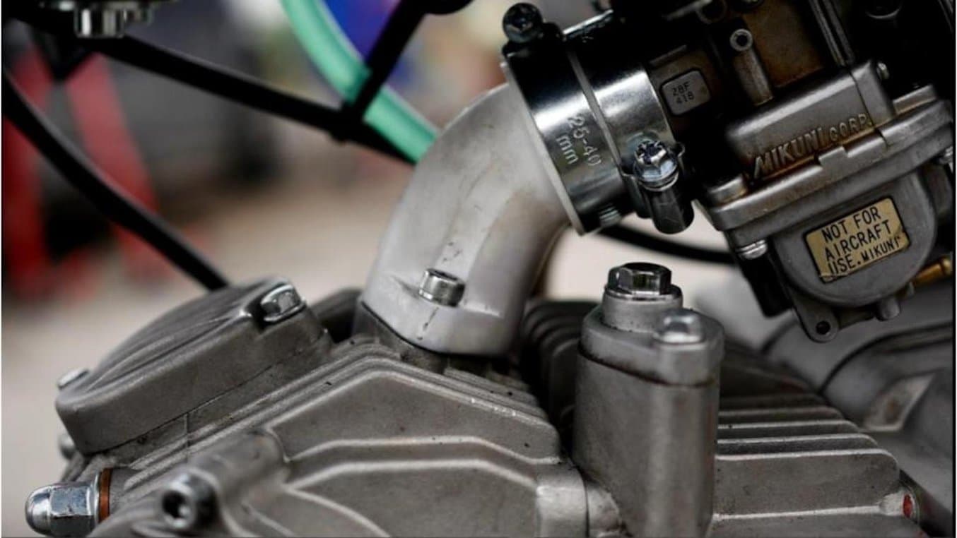

After consulting the specifications in detail, Pirazzini thought that 3D printing an intake manifold, a part that’s traditionally machined from aluminum, would be an interesting project. In the past, he had tried using FDM technology, but the result was not what he hoped for, as air leakage distorted the carburetor and the engine’s output.

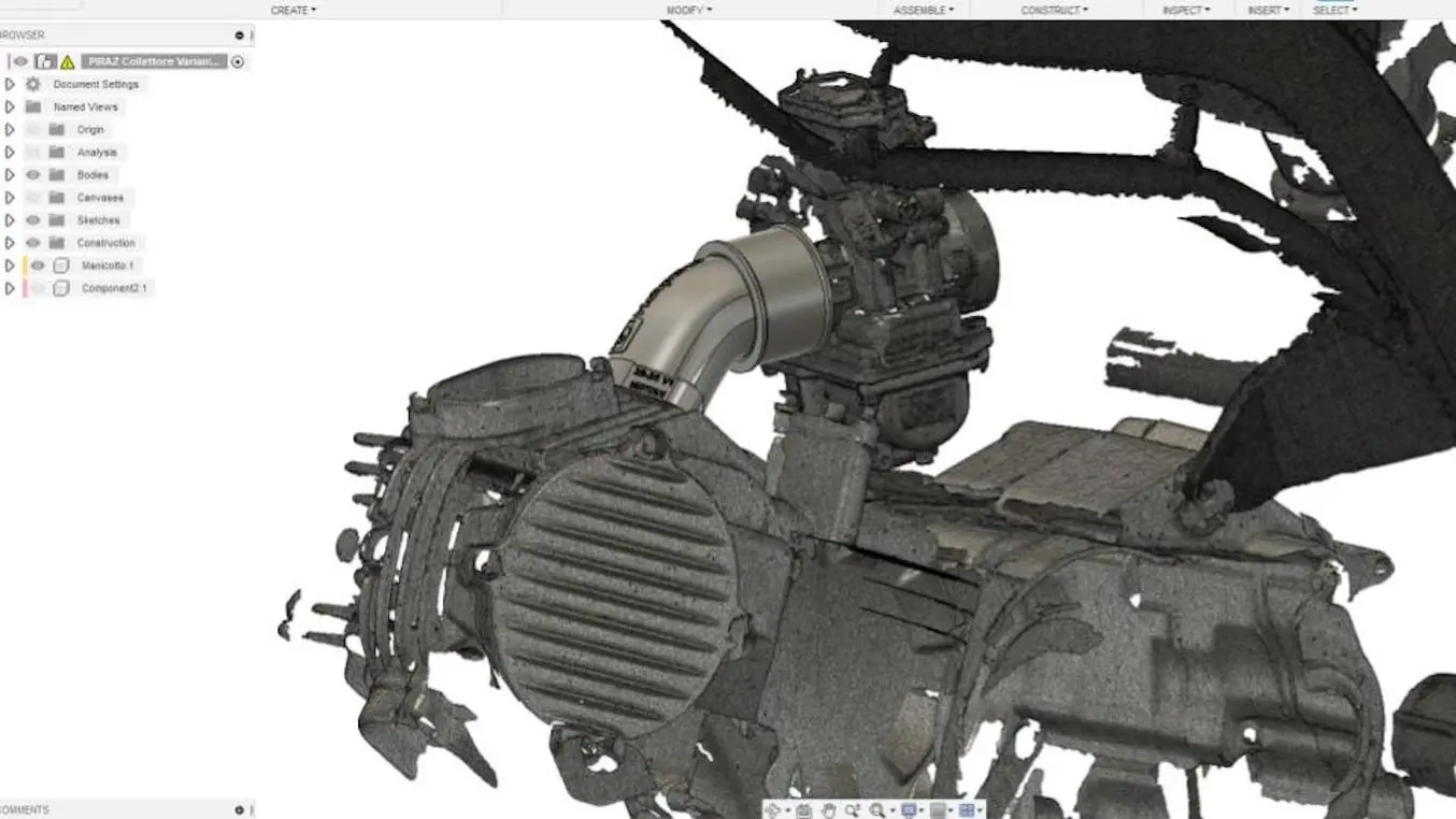

To develop the project, Pirazzini used 3D scanning and Autodesk Fusion 360 software to reverse engineer the design. The scan of the four-stroke engine (two-valve) engine with its frame and carburetor helped him to correctly size the manifold and then to position it so that the carburetor would not crash into the frame or the exhaust system. Pirazzini also designed intake trumpets and intake ducts. With the use of CAD, it was possible to align the diameter of the head inlet with the carburetor, avoiding steps and any pressure drop or turbulence.

The new manifold design was printed with the Form 3 using the Rigid 10K Resin at a 100 microns layer height, creating a smooth surface without visible layer lines. As for the finish, Pirazzini used classic water-based sandpaper to smooth the surface. Unlike an FDM manifold, which has to be treated externally and internally to be watertight, SLA printing creates solid and waterproof parts.

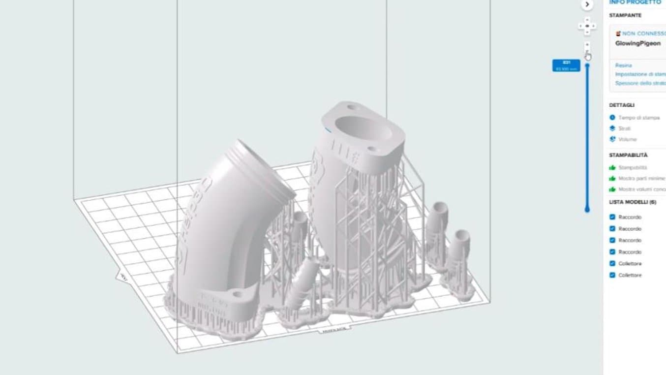

In PreForm, the user can position the object manually or use automatic orientation. Pirazzini found the latter very useful because it tends to minimize the creation of supports that can be added or removed according to the user’s needs. If supports are missing in key areas of the print job, the software will notify the user.

The manifold that Pirazzini printed with the Form 3 has withstood high and low temperatures perfectly and is still mounted on his pit bike. Thanks to the use of a thermal imaging camera, Pirazzini discovered that Rigid 10K Resin also offered a significantly better thermal performance: The 3D printed manifold with cooling fins recorded a 40-50 degrees celsius lower temperature compared to a classic aluminum manifold. Moreover, after a race of about 20-25 minutes at an outside temperature of about 33 degrees, it was possible to touch the manifold without getting burned because it was actually cold.
