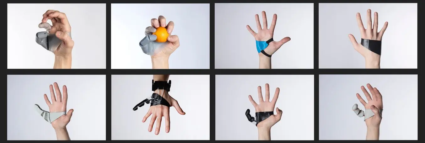

Dani Clode takes the meaning of prosthesis quite literally: rather than fixing or replacing, the Latin word's original meaning is to add something. With “The Third Thumb,” Clode has designed an attachable 3D printed thumb controlled by the feet–and challenges our perception of prosthetics.
Watch the video to learn how “The Third Thumb” works and how it extends the wearer’s abilities.
Her graduation project at the Royal College of Art in London combines a seemingly simple design with refined technology. 3D printing enabled the young designer to achieve the level of precision required for the prosthetic on an accessible machine and with a quick turnaround.

I utilize the Form 2 to prototype and realize final models. I don’t like to work on a design in 3D virtual space for too long. I usually create my first prototype, print it, and then return to Rhino to update the model. I can go back and forth like this up to five or six times before I am happy with my final print.
I think when you work in a virtual space too long, you start to lose the tangibility of the design, especially when it comes to designs that attach to the body. So it’s great that we now have the facilities as designers to be able to very quickly work in both physical and virtual space almost simultaneously.
What are special requirements or attributes of the designs you’re 3D printing?
Feeling finished was a big part of it. With so many 3D printed parts, you can tell right away how it was printed, but with the Form 2, after sanding and a little bit of oil, it looks like a finished part.
I also had some very tight tolerances with “The Third Thumb.” There are pipes running through the hand piece that house the teflon tubing for the wires; I was working with a tolerance of about ±0.2 mm.
Dani Clode used Formlabs Grey Resin for “The Third Thumb” prosthesis. Request a free sample part.
What specific aspects of the design and workflow were made possible by 3D printing?
The fast turnaround helped enormously. I also really appreciate not having to paint the prints for them to look good, I think that saved me the most time in my process.
The biggest challenge was definitely the internal pipes in my design. It was such a tight tolerance, and the Form 2 performed great with the tolerances I provided.
