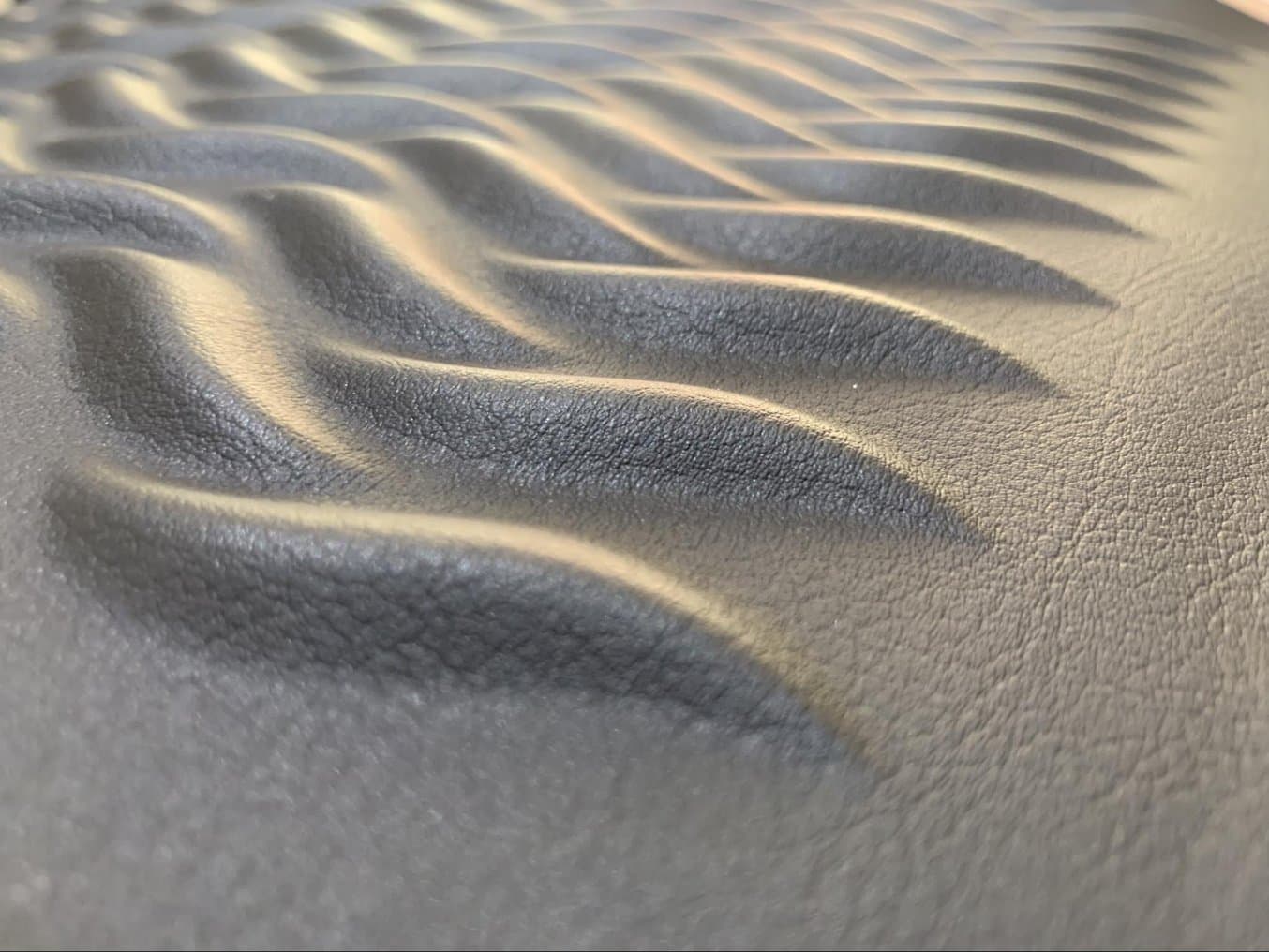

A close-up view of 3D leather.
Real leather is a material that is popular, among other applications, for the interior of vehicles or real estate properties. Leather is also often embossed, embroidered, or covered to achieve the desired pattern. The Makra Pro team wanted to achieve a 3D look for leather covers, which is a major challenge since real leather is difficult to stretch.
The groundbreaking idea came to Mr. Krabel while preparing waffles for his breakfast on a Sunday. He asked himself, “Could the leather be molded with the help of a foam, which spreads out in the same way as waffle batter?” This idea was finally put into practice and validated.
First, the molds for the tool are printed on the Form 3 printers with a specially developed material. These molds are inserted into the tool, covered with leather, and then injected with the foam for shaping. When the tool is then closed and the foam hardens and the leather takes its 3D look.

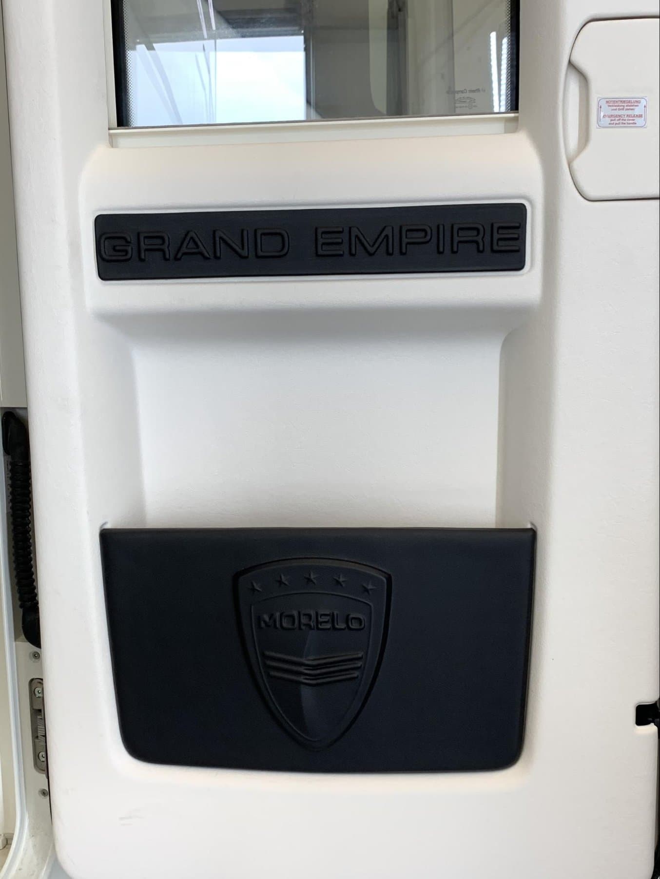

Custom 3D leather parts proceed for a luxury motorhome produced by Morelo.
The finished leather parts can then be, for example, stretched over the door panel in a car or attached to the seat cover in a vehicle. One well-known tuning company of limited-edition luxury automobiles uses these molded leather parts for wall or ceiling panels in vehicle enhancements.
The custom 3D leather parts built into the door of a luxury motorhome.

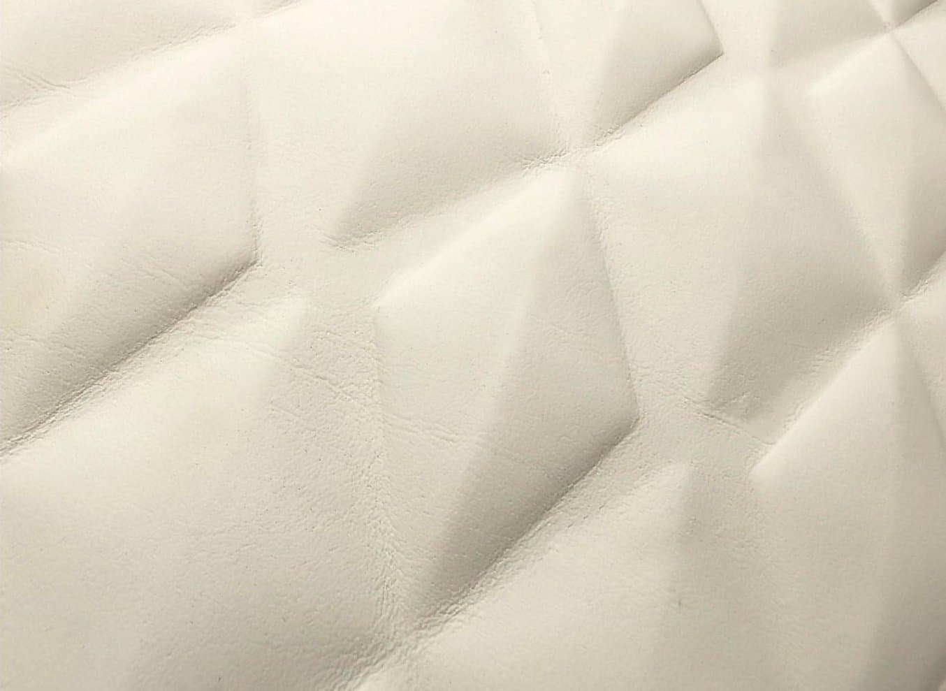

Customers often request designs where the embossments of the leather are very delicate and can only be achieved using the 3D printed tool.
Since the end parts are usually larger than the build volume of the Form 3 printer, the molds are printed in several parts and then assembled in the tool. The largest mold Makra Pro produced consisted of 160 individual parts. These parts are often glued together in the tool or in other cases, the leather is processed using a loose mold in order to be able to change and personalize parts of the mold quickly and easily.
