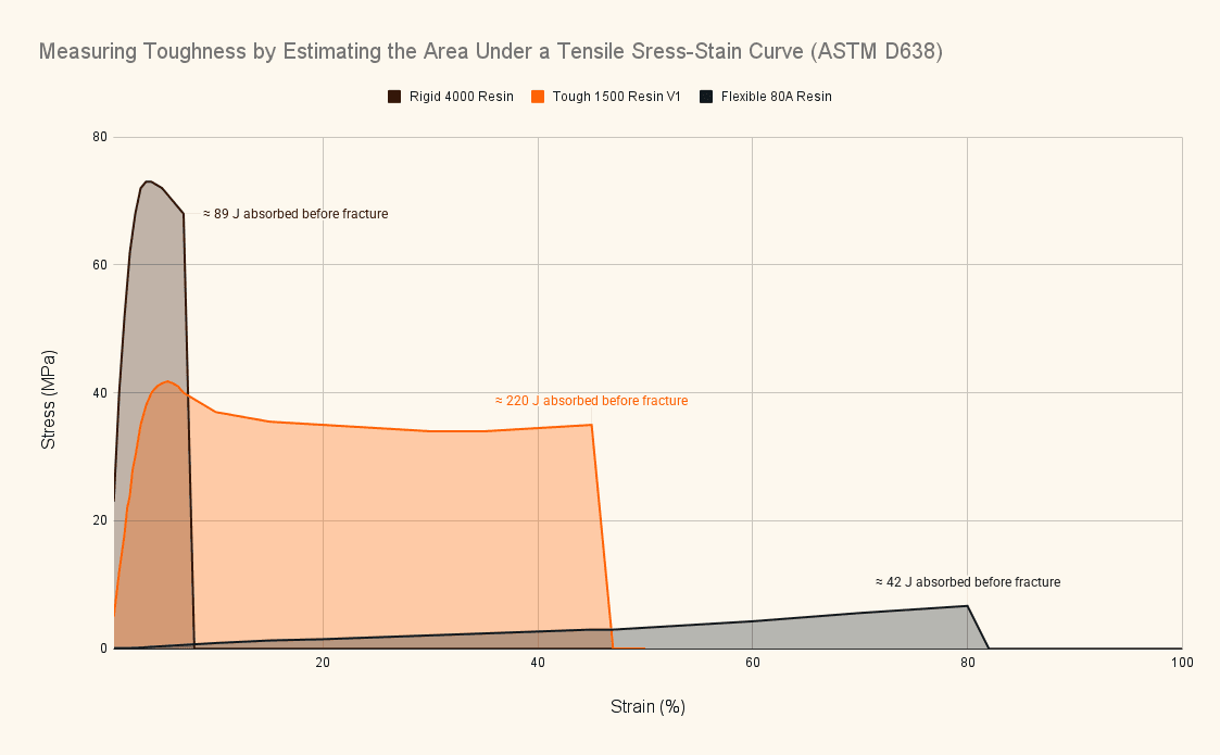

Toughness is the ability of a material to absorb energy and plastically deform without fracturing, but there are several ways to quantify toughness.
One way is to perform a tensile test like ASTM D638, where a specimen is pulled apart by a pair of grips. The force on the cross-sectional area of the part, or stress, can be plotted relative to the elongation, or strain. Work is the dot product of force and distance. By taking the integral to calculate the area underneath the stress-strain curve, the energy absorbed before fracture can be determined.
Tensile Toughness: The stress on an area of the part relative to strain.
ASTM D638 tensile test on Tough 1500 Resin V1.
ASTM D638 tensile test on Tough 1500 Resin V2.
This particular way of measuring toughness is often called “Tensile Toughness,” and while it’s useful for helping understand the meaning of toughness, it is not commonly measured or reported, making it more difficult to quantitatively compare toughness values and is rarely reported in a technical data sheet (TDS).
Graph showing stress-strain curves of three resins
