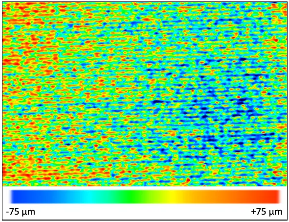

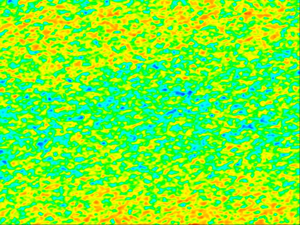

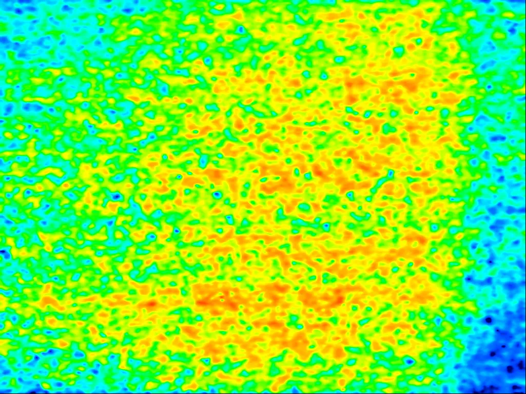

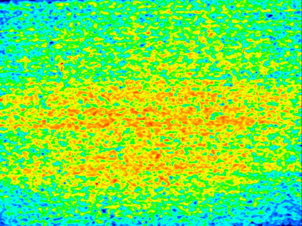

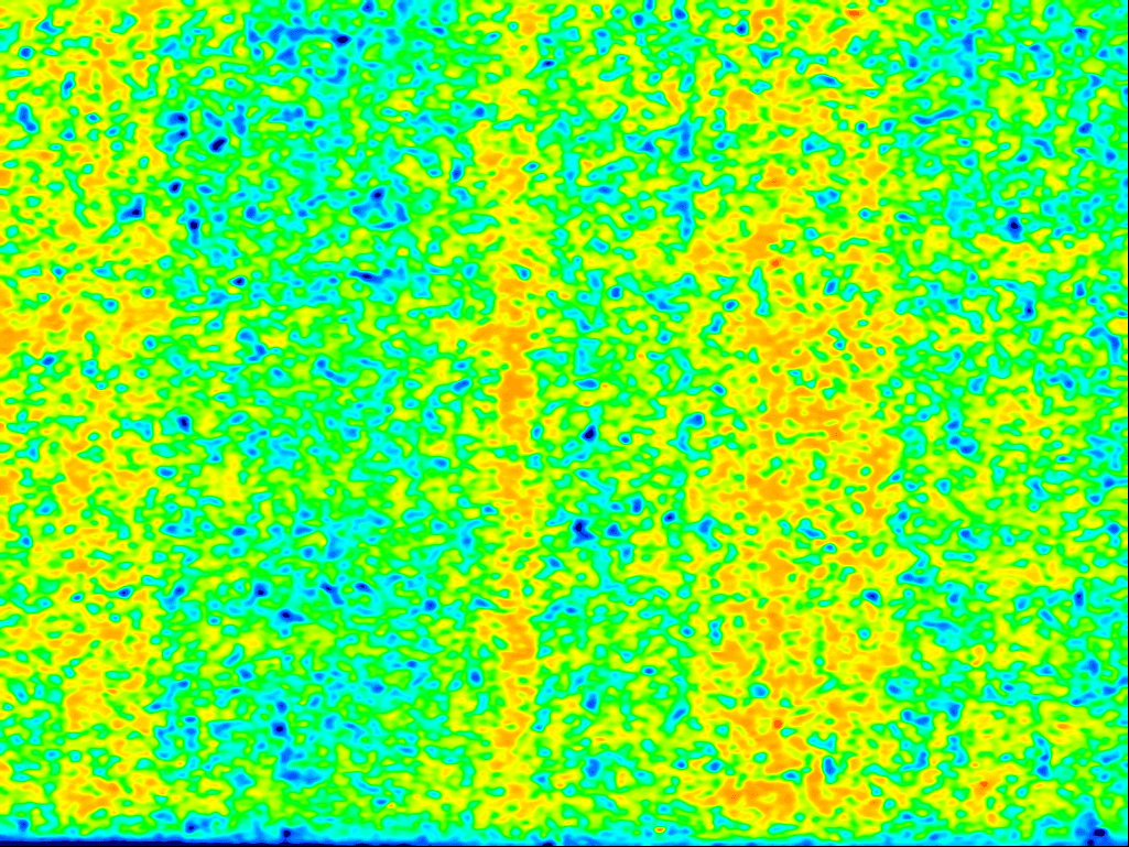

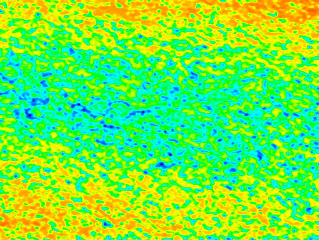

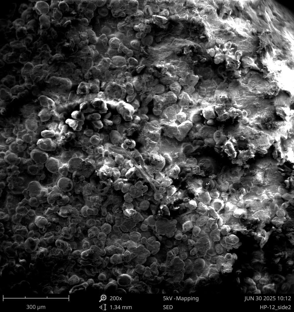

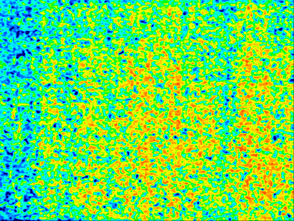

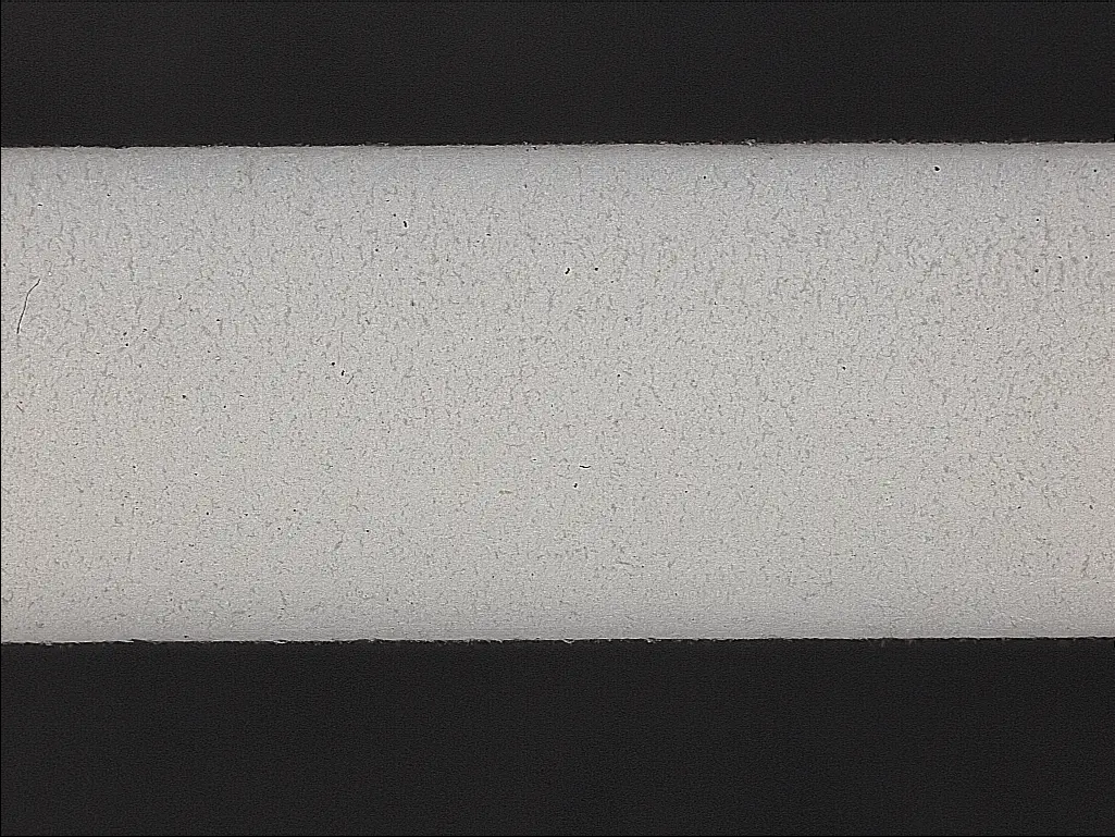

Three other methods of determining surface roughness were employed: optical profilometry, high-contrast photography, and SEM microscopy. Though the major results of this paper are taken from the surface profilometer readings, these supplementary measurements are included in the Detailed Results, and can provide further context and evidence.
From left to right: An optical profilometry scan via a Keyence VR-3000, which provides surface plots and Sa/Sz; high contrast photography, which shows the roughness along a surface; and SEM microscopy taken with a Phenom XL, which shows the microscale deviations in the surface. Additionally, gloss measurements are used to show how shiny a part appears to be, which is often compared with the surface roughness. Since these analysis techniques can get extremely complicated, they aren’t described in detail here, but are described by the various manufacturers in the related links.

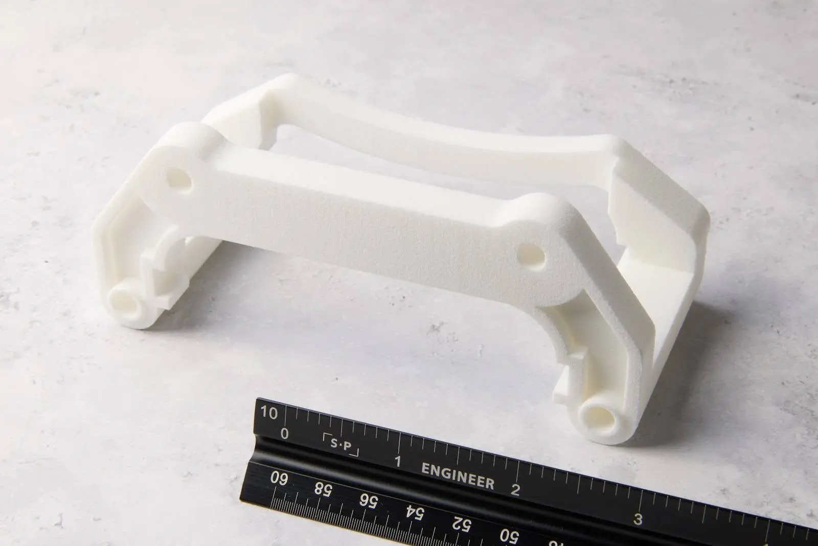

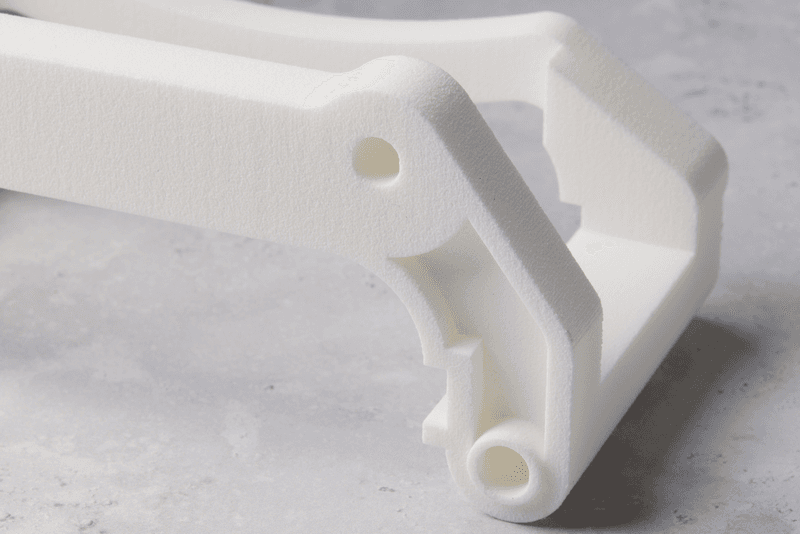

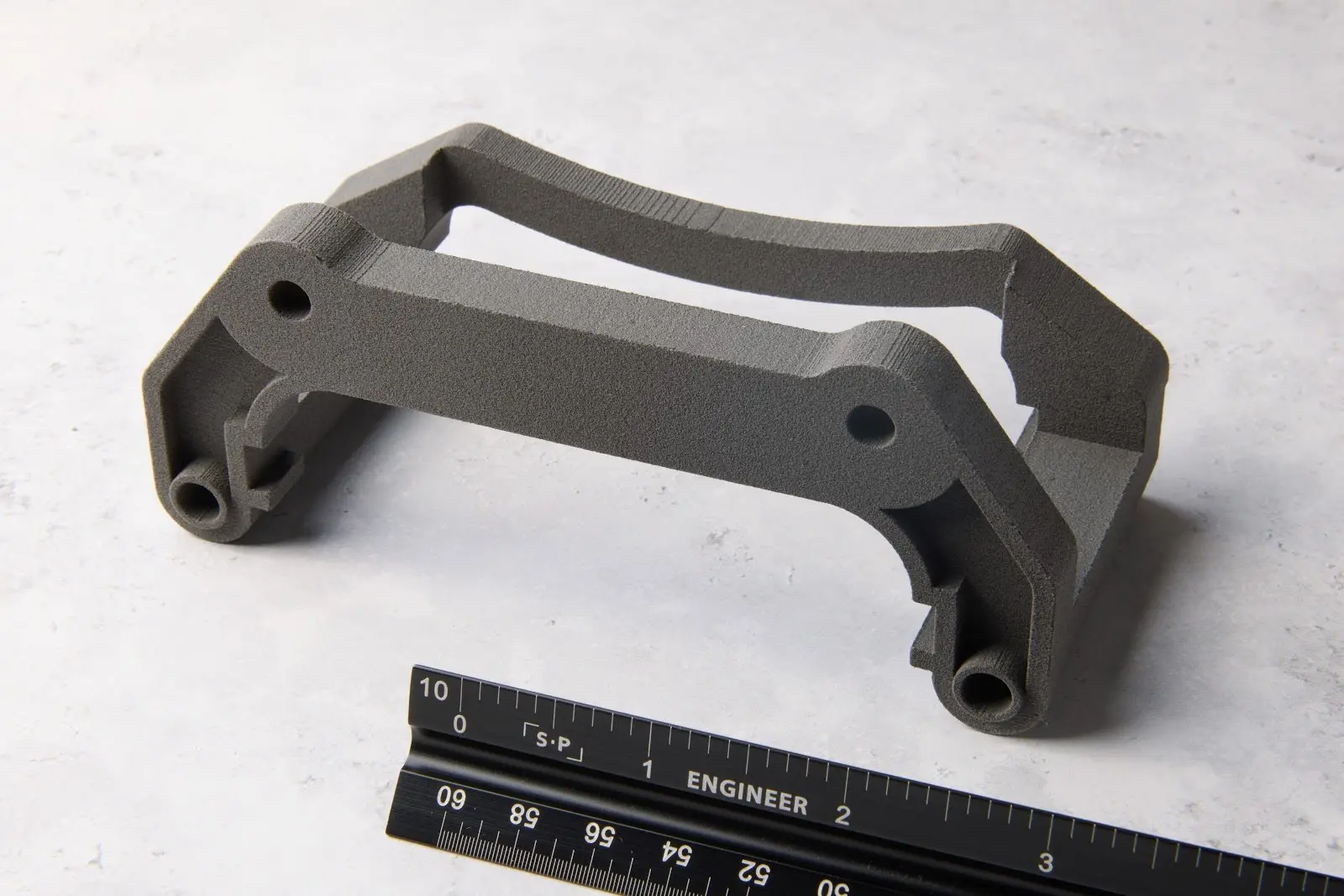

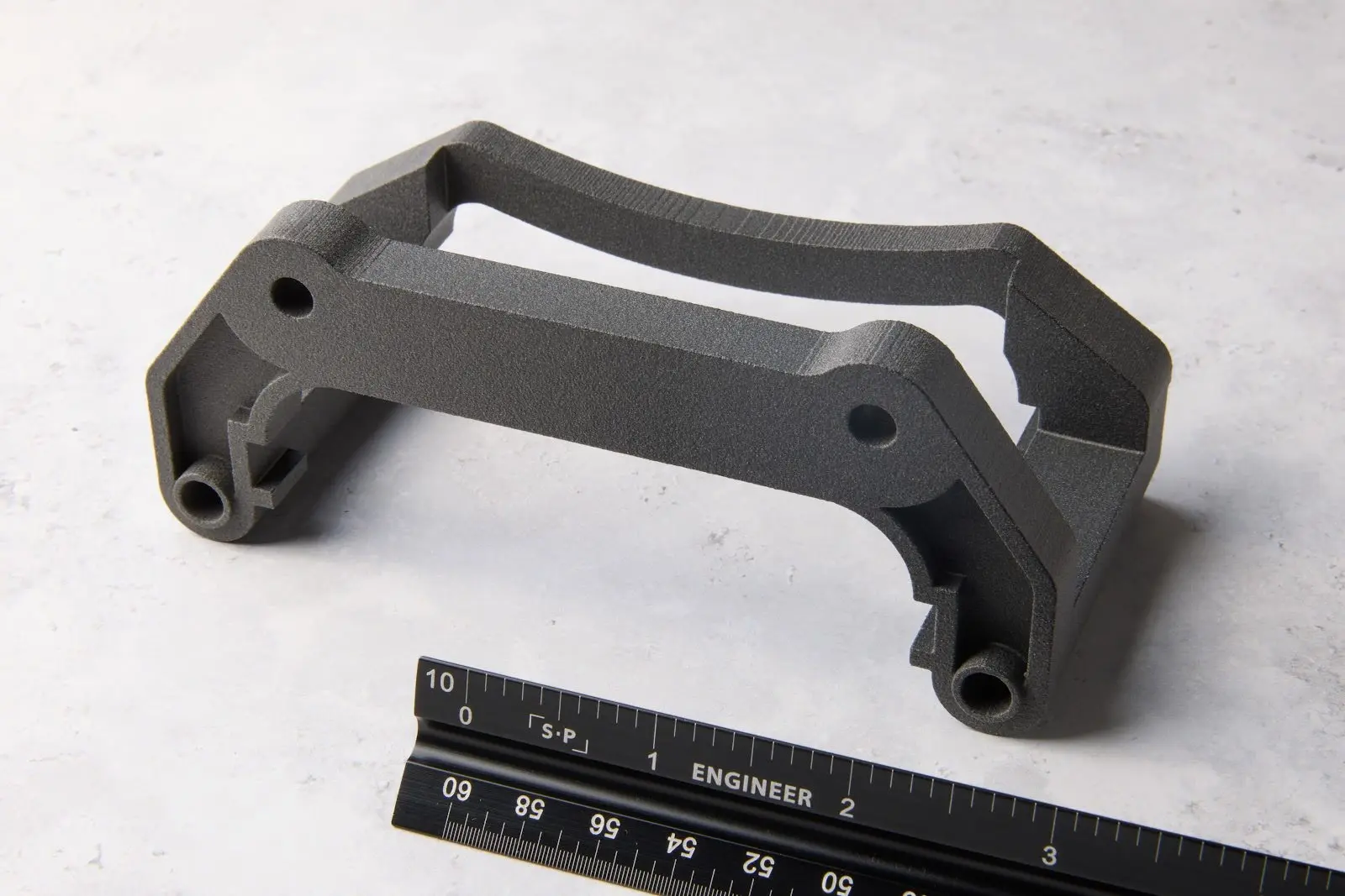

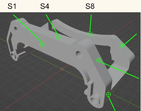

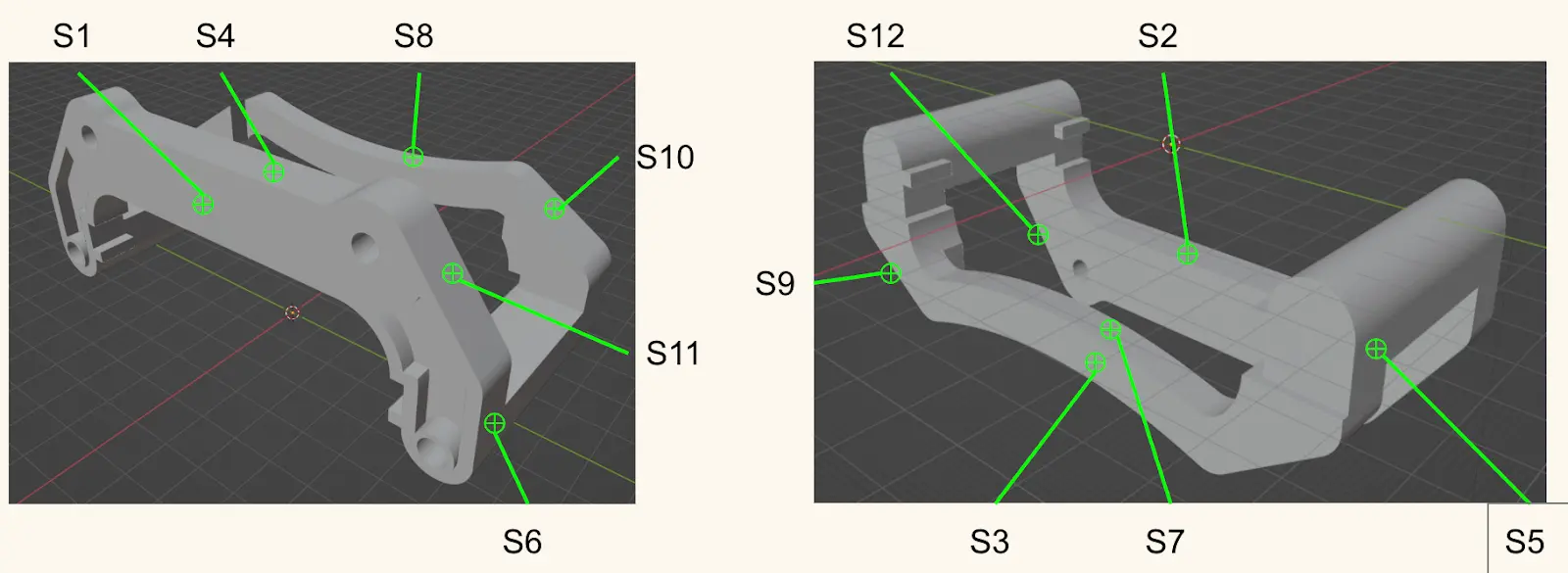

The model selected for this study — the brake caliper — features large flat surfaces in every major plane, four angled planar surfaces, and multiple sloping surfaces, all of which are large enough to give high-quality data. Keeping the part in the same orientation on each printer guarantees that the different features resolve as needed.
The brake caliper part in PreForm. The part features large flat surfaces in every major plane, four angled planar surfaces, and multiple sloping surfaces.
In total, 12 different measurement planes were identified and measured by optical profilometer and contact profilometer methods.

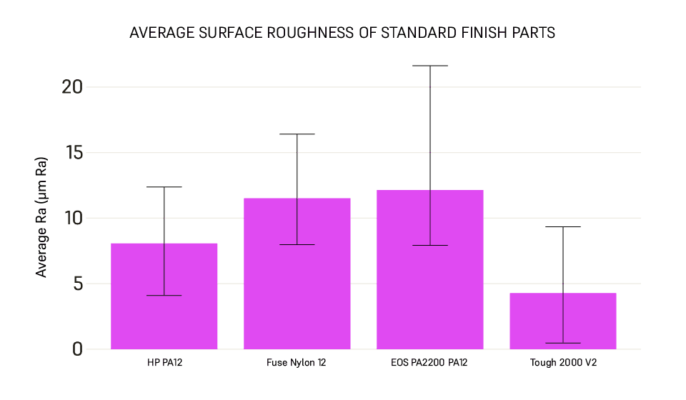

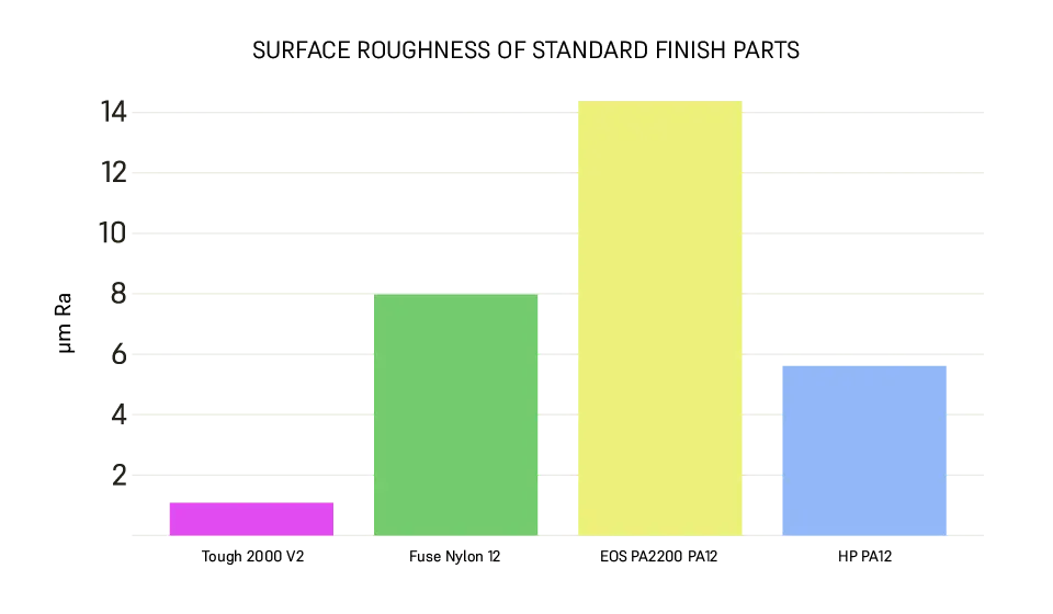

Average Ra of all 12 Surfaces:
Surface roughness averaged over all 12 faces as measured by a contact profilometer, for each part, following the standard surface finishing process.

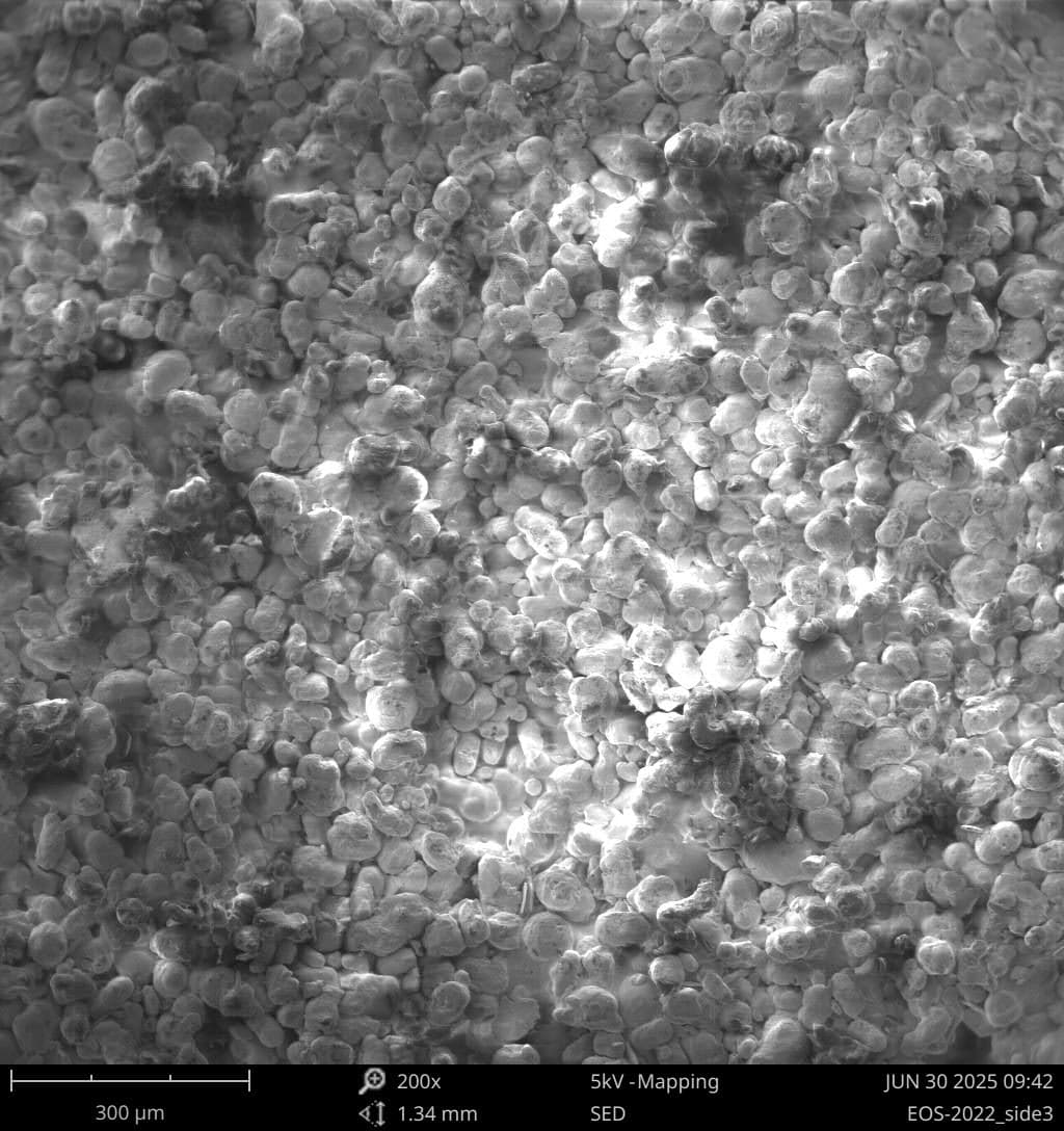

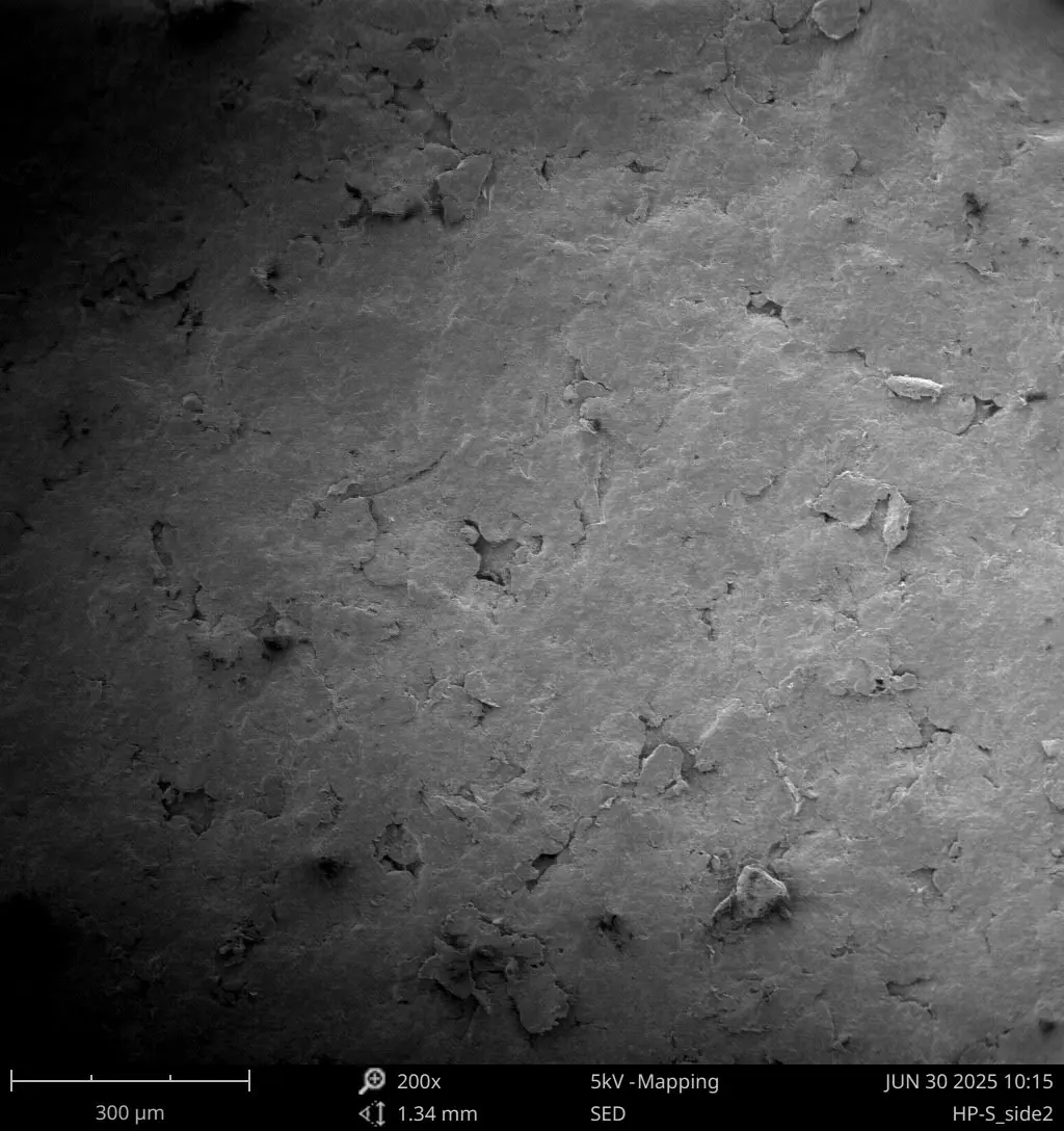

Visual Comparison of Curved Surfaces

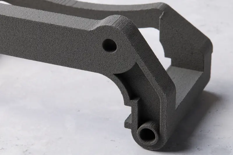

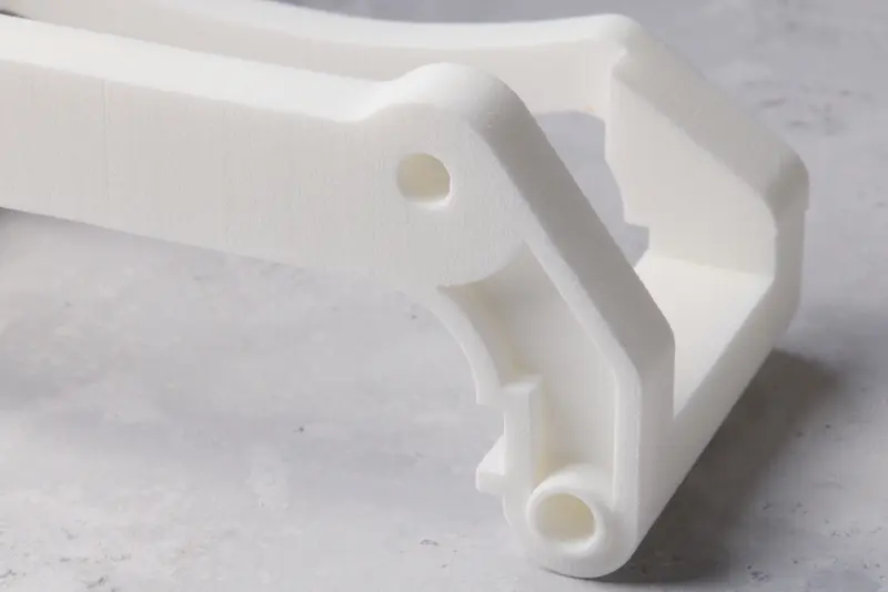

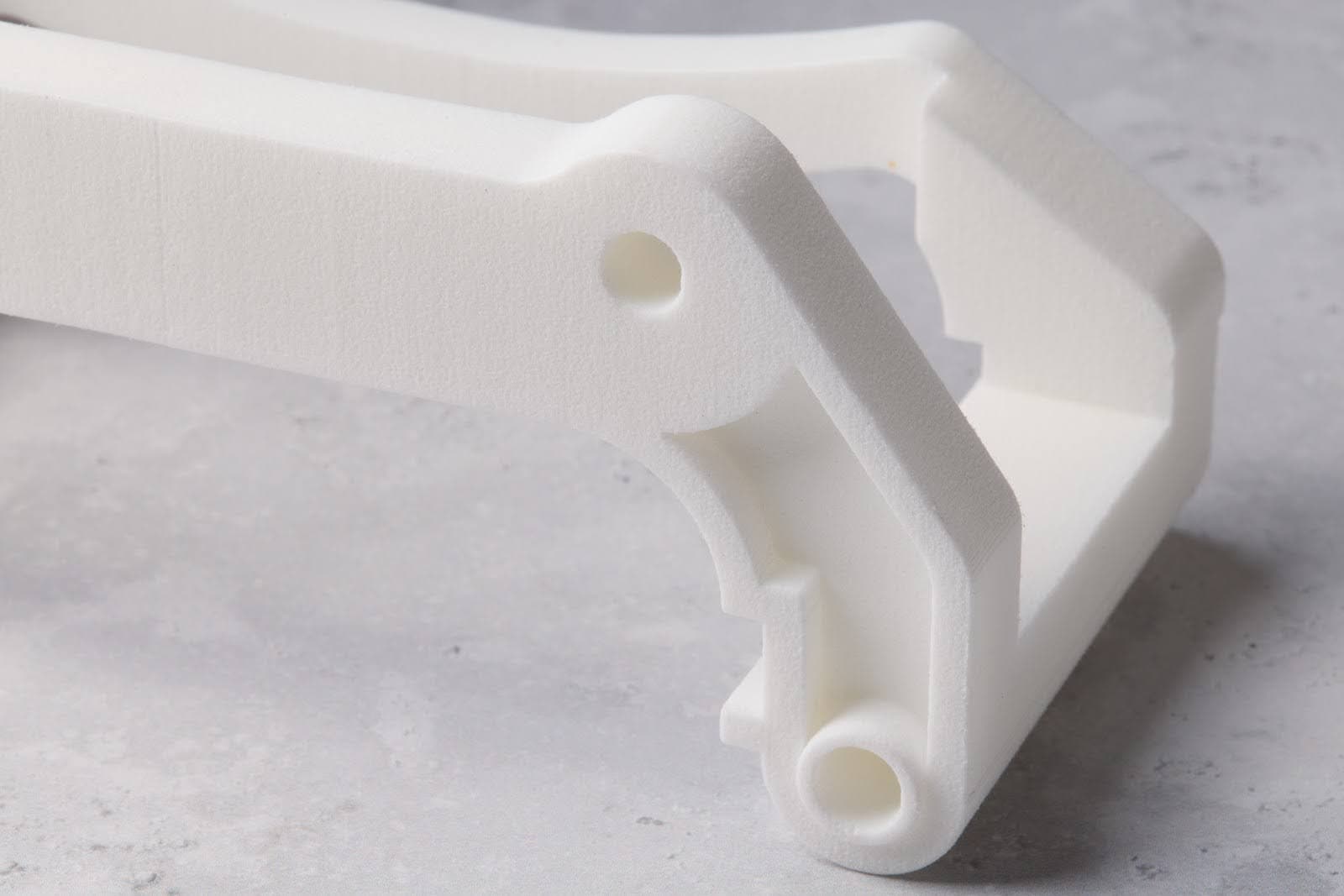

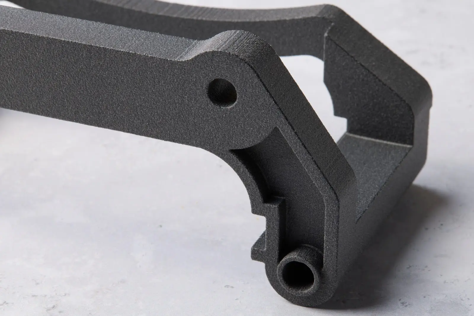

Looking closely at these images shows several key points on the surface finish. The curved surface, particularly, shows the stair-stepping that occurs when these parts are printed. For most of these, they show up as 100 µm steps, though in some cases they smooth out. On the other hand, the flat face directly facing the camera shows a vertically oriented surface. On the Tough 2000 Resin part, the surface looks almost glass-smooth, while on both the EOS and Fuse Series surfaces, a lot of roughness is visible. The HP part splits the differences somewhat, with a surface that looks almost like cloth.
Fuse Series Nylon 12 Powder
EOS PA2200
HP PA12

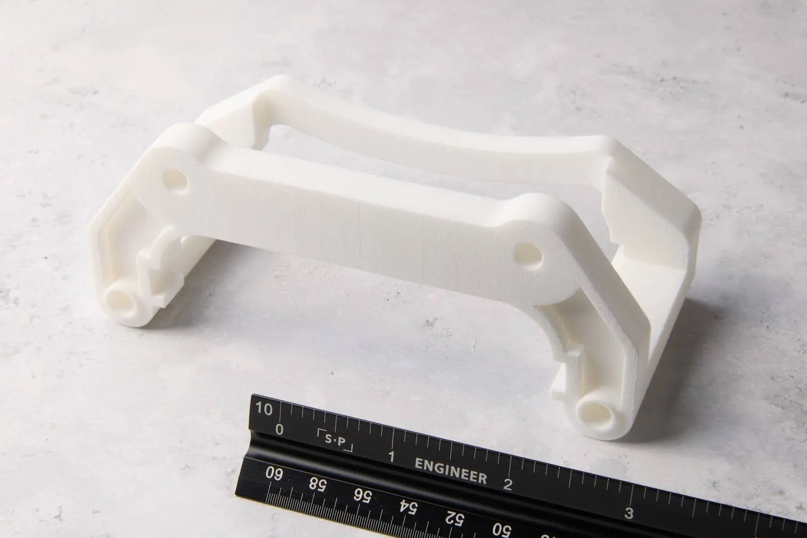

Form 4 Series Tough 2000 Resin

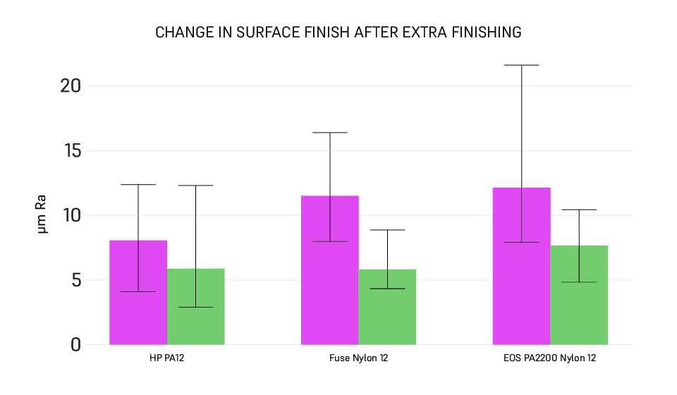

It’s apparent how much post-processing impacts the average surface finish — the smoothness of Fuse 1+ 30W printed Nylon 12 Powder improves dramatically and is nearly on par with that of the HP PA12 after running the polishing routine.

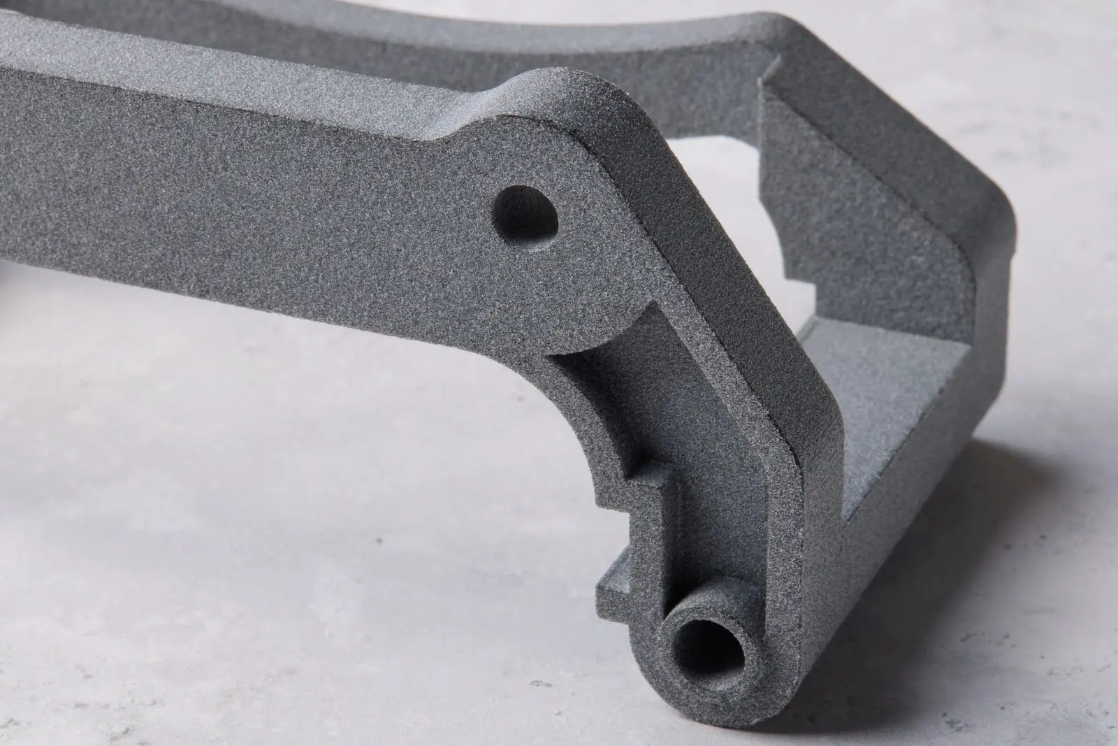

Fuse Series Nylon 12 Powder: Standard vs. Polishing

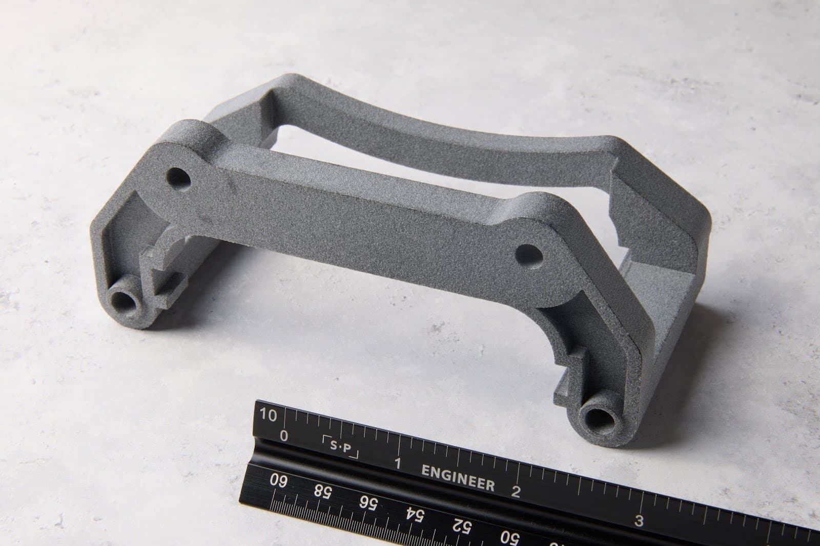

Before (left) and after (right) a secondary post-processing step (Fuse Blast Polish).
Parts before and after 'extra' post-processing are shown below from the three powder bed technologies (Fuse Series, EOS, and HP). Because there is no 'extra' version of post-processing for the SLA 3D printed part, the comparison is not shown.

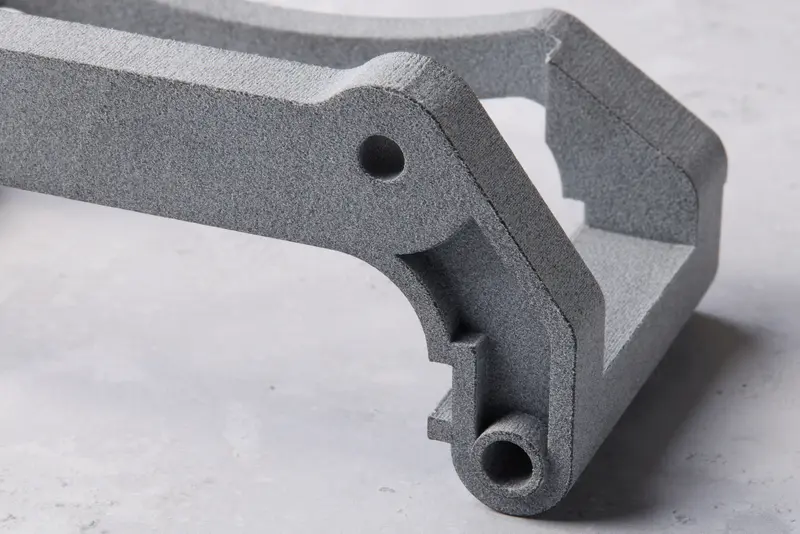

EOS PA2200 Nylon 12: Standard vs. Extra Tumbling
Before (left) and after (right) a secondary post-processing step (extra tumbling).
HP PA12: Standard and Extra Tumbling

This study shows that parts printed by SLS and MJF technologies can achieve very similar surface roughnesses. Parts printed on the Formlabs Fuse 1+ 30W in Nylon 12 Powder are somewhat smoother than those printed on EOS SLS printers with EOS PA2200 Nylon 12, though with additional post-processing (Fuse Polishing System and vibratory tumbling, respectively), the two are very similar.
Directly from the printer, MJF parts printed on the HP printer have the smoothest surface finish, though on average, this is only by about 0.2 µm, and the difference is further mitigated by post-processing.
Ecosystem additions, such as the introduction of Formlabs’ Fuse Blast Polishing System, enable users to achieve part surface quality traditionally reserved for systems that cost many hundreds of thousands of dollars more. Post-processing steps like this, combined with print process improvements, are what enable accessible SLS printer systems to produce parts with highly competitive surface finishes, ranging from
4.3 µm Ra to 8.9 µm Ra at the high end when polished.
