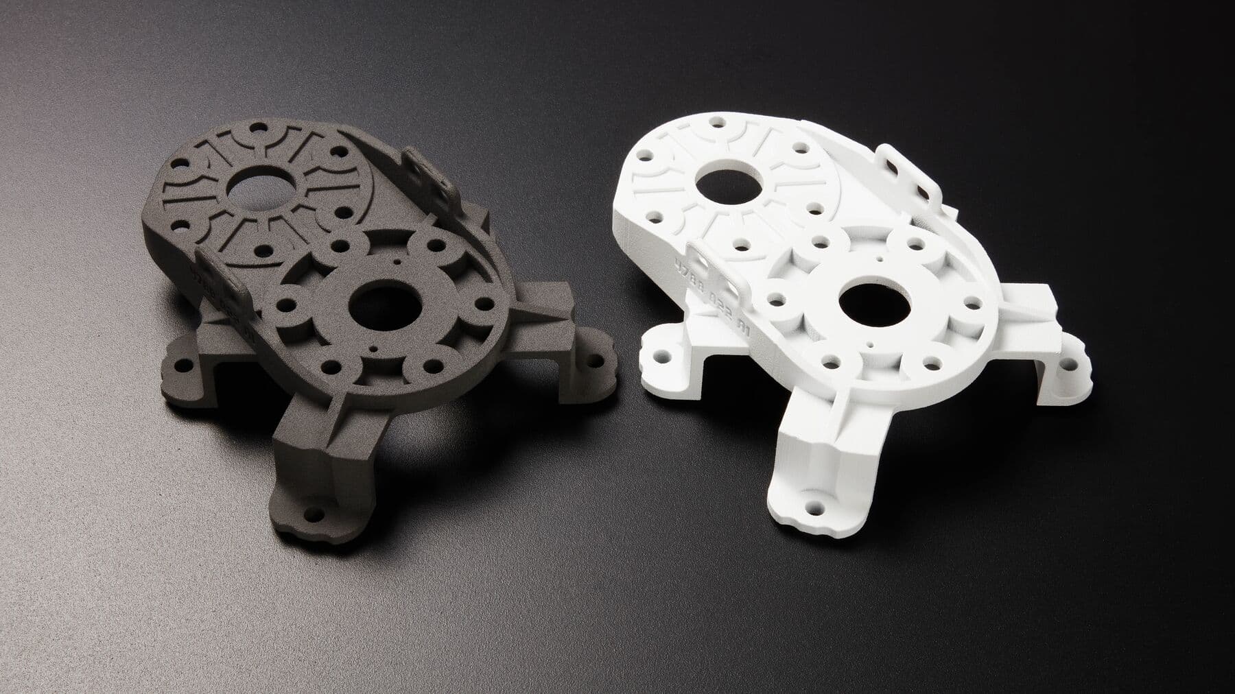

two sls 3d printed parts, automotive swivel gear, one on the left is nylon and dark grey, one on the right is white and cerakoted
An SLS printed swivel gear, uncoated (left) and Cerakoted (right). Cerakote is an ideal material for these gears, which require frictionless assembly and contact with other parts, as well as the ability to withstand wear and tear.

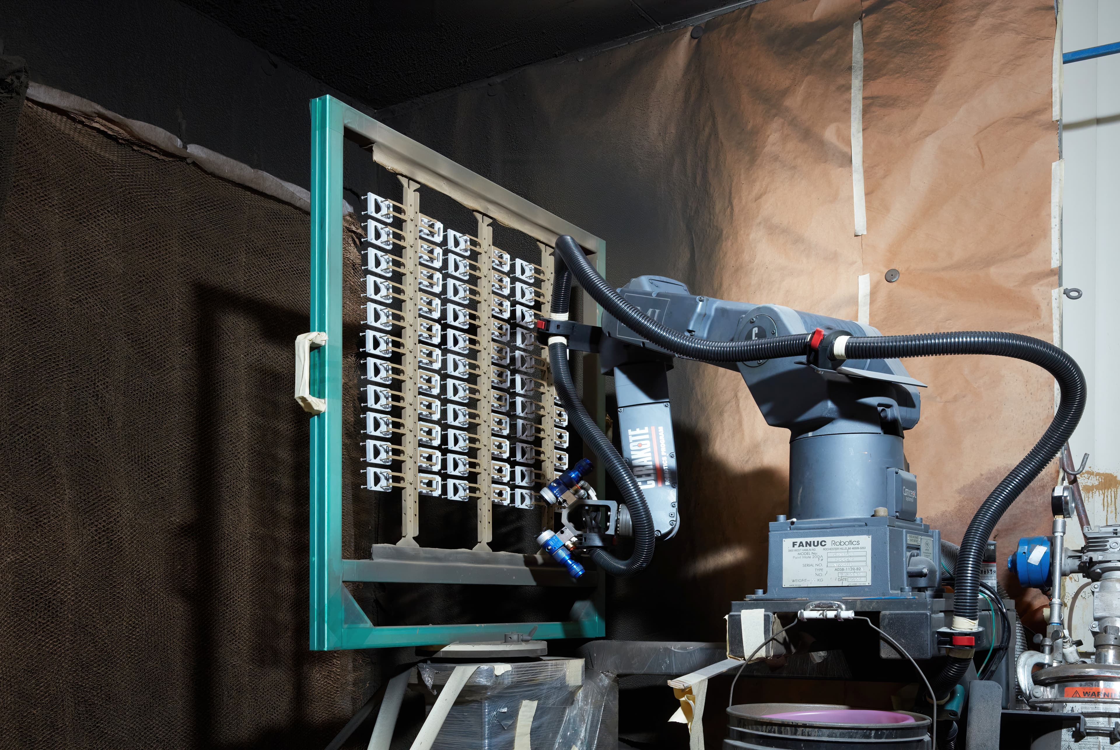

cerakote robot at SMI Finishers
The Cerakote robot at SMI Finishers in Amesbury, MA, coats parts evenly and quickly, enabling increased productivity.

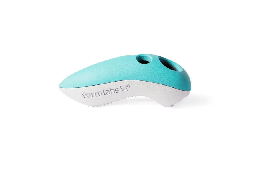

This 3D printed VR remote combines the lightweight properties and durability of SLS 3D printing with the vibrant colors, UV resistance, and increased material stability of ceramic coated parts. It is printed in two parts and coated in two separate colors. The Fuse 1+ 30W can produce 36 units of this VR remote assembly (36 top and 36 bottom parts) in 24 hours and 27 minutes, enabling the production of 200+ parts in a single week.

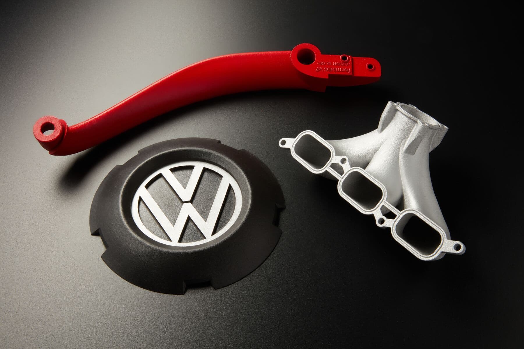

Automotive manufacturers have already begun incorporating 3D printing into their workflows for lightweighting traditionally machined parts, insulating supply chains, offering customization, and reducing costs with inexpensive and quickly-made jigs, fixtures, and repair parts.
Now, with an easy 3D printing and Cerakoting workflow, parts can withstand higher temperatures and more UV exposure, making a wider variety of end-use applications possible. Whether for custom-made one-off luxury cars or functional prototypes, Cerakoted 3D printed parts can be used in engines and on exteriors.
cerakoted automotive parts
Cerakoted parts are better able to withstand high temperatures and prolonged UV exposure, making them ideal for automotive applications, especially where lightweight improves overall vehicle performance.

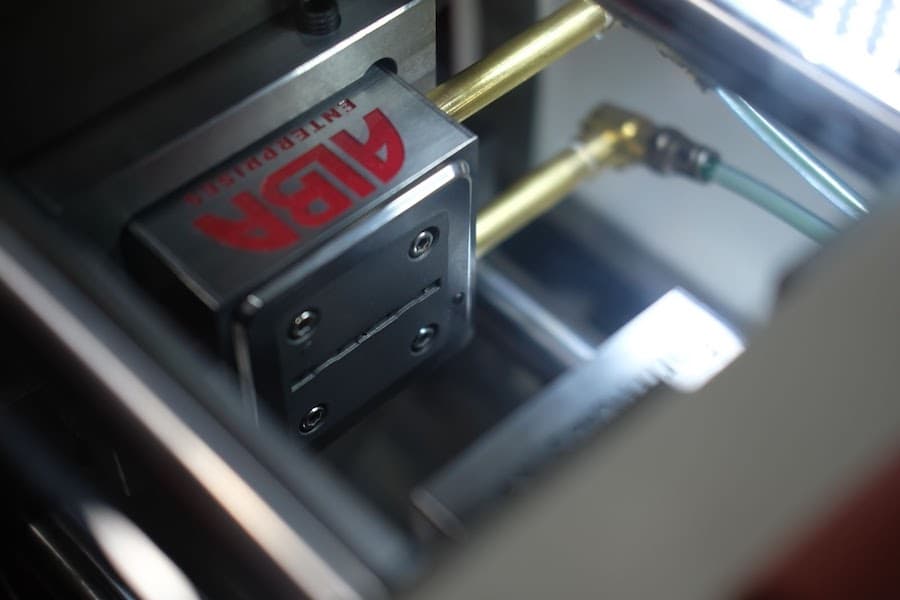

Injection mold printed on the Formlabs Form 3+ SLA printer, then coated in Cerakote. Manufactured by Alba Enterprises, and used in the Babyplast micro injection molding machine.

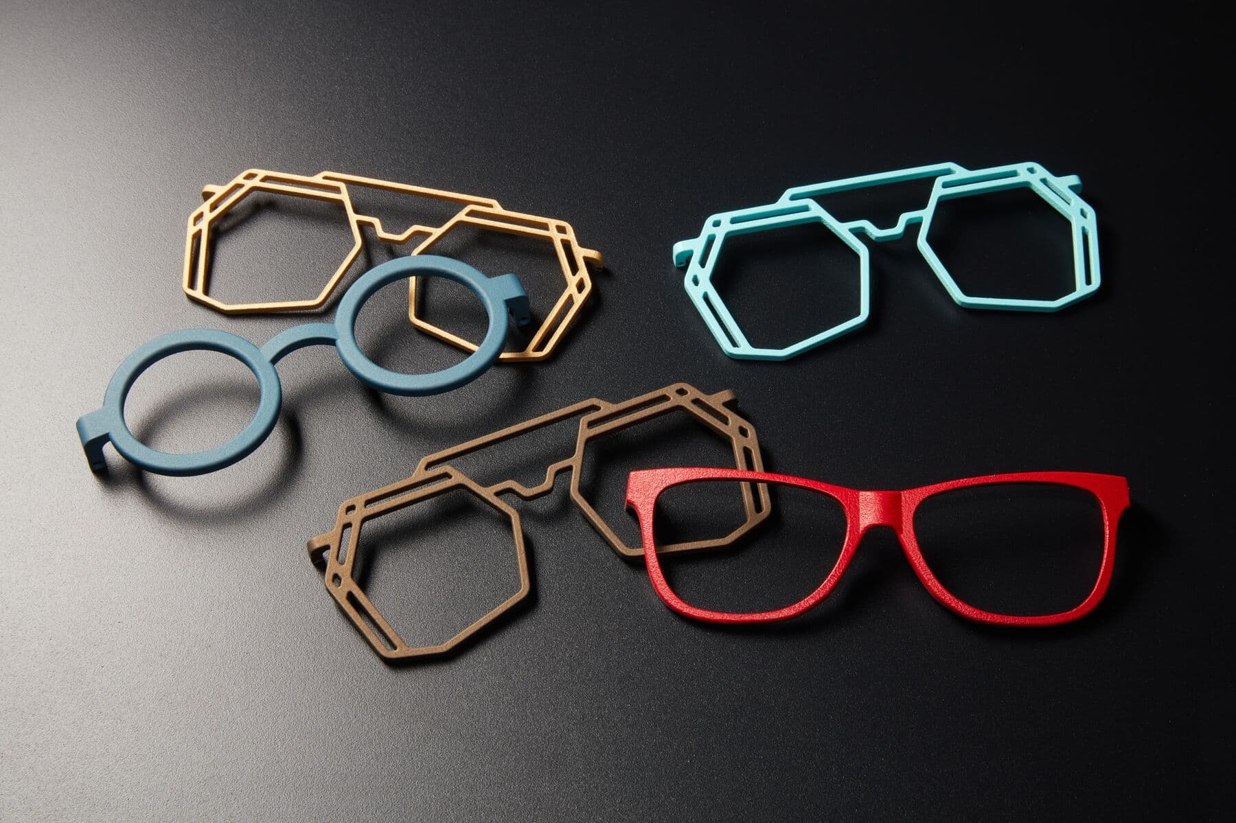

cerakoted sls 3d printed glasses frames
For consumer goods like these unique eyewear frames, Cerakoting is a great way to add professional, smooth finishes and end-use functionality.
