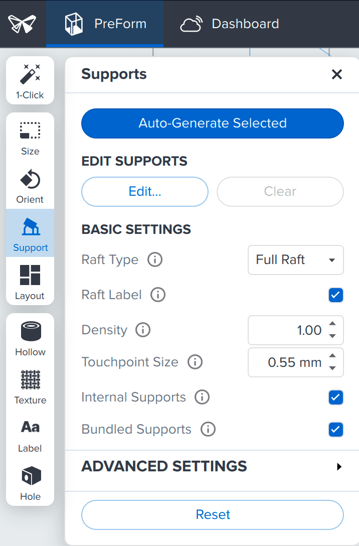

Setting Up Bundled Supports in PreForm
Screenshot of Supports menu in PreForm
To generate Bundled Supports, check the “Bundled Supports” checkbox in the supports tab within PreForm. Supports can then be generated using the “Auto-Generate All” or “Auto-Generate Selected” button.
Removing Bundled Supports
To remove bundled supports, grip a support tower and pull. Repeat this grip-and-rip for each bundle or tower of supports.
