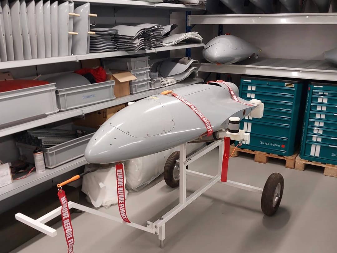

Flying Beyond Limits
ION Mobility's drones are state of the art machines, so manufacturing them can be expensive. The Fuse Series has reduced R&D costs by 60% and increased their development speed by 70%, helping them reach market faster and stay ahead of their competition.
As demand for agile, rugged, and intelligent drones continues to grow, ION Mobility is poised to lead the way. Their investment in the Fuse 1+ 30W and Nylon 12 GF Powder has empowered the team to innovate without compromise and scale production with confidence. From prototype to production, they’ve gained full control over their development pipeline — delivering smarter, safer, and more effective drone solutions to the market faster than ever before.
