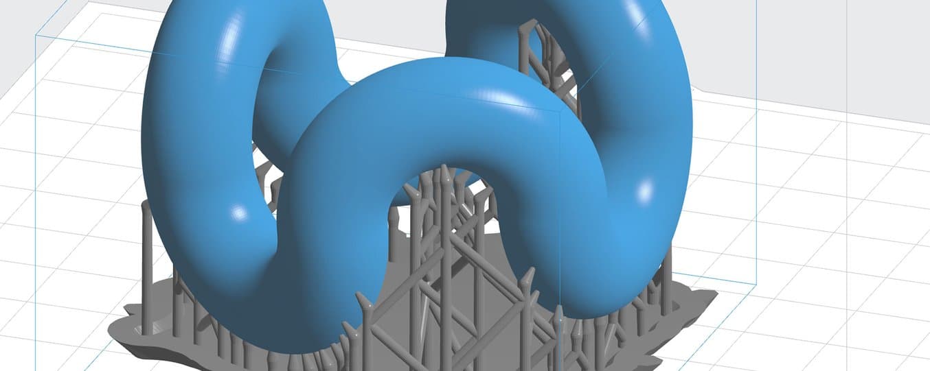

Printability at a Glance
In the bottom right corner of PreForm, we’ve added a simple printability indicator to help you determine whether your print is likely to succeed.
In the example below, we can see that the lower parts of the loops are well supported, but the upper parts might have some problems printing. If you hover over the printability indicator, you’ll see some details about what’s wrong, with a link to our documentation on What Supports Do.

In a case like this, to avoid the need for internal supports, it’s usually better to orient the part so that taller portions of the model aren’t hovering directly above the earlier layers.
![Re-orienting the model removed the red highlights, minimizing the chances of a print failure.](https://archive-media.formlabs.com/upload/printability_success.png)
In the successful case above, the printability indicator has changed to a check mark. That means that your model is well supported and you’re ready to print!
