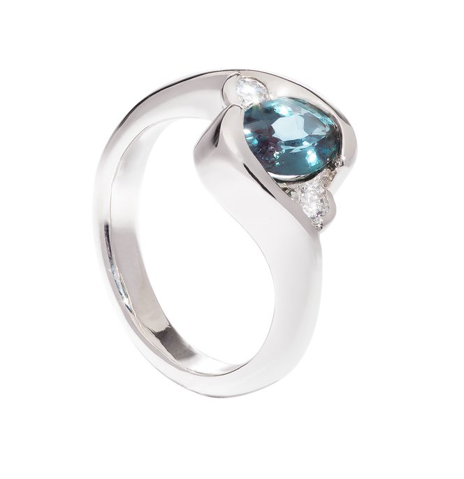

When Formlabs co-founder, Max Lobovsky, was looking to propose to his fiancée Nadia, he knew that he wanted to give her something special. He took inspiration from Alexandrite, a stone known for its color-changing effect. With the special stone in mind, Max set out to find partners to help design and cast a custom engagement ring.
Nadia's engagement ring alexandrite
Looking for the Right Partners
I knew I wanted to use Alexandrite, a unique stone with color-changing properties, in the final ring (because diamonds are boring ;) ), as well as to 3D print the ring with the Form 1+ desktop 3D printer and have it cast. After talking to several jewelers in Boston, I found Ed Spencer at Skylight Jewelers who knew a lot about unusual stones, and was happy to work with the stereolithography printed ring.
unique engagement ring color changing
After we found the perfect stone, I looked at some of his designs and we discussed what the ring would look like. He took some wax patterns of other designs he had in his shop and modified one to look like what I wanted right in front of me in a few minutes, after which I then asked him if he could get me a 3D model of the ring. As my CAD experience is more mechanical, I asked a few other people to model some versions including Martin Galese, who is our lawyer at Formlabs, and Jay Bradshaw, a freelance CAD designer who created the final design.
Unique engagement ring in PreForm software
The Investment Casting Process
Through this process, I printed out several versions of the ring. When I was happy with it, I took a print to Ed Spencer who had the ring cast. Ed said the cast polished just as easily as any other printed one he has used.
