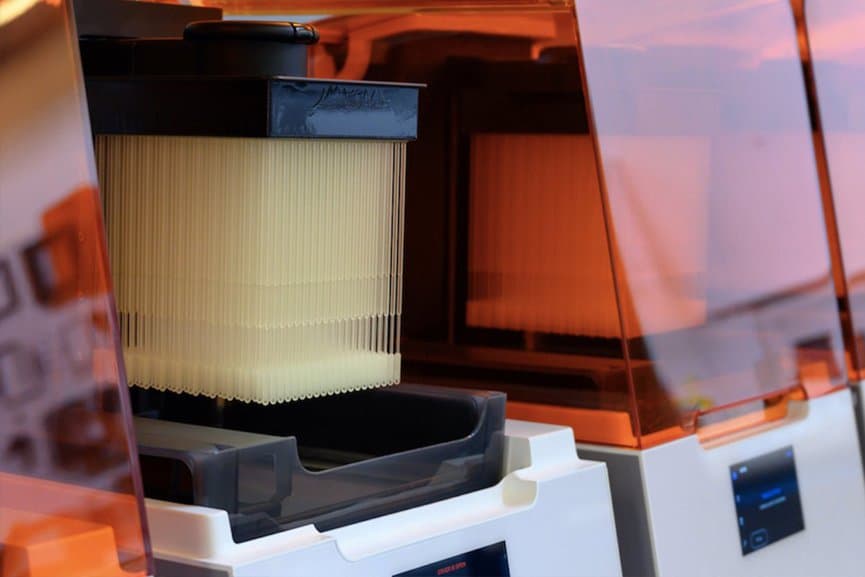

At the onset of the COVID-19 pandemic, nasal swabs for testing COVID-19 were identified as being in high demand and extremely limited in supply. A team from the USF Health’s 3D Clinical Applications Division created an initial design, working with Northwell Health and collaborating with Formlabs to develop prototypes and secure materials for a 3D printed alternative. Before long, the design was available for 3D printing, with Formlabs printers able to create 324 swabs per print. But prior to the pandemic (PreForm 3.4), printing hundreds of identical parts was not a common use case. At that time, loading and analyzing the printability of the scene took about 80 seconds (~17 CPU-minutes) on a 2.4 GHz 8-Core Intel Core i9.
