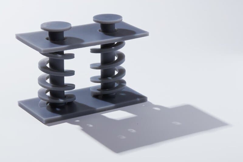

Tough 1500 Resin produces stiff and pliable parts that bend and spring back quickly under cyclic loading. This material is ideal for functional prototypes, connectors, as well as jigs and fixtures undergoing temporary deflection. It also simulates polypropylene parts in terms of stiffness and strength.

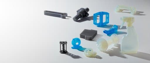

Tough and Durable Resins are ideal for:
  • Housings and enclosures, such as electrical housings, bottles, and packaging
  • Jigs and fixtures, such as non-marring grips, drill guides, and locators
  • Connectors, such as snap fits, press fits, hinges, threads, and joints
  • Prototypes undergoing wear and tear, such as consumer goods, tools, and assemblies

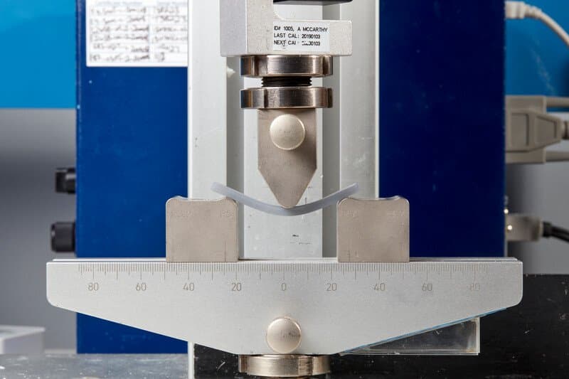

Q: How does Tough 1500 react under stress?
Due to its balance of elongation and modulus, Tough 1500 Resin is ideal for parts that bend, but require high memory retention. When pushed to normal stress limits, parts made from Tough 1500 will strain and spring back to its original shape when that stress is relieved. When pushed to its stress limit, parts made from Tough 1500 will strain significantly before permanently deforming and ultimately breaking.
Bending Tough 1500 under stress
