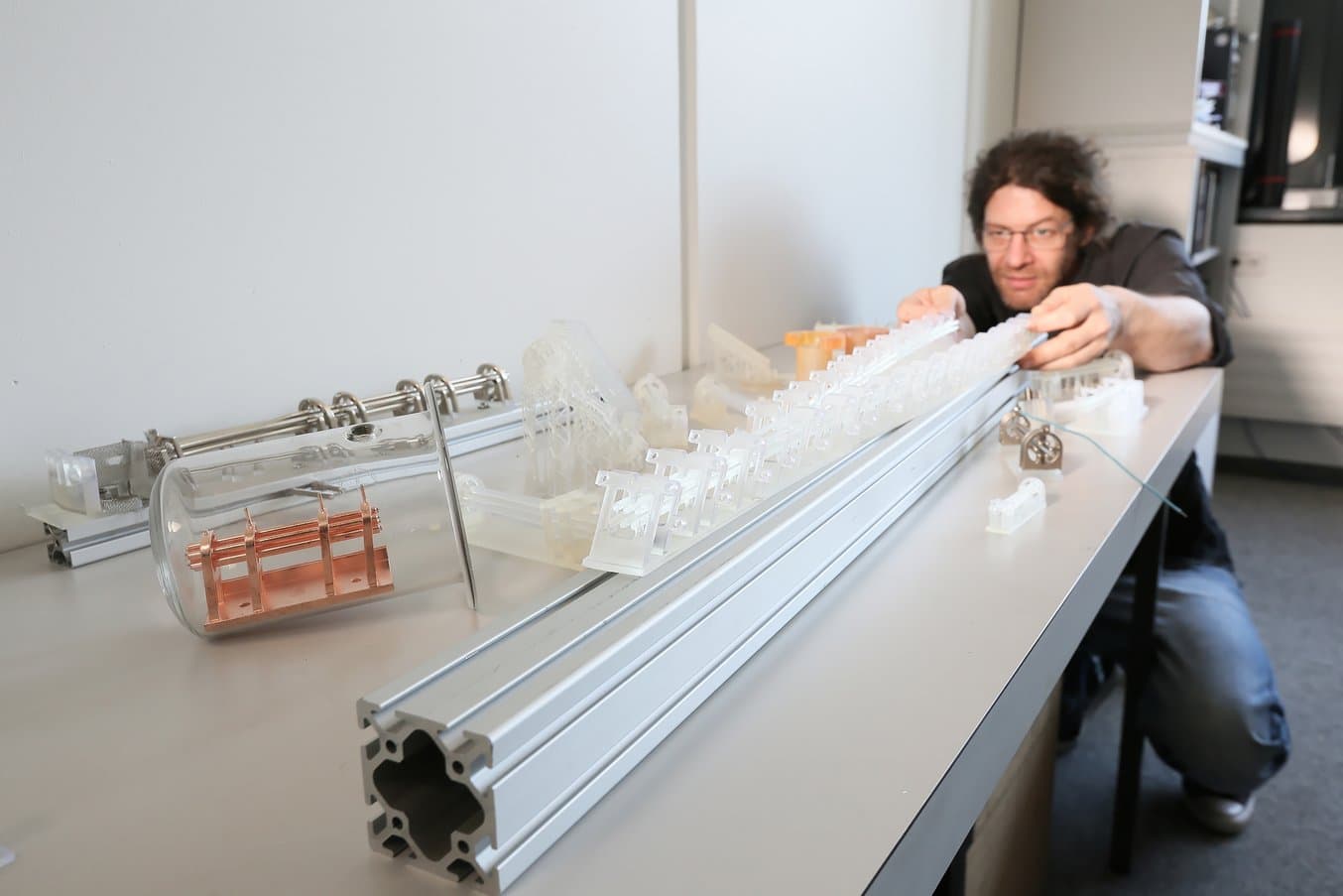

Andreas Osterwalder calls his office a museum: what looks like a collection of small machines are 3D printed and partially electroplated parts that the scientist has been creating for his experiments at the Swiss Federal Institute of Technology in Lausanne (EPFL).
Experimental setups like Osterwalder’s beamsplitter function as highly complex machines, and turning a research idea into the actual experiment can easily take months or even years. A common bottleneck is the actual fabrication of specific customized components.
With the help of a electroplating company specialized in rapid prototyping parts, Osterwalder has found a method to expedite and lower the cost of advanced experimental setups using 3D printing and electroplating.
![Osterwalder’s office, including his “museum” of 3D printed, partially electroplated parts and his beam splitter.](/_next/image/?url=https%3A%2F%2Fformlabs-media.formlabs.com%2Ffiler_public_thumbnails%2Ffiler_public%2Ffb%2F74%2Ffb74a07d-b2e4-4efd-a182-421f77d1d37b%2Fimg_1589_dxo.jpg__1354x0_q85_subsampling-2.jpg&w=3840&q=75)

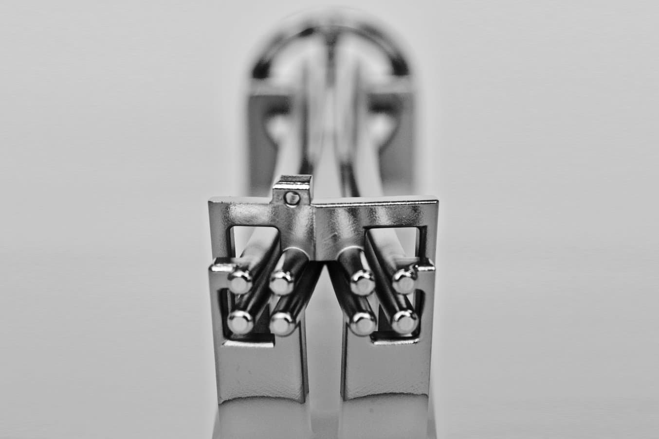

Osterwalder’s 3D printed and electroplated beam splitter allows him to split a stream of gas-phase molecules into two streams without touching the molecules. The metal structure is used to produce strong electric fields by applying voltages on the order of 10,000 volts. These fields then generate a force on the molecules. Similar devices are simple to construct for light–for example, a partially reflecting window–but are much harder to achieve for molecules.
![The above illustration shows Osterwalder’s beam splitter, an electrode structure of 35 cm length, printed in three segments of 15 cm, 10 cm, and 10 cm at a 0.025 mm resolution.](/_next/image/?url=https%3A%2F%2Fformlabs-media.formlabs.com%2Ffiler_public_thumbnails%2Ffiler_public%2Fc7%2Fb0%2Fc7b08f3f-c756-4761-a4dc-acb658ad6246%2Fgordon_fig1.jpg__1354x0_q85_subsampling-2.jpg&w=3840&q=75)
Using 3D printing and electroplating, Osterwalder could reduce the production time of this experimental setup from several months to under one week. Osterwalder needed a few days to design the beam splitter and only 36 hours for 3D printing in his own lab. Electroplating the structure in nickel took just one more day. In the end, shipping the 3D printed parts back and forth from the electroplating company took longer than anything else in the process.

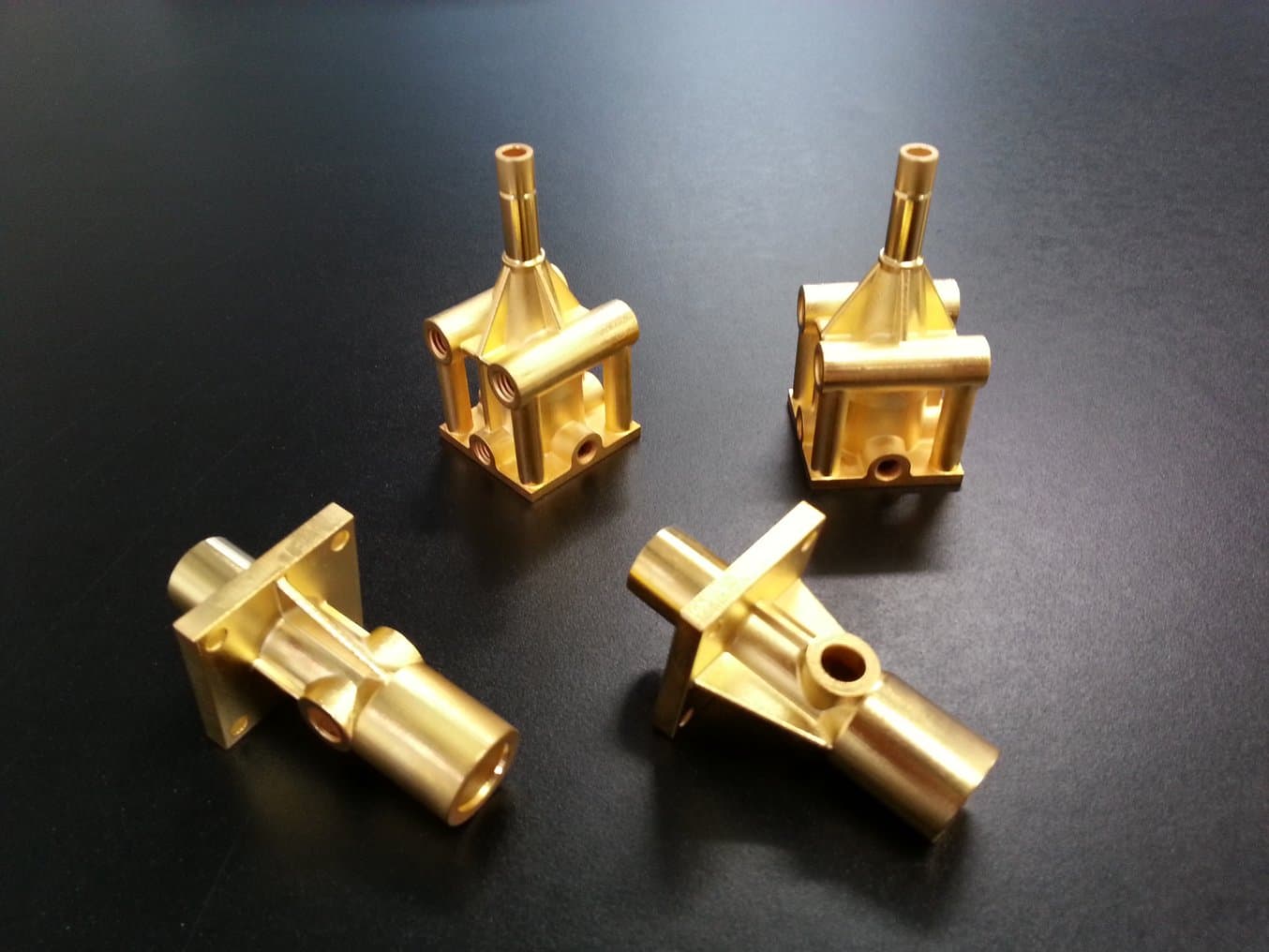

![3D printed parts in gold, electroplated by the Swiss company Galvotec, one of few in the world specializing in metal coating for rapid prototyping.](/_next/image/?url=https%3A%2F%2Fformlabs-media.formlabs.com%2Ffiler_public_thumbnails%2Ffiler_public%2Fbf%2F43%2Fbf438655-37e8-4de7-b368-ba6d51765255%2F20131025_132357.jpg__1354x0_q85_subsampling-2.jpg&w=3840&q=75)
3D printed parts in gold, electroplated by the Swiss company Galvotec, one of few in the world specializing in metal coating for rapid prototyping. Electroplating is used to improve appearance and material properties such as strength and electrical conductivity.
According to Schuhmacher, electroplating can extensively broaden the range of applications for 3D printing. Material properties that electroplating can achieve for 3D printed parts go from being electrically conductive, magnetic, or electromagnetic to having higher wear resistance and dimensional stability. In addition, there is an entire palette of decorative coating, such as gold.

![Osterwalder found the high quality surface of the 3D printed and electroplated beam splitter to be better than machined and polished devices of the same kind.](/_next/image/?url=https%3A%2F%2Fformlabs-media.formlabs.com%2Ffiler_public_thumbnails%2Ffiler_public%2F40%2F5c%2F405cc071-3bea-4bbf-b5e7-4e29935307d8%2Fbeamsplitter.jpg__1354x0_q85_subsampling-2.jpg&w=3840&q=75)
