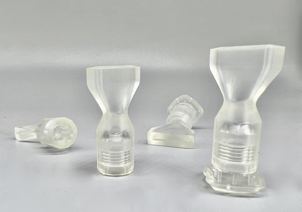

![The nozzle, made of Clear Resin, with the integrated thread (on the right, still as printed with support structures).](/_next/image/?url=https%3A%2F%2Fformlabs-media.formlabs.com%2Ffiler_public_thumbnails%2Ffiler_public%2F0f%2Fee%2F0fee5f5a-f6f6-4a24-be53-b6c2cd40ebde%2Fimage5.jpg__1354x0_q85_subsampling-2.jpg&w=3840&q=75)
A special requirement was for this nozzle to be treated as a consumable. The 3D printed nozzle is a cost-effective alternative to a manufacturing aid that would otherwise be produced with a conventional process like machining or injection molding. The nozzle is produced with SLA 3D printing using Clear Resin, which meets the necessary quality and accuracy requirements for the tool. This solution enables Lufthansa Technik to replace the nozzle on a daily basis for an optimal production process.

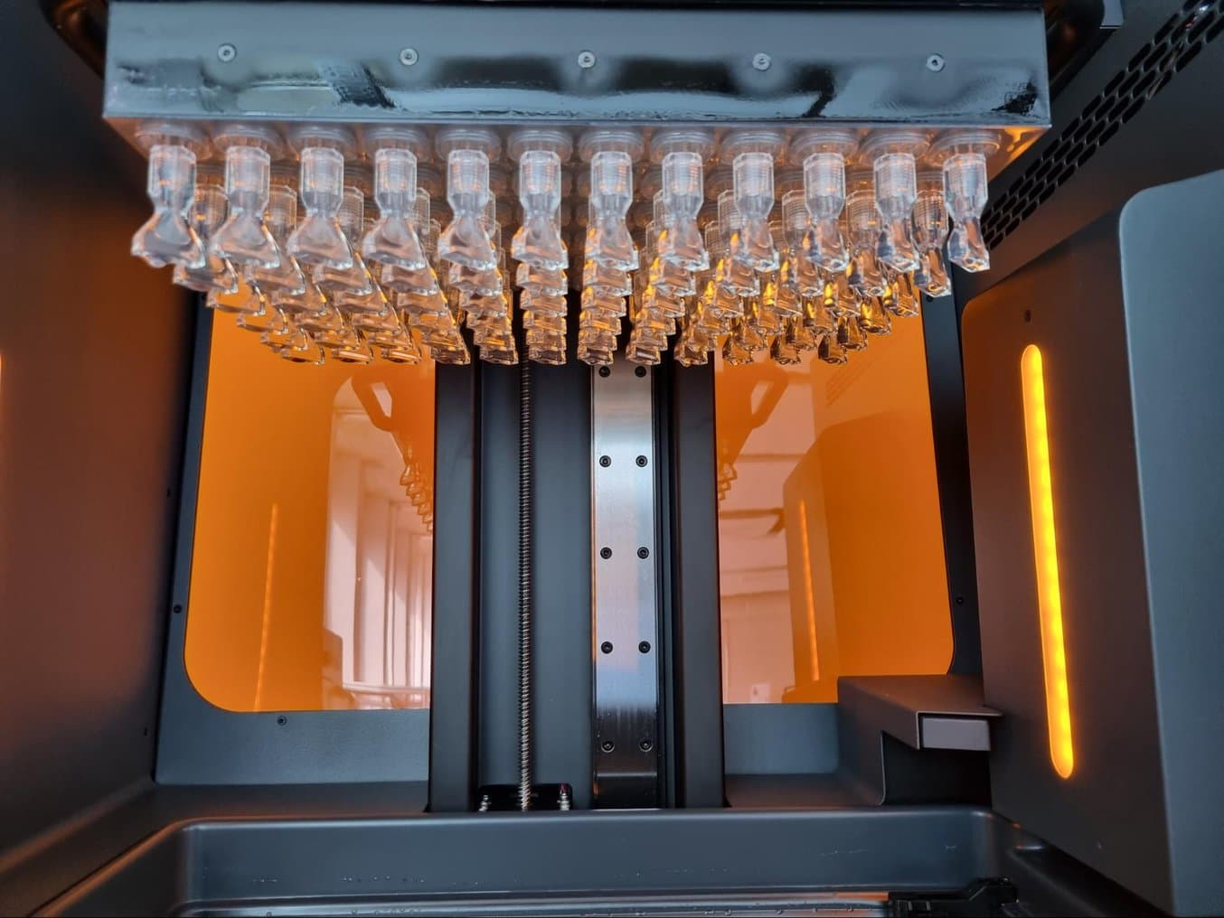

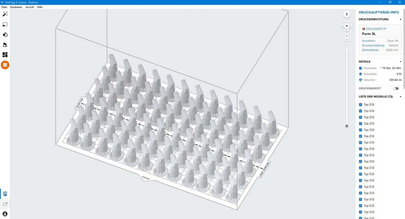

This production tool was printed on the large-format Form 3L in cooperation with Formlabs partner myprintoo. The large area of the build platform in the Form 3L allowed 72 nozzles to be produced in a single print run. In comparison, on the smaller version of the Formlabs SLA 3D printer, the Form 3+ would be able to print 25 nozzles in one build. The Form 3L saved a lot of time in the production of the application without sacrificing the printing accuracy of the nozzle.
![72 nozzles produced on the Form 3L with a print time of 19.5 hours.](/_next/image/?url=https%3A%2F%2Fformlabs-media.formlabs.com%2Ffiler_public_thumbnails%2Ffiler_public%2Fd6%2F5d%2Fd65d5881-1dab-49a6-962f-61a21f07b75a%2Fimage1.jpg__1354x0_q85_subsampling-2.jpg&w=3840&q=75)
