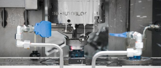

Subtractive manufacturing is an umbrella term for various controlled machining and material removal processes that start with solid blocks, bars, rods of plastic, metal, or other materials that are shaped by removing material through cutting, boring, drilling, and grinding.
These processes are either performed manually or more commonly, driven by computer numerical control (CNC).
In CNC, a virtual model designed in CAD software serves as input for the fabrication tool. Software simulation is combined with user input to generate toolpaths that guide the cutting tool through the part geometry. These instructions tell the machine how to make necessary cuts, channels, holes, and any other features that require material removal, taking into account speed of the cutting tool and feed rate of the material. CNC tools manufacture parts based on this computer-aided manufacturing (CAM) data, with little or no human assistance or interaction.
Subtractive manufacturing processes are typically used to create parts in plastics or metals for prototyping, manufacturing tooling, and end-use parts. They’re ideal for applications that require tight tolerances and geometries that are difficult to mold, cast, or produce with other traditional manufacturing methods.
Subtractive manufacturing offers a variety of material and processing methods. Softer materials are much easier to machine to their desired shape, but will wear more quickly.
