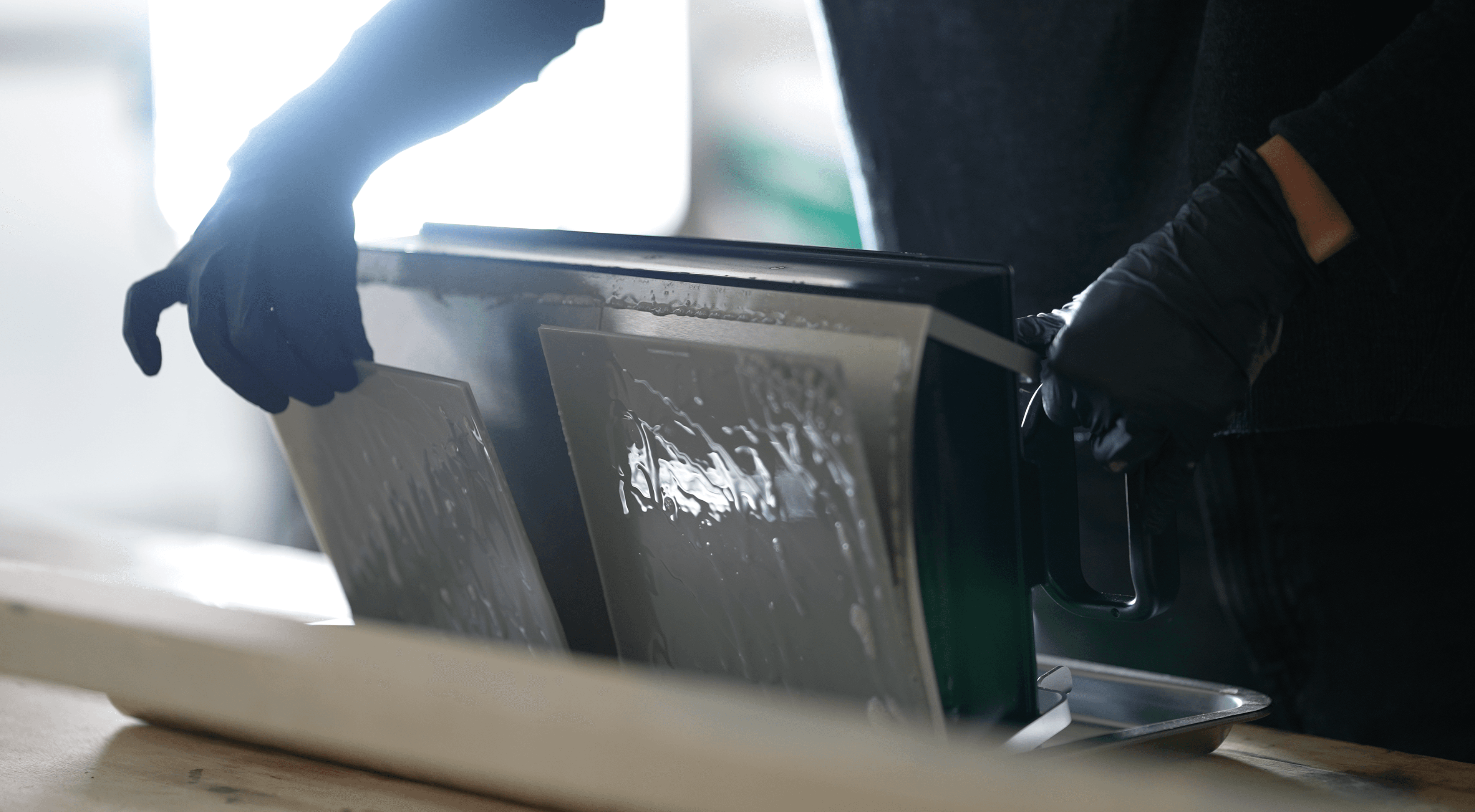

Person wearing gloves inspecting parts on a Form 4L Flex Build Platform.
Tiles are printed on Form 4L in Fast Model Resin. (Image courtesy of the MIC)
Person wearing gloves removing prints from a Form 4L Flex Build Platform.
Form 4L Flex Build Platform makes removing the tiles in seconds easy, and eliminates the need for supports. ((Image courtesy of the MIC)

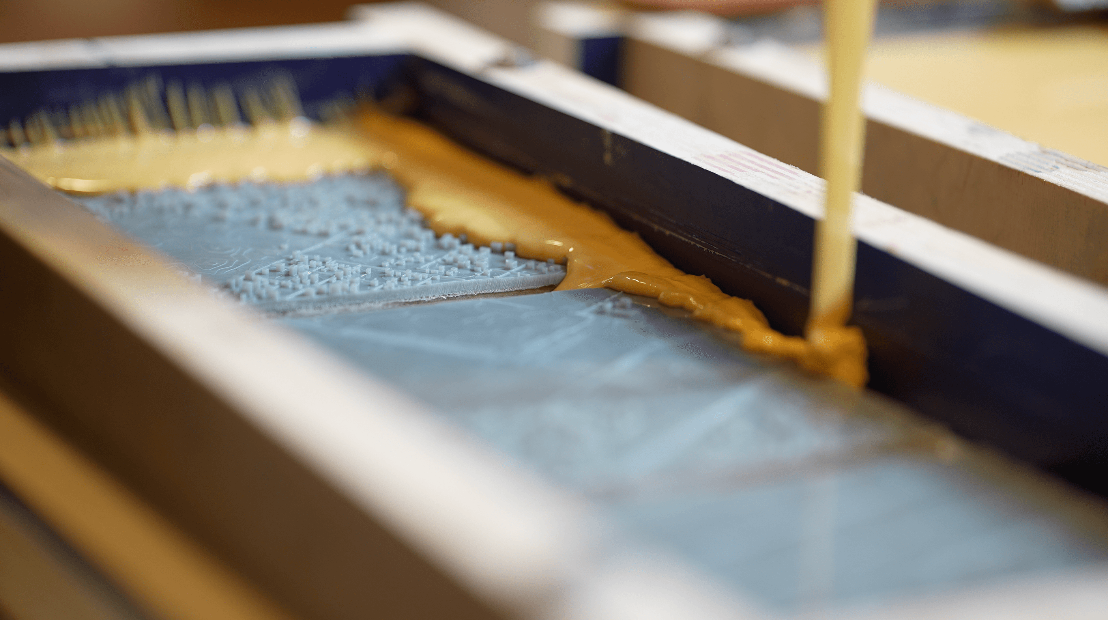

Pouring mold material on top of 3D prints.
Once printed and post-processed, molds are made from the 3D printed tiles. (Image courtesy of the MIC)

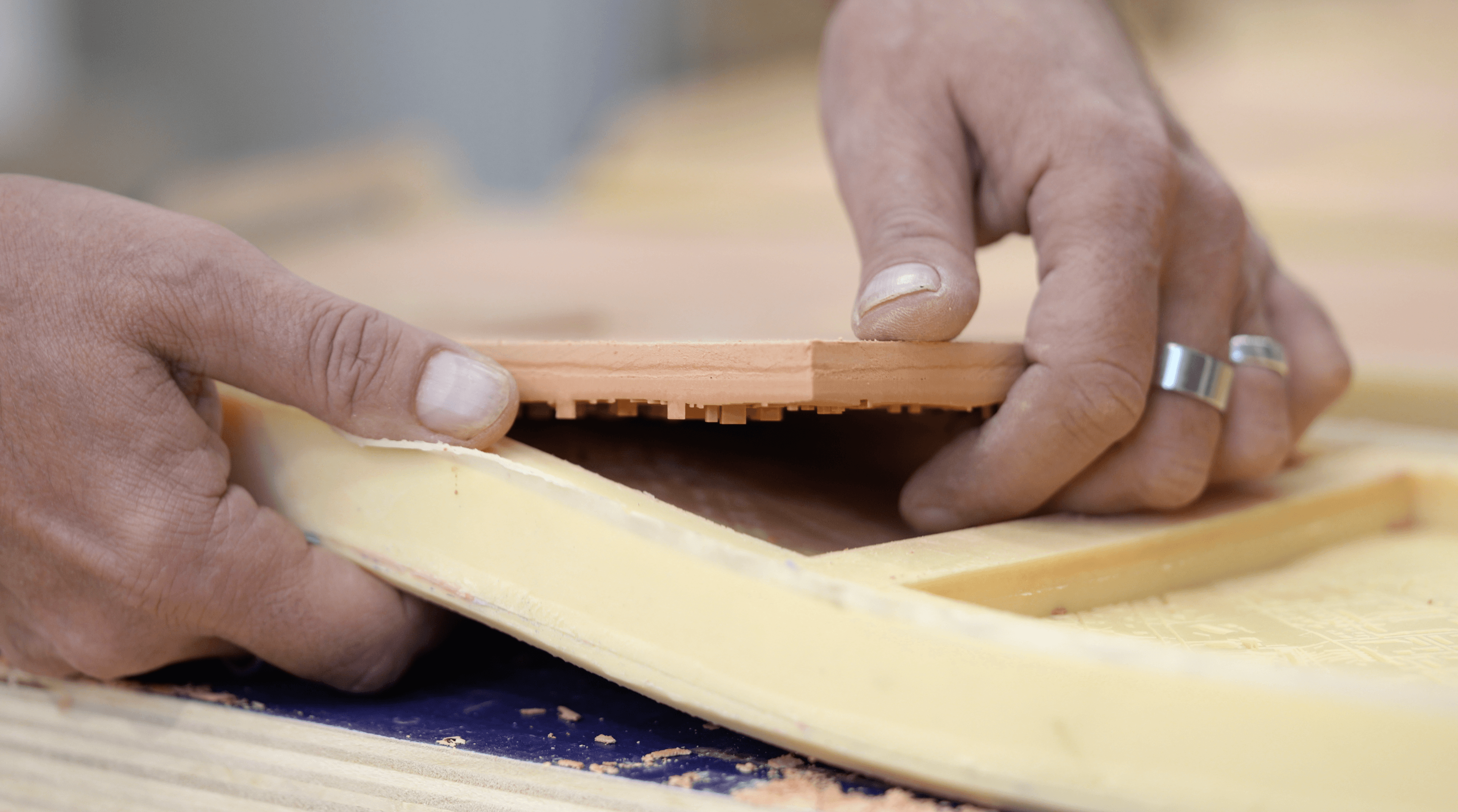

Removing 3D prints from the molds.
After the molds have set, the 3D printed tiles are removed before the terracotta is cast. (Image courtesy of the MIC)

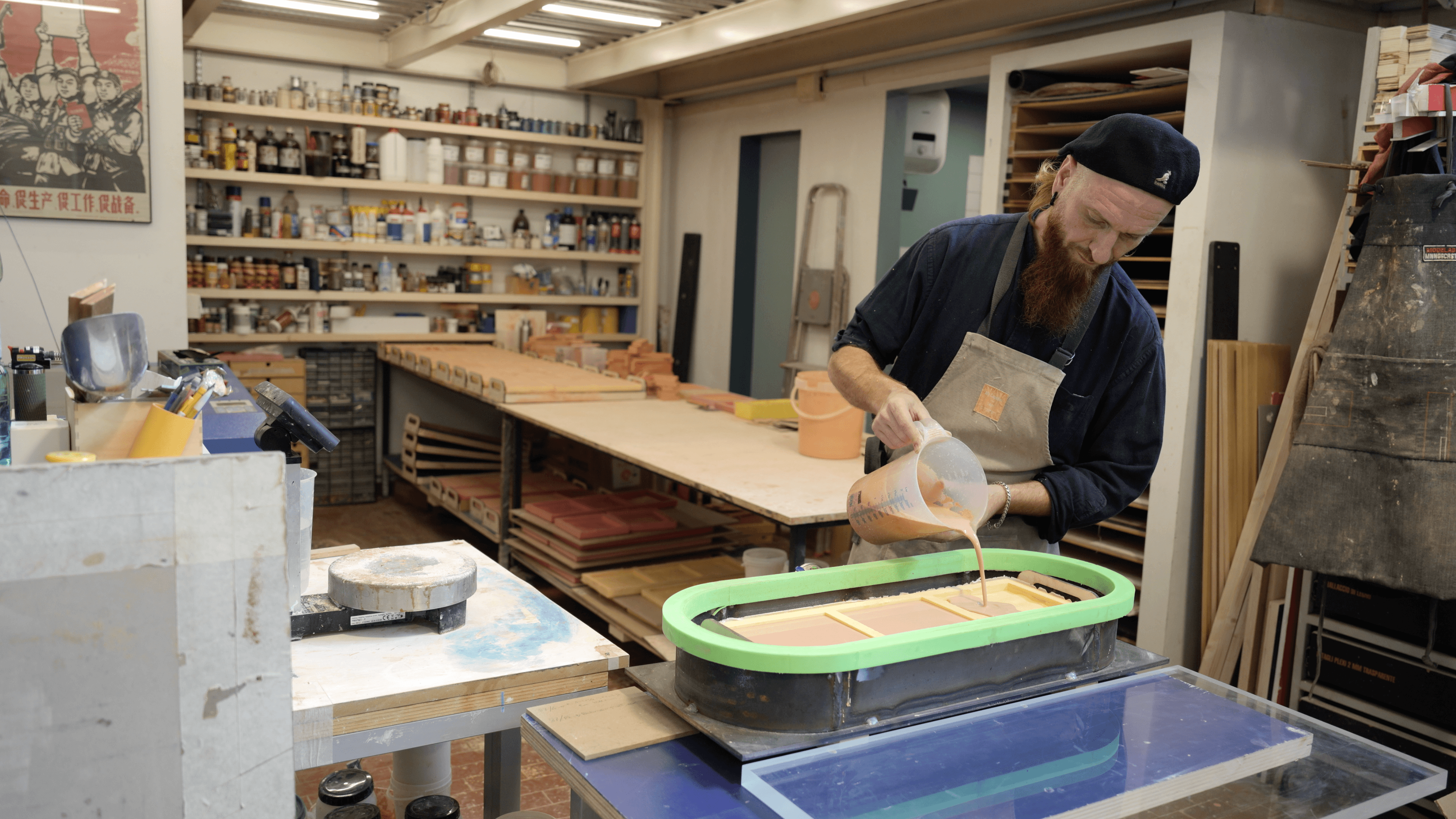

Person pouring slip into a mold.
Slip is poured into the molds. (Image courtesy of the MIC)

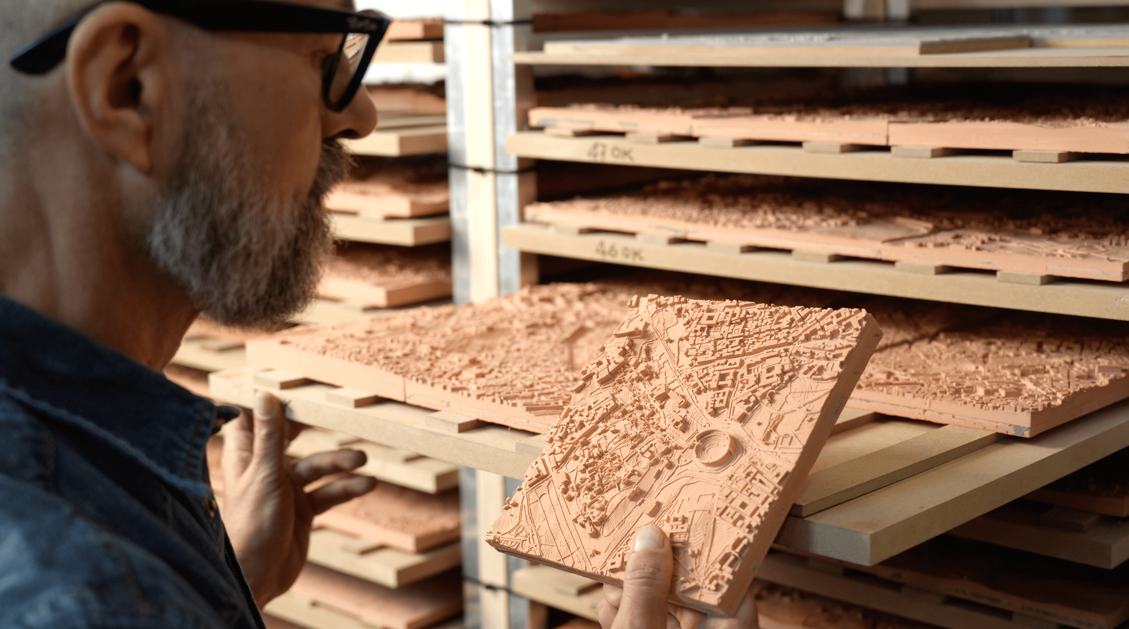

Person removing tile from mold.
Cast tiles are carefully removed. (Image courtesy of the MIC)

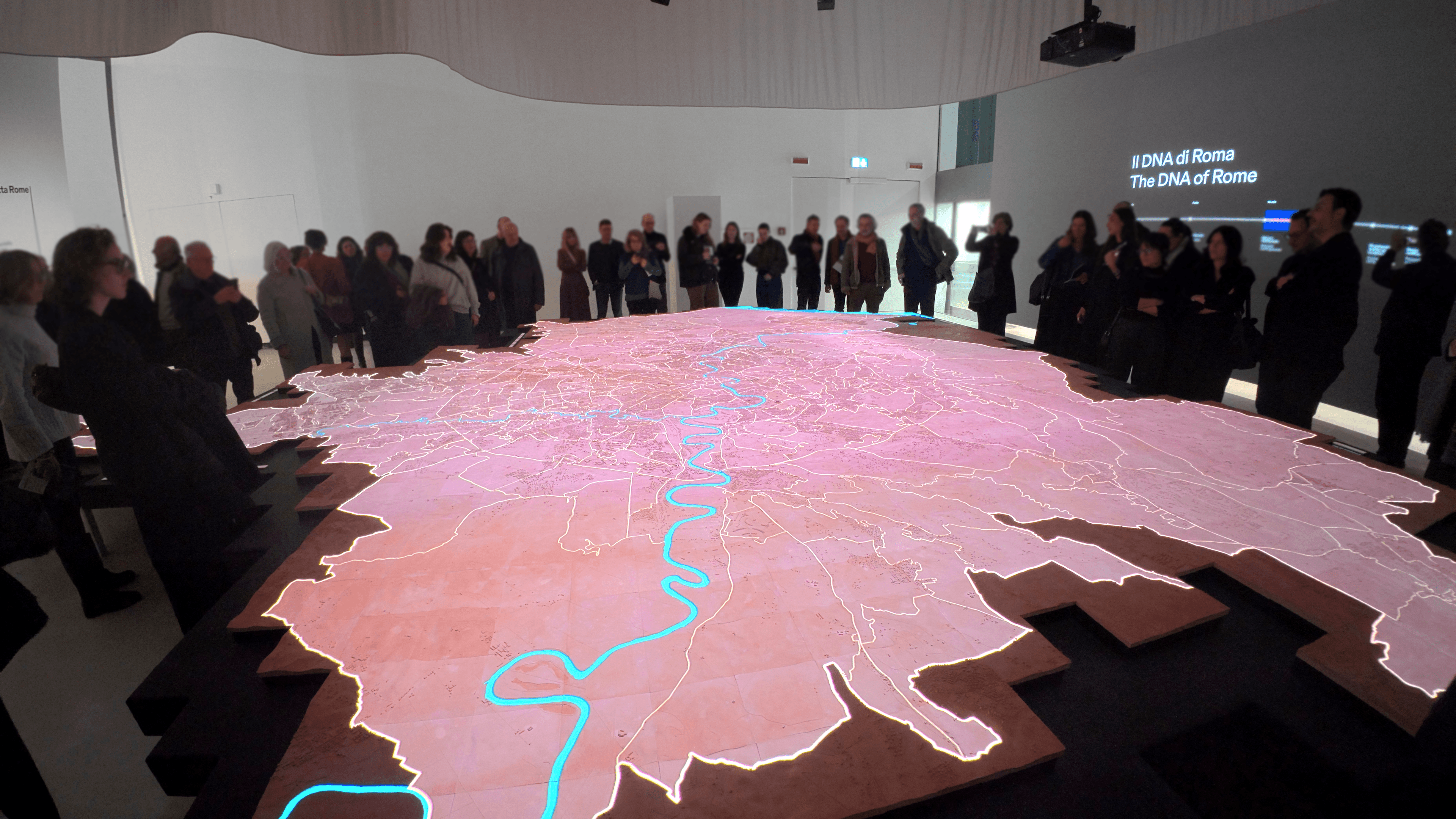

The 48 m2 (~516 ft2) scale model at MAXXI is imposing, commanding the attention of visitors and immersing them in the city. Projected infographics and data on the surface of the map change it, making it a dynamic exhibition and educational tool that conveys the history of Rome in a new way. Pulling off a feat of this detail and scale would not have been possible without 3D printing.
Group of people around map installation with a projected overlay.
Infographics were projected over the map to give more information about the history of the city. (Image courtesy of the MIC)
