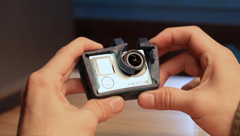

Print the part. Start out by downloading and printing the free mount. You can also use this link to print it on 3D Hubs - a network with hundreds of Formlabs users who can print it for you.
Add the GoPro. Tear off the support material and insert the GoPro into the mount. We tested fit with both the Hero 3 and the Hero 4 - your mileage may vary with other models. Tighten the GoPro with the socket head screw and the hex nuts using the allen wrench.
Attach the Mount. The mounting plate should fit directly against the board, sandwiched between the board and the truck. Tighten down the hardware using the phillips head screw. Add the riser pad to the other truck to balance the board.
Connect the Camera to the Mount. Attach the GoPro mount to the camera case using the GoPro mounting nut. You’ll want to tighten it down with the phillips head screwdriver to keep the mount stiff. With the mount in place, you’re ready to go.
