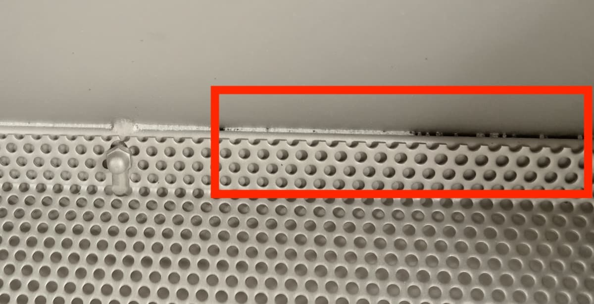

  • The Fuse Blast work surface grate is secured to a chute that leads to the parts catcher. That chute should be sealed tightly against the inner walls of the Fuse Blast. If there are any gaps between the chute and the machine walls, blasting media or waste powder could collect underneath the machine. If you notice a gap, seal it with silicone caulk or another similar material.
