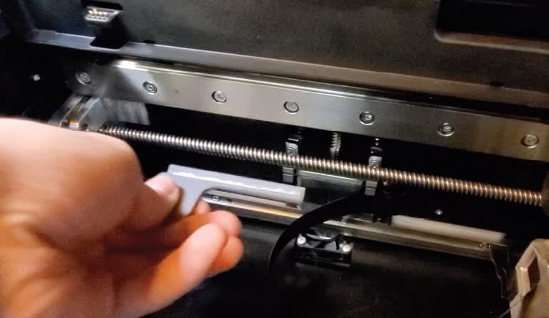

Step 2: Attach the lead screw thread cleaning tool
Seat one half of the lead screw thread cleaning tool on the threads on the left side of the X-axis lead screw. Snap the other half of the tool onto the first half, fully enclosing the lead screw. When installed correctly, the arrow on the tool points to the right. The tool should snap closed without significant resistance and should spin freely on the lead screw.

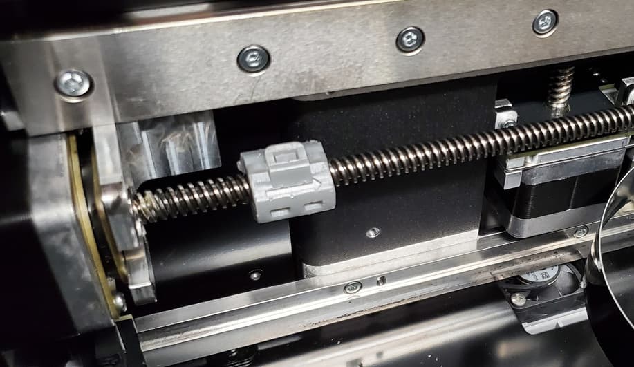

Step 3: Rotate the lead screw thread cleaning tool
Rotate the top of the thread cleaning tool toward the front of the printer. The thread cleaning tool moves along the X-axis lead screw toward the right of the printer. Continue rotating the thread cleaning tool until it reaches the LPU housing at the right end of the X-axis lead screw.
