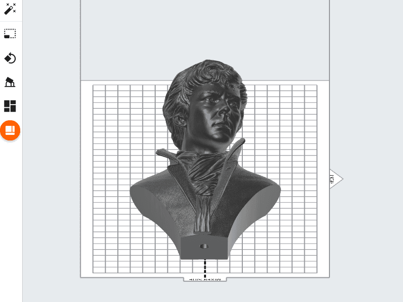

Part orientation
Vertical orientations increase the total number of layers in a print job. By placing a model at a 45° angle instead, you lower the total Print Time. A job with fewer layers does not raise or lower the build platform as often, measure resin level as frequently, as well as decreasing the amount of times that the mixer is sent back and forth across the tank.
Tip:
Avoid extremely vertical orientations to shorten print times, improve surface finish, and reduce warping on thin parts.

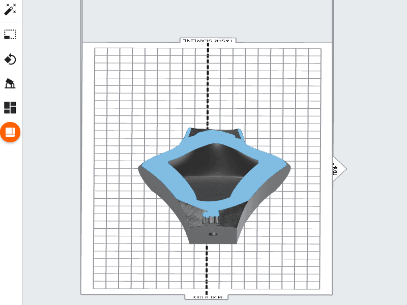

Hollow parts
Before importing a model into PreForm, consider using your preferred CAD software package to hollow out the inside. A hollow model consumes less resin during printing, and decreases Print Time by reducing the amount of lasing needed by the LPUs.
Note:
Large hollow parts require a drainage hole to prevent a cupping blowout print failure.
The Slicer tool is being used on a model within PreForm to display the hollow inside.

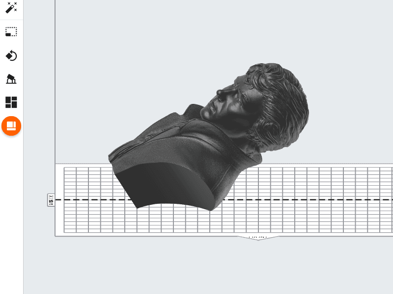

Layout
Placing a model so that the seamline effectively cuts the model in half makes the best use of the two LPUs on a Form 3L/Form 3BL. The seamline indicates the line where one LPU's work ends and the other begins. By placing a model across this division, they work in tandem to split the load between them.
A model has been placed on the seamline within PreForm.
