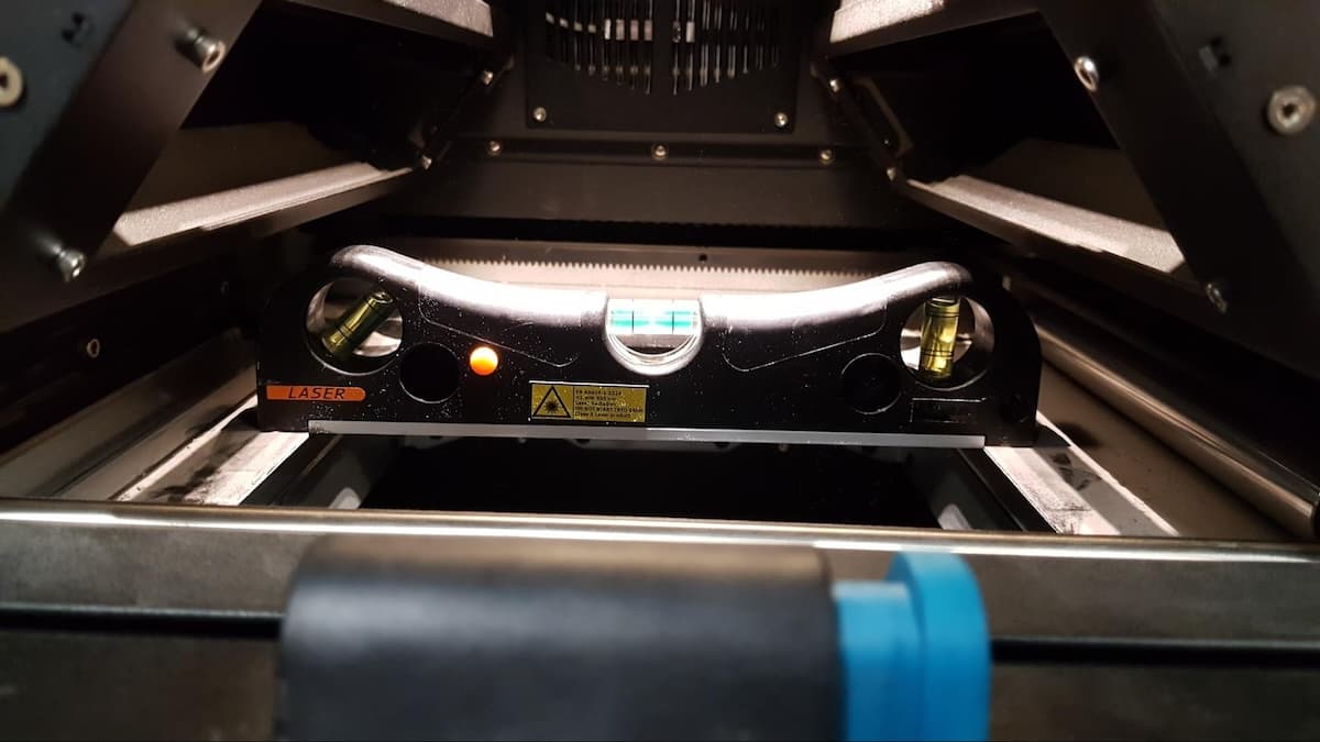

    1. Use a spirit level, bubble level, or a level app on your smartphone.
    2. Place the level on the powder handling assembly.
    3. Check that the printer is level in both the X and Y axes (front-to-back and side-to-side).
    4. If the printer is not completely level, follow the steps for leveling in the support article Unboxing and setting up the Fuse 1.

Using a spirit level to level a Fuse 1 generation printer
