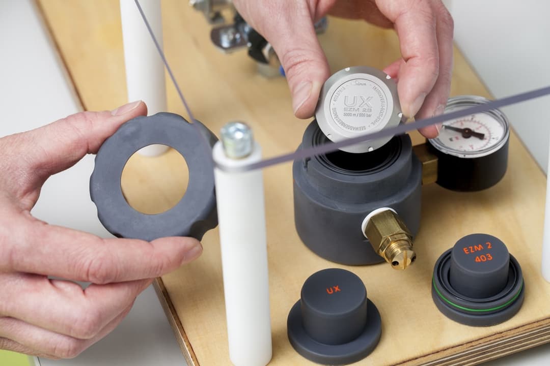

3D printed, prototype watch parts, fixtures, and testing equipment produced using the Form 3.
After purchasing their first 3D printer, Sinn’s team quickly discovered other valuable use cases for the machine beyond prototyping. The Form 3’s versatility and consistency in producing high-quality prints lend itself to different applications throughout product development and production.
Read our next article to learn how the company leveraged 3D printing for producing manufacturing tools, such as mounts, fixtures, and testing equipment.
