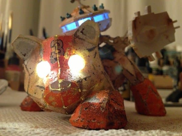

First, all parts are sanded and testing for fittings:
Next I mask the eyes with model tape and begin by airbrushing a basic gray paint primer, adding blotches of dark red rust areas. I paint a few coats of varnish on to help set this layer, and then I paint over the first white colour layer:
After that, I take a small file (and lots of other scraping tools) and scrape away layers of the white colour, paying special attention to the edges. This gives a worn and rusted look of chipped paint:
Next I add the orange accents with some more masking, varnish and scraping:
Then the electronic components are added and tested to make sure everything is working. I wanted the model to seem like a real machine, so here is where the inner workings come into play. Each piece is printed separately and then assembled and fit into the head cavity. After completion, one side of the head is removable, so you can imagine how it would be to service this machine, make upgrades and patch in new software directly to the memory core:
![Electronic components on V.e.r.a.1. models printed on the Form 1 3D printer](https://archive-media.formlabs.com/upload/walkthrough-5.jpg#autosize=2281)
![LED lights in V.e.r.a.1. models printed on the Form 1 3D printer](https://archive-media.formlabs.com/upload/vera1_J.jpeg#autosize=2282)
After that, paint pigments are rubbed into the surface to add to the worn look, as well as faint red and brown washes to break up the solid colouring:
Finally, paint splatters and hand painted rust spots and details are added, including fine touches such as highlights to pop out some specific spots:
In the end I have a collection of models whose subtle differences contribute to a unique look on each piece:
