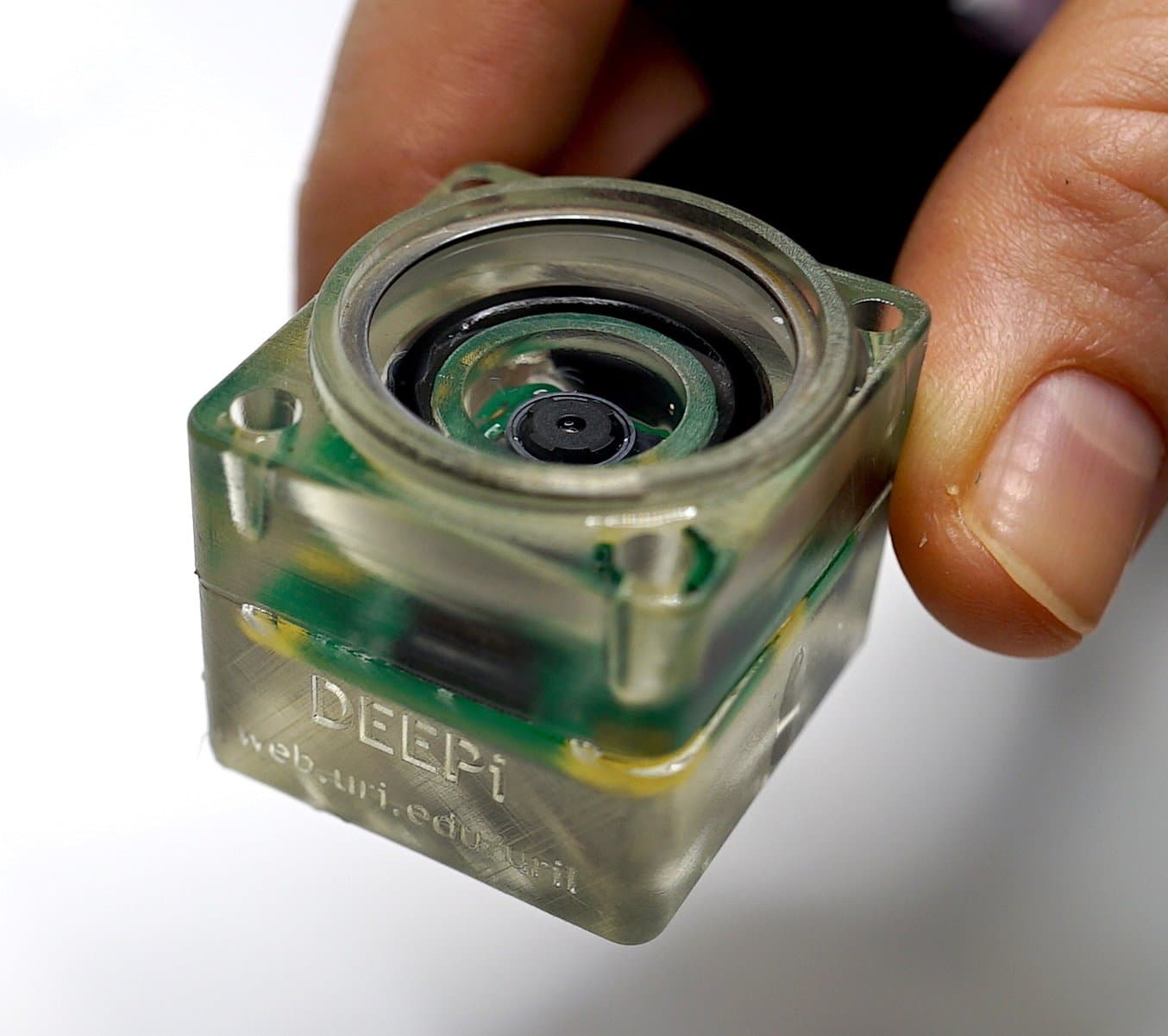

“The challenge that is placed in front of us is, ‘what's the tiniest, cheapest deep-sea camera we could make?’ So now we’ve printed dozens of them in different shapes, and because it’s a printable thing, we can make any shape we want. We can design something quickly, build up the electronics, put it in there, optimize size, and then pour the epoxy,” says Phillips.
3D printing has allowed the lab to thoroughly iterate without worrying about running up the budget, and has introduced more design flexibility than was possible through machining.
The DEEPi camera design uses a hybrid 3D-printed mold and o-ring seal design along with an epoxy-filled volume for the circuit board components and an external clear glass viewport (US Patent #16/920,577) (Image credit: Brennan Phillips).
The lab uses a pressure tank to simulate deep sea environments. Once Phillips and his students settled on the two-part design with epoxy, they put the parts into a pressure chamber, increasing the pressure to simulate a true deep-sea environment. “It was a total experiment and I started sending them down, and it was farther than we ever thought, thousands of meters even,” says Phillips.

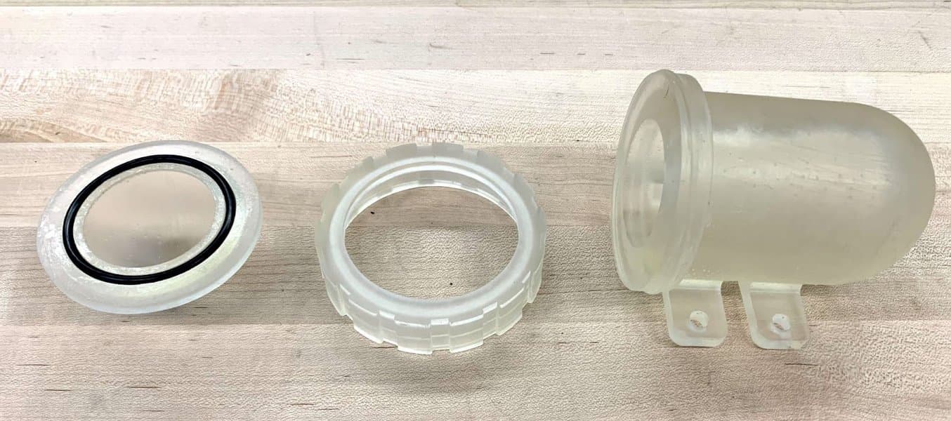

When evaluating different 3D printers, accuracy and material properties were top of the list for Phillips’s lab. The isotropic nature of SLA 3D printed parts means that they aren’t porous, and won’t leak water as fused deposition modeling (FDM) printed parts might. The smooth surface finishes of SLA parts also ensure that functional assemblies like the two-part cylindrical enclosures can fit together without a rough surface causing air gaps. Accuracy and high resolution also contribute to that watertight nature—incredibly tight tolerances and small feature size allow users to print screw threads directly into the material, and Phillips’s lab does this for both the two-part enclosure and the screws that act as further attachment security.
A complete 3D-printed pressure housing assembly capable of protecting electronics from seawater at depths exceeding 1000 meters. The o-ring seals are directly printed into the parts and the enclosure is sealed using a hand-screwed bezel. Photo and design credit: Breanna Motsenbocker
“You need the hundred percent in-fill of SLA parts—with FDM you can maybe get an IP rating out of them, but you can’t sustain it past a couple meters of pressure. Second, you need resolution, so that the O-ring between the two parts makes a complete seal. These parts come right out of the printer, and we maybe sand it a little bit, but then we orient them so the critical surfaces are smooth, and we get perfect seals,” says Phillips. “And the third reason is that the material properties of the SLA materials are way better—there's generally no comparison. They're far better in terms of yield strength. All the modulus' are just better than any other material we’ve found.”

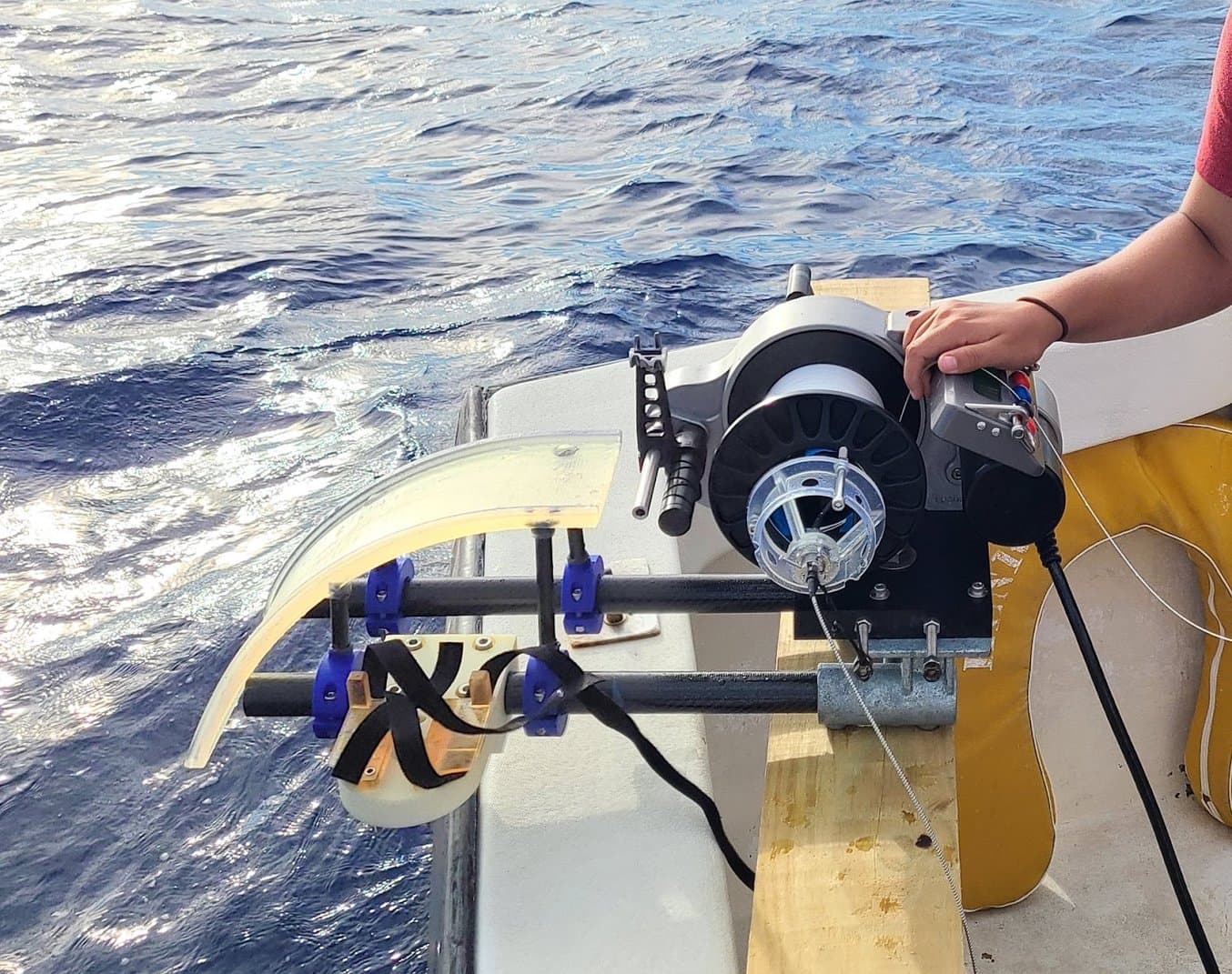

To deploy these enclosures and other monitoring devices underwater, the lab has to use and maintain thousands of feet of thin fiber optic cable. To avoid tangles or knots, they first used repurposed bike wheels to guide the fiber optics over the side of a boat. With a large format SLA printer on hand, however, they were able to prototype designs to reduce the size and improve the performance of this process.
A 3D-printed ‘slide’ helps smoothly guide fiber optic cables over the side of a boat without tangling or breaking them. (Image credit: Brennan Phillips)
“For this fishing line, we don't want to use a turning sheave or a wheel. We needed a slide. So we’ve printed about three or four iterations of this slide. It’s big, it’s nice and smooth, and that smoothness is helpful with the thinner lines,” says Phillips. The slide printed on the Form 3L in Clear Resin reduces the time it takes to carefully stow away the fishing line for reuse, and reduces the number of times they’ll need to replace their equipment.

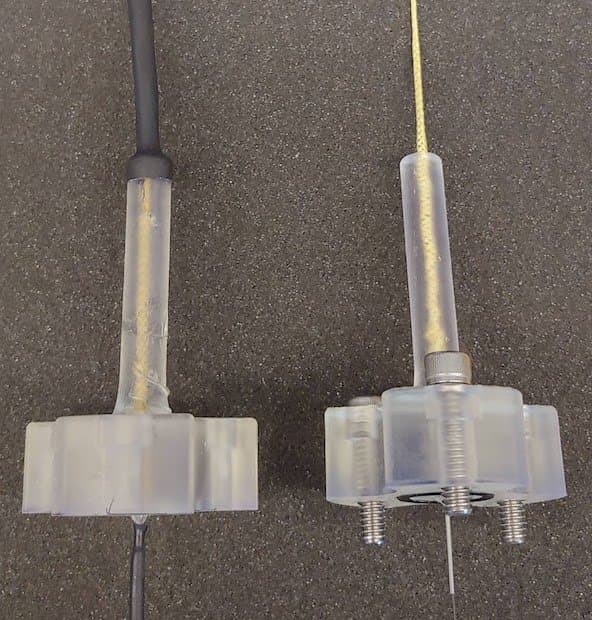

But the fiber optic fishing line wasn’t quite usable on its own—it needed a mechanical termination point so that you could pull on it without breaking the fiber optic core. Because fiber optic cables can’t be knotted or manipulated in the same way as other, more durable lines, the lab had to invent a fixture for the end of the cable.
Using a 3D-printed part with tight tolerances achievable with Formlabs’ high resolution SLA printers, the load-bearing external braids of the fishing line can be separated from the fragile fiber optic core. Using injected epoxy, the braided line adheres to the 3D printed fixture, and the fiber optic passes through into a metal furcation tube, which can connect to the computer to receive the information that the fiber optic is carrying.
SLA-printed parts are used as mechanical terminations for “fiber optic fishing line” or FOFL (US Patent Pending), separating the load-bearing external braid from the delicate fiber optic core. Image credit Brennan Phillips
“This type of attachment is very strong, it’s resistant to at least one hundred pounds. We filed for a patent and we also made it published as open access,” says Phillips. “Without 3D printing, in a normal manufacturing process, these could cost $3,000 or $4,000 each time, and we went through several iterations. I don’t think anyone did this because the path to production was too expensive. It’s the combination of rapid prototyping methods like the Formlabs printers and the new fiber optic line that enables new ideas like this,” says Phillips.
