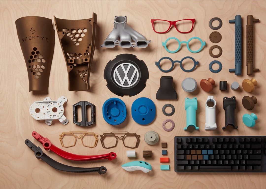

Color and Material Combinations
Color Dyeing White Parts
Dyeing Nylon 12 White Powder is the best option to attain the widest range of colors. Nylon 12 White Powder should be used to dye all light colors, including pastels, and vibrant colors.
Parts 3D printed in Nylon 12 White Powder that were dyed in an ultrasonic dye station.
