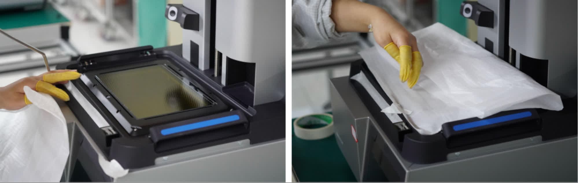

Lift the printer’s cover to access the LPU. Place a lint-free cloth or other similar protective material over the LPU. Make sure the entire surface is covered.

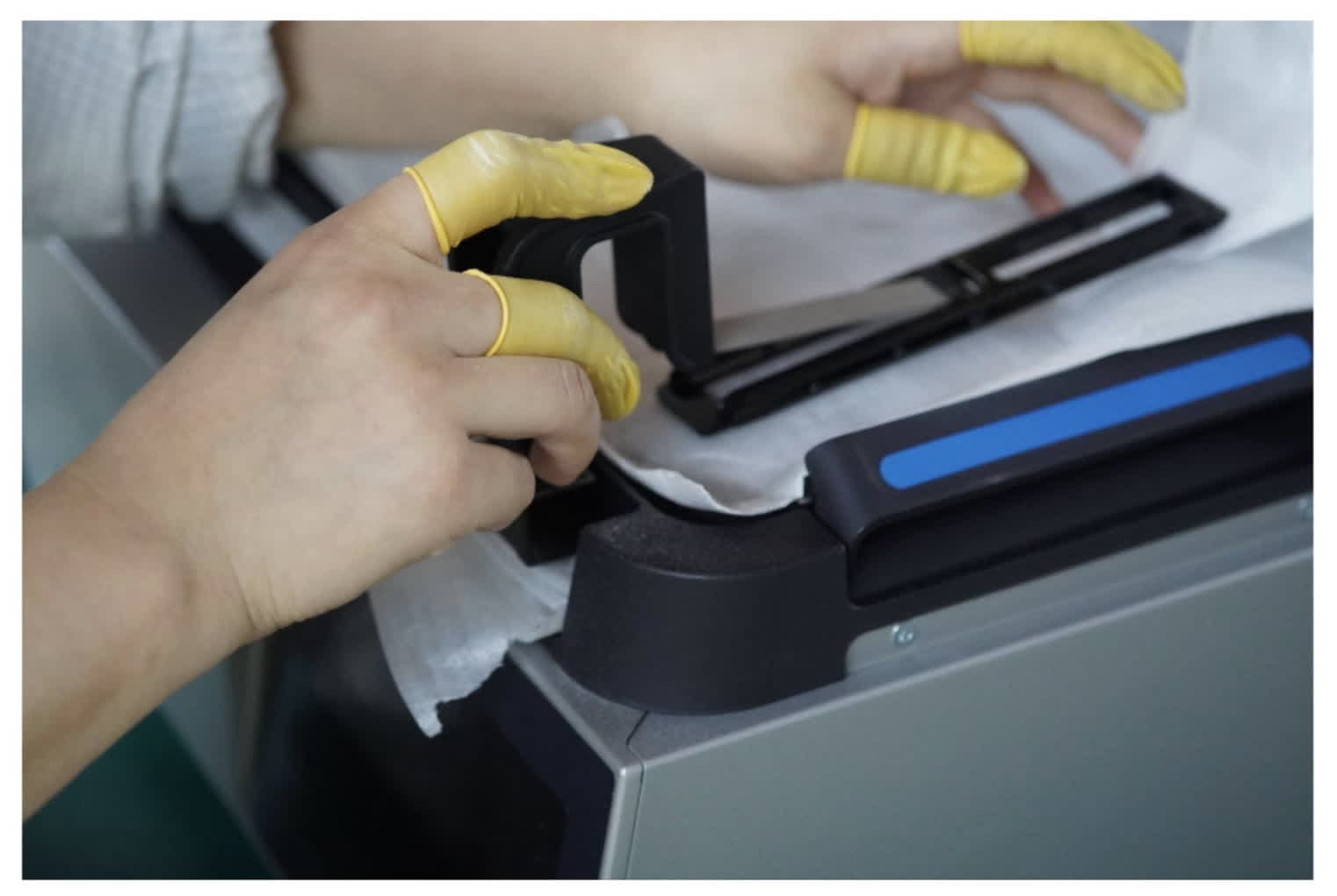

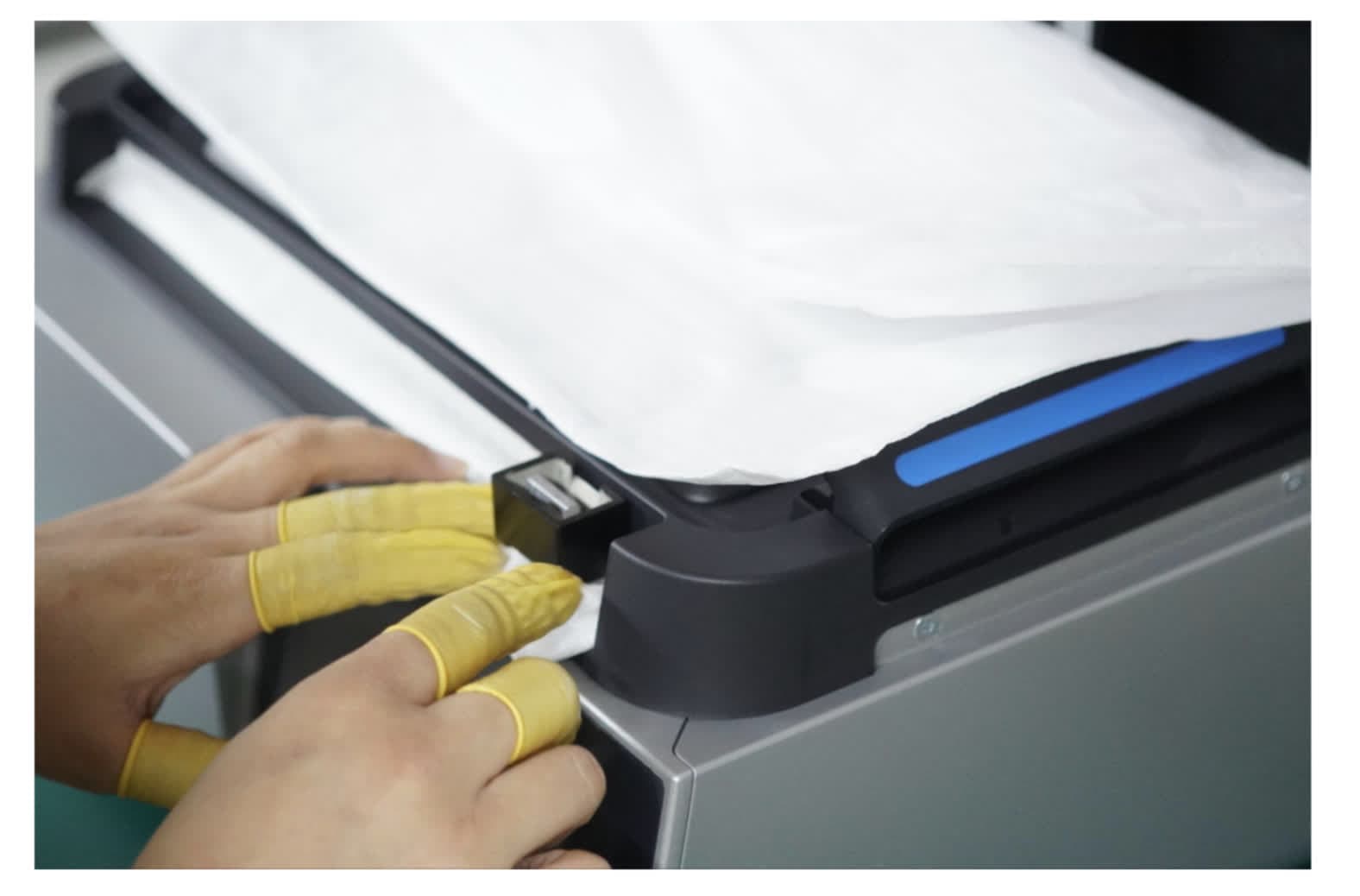

Move the mixer base to the right side of the machine.

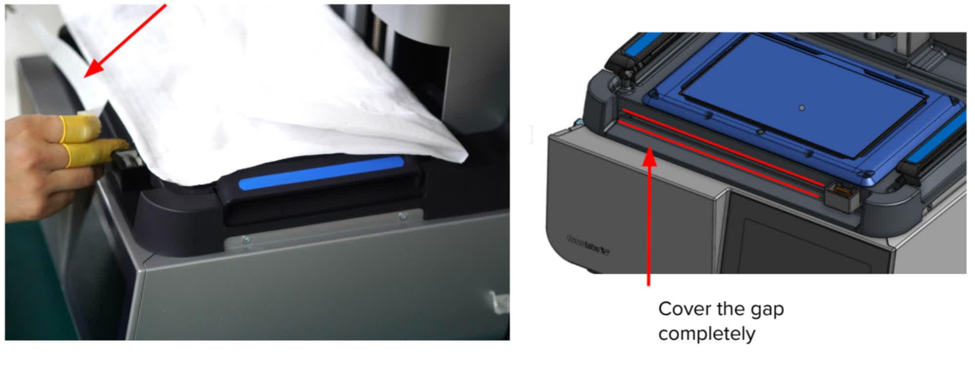

Place a strip of tape on the front of the printer to cover the gap between the LPU and the lip the mixer base rides on. Be sure to cover the gap completely to prevent debris from entering the printer.

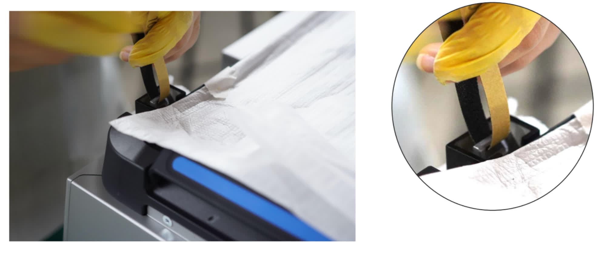

Step 1: Loop sandpaper

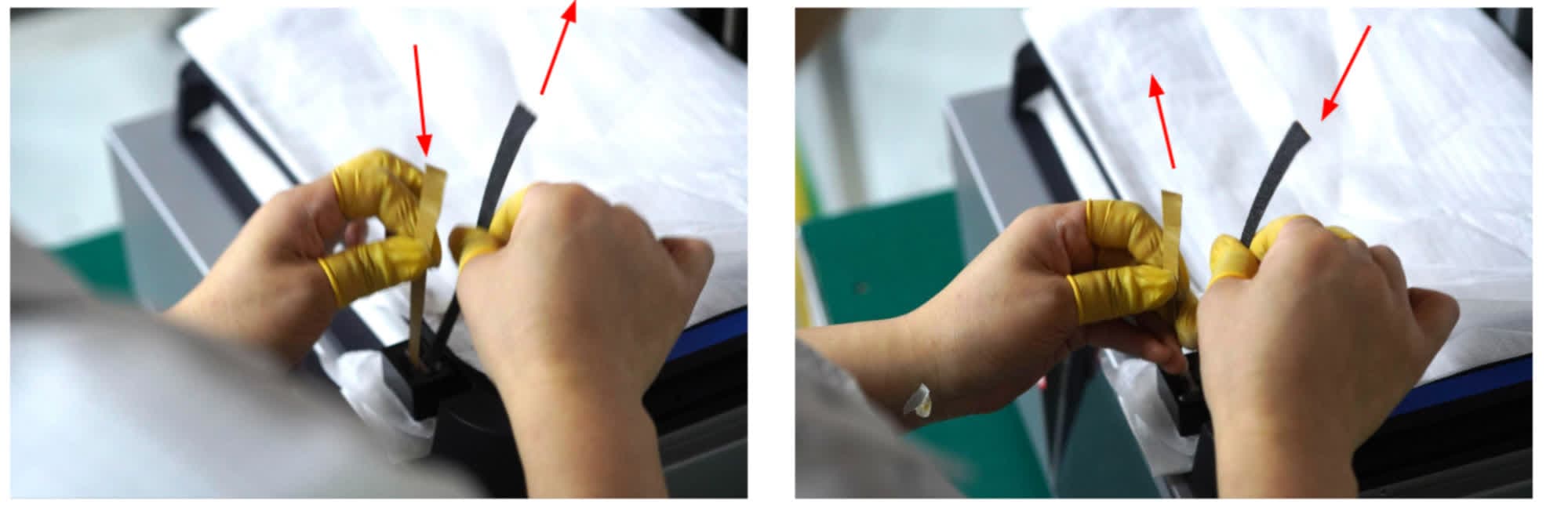

Loop a piece of coarse (80 grit) sandpaper under the latch lock in the mixer base. Formlabs recommends using a strip of sandpaper that measures around 9 mm × 150 mm.
Step 2: Sand the latch lock
Pull gently on both ends of the sandpaper and move the ends quickly up and down. Repeat this motion 60 times, or about 30 seconds. Discard the sandpaper after use.

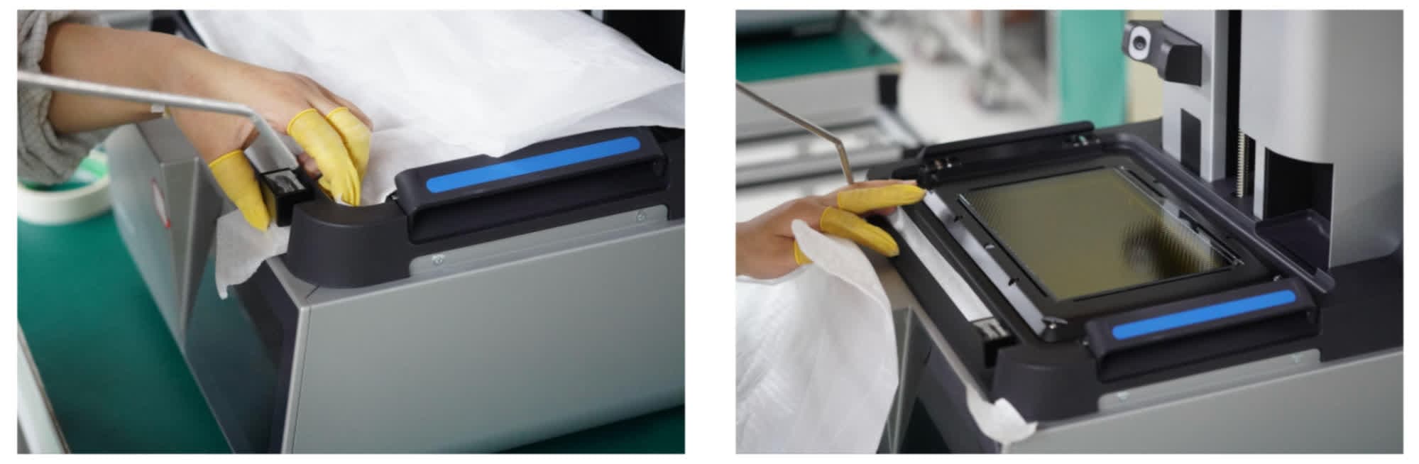

Insert the mixer into the base. Latch and unlatch the mixer.The mixer should latch firmly when installed but still be removable with one hand.
Step 4: Continue sanding (optional)
If there are issues latching the mixer, perform additional sanding. There is little to no risk of oversanding.
