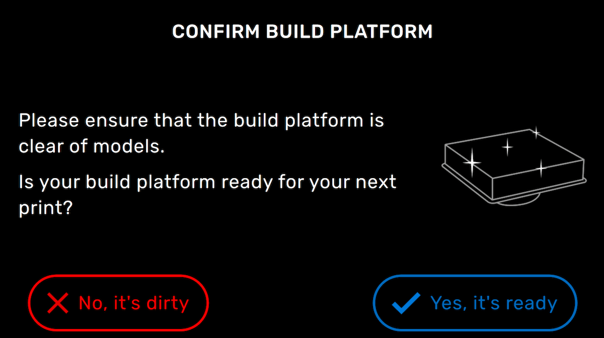

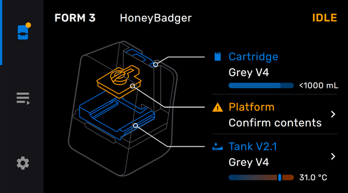

  • If the notification disappears before you confirm the status of the build platform or you have disabled build platform detection, tap Platform on the main printer screen. The Confirm Build Platform screen appears. Tap Yes, it’s ready to confirm that the build platform is ready for a new print.
Idle Form 3 awaiting build platform confirmation
Form 3 showing the Confirm Build Platform screen

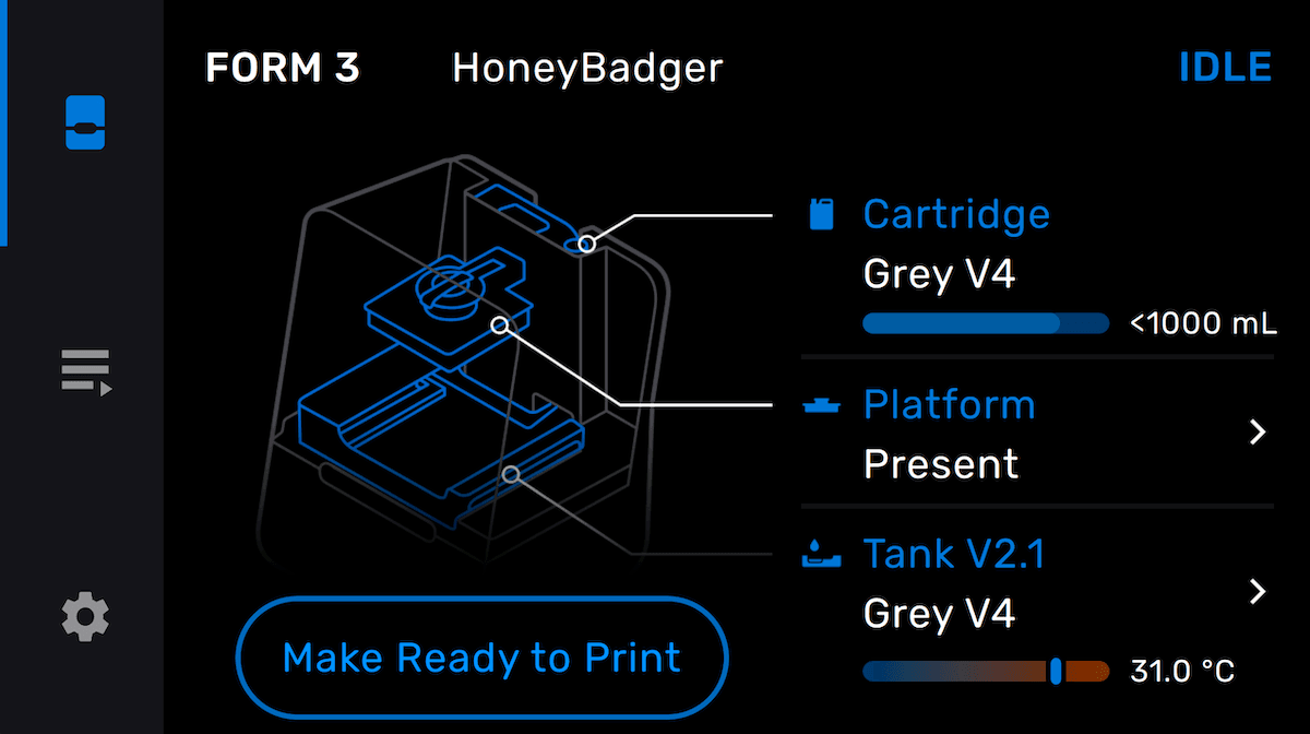

Form 3 showing Make Ready to Print button

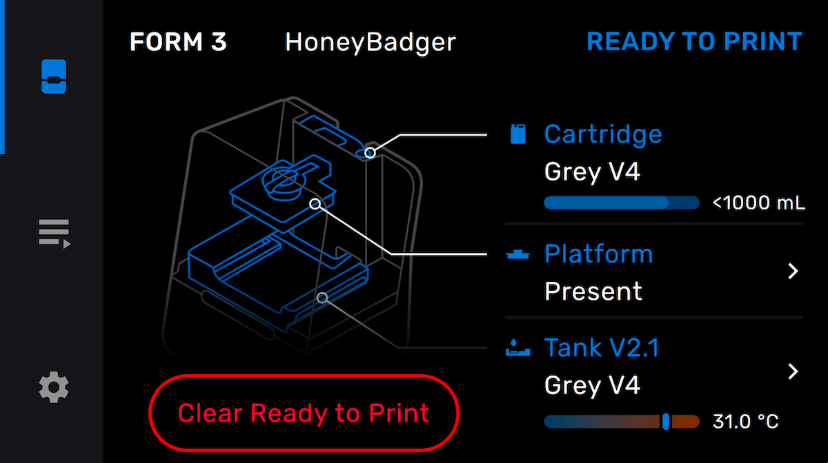

Form 3 showing Clear Ready to Print button

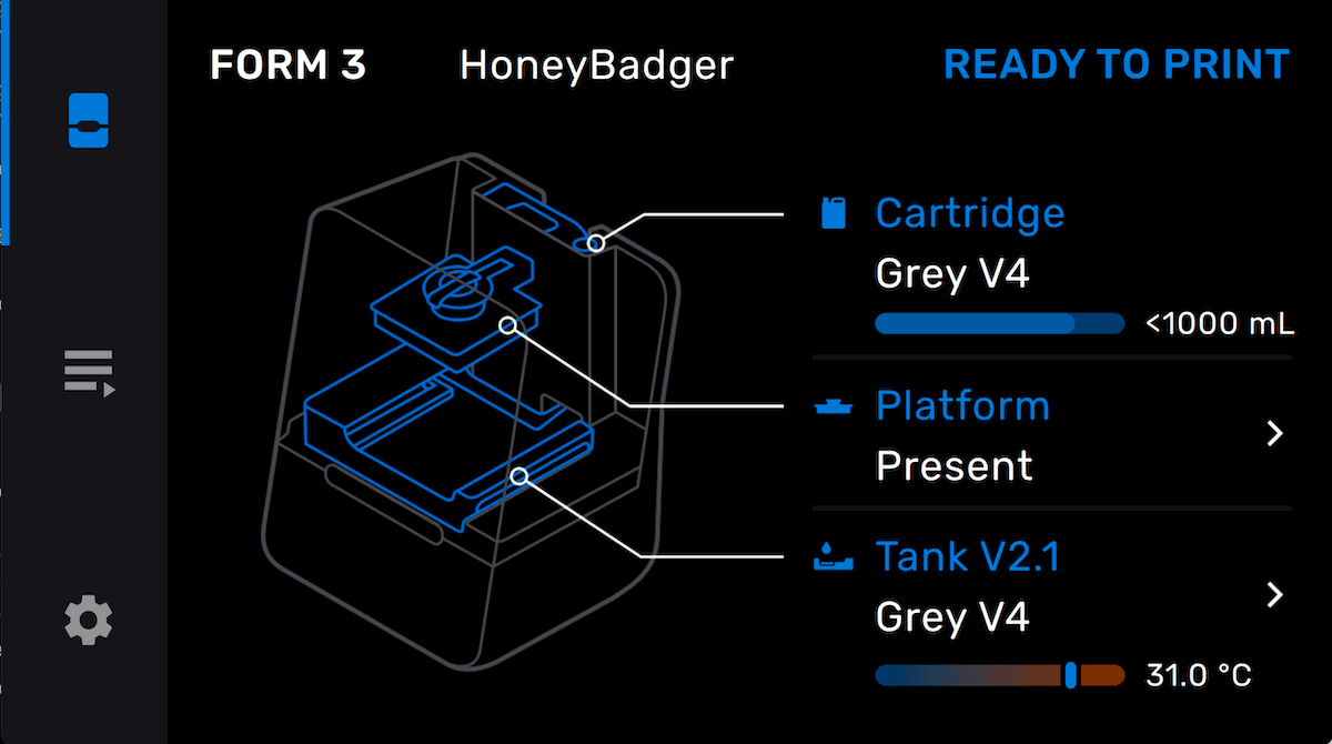

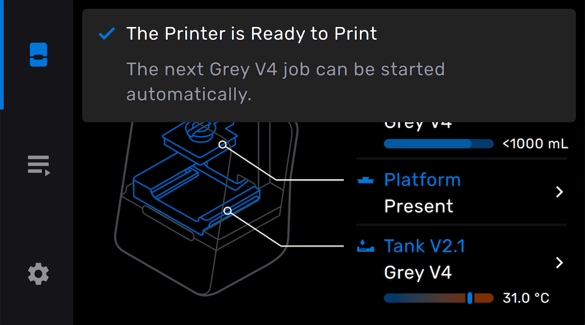

Form 3 showing ready to print notification
Form 3 showing Ready To Print status
  • If you previously disabled Automatic Ready to Print, the Ready button appears. Tap Ready.
  • Once you insert matching consumables and confirm the status of the build platform, the printer displays the message The Printer is Ready to Print.

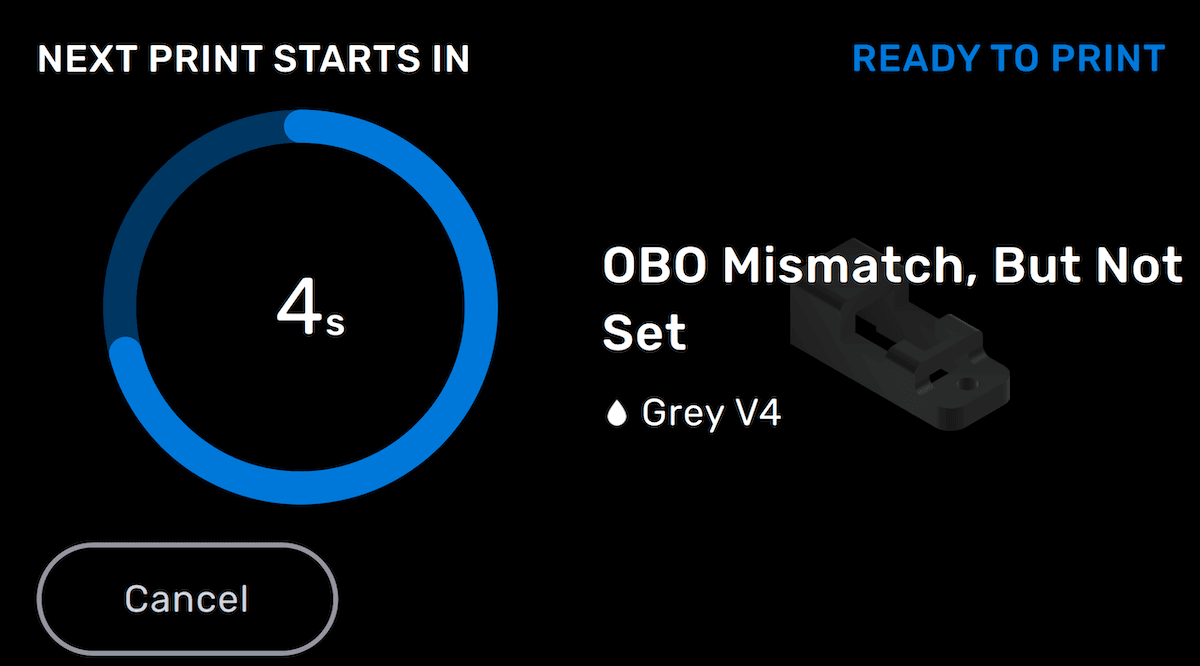

Once your printer’s status is Ready To Print, set up your print job in PreForm and click Print Now (available in PreForm 3.29.0 and later). The print job is uploaded to the printer, which starts the print automatically.
Form 3 automatically starting a print

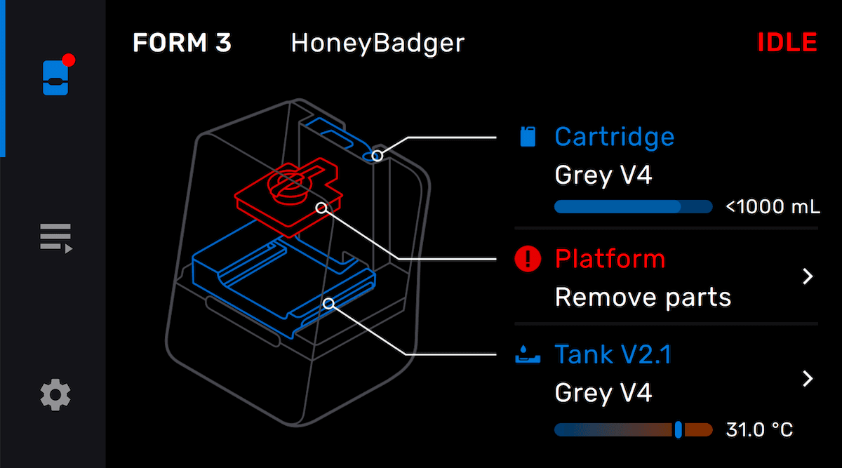

After a print completes, the printer status changes to Idle. The build platform status on the printer screen changes to Remove parts.
Idle Form 3 after a print
Remove the build platform and retrieve your printed parts. To ready your printer again, insert a build platform and confirm that it is ready to print.
