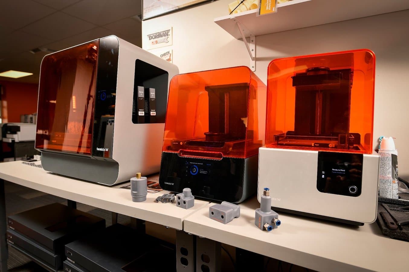

Dorman Products uses the Form 3L, Form 3+, and Form 2 stereolithography printers, seen here.
Dorman engineers use the Form 2, Form 3+, and Form 3L printers.

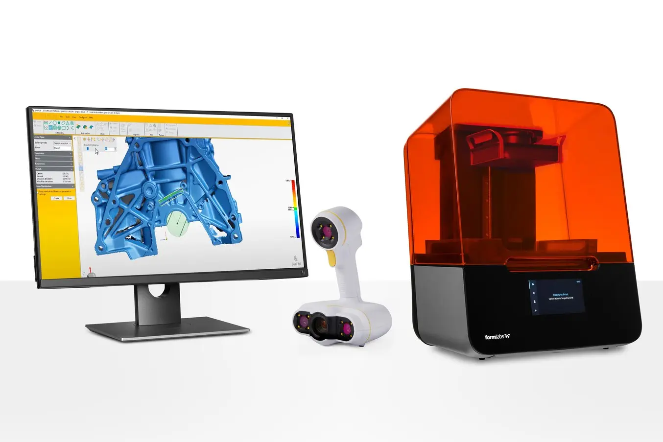

The design process first requires a digital recreation so they can alter the design. Then, the parts are sent to the Dorman metrology lab, which uses either non-contact laser scanning or a contact probe for higher precision parts. The benchmark data is then sent back to Allebach and Tryson’s team, who use Solidworks to reverse engineer the parts.

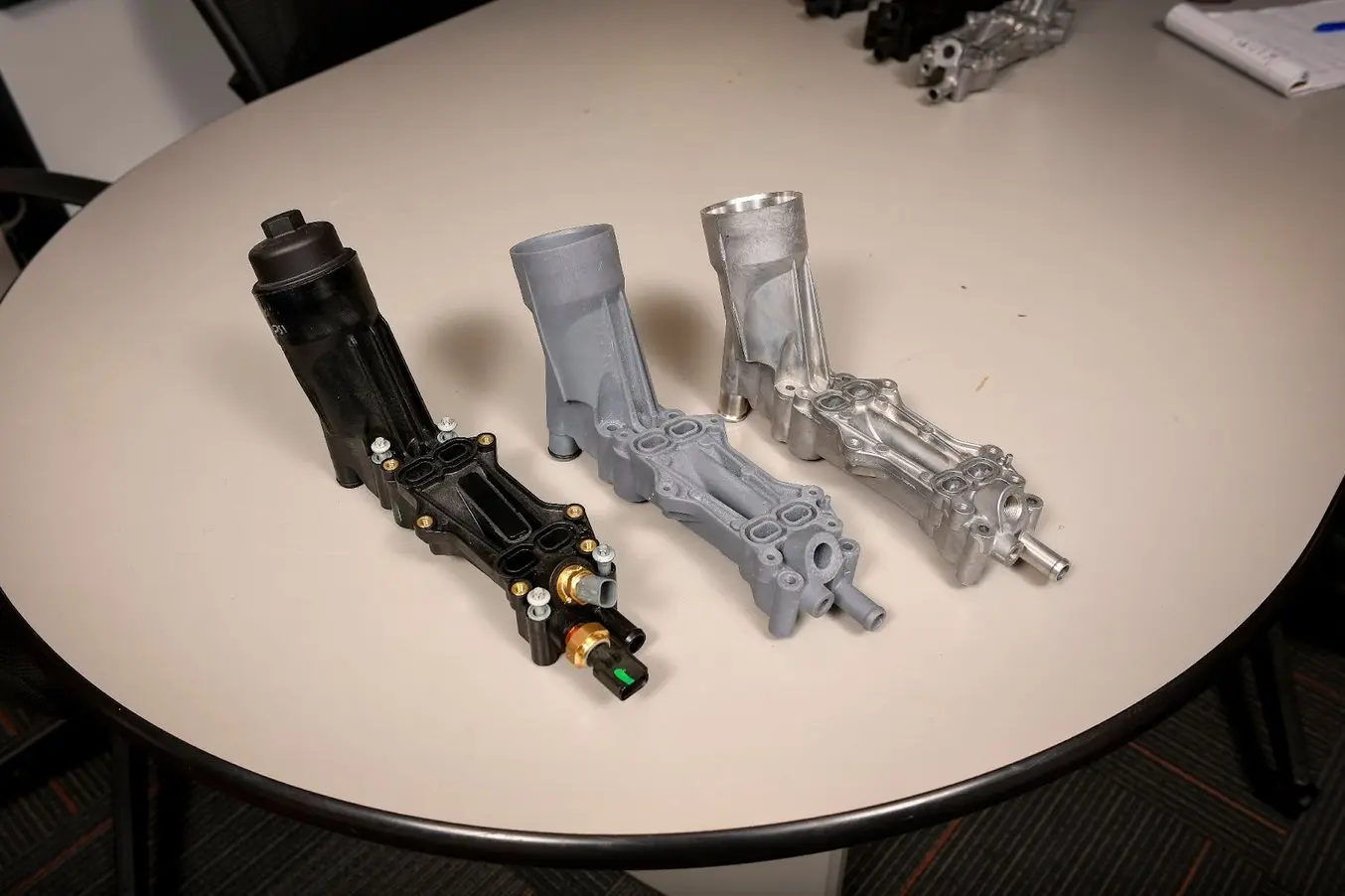

One example was an engine component that had been failing for many car owners. It was originally made out of plastic and cracked over continued exposure to the heat produced by the engine. The Dorman team analyzed the part, had it scanned by their metrology team, and decided to re-engineer it in cast aluminum. Designing the product in a different material wasn’t just a simple one-to-one material switch — the part had to be suitable for die casting. To ensure the performance of the part remained the same despite the redesign, they had to prototype extensively, and test each iteration.
“Doing these design iterations and having it done in a couple of hours, and to be able to get two iterations done in a day is so helpful. Before 3D printing, it was hopes and dreams that you get it right the first time. If not, you wasted weeks or months getting the right article back in, only to get the first one in, then realize you had to tweak it again and send it back out," says Tryson.
Once they had a design prototyped in-house, Dorman performed functional testing to validate that the part still worked the same.
An engine component that was failing for many car owners was remanufactured, and seen here prototyped.
This engine component had been failing for many car owners, iterations from Dorman's redesign showed here.

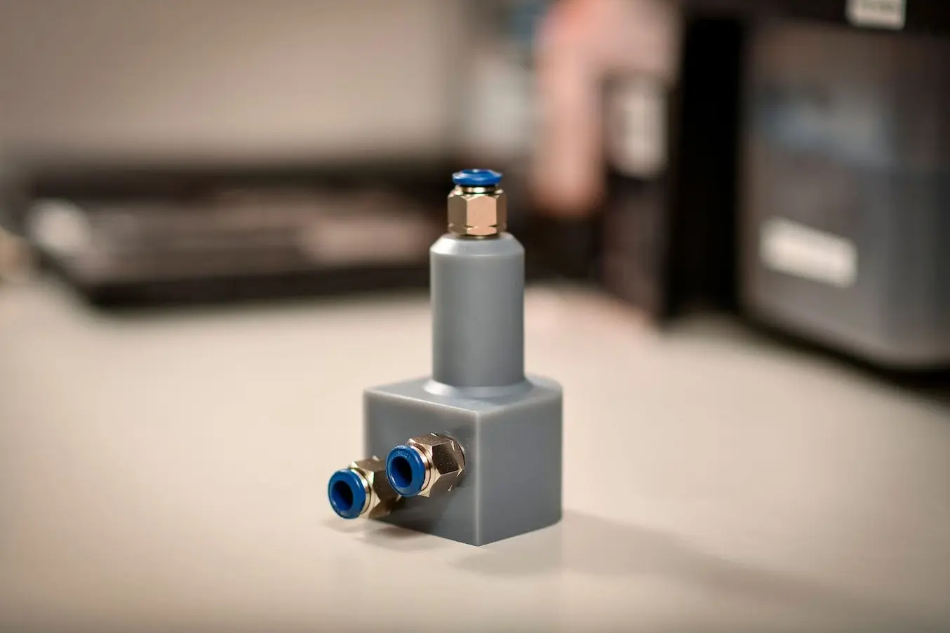

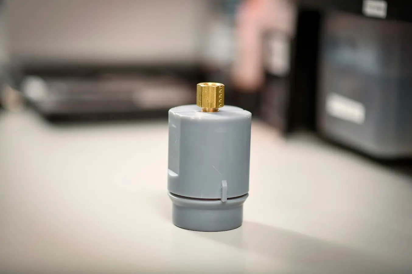

One validation process required two 3D printed test fixtures for a pressurized hose test. One fixture was made to cap off the hose at one end and run fluid through it to find the limits of its pressurization. The other fixture was made to simulate the mating geometry, which in real life would be a large radiator under the hood of the car. Being able to 3D print only the mating portion of that radiator meant greater maneuverability for the testing team, and it also meant they could send the part out to their manufacturing assembly line, and have them run validation testing as parts were coming off the line as well, as an additional quality control process.
“If the mating component is a giant radiator, you’re not going to buy multiple of those and ship them, only to cut off a tiny section of it. This way we just make what we want, make them in mass, and then distribute them. At the end of the day, if one breaks, it’s a couple of dollars and we can just print another one,” says Tryson.

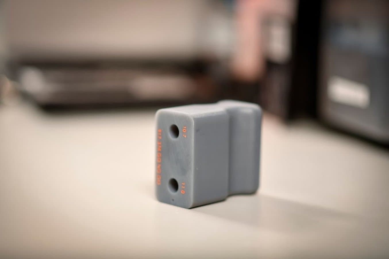

“We do a lot of no-go gauges with Formlabs printers, because of the tolerances we can hit. One part I did that I did not think was possible was a no-go gauge that we were going to start checking parts with, the engineer came down and said that we had a +/-.05 mm tolerance that we needed to hit, on a diameter. We were able to get it printed with a diameter that had a .025 mm tolerance on a run-out. I couldn’t believe that I was able to get a tolerance like that on a Form 3L”, says Allebach.
A no-go gauge made with the Form 3 stereolithography printer and Grey Resin.
A no-go gauge printed in Grey Resin.

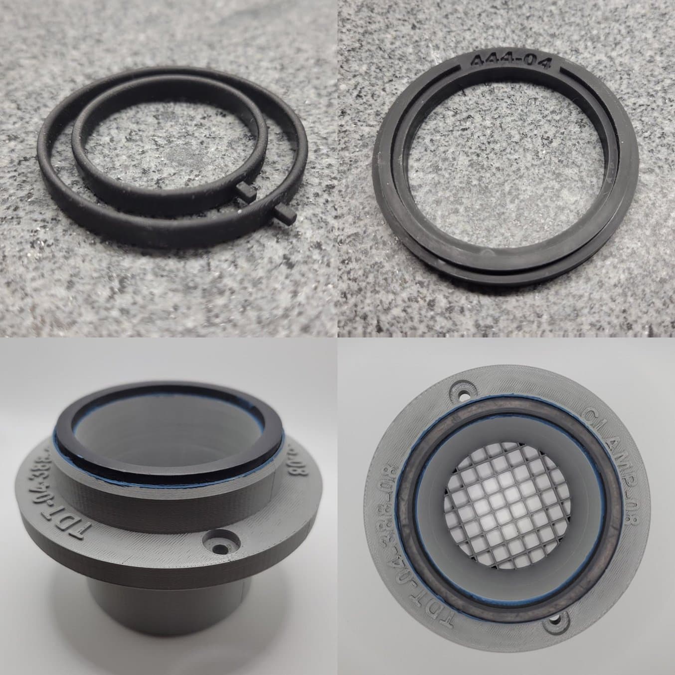

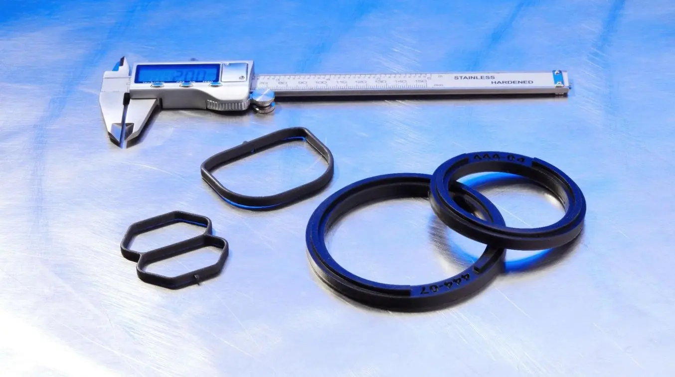

When they pressure test components for validating new design, the team needs to be able to seal up certain ports and faces. But they don't always have the mating geometry to seal every part, so they have to come up with creative ideas, which most of the time comes down to making custom gaskets and fixturing.
Traditionally, they’d measure components in their lab, get metal dies made, and then cut the custom gaskets using the dies in an arbor press. “It was like cutting cookies out of a sheet. It was very inefficient in terms of material use and time spent by our lab techs,” says Allebach.
Switching to 3D printing allows the team to drastically reduce lead times and costs, especially considering the large number of new components. “We printed hundreds of custom gaskets for our throttle body tester to seal up both ends of the throttle body and then do flow tests on that,” says Allebach.
Custom gaskets from Dorman Products 3D printed in Silicone 40A Resin.
While Formlabs’ silicone-like Elastic 50A Resin was at times suitable for this purpose, the new Silicone 40A Resin, the first accessible pure silicone 3D printing material, expands the range of applications. “It's unreal how much more durable the Silicone 40A Resin is [compared to silicone-like 3D printing materials],” says Allebach. “Basically, it is a silicone resin, so I was expecting that, but it definitely performs like an injection molded silicone.”
Chemical and thermal resistance are two key properties they were looking for in Silicone 40A Resin. They conducted 2-month chemical testing on the 3D printed parts with oil, washer fluid, and UV environmental testing among others, then ran compression set testing. The spring back and other mechanical properties held up to match their requirements.
Gaskets for Validation Testing
Lead TimeCost
Cutting Silicone Sheets With Machined Metal Dies2 weeks per set$250 per set
SLA 3D Printing With Silicone 40A Resin3 hours per set$12 per set
“Being able to make custom gaskets that are going to be tested in a heat aging oven, or sealing it in an environment that's going to mimic the engine compartment from a testing standpoint, or to be able to test under air, water, coolant, oil, anything that the part's going to see under real life — that's huge, especially for us.”

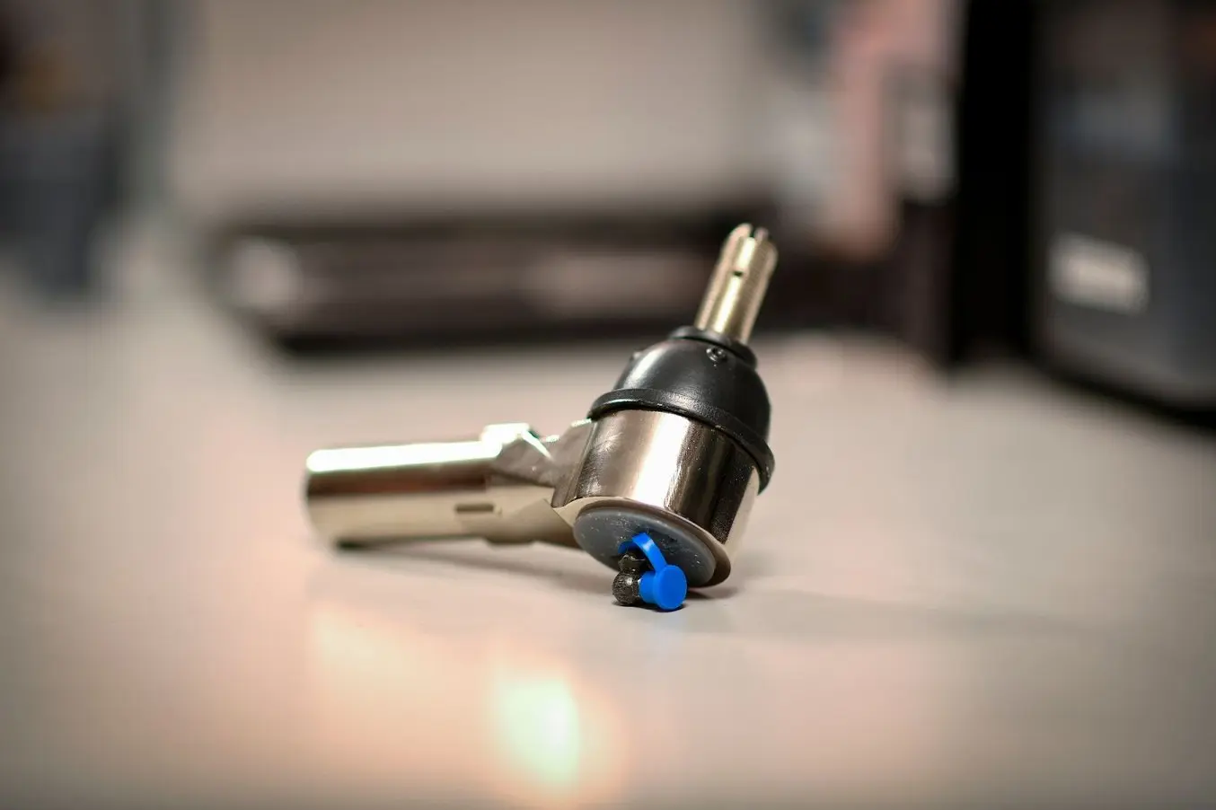

Tryson and Allebach often do a little extra post-processing to parts before sending them to the marketing and sales teams at Dorman. For a part that will eventually be mass-produced in metal, they’ll do a finishing process on an SLA-printed part before handing it off to their customer-facing departments. Recently they had printed some ball studs for their chassis team in Grey Pro Resin, then had them electroplated before giving them to their colleagues for some marketing collateral (electroplating by Repliform INC). There was only one problem — the surface finish was almost too good! “The marketing team said, ‘these parts are usually forged or cast and then zinc coated. If we use this, it’ll look even better than the part that comes in the box,’” says Allebach.
A part printed on the Form 3 and electroplated by Repliform.
An electroplated assembly.
