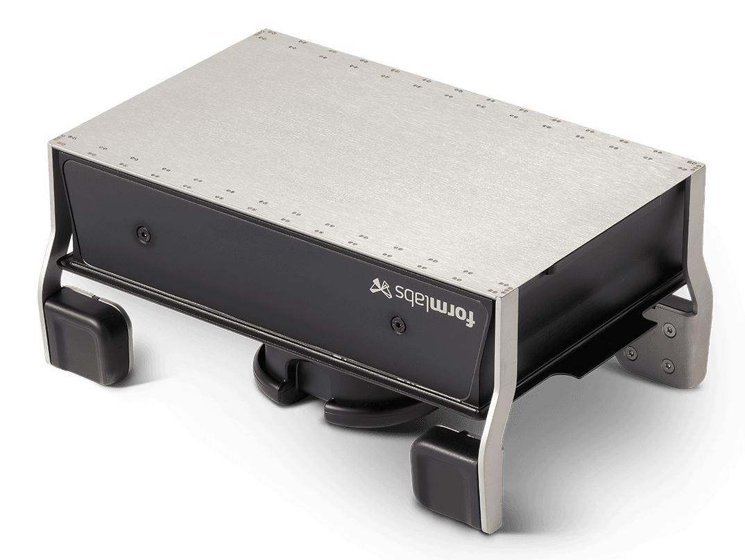

Cleaning and maintaining the Form 4 Flex Build Platform
When performing consecutive prints using the same resin, you can clean the outside surfaces of the Form 4 Flex Build Platform without separating the print surface from the build platform body.
If you are changing resins, disassemble the Flex Build Platform to clean between the print surface and the build platform body. Follow the instructions below to keep the build platform clean and well-maintained.

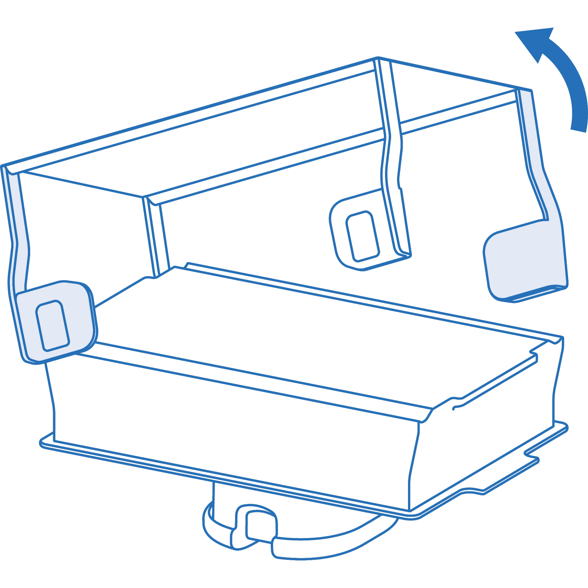

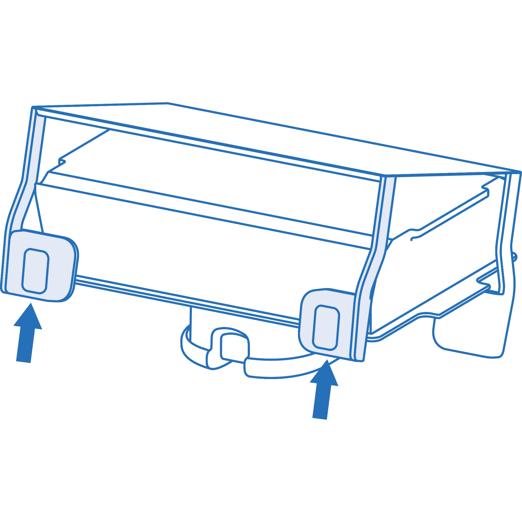

  2. Place the build platform on your work surface. Lift the part release tabs closest to you.

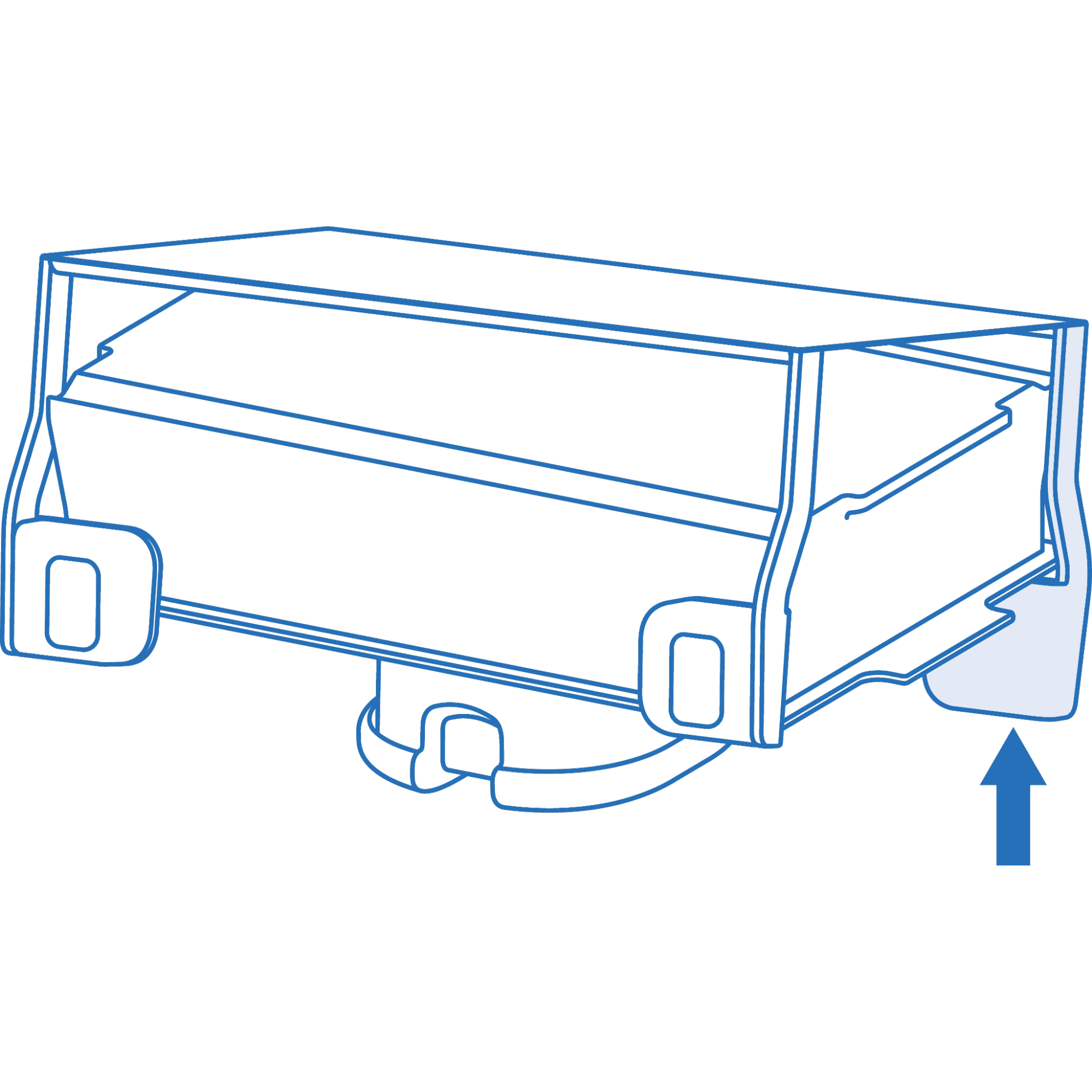

  1. Push up on one of the rear tabs behind the handle to disengage the print surface from the build platform body.

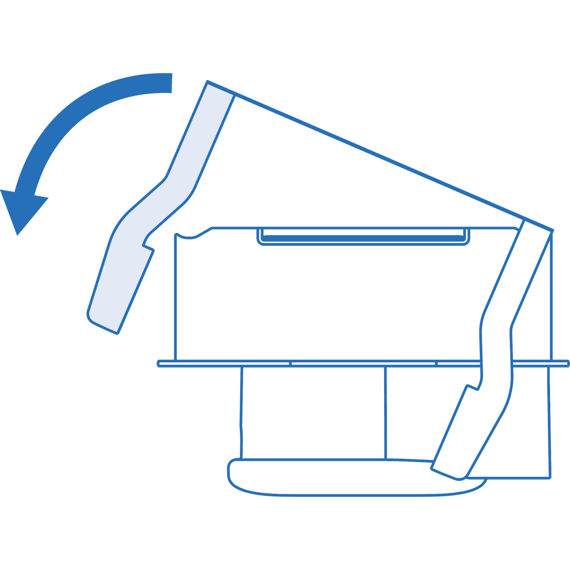

  1. Remove the print surface from the build platform body.

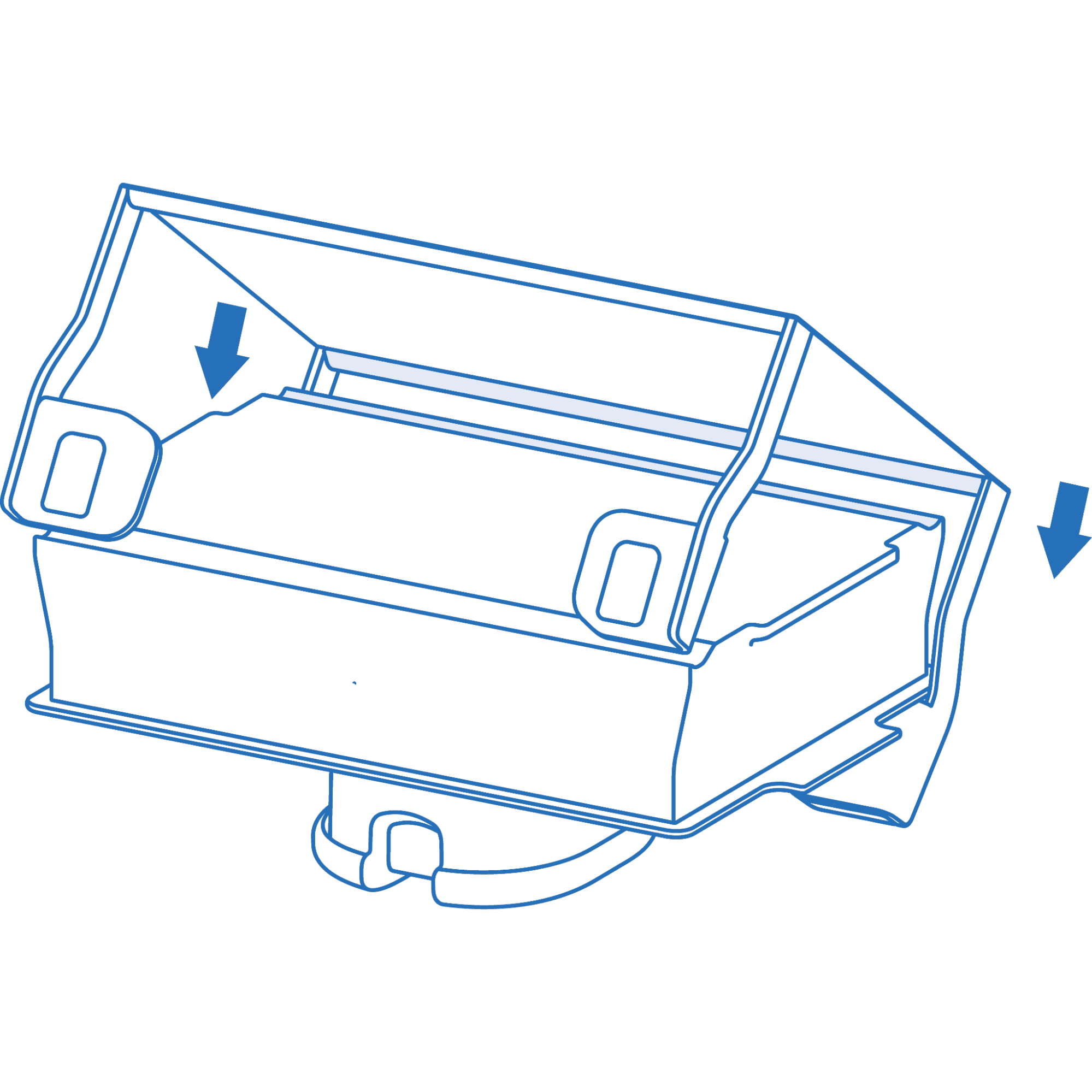

  1. Carefully lower the print surface down onto the build platform body. Ensure the print surface is flat and properly aligned before starting your next print.
