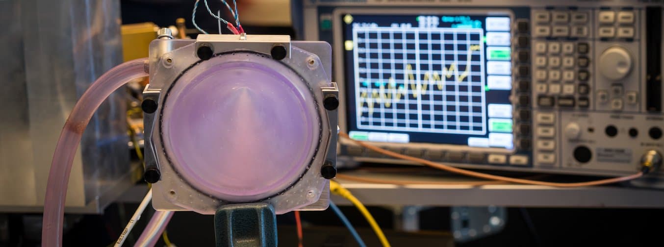

“Finding the best compromise between the conflicting microwave performance and the temperature distribution constitutes a major challenge in the design process of calibration units. We decided to experiment with water as the absorbing medium. Water has excellent absorbing properties, and since it’s fluid, the temperature can be controlled efficiently,” said Dr. Schröder.
One main challenge remained: how could they shape a water container of a calibration unit to obtain a high performance?
The scientists decided to use a conical shell to separate the water from the air. Computer simulations indicated that this would be a promising way forward, given that the separating material was transparent in the microwave regime. To test their idea, the scientists printed the first prototype shells using Clear Resin on a Formlabs stereolithography (SLA) 3D printer.
“We put these shells in a water-filled jar to have a very simple water-based absorber. We conducted initial electromagnetic measurements which showed that these prototypes displayed excellent electromagnetic performance,” said Dr. Schröder.
“In the first test, the new device was ten times better than a conventional calibration target. The absorption was so good that the measured signal turned out to be close to the noise floor of the testing instrument,” said Mr. Raisin. “These first investigations demonstrated that we were on the right way. Having proven the electromagnetic performance, it was time to build a real prototype to investigate the thermal performance.”
The second prototype consisted of two 3D printed cones, one inner shell optimized for electromagnetic absorptivity, and one outer shell around the former. The water flows in between these two cones uniformly with the help of a guidance spiral. Hoses attached to the device channel water inflow and outflow, and temperature sensors are inserted into the outer shell to monitor the temperature of the water.
Traditional calibration units tend to have poor temperature gradients due to their low thermal conductivity, whereas water allows for a consistent temperature throughout the cone—as required for a high-performance calibration unit. The scientist examined the prototype using an existing ozone radiometer.
“Instead of measuring ozone, we measured our prototype. In this experiment, we increased the water temperature step by step up to around 60 °C,” said Dr. Schröder. The temperature measured by the radiometer precisely followed the temperature measured by the sensors deployed in the water.
Moreover, the temperature homogeneity in the cone is within several millidegrees Celsius (m°C), a significant improvement over other targets where a difference of several hundred m°C is common.
“This is a great result as it demonstrates that the water-based calibration unit meets the theoretical predictions, and even exceeds our expectations. These 3D printed calibration units can be produced much faster and at least five times cheaper than commercial calibration units with comparable performance,” said Dr. Schröder.
