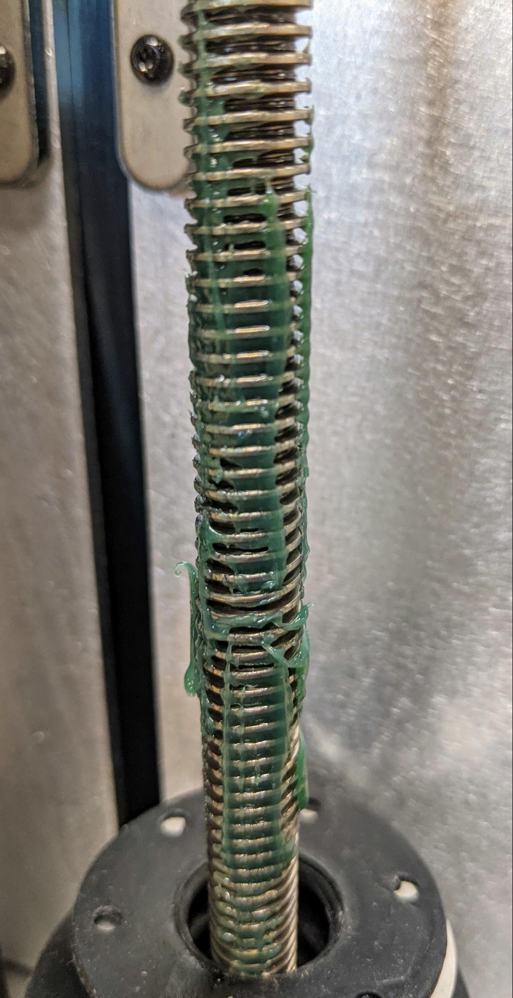

Over time, the nut on the build chamber’s Z-axis lead screw can degrade and leave a black residue in the grease on the lead screw. Loose powder can also contaminate the grease. This debris can cause the print bed to stall or generate noise during printing.

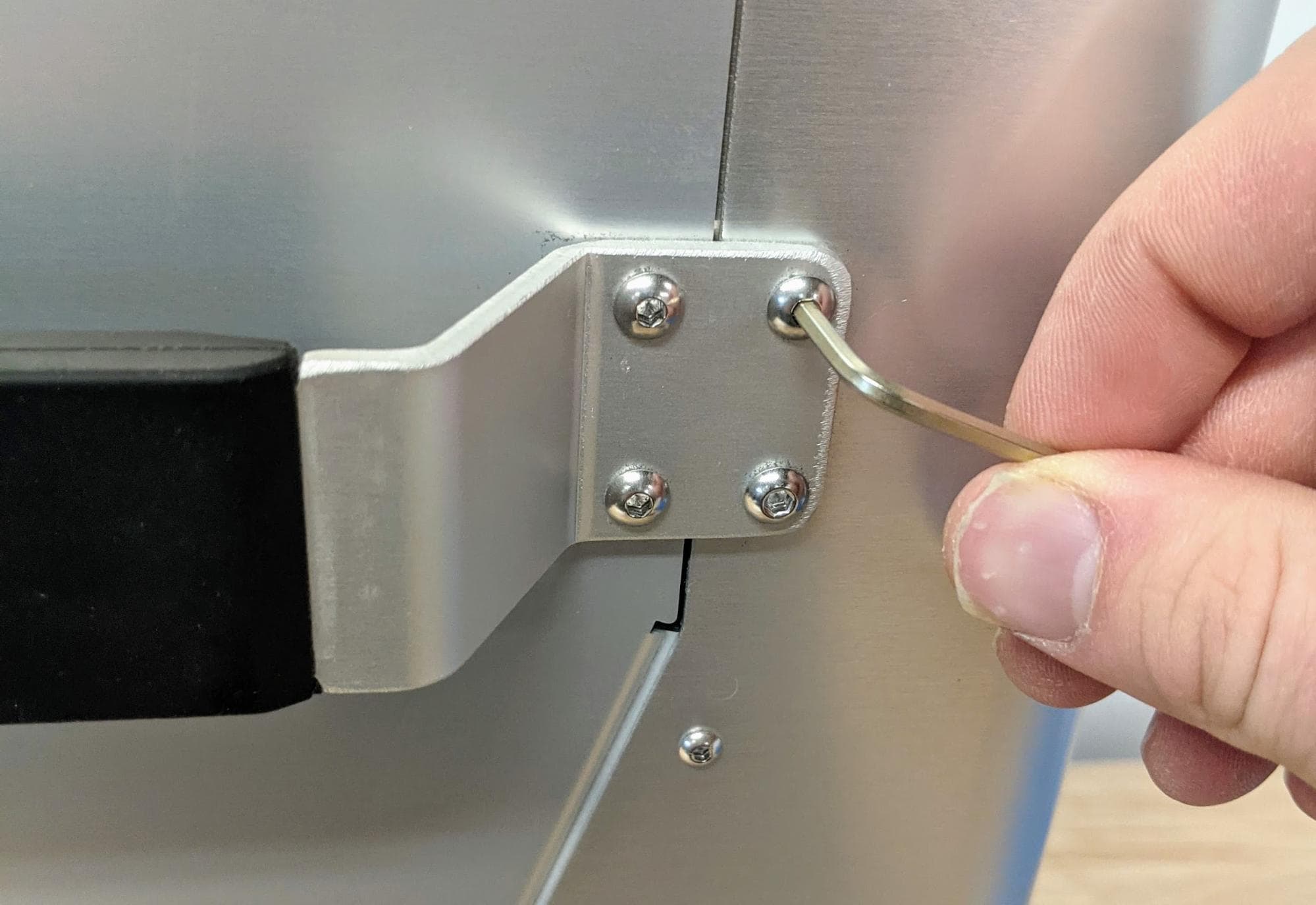

Step 1: Remove the build chamber handle screws
Using a 2.5 mm hex driver, loosen and remove the two M4 × 10 mm screws securing the build chamber handle to the rear shell. Leave the other two screws in place. Repeat on the other side of the build chamber.

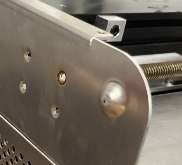

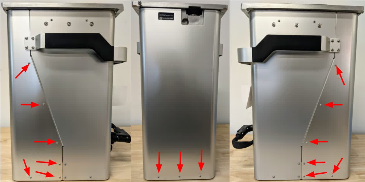

Use a 2 mm hex driver to remove the M3 × 6 mm screws securing the rear shell to the build chamber. There are 15 screws in total: six screws on the left and right sides of the build chamber and three screws on the rear. Set the screws aside.

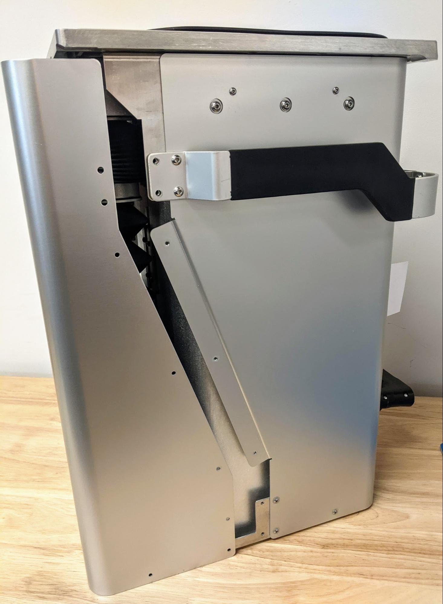

Grip the rear shell and pull it away from the build chamber. Set the rear shell aside.

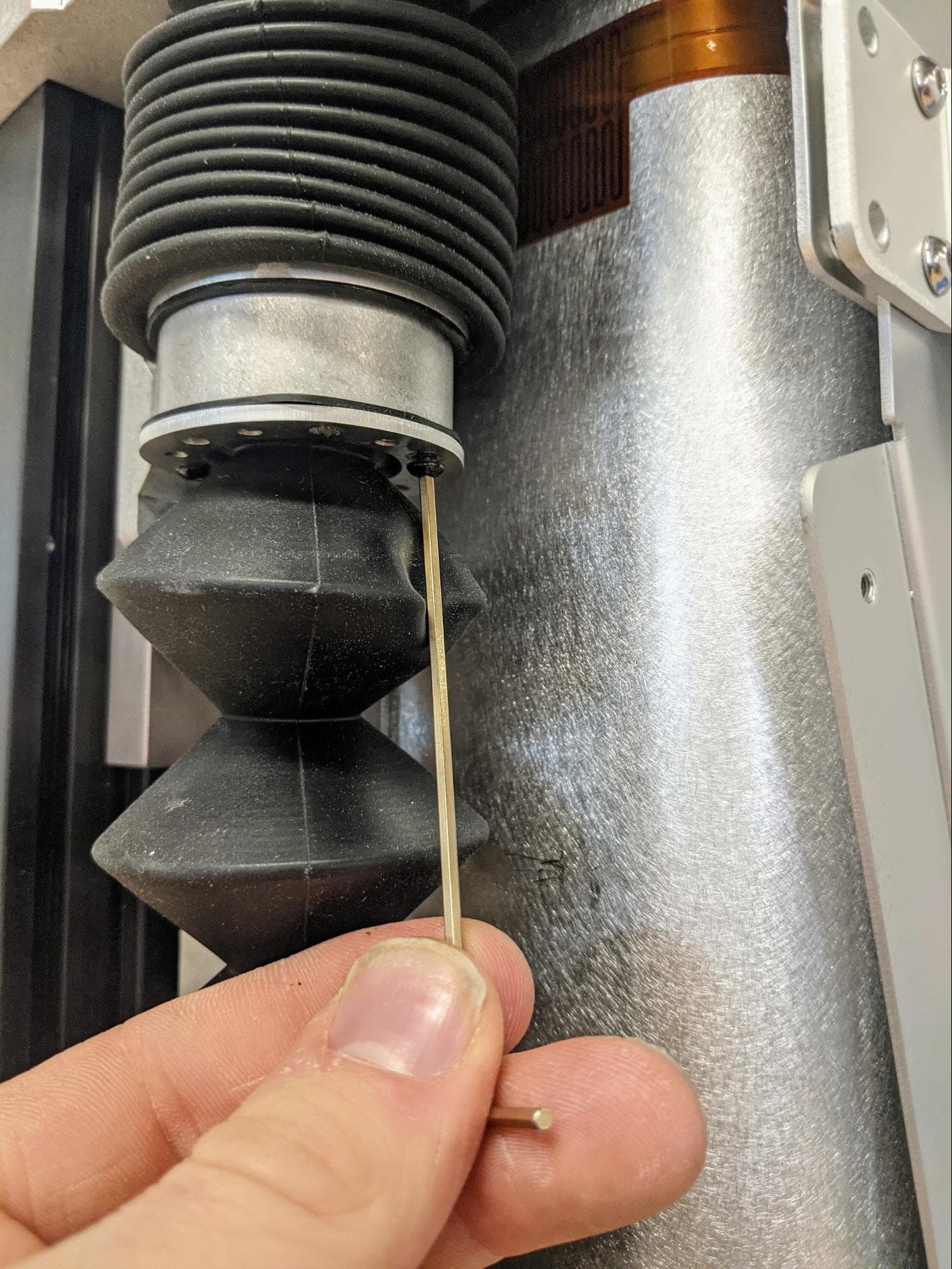

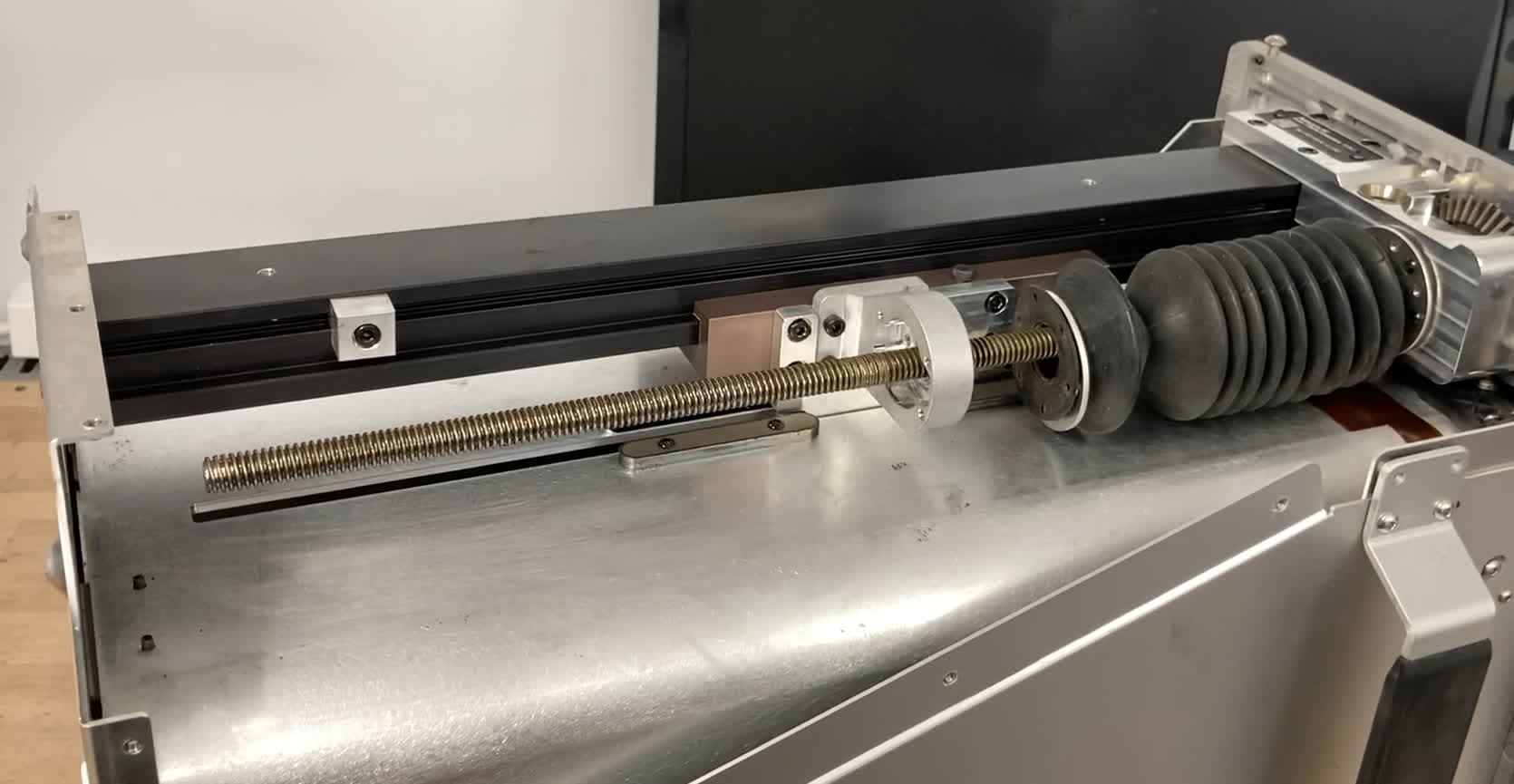

Step 1: Remove the lower rubber lead screw baffle
The lead screw is protected by two rubber baffles, secured to either side of the housing that holds the lead screw nut. When the print bed is at the top of the build chamber, the upper baffle is fully compressed. The lower baffle must then be removed to access the lead screw for cleaning and relubrication.

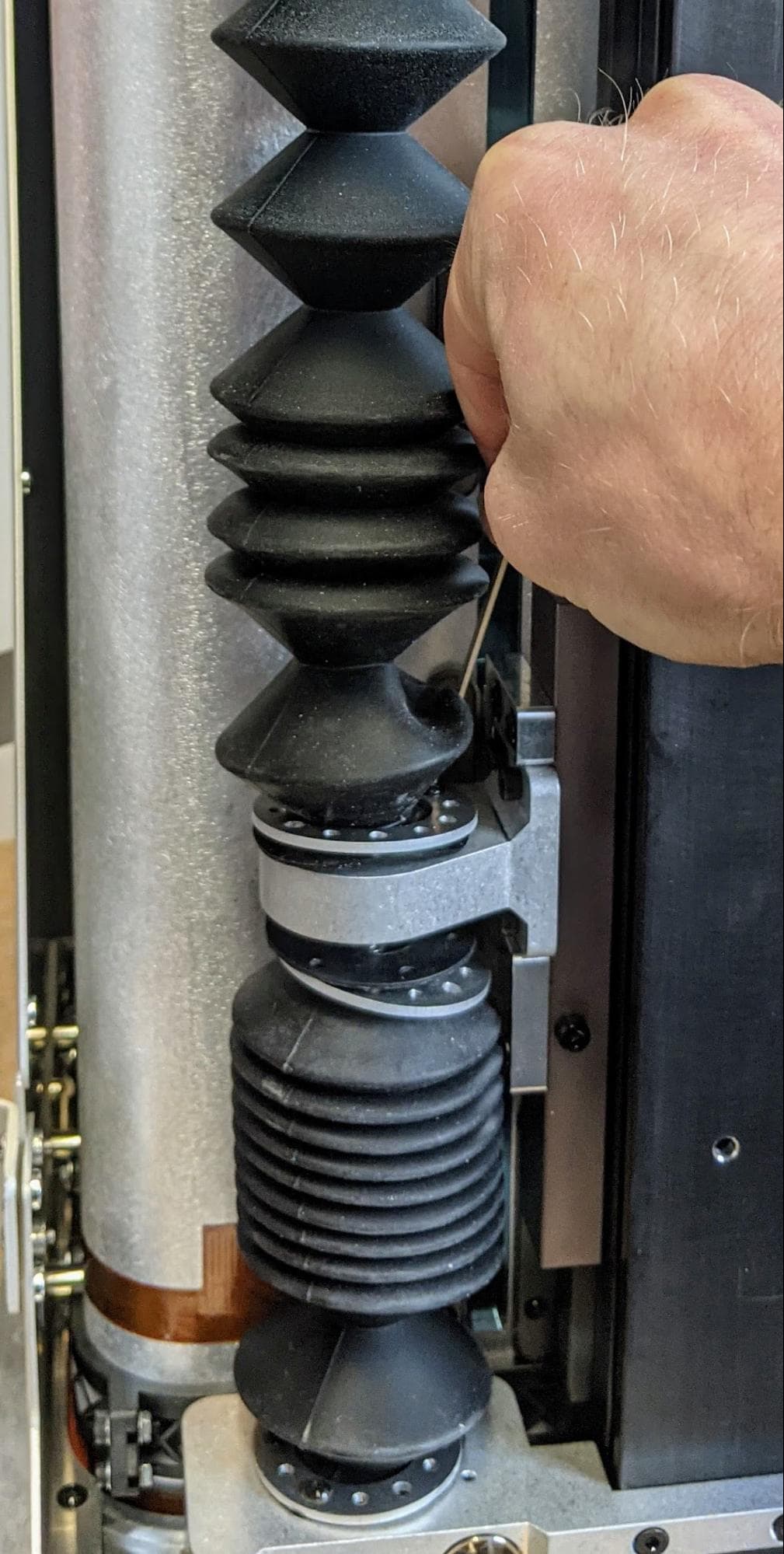

Use a 2 mm ball-end hex driver to loosen and remove the four M3 × 6 mm screws securing the lower baffle. These screws are accessible from the bottom side of the lead screw nut housing, which sits between the two baffles.
Repeat for the four screws on the bottom of the build chamber, which secure the lower baffle to the body of the build chamber. Set the screws aside.
After the screws have been removed, compress the lower baffle and slide it off of the lead screw.

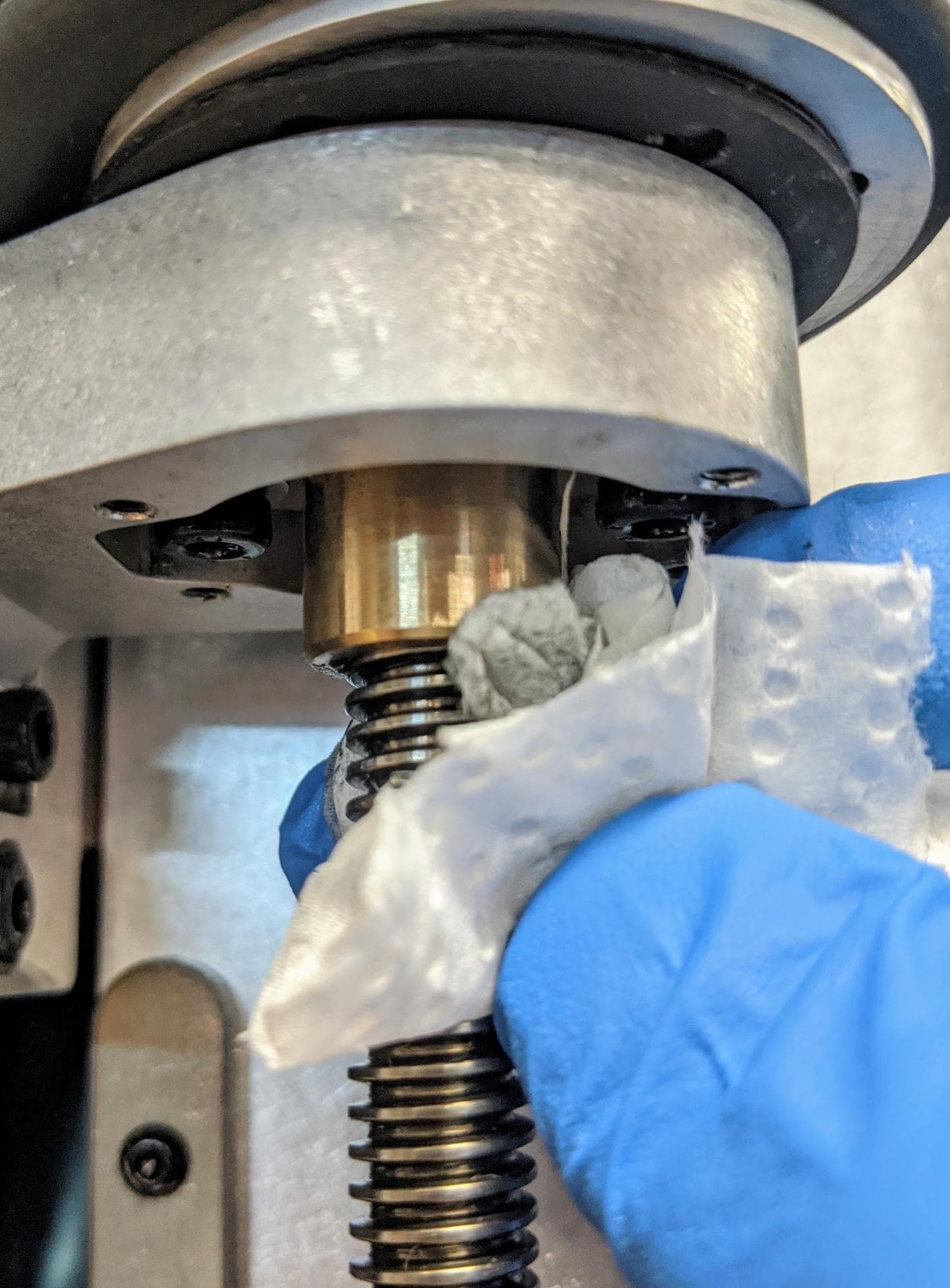

Step 2: Wipe the Z-axis lead screw
Step 2: Wipe the z-axis lead screw

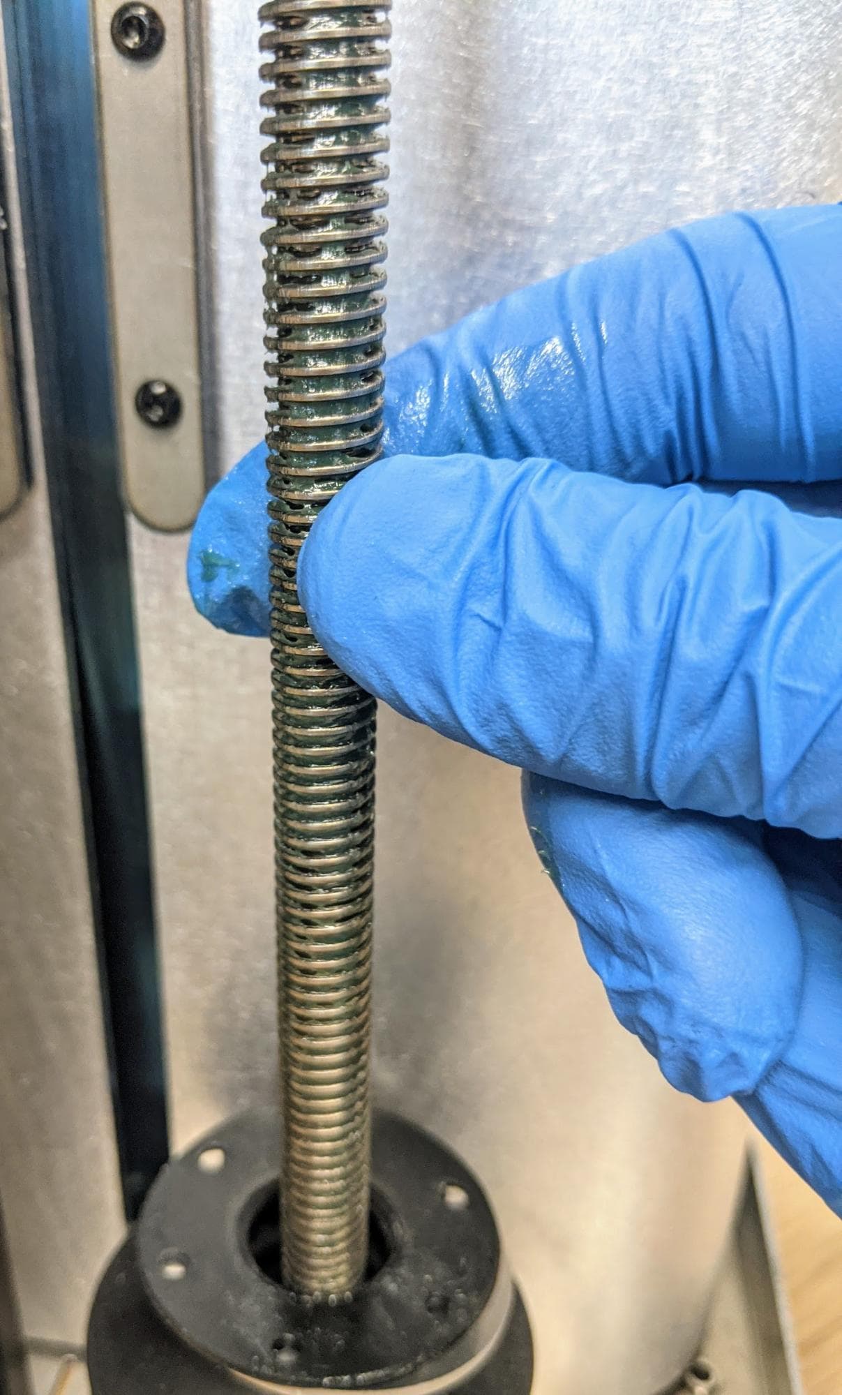

Gently wipe down the lead screw and lead screw nut with a dry paper towel and cotton swabs.
Warning:
PTFE-based grease may cause skin irritation or an allergic skin reaction. Wear gloves when interacting with the Z-axis lead screw.

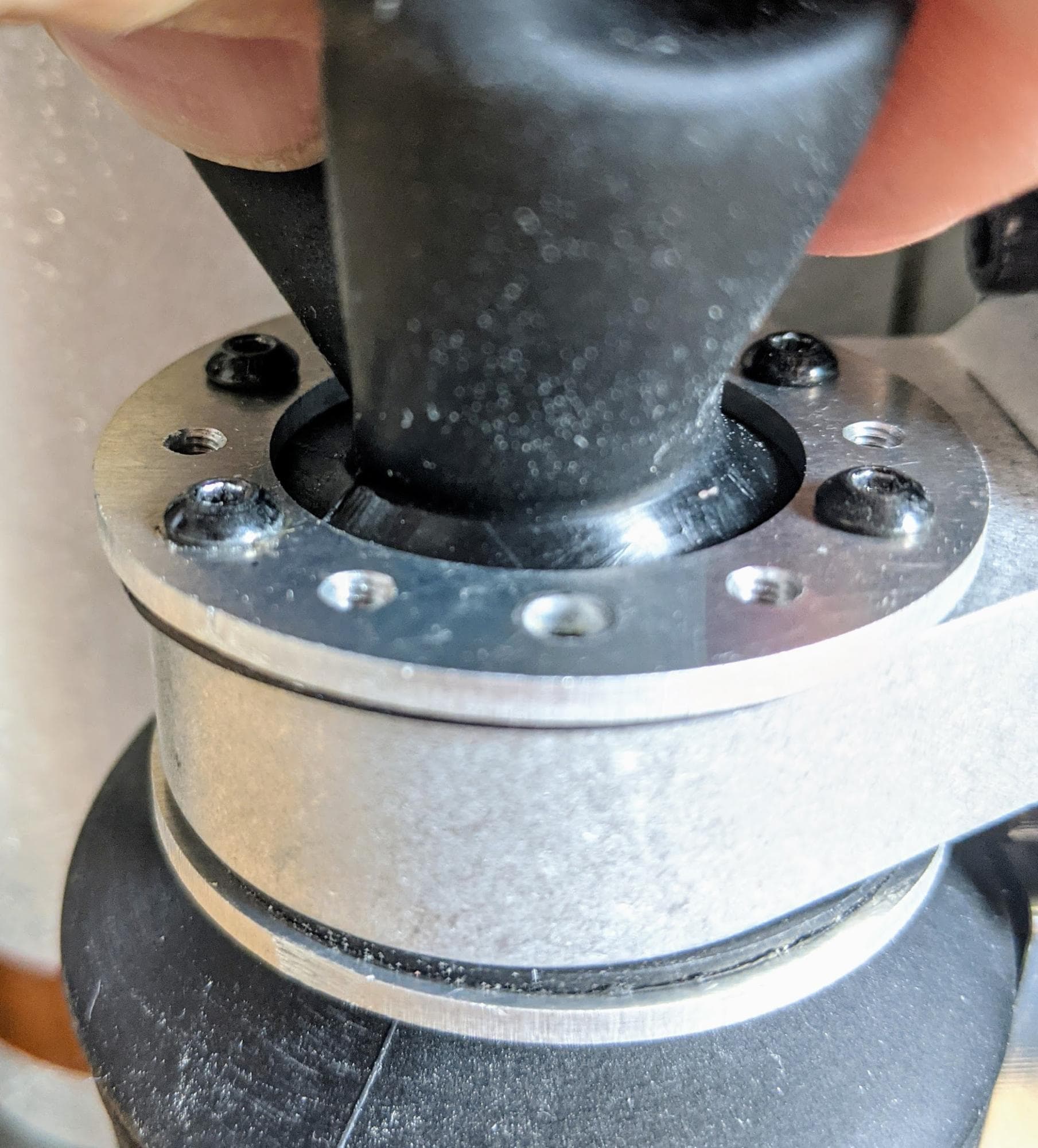

Step 3: Attach the lead screw thread cleaning tool

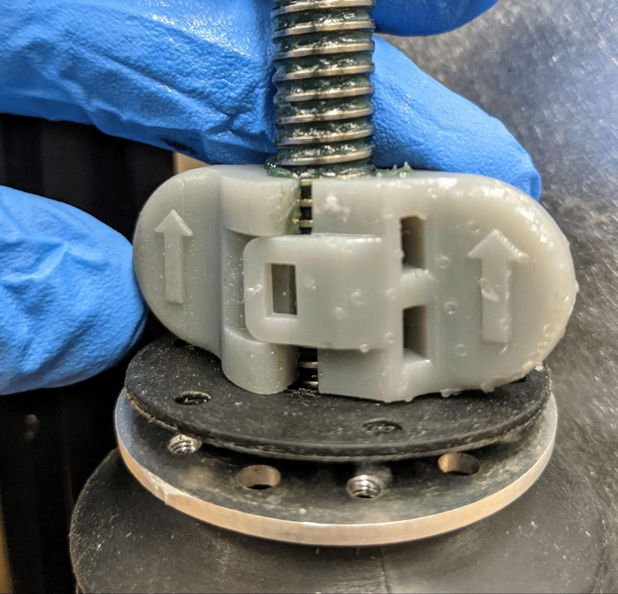

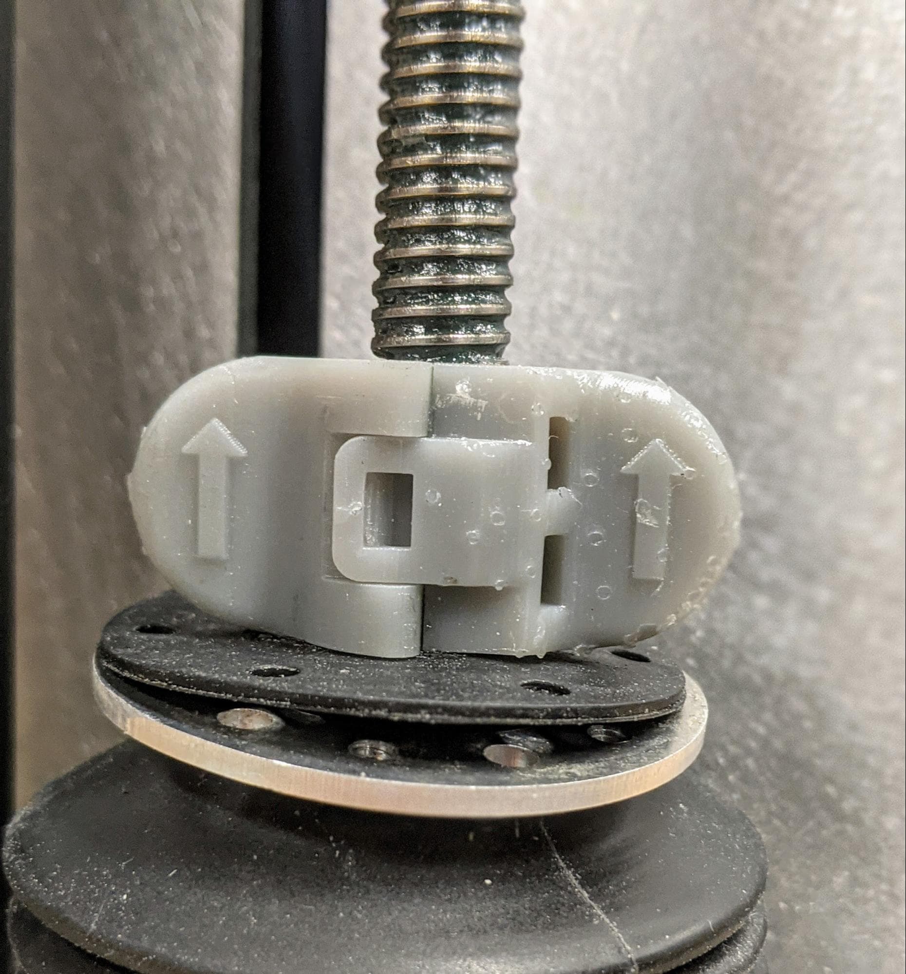

Seat one half of the lead screw thread cleaning tool on the threads at the bottom of the lead screw with the embossed arrow pointing up. Snap the other half of the tool onto the first half, fully enclosing the lead screw. The tool should snap closed without significant resistance and should spin freely on the lead screw.
Step 4: Rotate the lead screw thread cleaning tool
Rotate the thread cleaning tool so that the tool moves upward, in the direction of the arrows. Continue rotating the tool until it reaches the lead screw nut.
Step 5: Remove the lead screw thread cleaning tool
Unclip the lead screw thread cleaning tool. Remove the tool from the printer cavity.

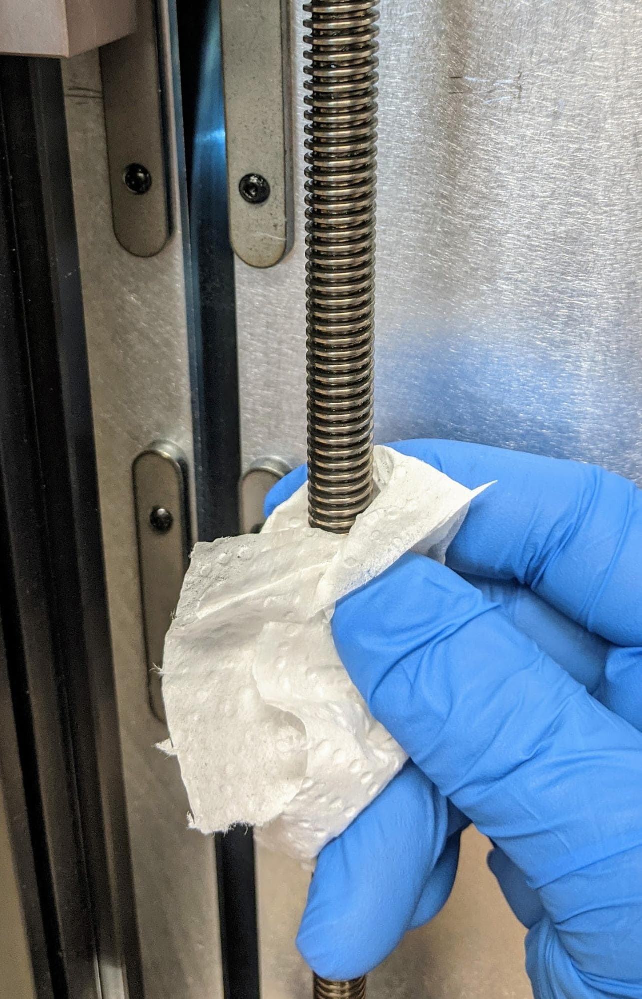

Step 6: Wipe the Z-axis lead screw
Gently wipe down the Z-axis lead screw with a dry paper towel.

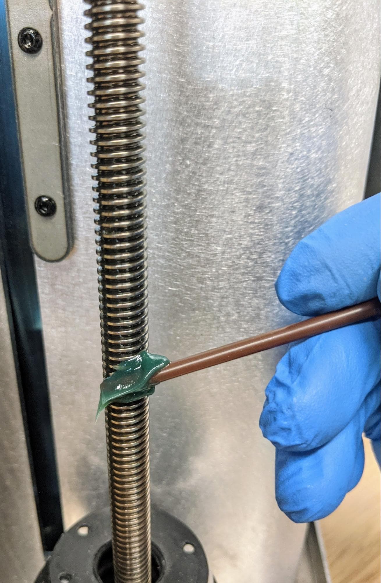

Place a small amount of grease on an applicator, such as a tongue depressor or coffee stirrer. Apply small amounts of the new grease along the length of the Z-axis lead screw.
Step 2: Spread the grease along the lead screw
Using your gloved fingers, spread the grease along the Z-axis lead screw.

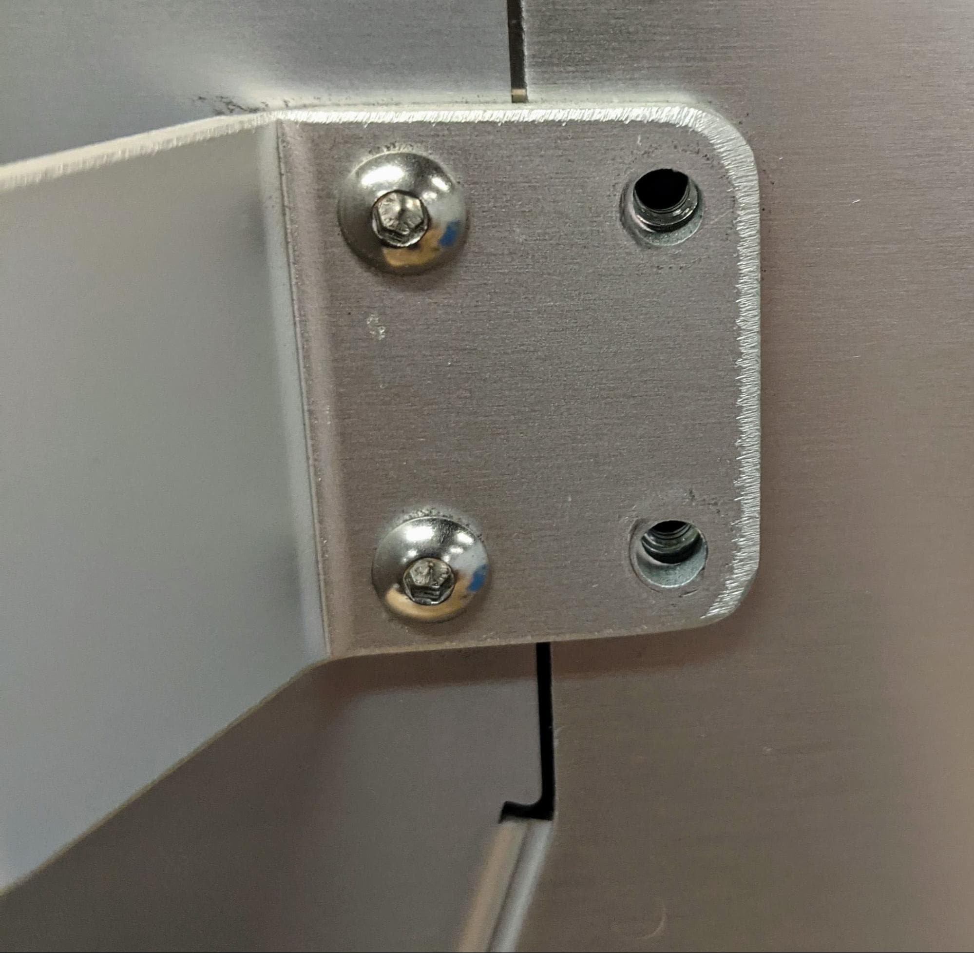

Step 4: Secure the build chamber handle
Thread two M4 × 10 mm screws into the screw holes on one side of the handle. Use a 2.5 mm hex driver to tighten the screws until finger tight, securing the handle to the rear shell. Repeat on the other side of the build chamber.
