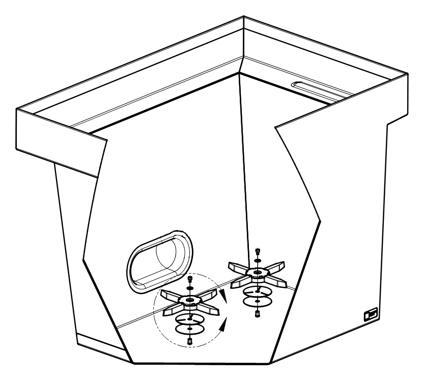

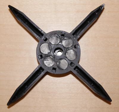

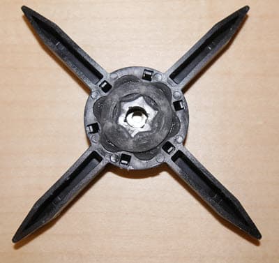

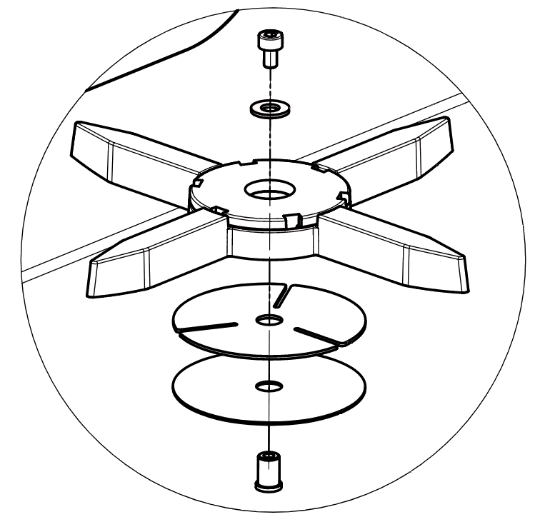

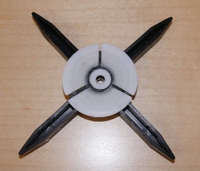

| Inspect the impellers | When inspecting or cleaning the wash bucket |
| Replace the wash bucket |
