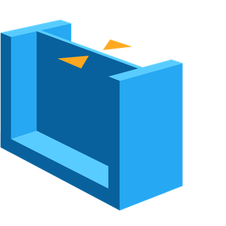

Minimum supported wall thickness
Recommended: 0.2 mm/200 microns
A supported wall is one that is connected to other walls on two or more sides. A supported wall with a thickness of 0.2 mm or less may warp due to the peel forces exerted on the part during the peel process.
NOTE: WASHING THIN WALLS
Take care when washing parts with thin walls, which may absorb solvents such as IPA during the washing process. Spending an extended duration in a washing solution can cause deformation of the part, so minimize how long the part is immersed in IPA to limit this effect.

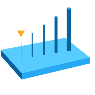

Minimum vertical-wire diameter
Recommended for a 7 mm-tall wire: 0.2 mm/200 micron diameter
Recommended for a 30 mm-tall wire: 1.5 mm/1500 micron diameter
A wire is a feature whose length is at least two times greater than its width. A wire with a 0.2 mm width can be up to 7 mm tall before it begins to deform. Similarly, a wire with a 1.5 mm width can be up to 30 mm tall before it begins to deform.
NOTE: WASHING SMALL WIRES
Take extra care when washing thin wires, as they are weakened by IPA and can easily be damaged. Minimizing how long the part is immersed in IPA limits this effect.

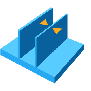

Minimum clearance
Recommended: 0.5 mm/500 microns
Clearance is the distance between two parts of a model (e.g., the distance between a pair of gears). Parts may fuse if clearance is less than 0.5 mm.
