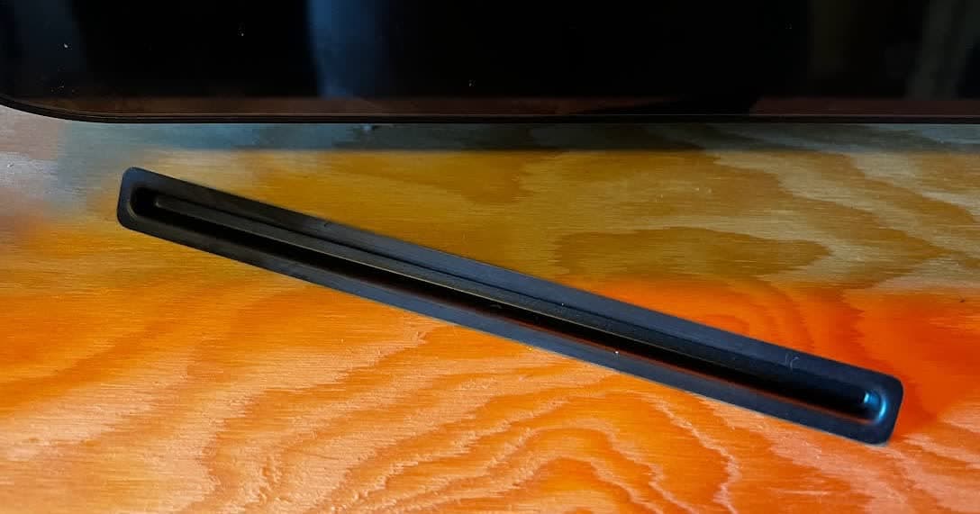

Step 3: Remove and store the resin tank
Remove the resin tank, place it in the resin tank case, and cover it with its lid. Set the case and tank aside on a clean, flat surface.

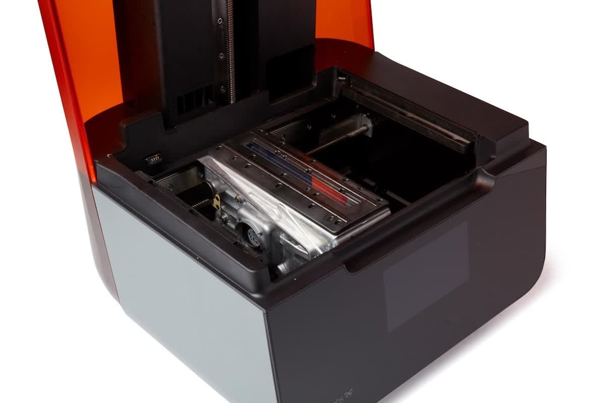

Step 5: Move the LPU housing to its maintenance position
Tap the gear icon to access the Settings screen, then tap Maintenance > Motor Moves. The Motor Moves screen appears. Tap and hold Left (<) to move the LPU housing to the middle of the printer cavity. Other controls on this screen fully sweep the LPU housing across the printer cavity and control the build platform carriage.

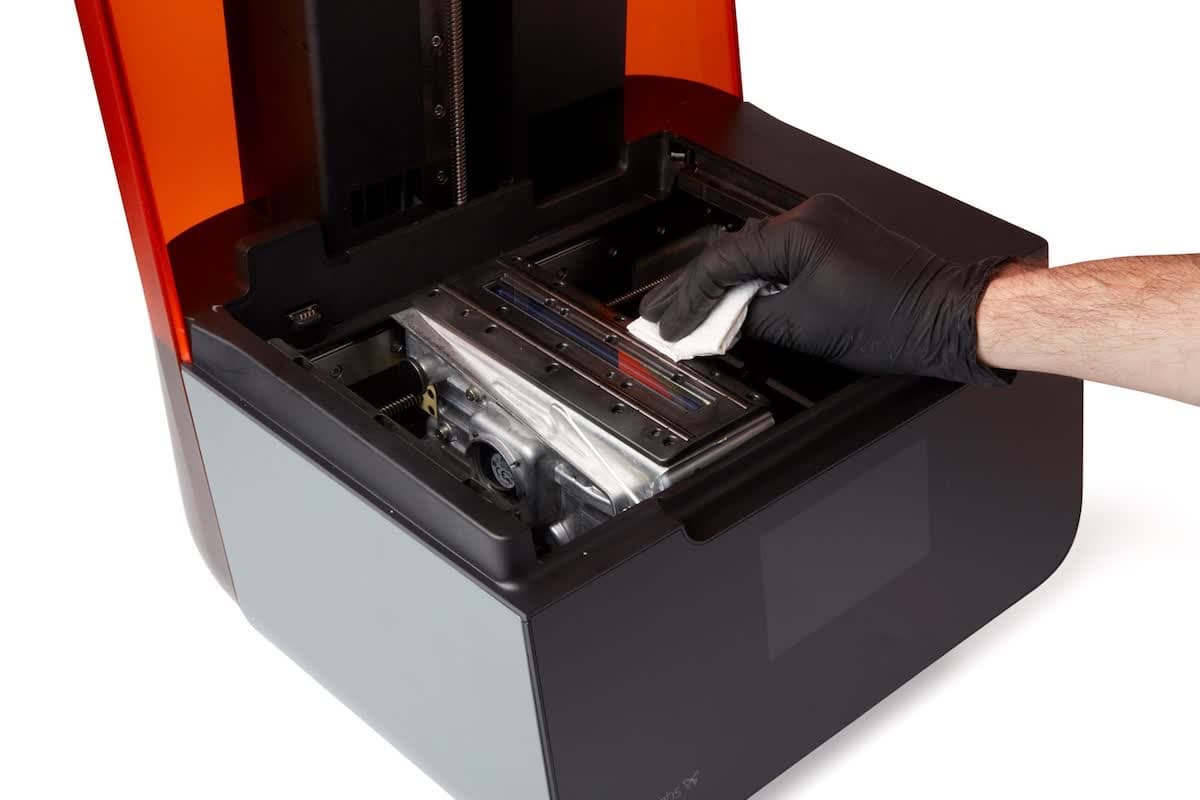

Step 7: Clean the roller holder
Open the printer cover. Clean any resin pooled on top of the roller holder and adjacent surfaces with paper towels. Dampen the paper towels with isopropyl alcohol if necessary to fully remove the resin.

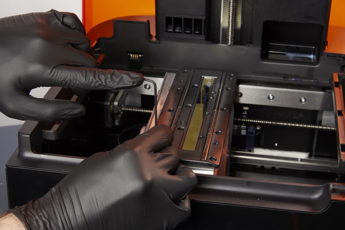

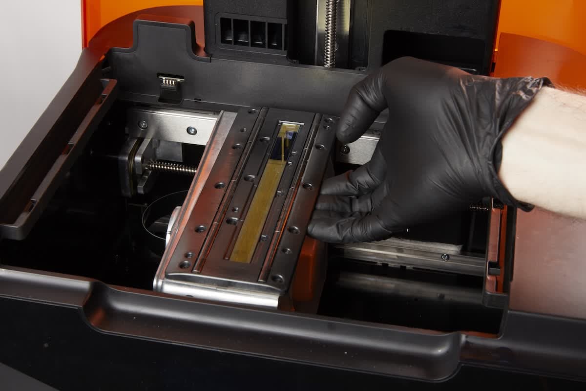

Step 1: Unscrew the roller holder
Fully loosen the 16 screws on top of the roller holder with the provided hex driver. Avoid dropping the screws into the printer cavity.

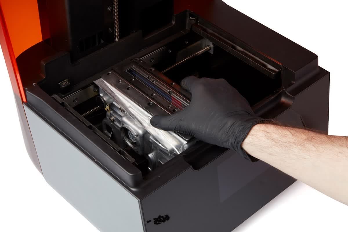

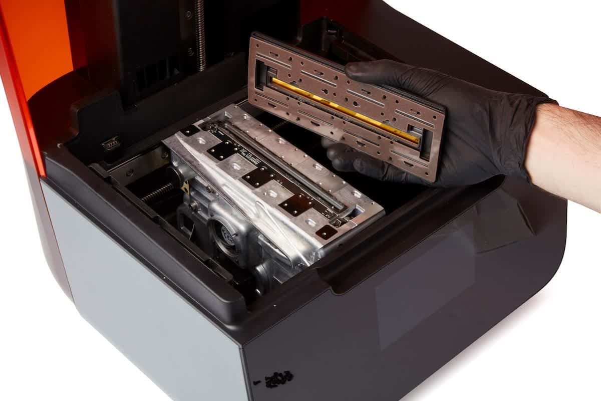

Step 2: Remove the roller holder
Layer several clean paper towels to the side of your work area. Carefully lift each edge of the roller holder to separate it from the LPU housing. Once the roller holder is free, lift the roller holder vertically away from the LPU housing. Quickly place the roller holder onto the paper towels to prevent any resin from dripping into the printer.
NOTICE:
Do not allow any resin or other debris to fall into the rectangular laser opening below the roller holder. Contamination may require additional cleaning or repairs.

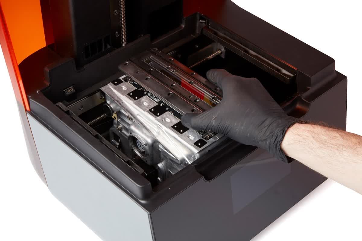

Step 3: Place the LPU gasket cover over the LPU laser opening
Carefully place the LPU gasket cover into the opening previously covered by the roller holder to prevent any contaminants from entering the LPU.

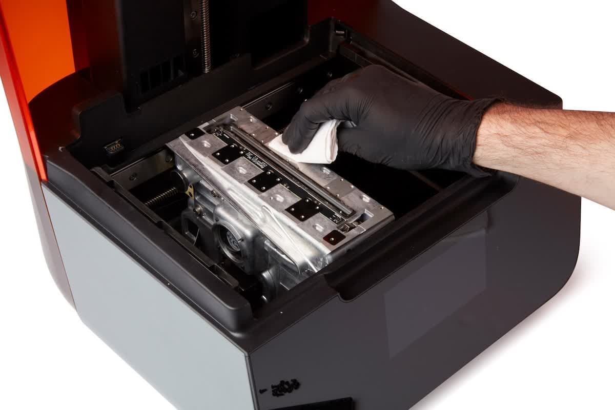

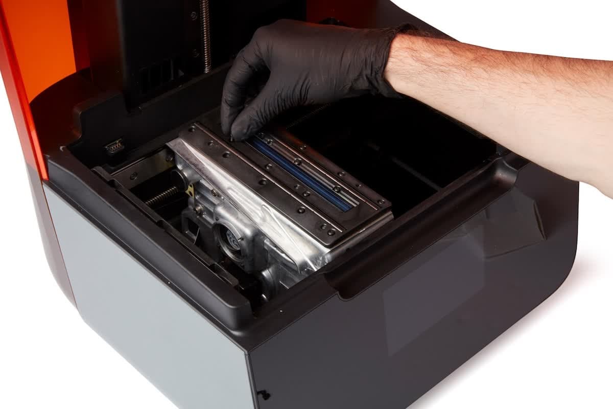

Step 1: Prepare the LPU housing
Clean any pooled resin on the roller holder mounting surface with paper towels dampened with IPA. Take care to not damage the gasket surrounding the laser opening, the printed circuit board, or any flexible shims on the mounting surface. Once the cleaning process is complete, remove the LPU gasket cover for disposal.
Step 2: Install the new roller holder

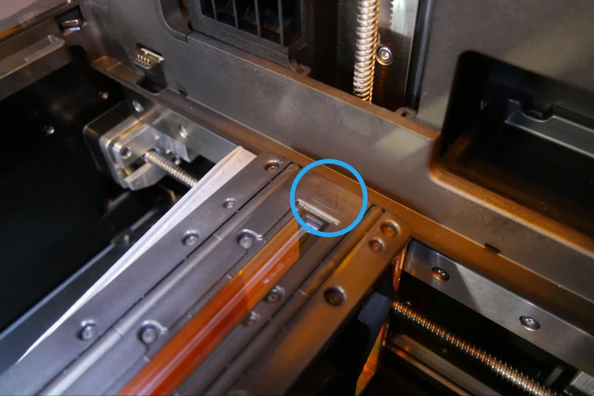

Carefully remove the new roller holder from its packaging. Do not remove the protective film from the roller holder laser window. Hold the roller holder above the LPU housing. The arrow on the top of the replacement roller holder points to the rear of the printer.
Align the laser window in the roller holder with the rectangular laser opening in the LPU housing. Align the six posts on the bottom of the roller holder with the corresponding slots in the mounting surface.
Place the new roller holder onto the mounting surface.

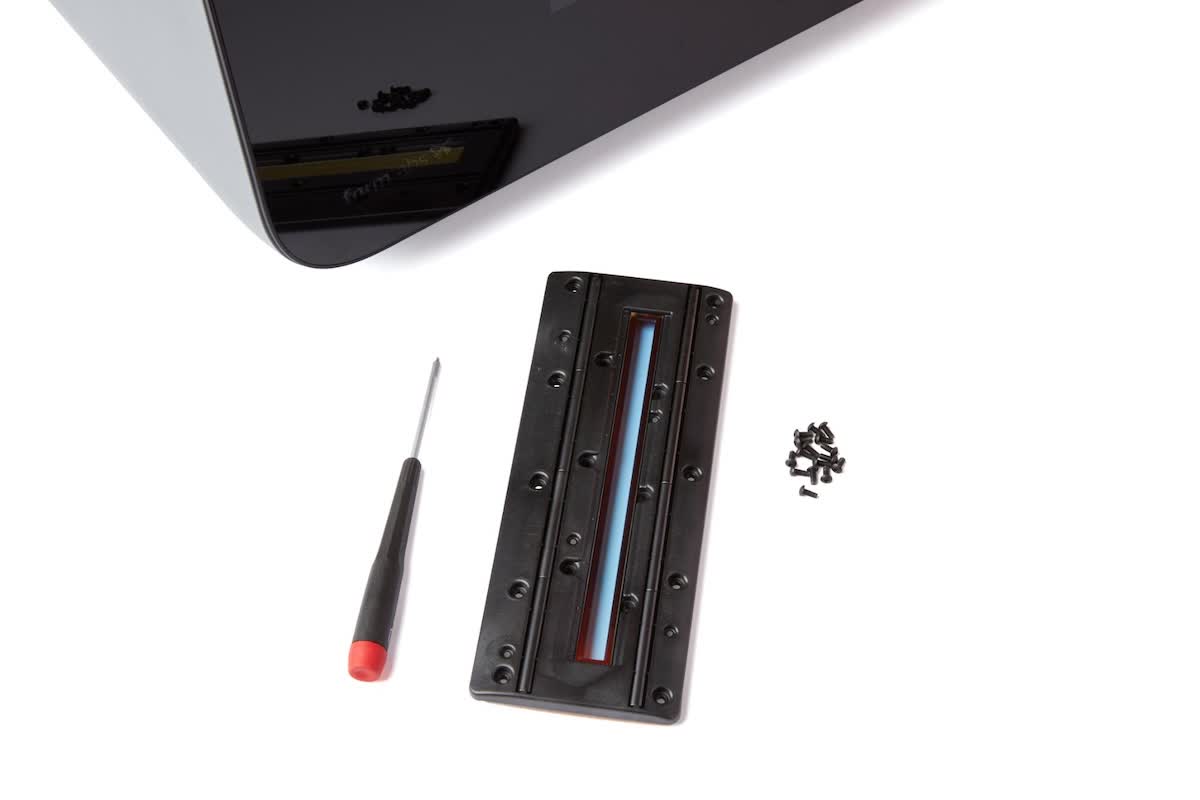

Step 3: Tighten the roller holder screws
Thread one of the included M2.5 screws into each of the 16 mounting holes on the roller holder. You may need to partially remove the protective film on the roller holder to access some mounting holes. Do not remove the protective film from the optical window.

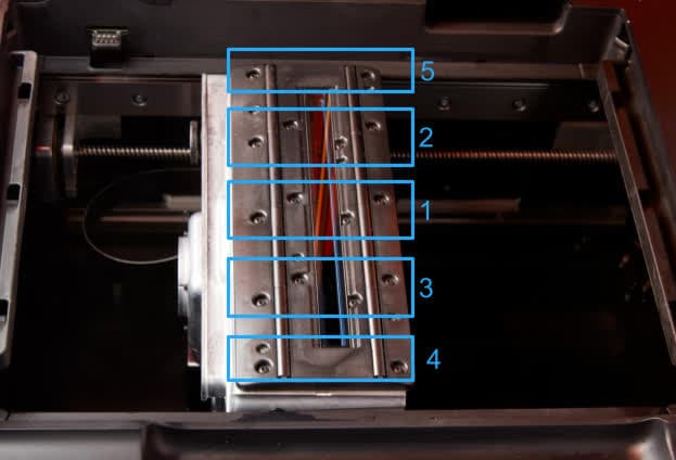

Using the included 1.5 mm hex driver, tighten the screws over the course of two passes, following the sequence shown below. Tighten all the screws in each numbered region before moving on to the next. On the first pass, fully thread the screws; on the second, tighten until each screw is finger tight. Use the long end of the hex driver (pressing on the short end) to avoid over-tightening the screws.
