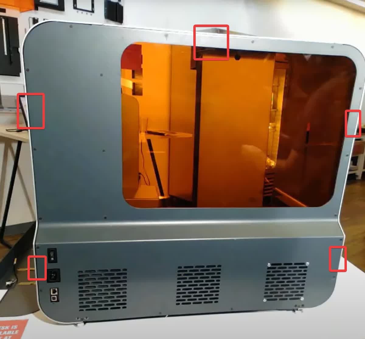

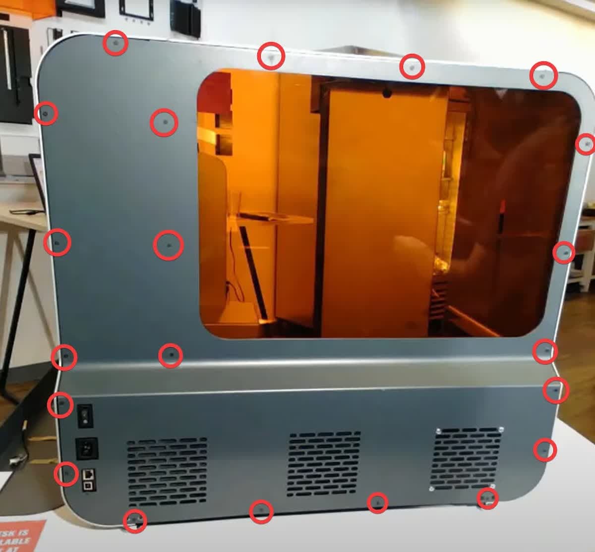

Step 2: Remove the rear shell screws
Use a T10 or T8 Torx driver to loosen and remove the 21 screws on the rear shell. Early models may use all T8 screws, while later models use all T10 screws. Start at the bottom of the panel and work your way up to the top.
Step 3: Remove the rear shell
Remove the rear shell by pulling it away from the printer. There are five pins that hold the panel in place, so it may require moderate force to separate from the printer. Be careful not to damage the rear fan cable, which is still attached to the rear shell. Lay the rear shell down next to the printer.

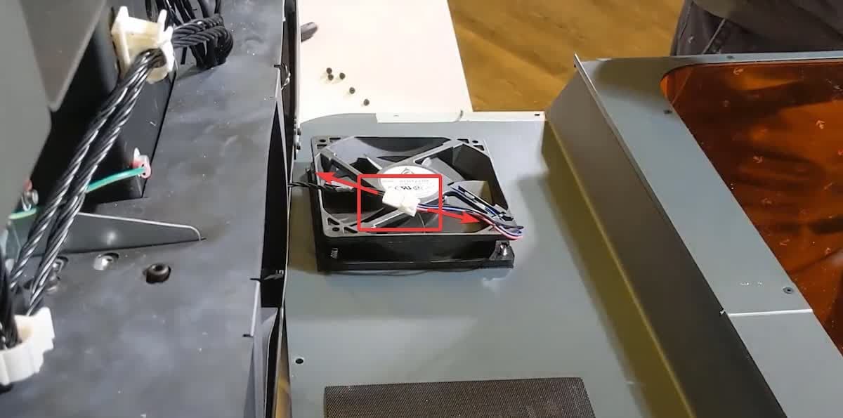

Step 4: Disconnect the rear fan
Disconnect the rear fan cable harness by gripping the plugs and gently pulling them away from each other. Do not pull on the wires themselves.

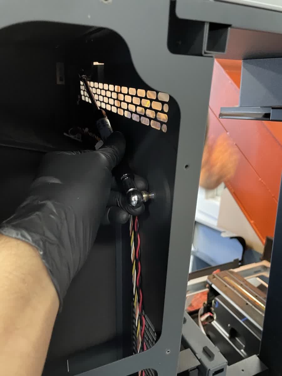

Step 2: Locate the retaining rings

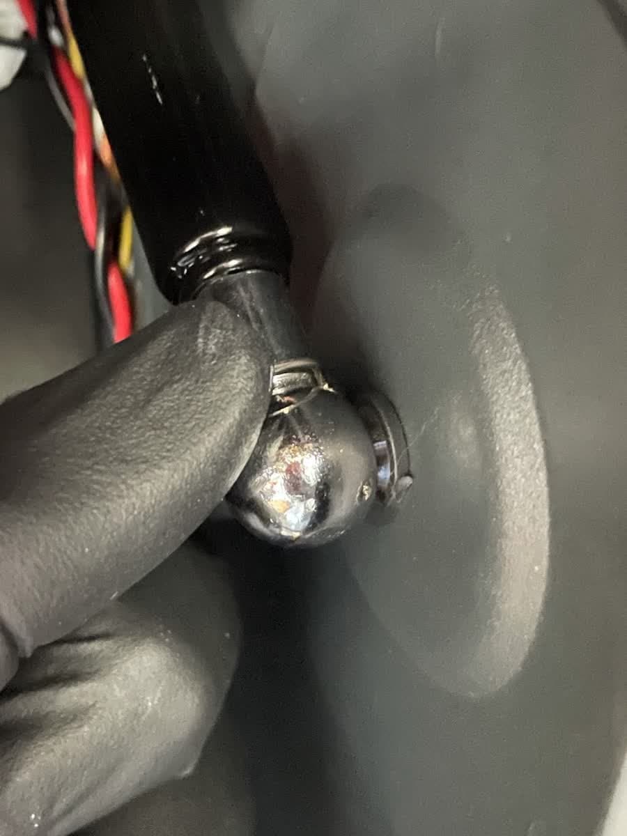

A retaining ring is located at each end of the gas spring. Note the orientation of the retaining rings for reinstallation. To unlock a retaining ring, rotate it until the curved section of the retaining ring unhooks from the shaft of the gas spring.
Step 3: Remove the retaining ring
Slide the retaining ring towards the center of the gas spring to remove it. Repeat for the second retaining ring.
Step 4: Remove the gas spring
Two people are required for this step. Have one person lift the cover slightly past its open position. Have the second person grasp the rear end of the gas spring and pull it away from the wall to which it is attached. Once one end of the gas spring is detached, the person holding the cover must support the full weight of the cover.

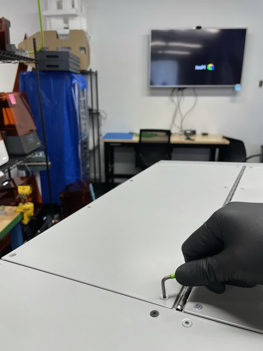

Step 1: Remove the hinge screws
Remove the four hex screws from the top panel near the cover hinge using a 2.5 mm hex driver.

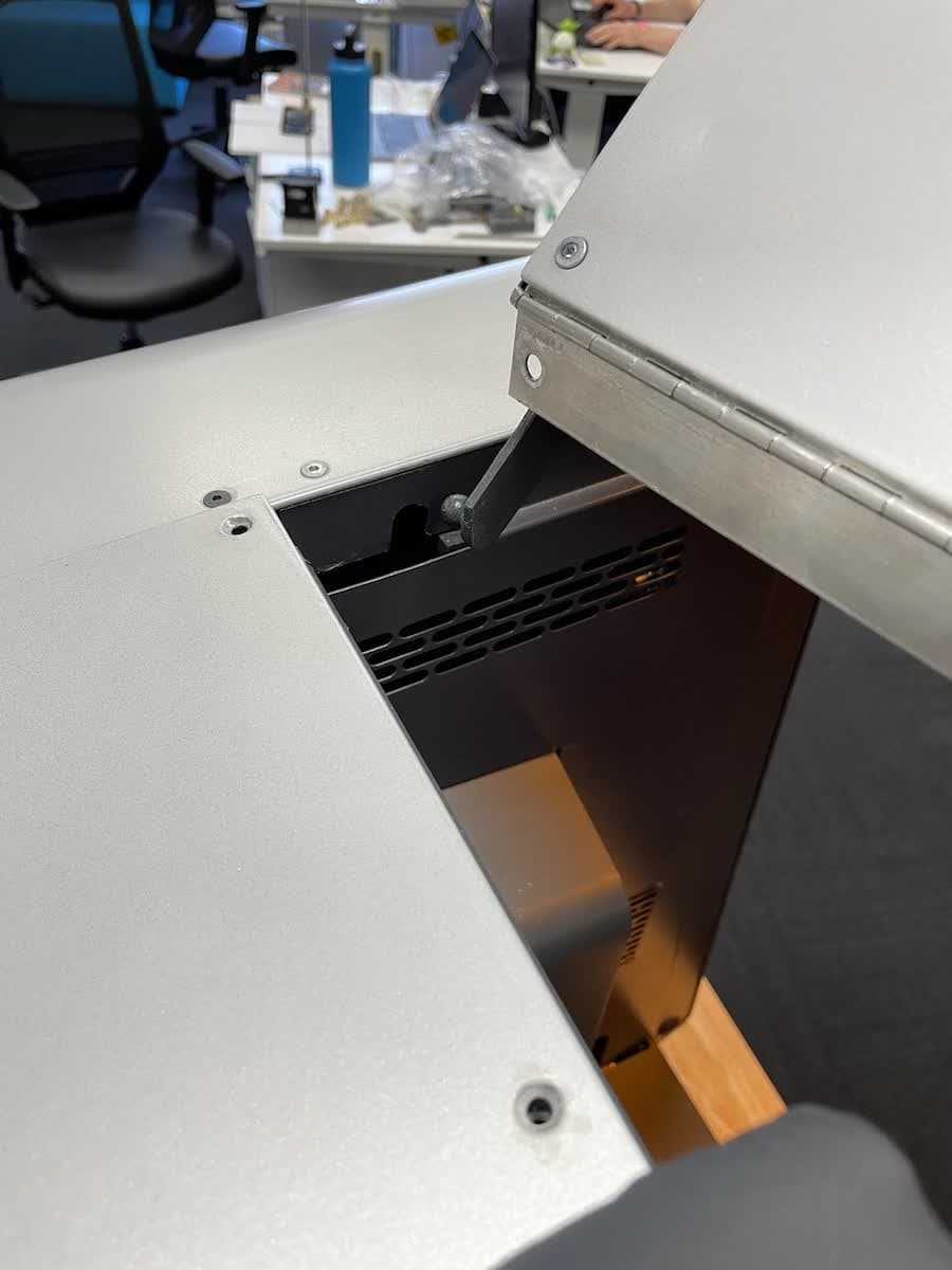

Step 2: Remove the cover
Two people are required for this step. Have both people lift the cover at an angle and pull outward, being mindful of the gas spring arm on the right side of the cover. If you are replacing the cover, set aside the cover for disposal.

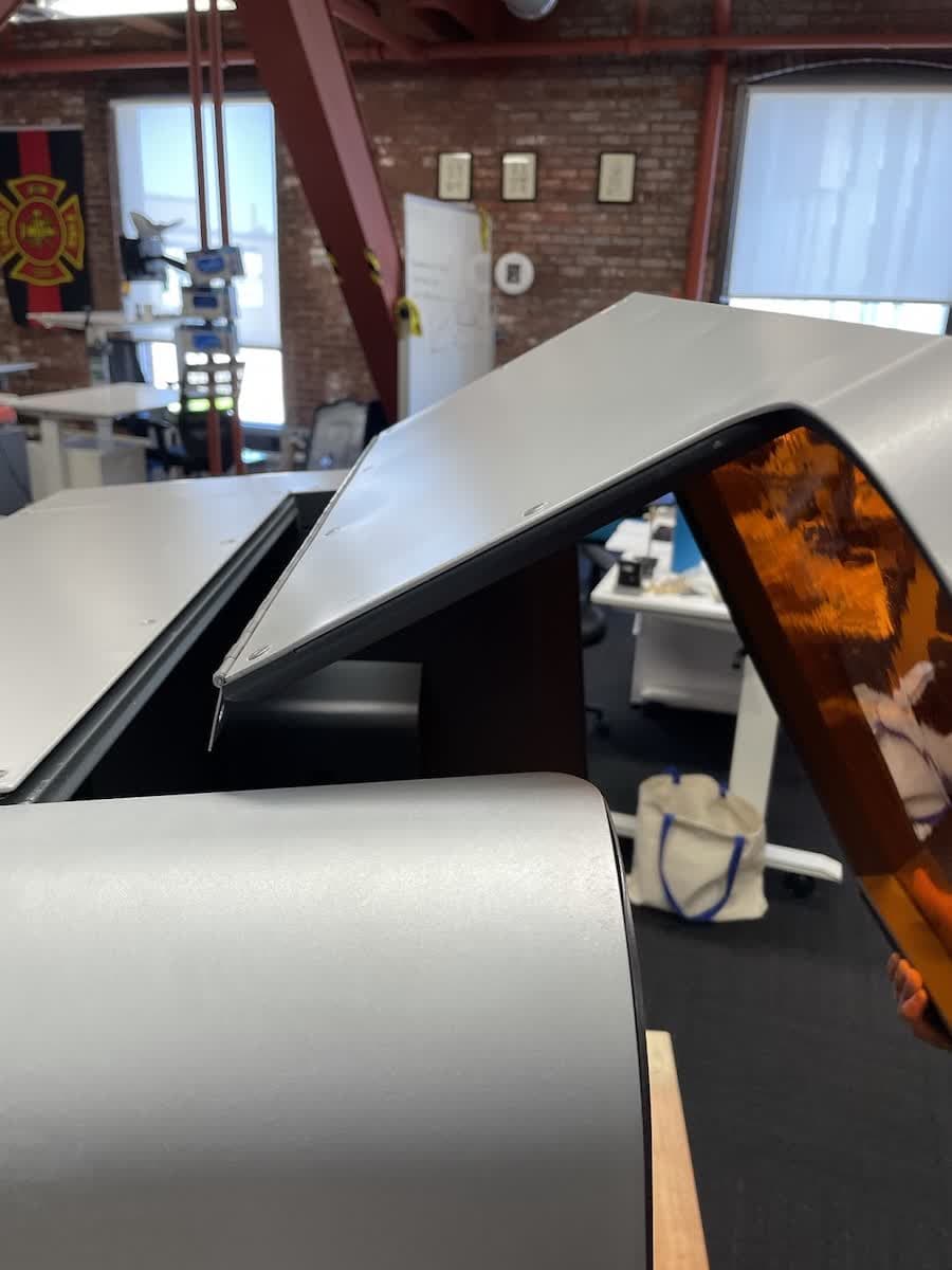

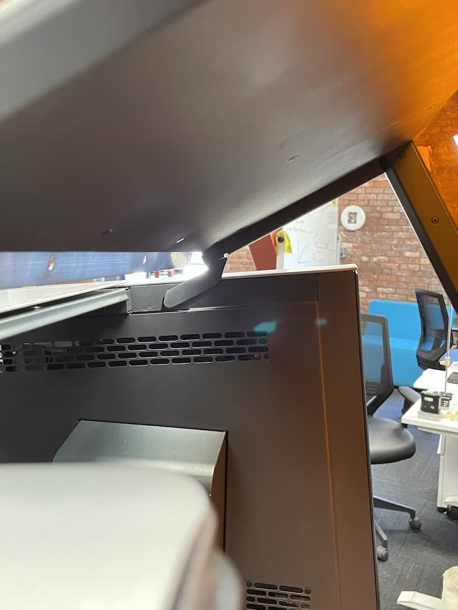

Step 1: Adjust the gas spring arm
Two people are required for this step. While one person lifts the cover into position over the cavity, the second person manually maneuvers the gas spring arm into the hole on the printer chassis.

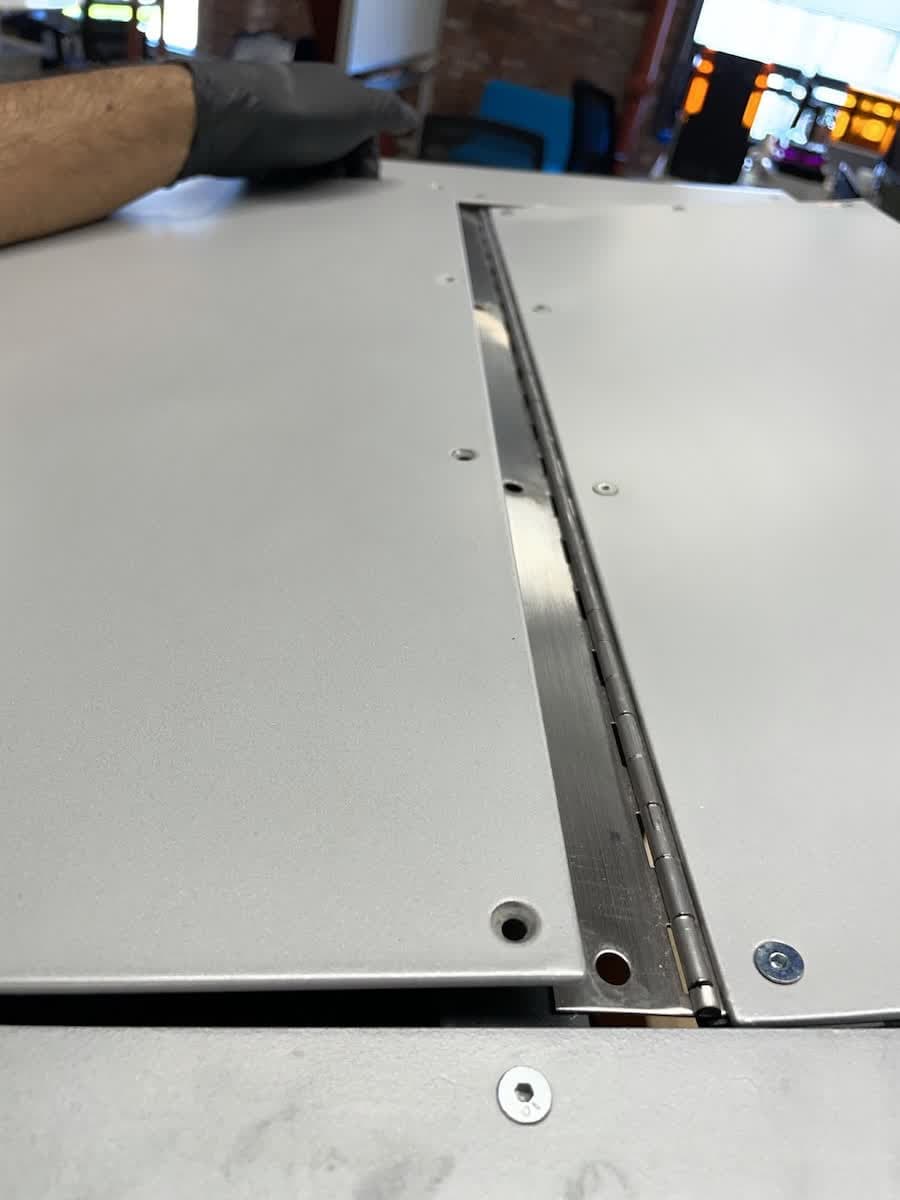

Step 2: Slide the cover hinge under the top panel
Lower the cover. Gently lift the top panel on the printer and slide the cover hinge underneath. Align the four screw holes on the cover hinge and the top panel.
Step 3: Reinstall the hinge screws
Using a 2.5 mm hex screwdriver, install the four hex screws on the top panel to secure the cover. Verify the cover can open and close unobstructed. Loosen screws and adjust the front panel if needed.

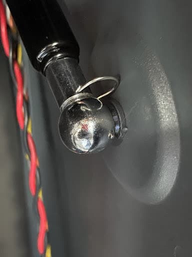

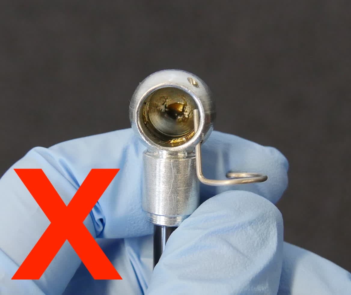

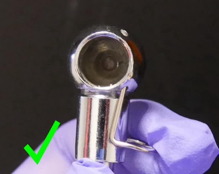

Step 1: Insert retaining ring into extended end of the gas spring
The retaining ring holes can be difficult to locate and access after the gas spring is installed. To ease installation, partially insert one retaining ring through the hole in the socket at the extended end of the gas spring. Only insert it through one hole; the ring should not be visible inside the gas spring socket. Hold the retaining ring in place inside the gas spring with your thumb and index finger. Keep the retaining ring in this position when inserting the extended end of the gas spring into the printer.
Step 2: Install and secure the extended end of the gas spring
Leave the cover in the downward position. With the retaining ring kept in place with your thumb and forefinger, install the extended end of the gas spring onto the ball on the cover. Press the gas spring socket onto the ball until you hear an audible click. Note that installation of the retaining ring is not possible if the socket is not correctly attached to the ball.
Use your thumb and index finger to fully insert the retaining ring into the socket, then rotate the retaining ring about the shaft and press firmly into place to lock the gas spring in place. The retaining ring should sit in the groove between the gas spring and shaft.

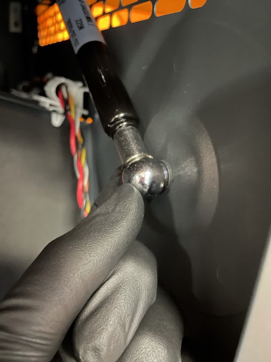

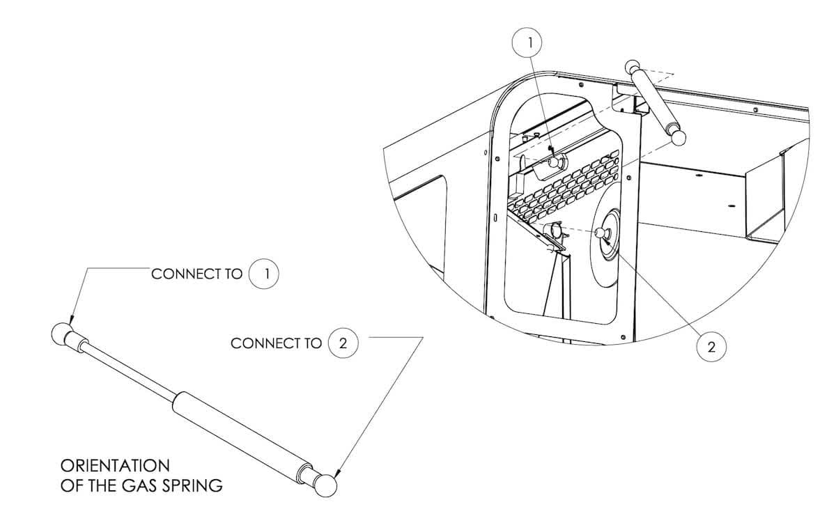

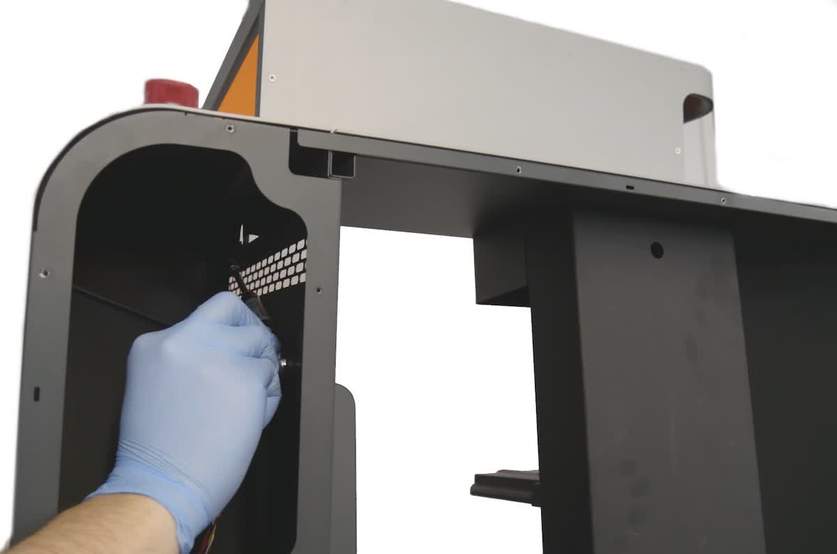

Step 3: Install the rear end of the gas spring
Raise and hyperextend the cover. One person keeps the cover in place while the other installs the rear end of the gas spring.
Press the gas spring socket onto the ball at the rear of the printer until you hear an audible click. Note that installation of the retaining ring is not possible if the socket is not correctly attached to the ball.

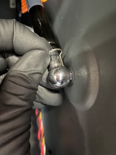

Step 4: Install the retaining ring
Install the retaining ring on the rear end of the gas spring. The long end of the retaining ring slides through the small holes in the gas spring socket.
Rotate the retaining ring about the shaft and press firmly into place to lock the gas spring in place.
