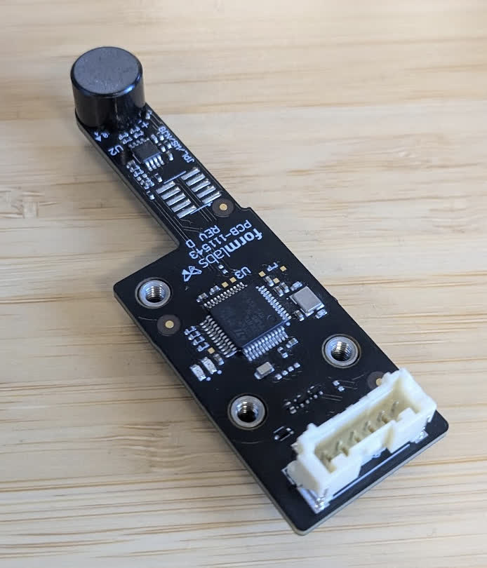

The LevelSense Board senses the amount of resin in the resin tank. The LevelSense Board sits at the left side of the tower in the printer. A malfunctioning LevelSense Board may prevent the printer from printing properly.

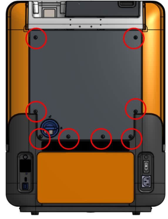

Step 1: Remove the back panel screws
Use a 2.5 mm hex driver to remove the eight screws securing the back panel to the printer. Set the screws aside.
Removing the Form 4 back panel screws

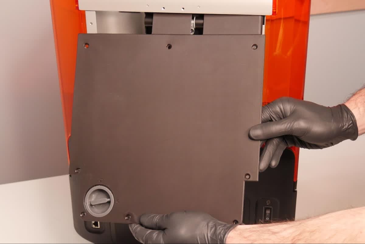

Step 2: Remove the back panel
Remove the back panel by sliding it down and away from the back of the printer. Set the back panel aside.

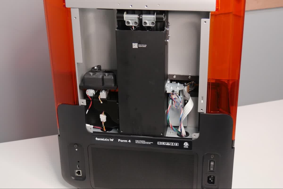

Form 4 with back panel removed

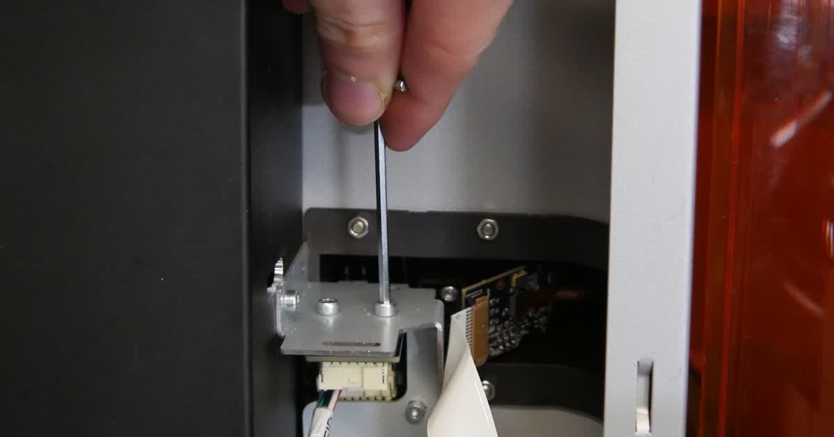

Step 1: Remove the LevelSense board mounting screws
Use a 2.5 mm hex driver to remove the three screws securing the LevelSense board to the metal bracket. Set the screws aside.
Removing the Form 4 LevelSense board mounting screws

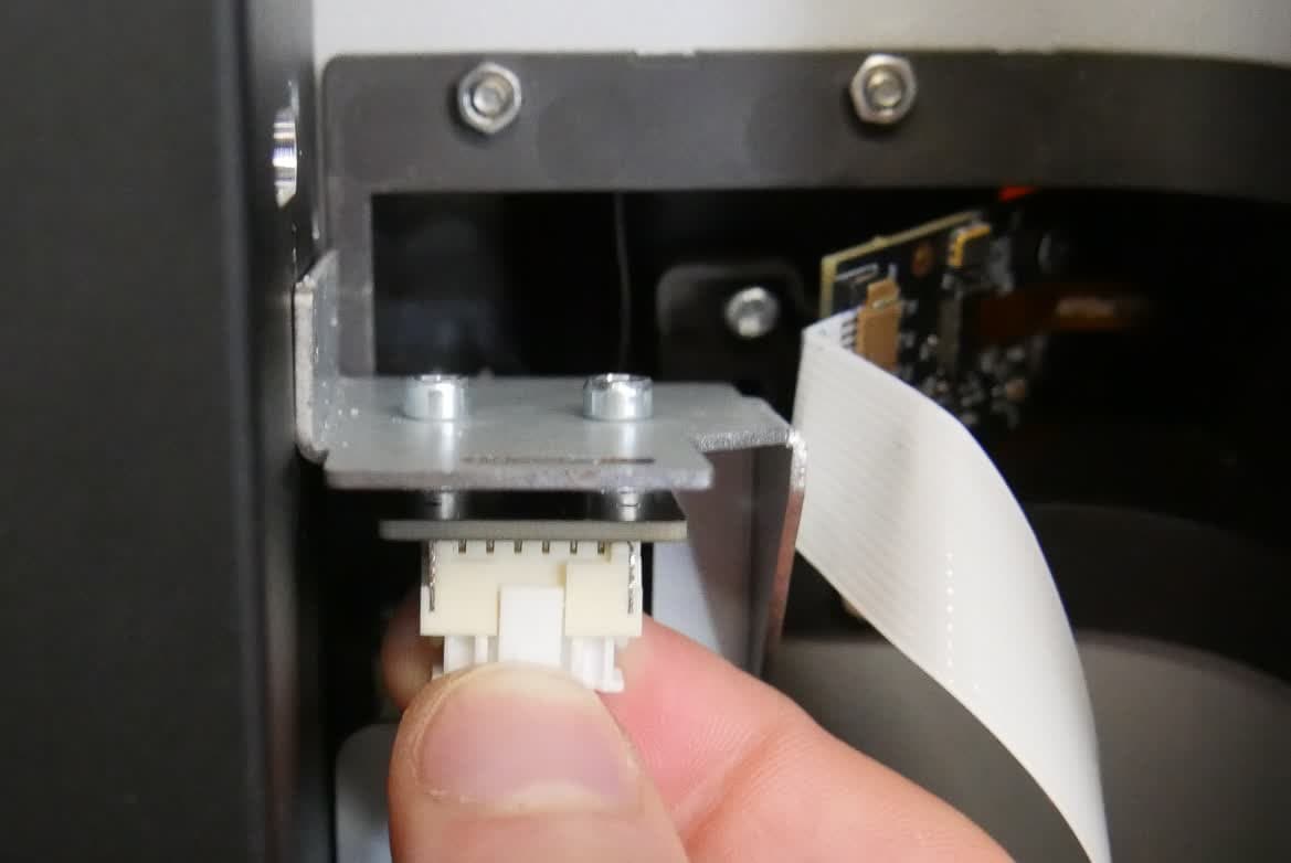

Step 2: Disconnect the LevelSense board cable
Press the plastic tab on the connector to release the cable that connects to the LevelSense board. Once the plastic tab is pressed, the cable will easily slide from the connector. Do not pull on the wires. Remove the LevelSense board and set it aside for disposal with electronic waste.
Unplugging the Form 4 LevelSense board

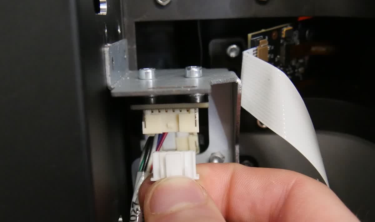

Step 1: Connect the cable
Reconnect the cable that connects the LevelSense board. The connector makes an audible and tactile click when secured.
Reconnecting the LevelSense board cable
Step 2: Install the mounting screws
Position the LevelSense board so that the screw holes align with the holes in the bracket. Use a 2.5 mm hex driver to tighten the three screws that secure the LevelSense board to the printer tower. Tighten until snug.
Reinstalling the Form 4 LevelSense board mounting screws

Step 1: Mount the back panel
Slide the top edge of the back panel under the cover bracket. Ensure that the eight screw holes in the back panel align with the corresponding holes in the printer and the back panel sits flush with the sides of the cover.
Mounting the Form 4 back panel
