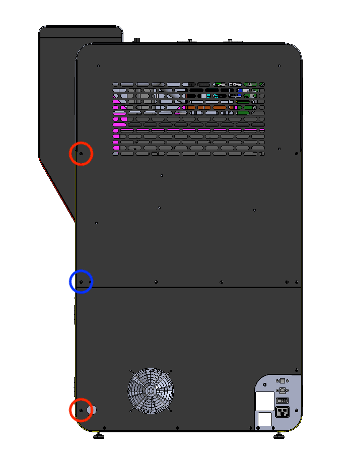

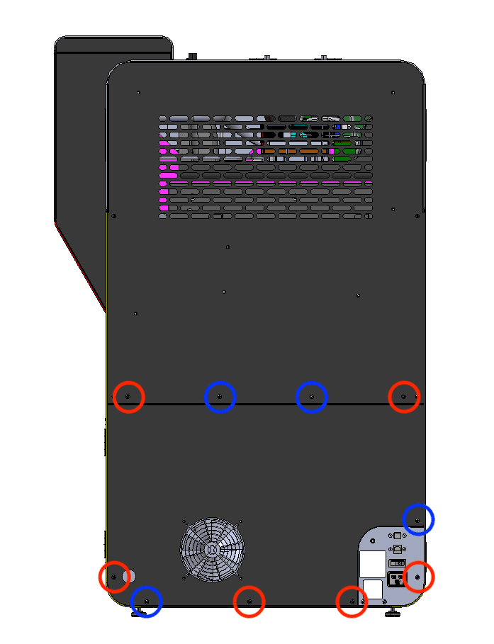

Step 1: Remove the lower rear panel screws
The six black lower rear panel screws are circled in red. The four chrome lower rear panel grounding screws are circled in blue.
Using a 2.5 mm hex driver, remove the six black panel screws and the four chrome panel grounding screws securing the lower rear panel to the printer. Set the screws aside, taking care to separate the black and chrome screws for later reinstallation.

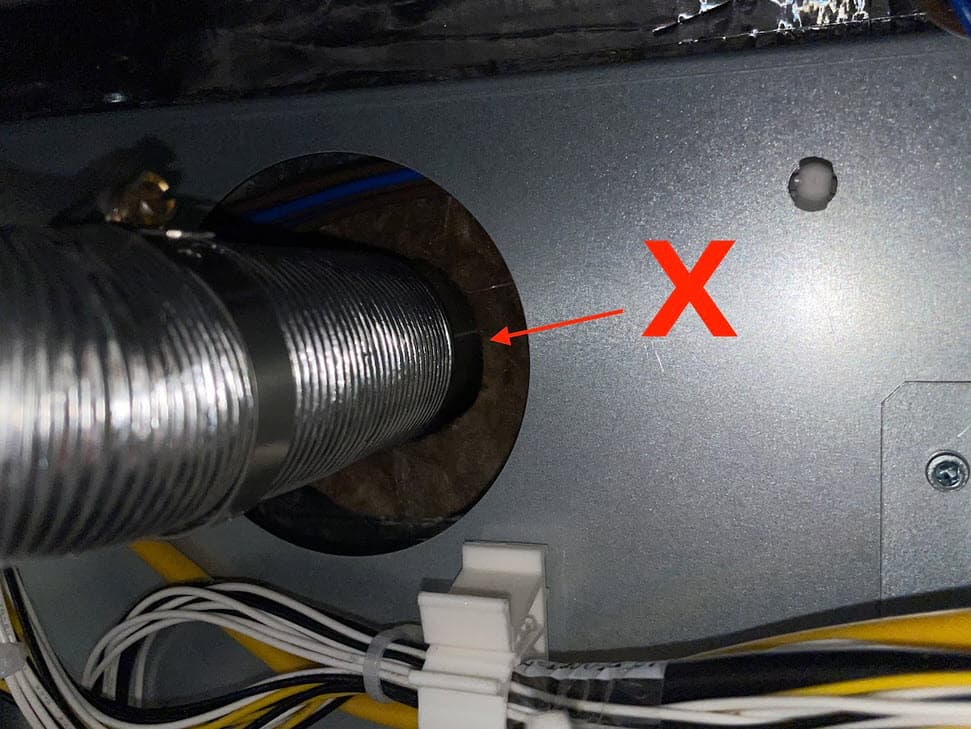

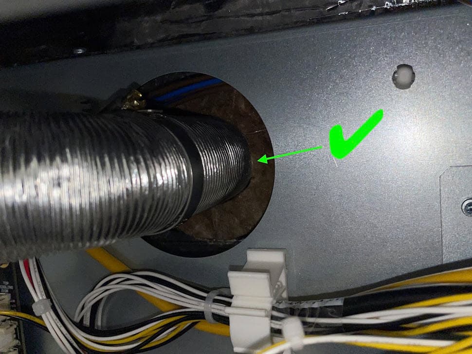

Step 3: Locate the exhaust duct and ring clamp
Locate the ring clamp attached to the exhaust duct in the center of the printer.
Step 4: Loosen the ring clamp screw
Using a 6.5 mm flathead screwdriver, loosen the ring clamp screw. Do not remove the screw. Pull the exhaust duct away from the exhaust pipe.

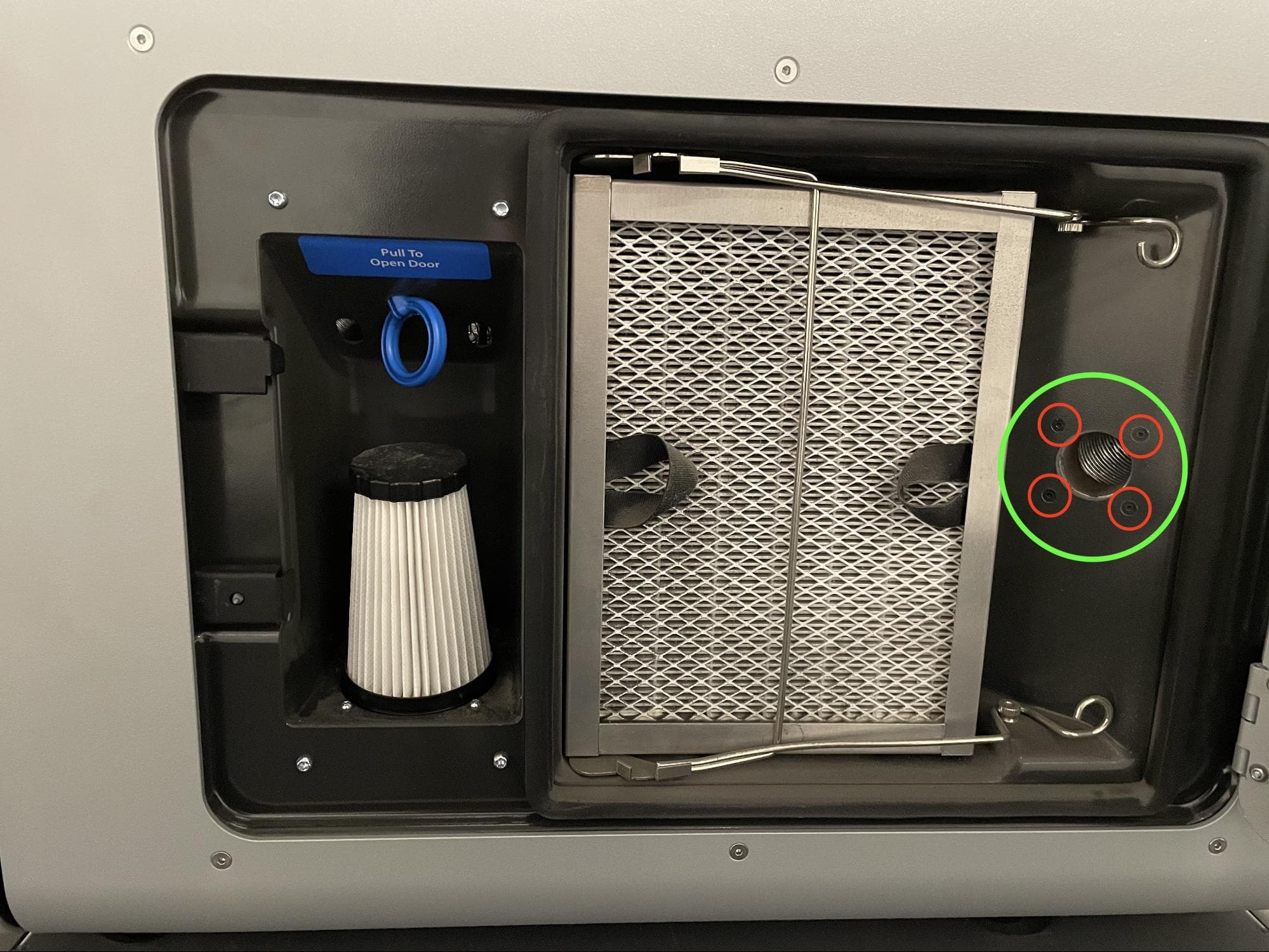

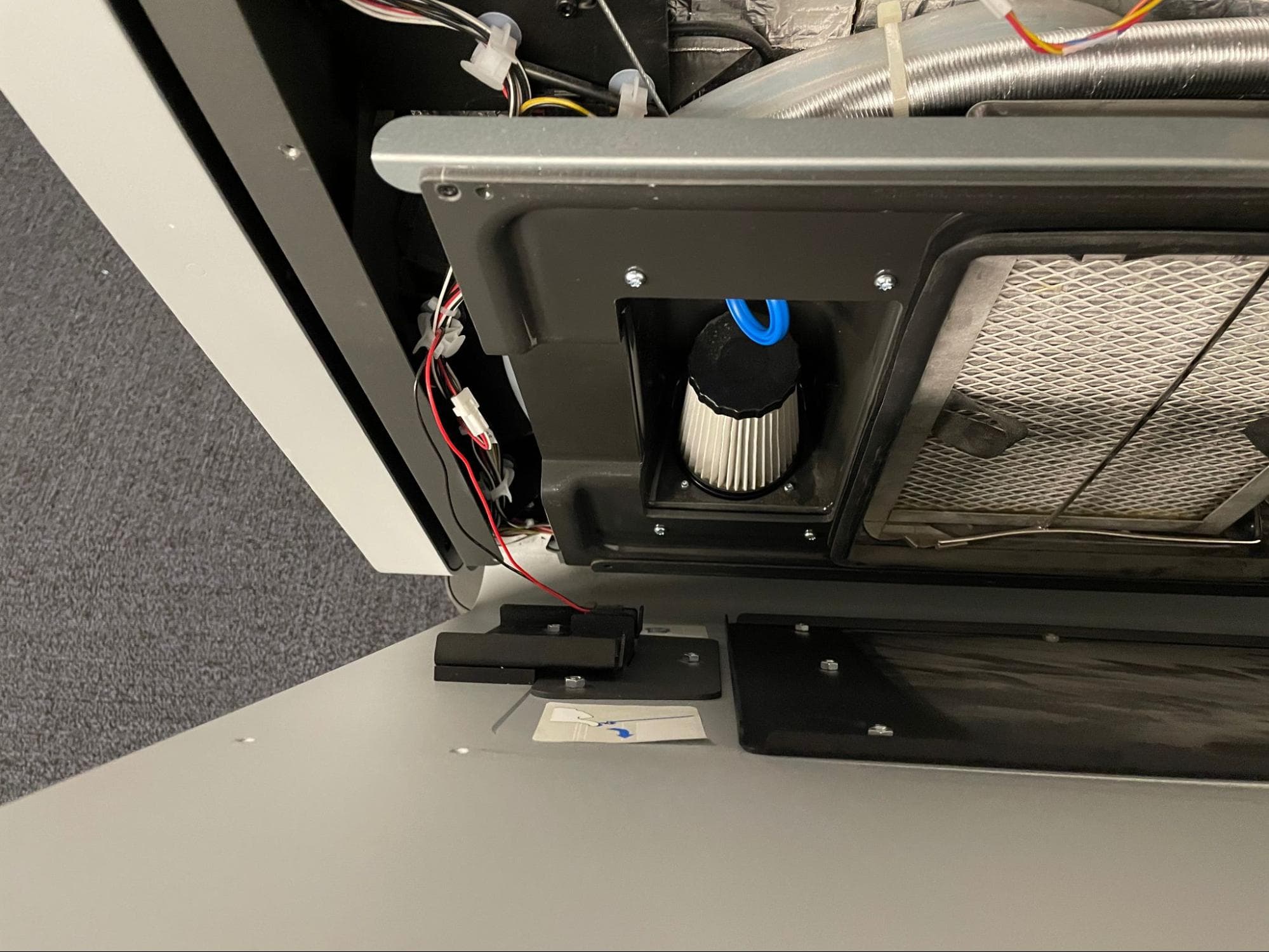

Step 5: Locate the exhaust inlet
Open the filter cabinet door on the printer. Locate the exhaust inlet on the right side of the cabinet.
Step 6: Remove the exhaust inlet screws
Using a 2.0 mm hex driver, remove the four screws attaching the exhaust inlet to the filter cabinet. Set the screws aside.

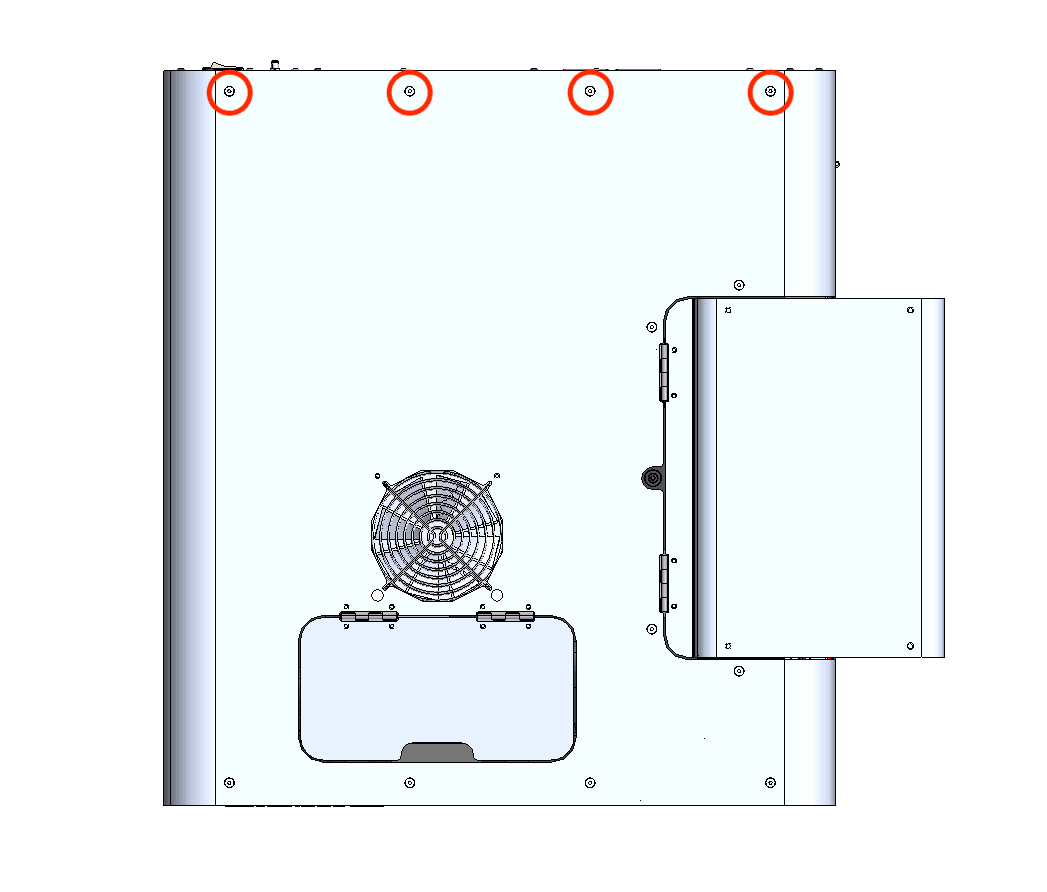

Step 8: Remove the upper rear panel screws
Using a 2.5 mm hex driver, remove the eight screws securing the upper rear panel to the printer:
  • Two 6 mm screws on the buffer side of the printer
  • Four 6 mm screws on the top of the printer
  • Two 6 mm screws on the hopper side of the printer

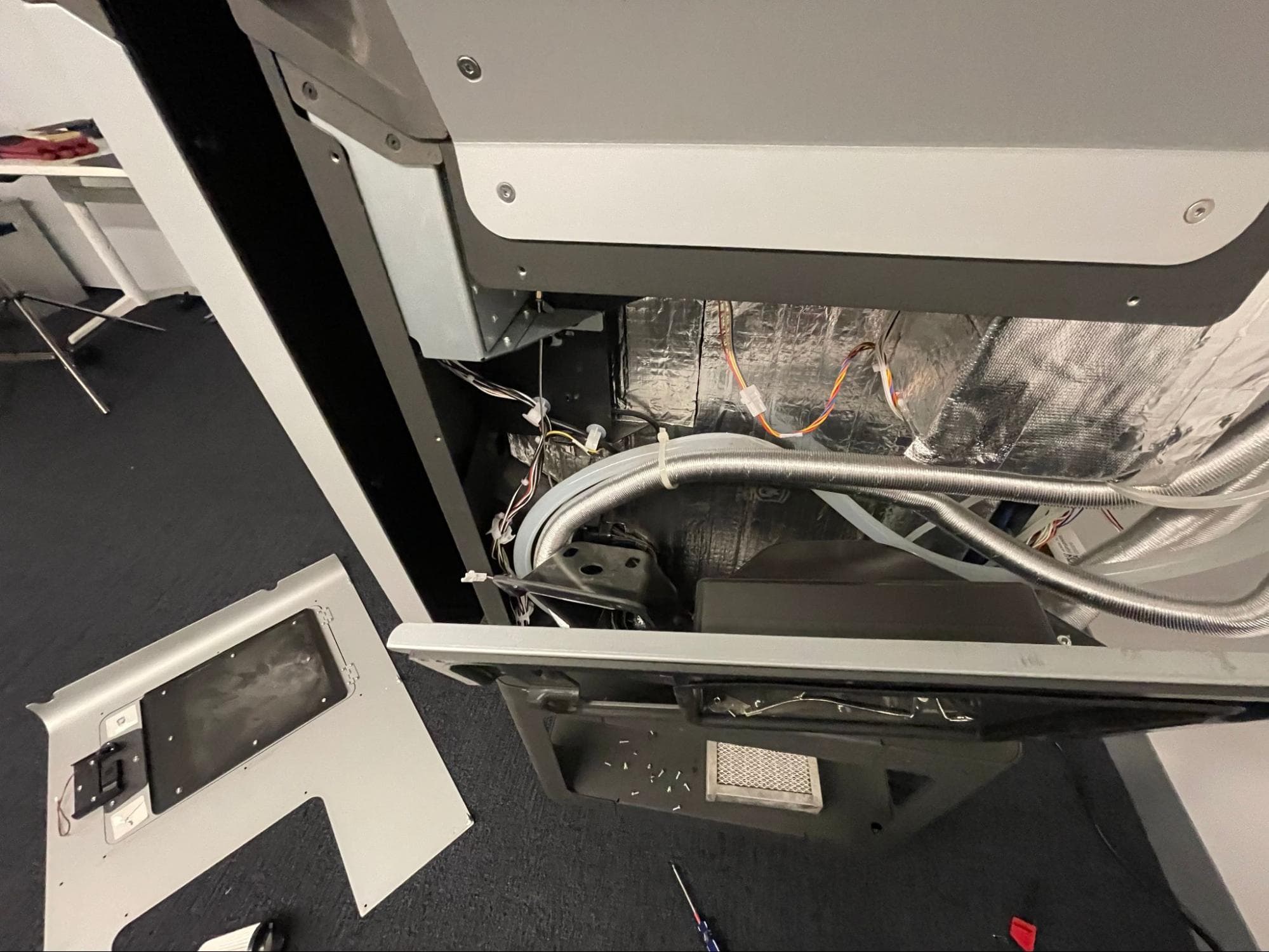

Step 9: Remove the upper rear panel
Pull the upper rear panel straight back and away from the printer. Lay it down on a flat, clean surface.

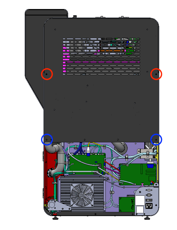

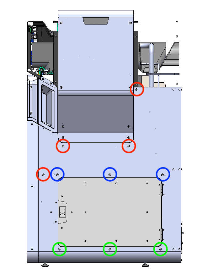

Move to the hopper side of the printer. Using a 2.5 mm hex driver, loosen and remove the 10 M4 countersunk screws holding the hopper-side panel to the printer. Remove the top-most 6.0 mm countersunk screws last to make removing the panel easier. Set the screws aside.
  • Three 16.0 mm screws, circled in green
  • Three 12.0 mm screws, circled in blue
  • Four 6.0 mm screws, circled in red
Remove the top & hopper-side panels

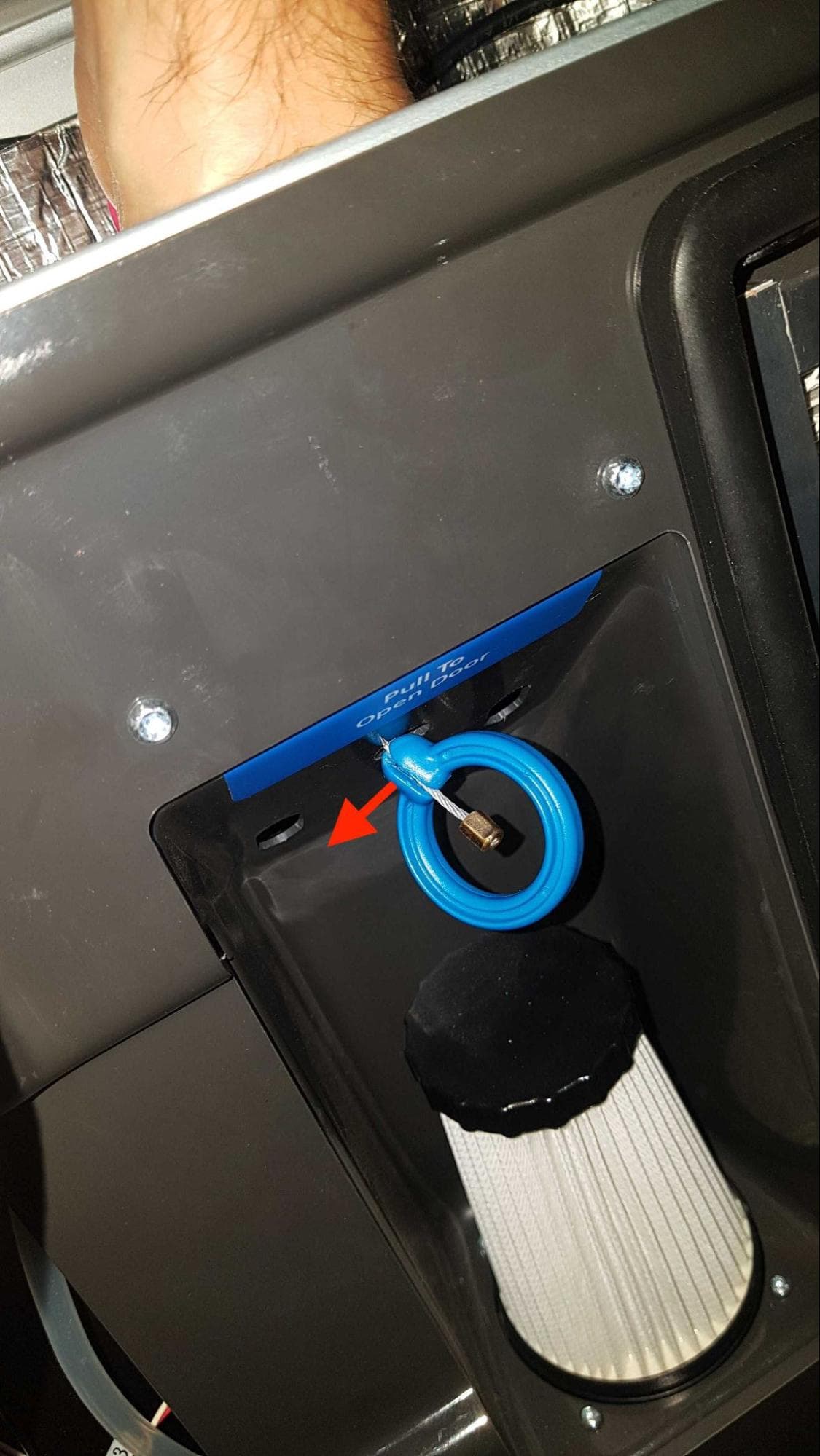

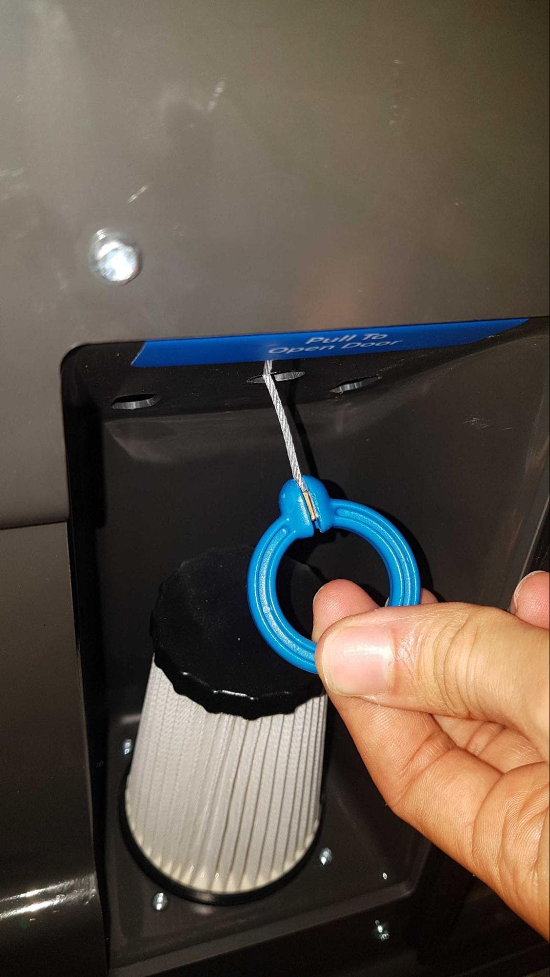

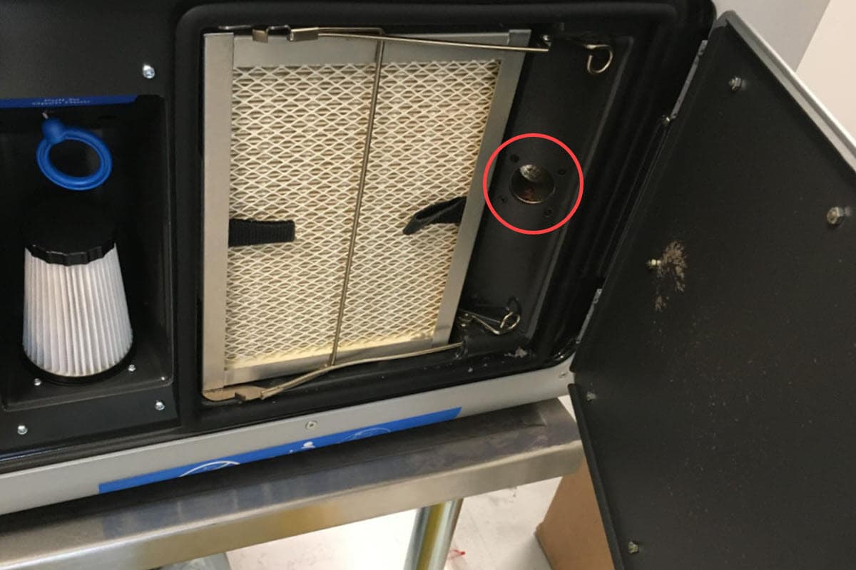

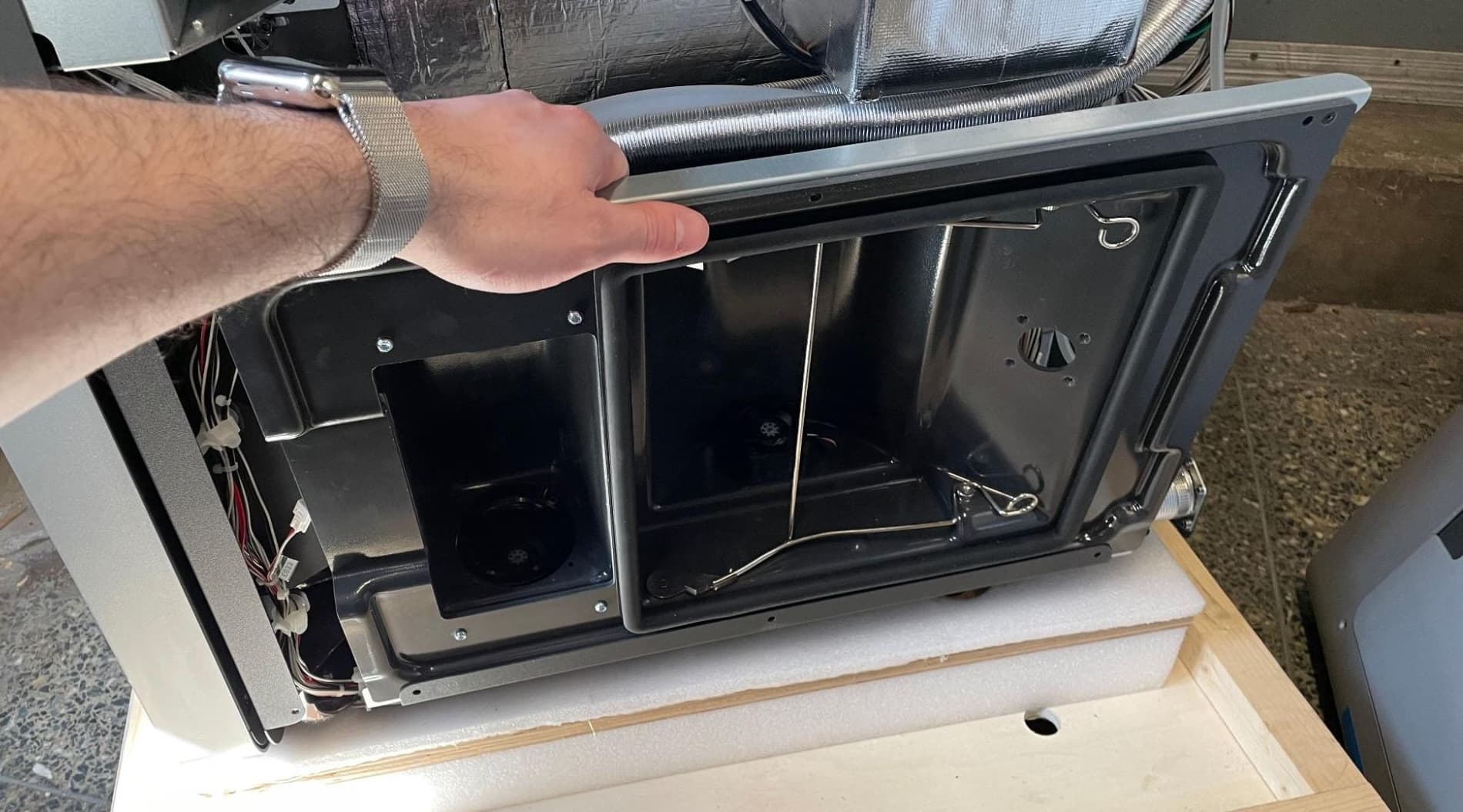

Step 1: Open the print enclosure door

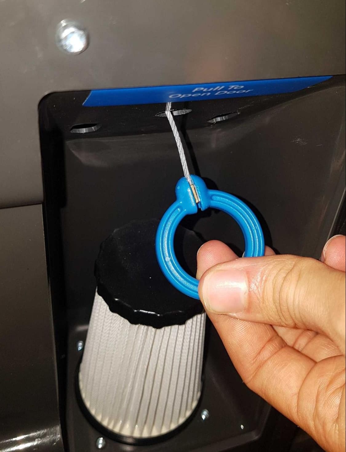

Open the print enclosure door by pulling the manual release handle in the filter cabinet.
Step 2: Remove the manual release handle
Remove the build chamber socket & cable harness
Pull the cable through the manual release handle to expose the ferrule, then slide the cable out of the handle. Set the manual release handle aside.

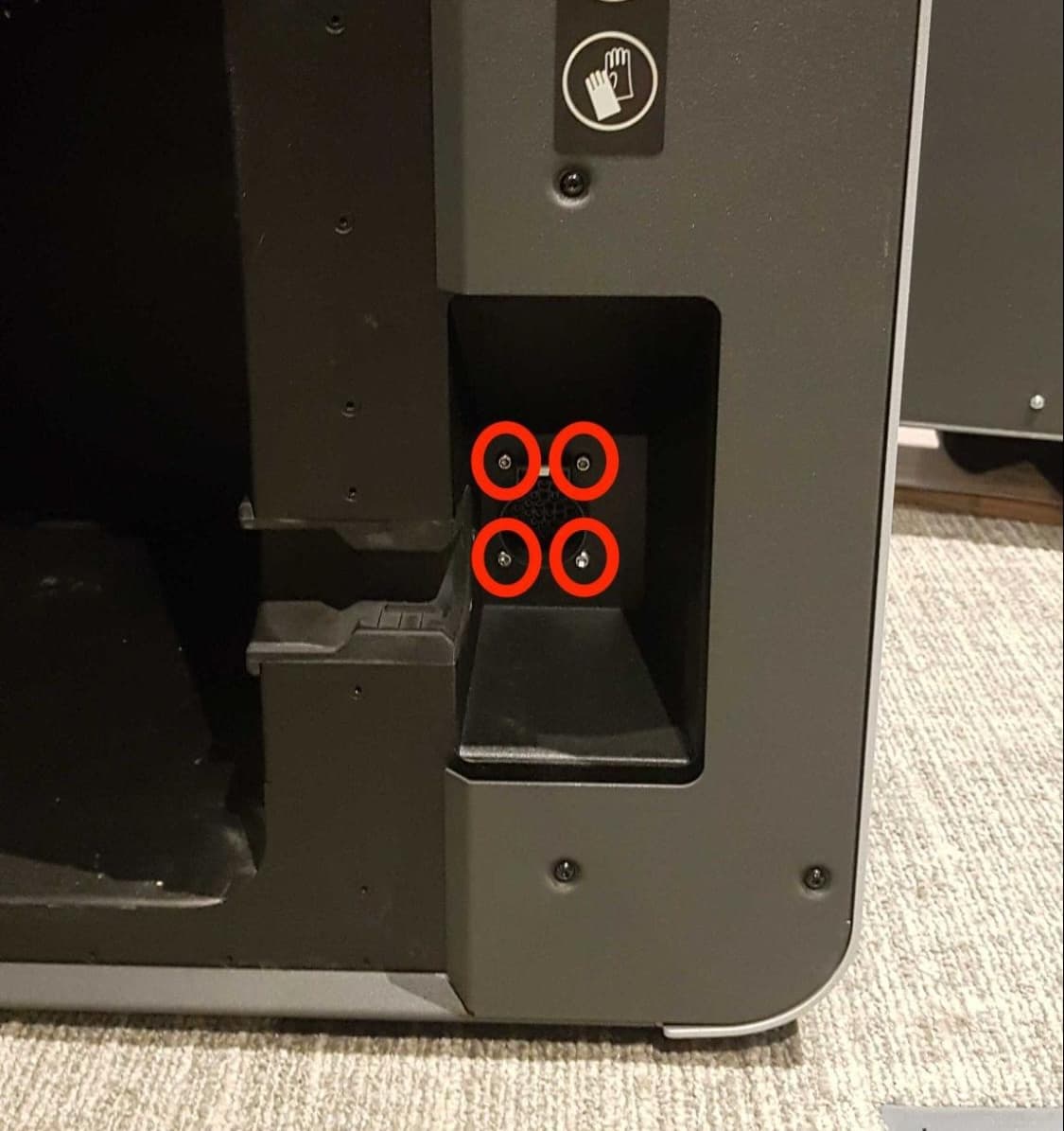

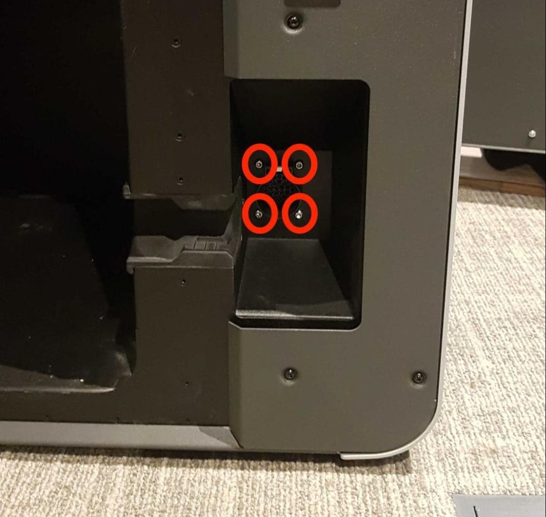

Step 3: Remove the build chamber socket mounting screws
On the front of the printer, use a 2.5 mm hex driver to loosen and remove the four M4 screws that secure the build chamber socket. Set the screws aside.

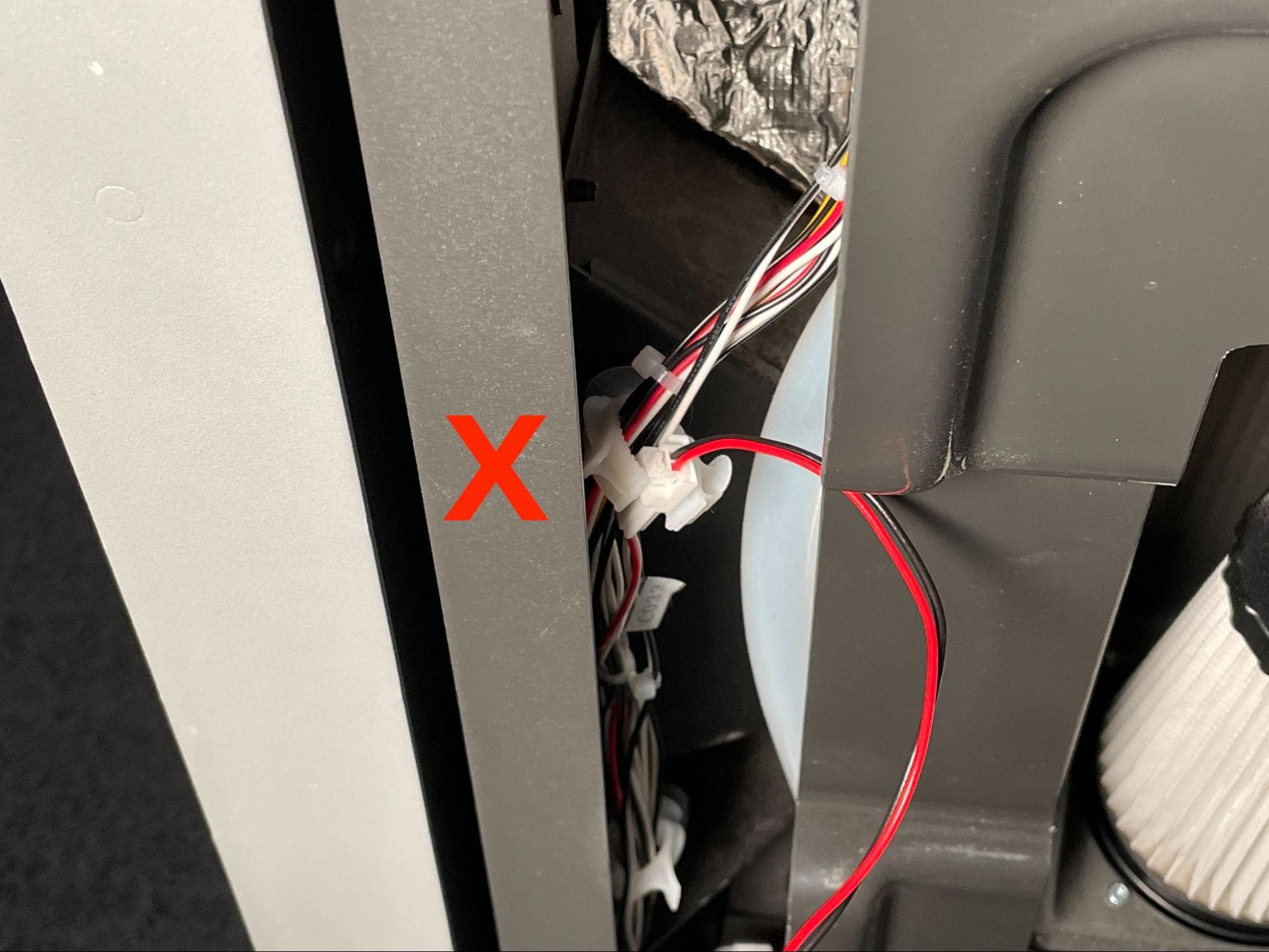

Step 4: Separate the filter cabinet from the printer frame

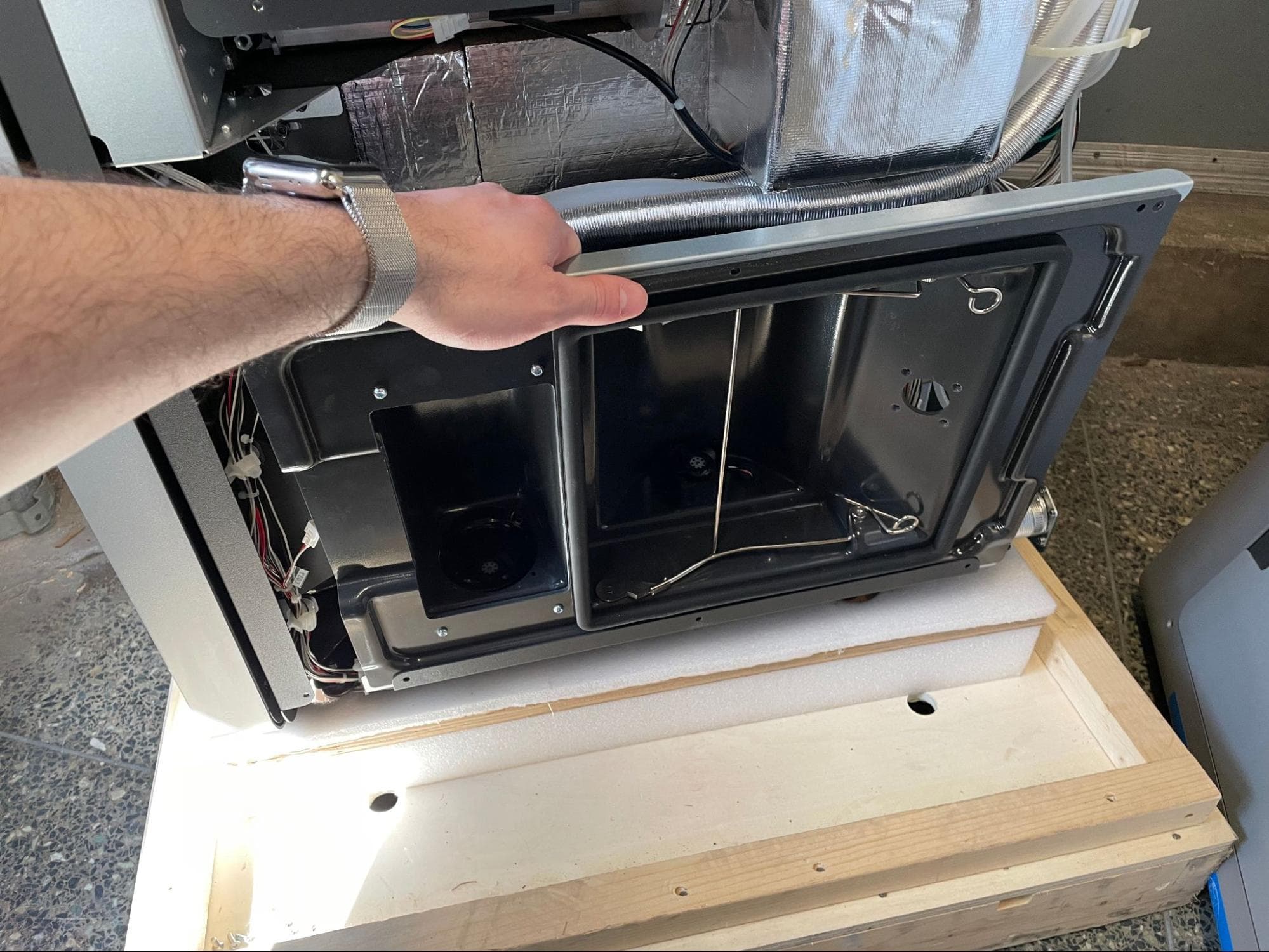

Grip the top frame of the plastic filter cabinet, then tilt it forward so the top edge clears the insulation directly above it. Gently pull the filter cabinet up and away from the frame, then let it hang off of the side of the printer. Do not pull the filter cabinet completely away from the printer. It is still attached via the exhaust fan cable and exhaust duct, which may be damaged.

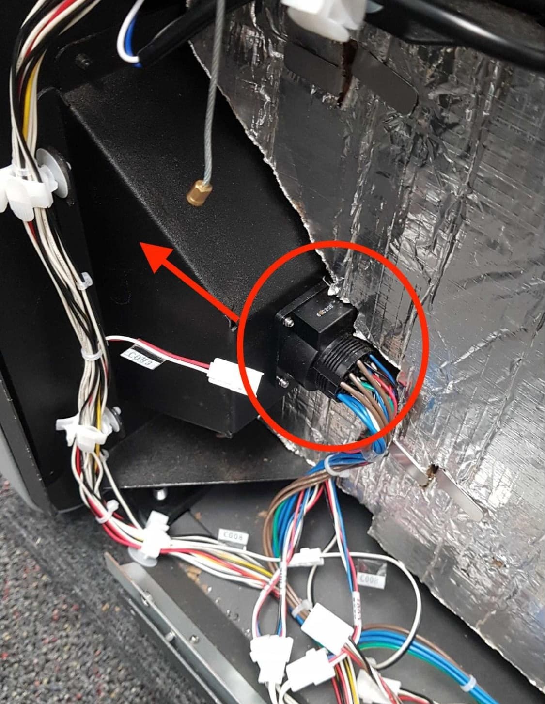

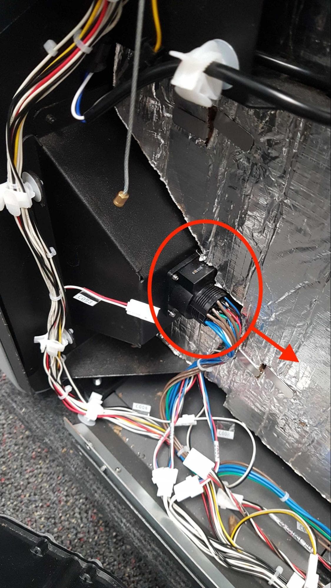

Step 5: Unmount the build chamber socket
Pull the build chamber socket towards the rear of the print, away from its mount. Do not pull on the individual wires.

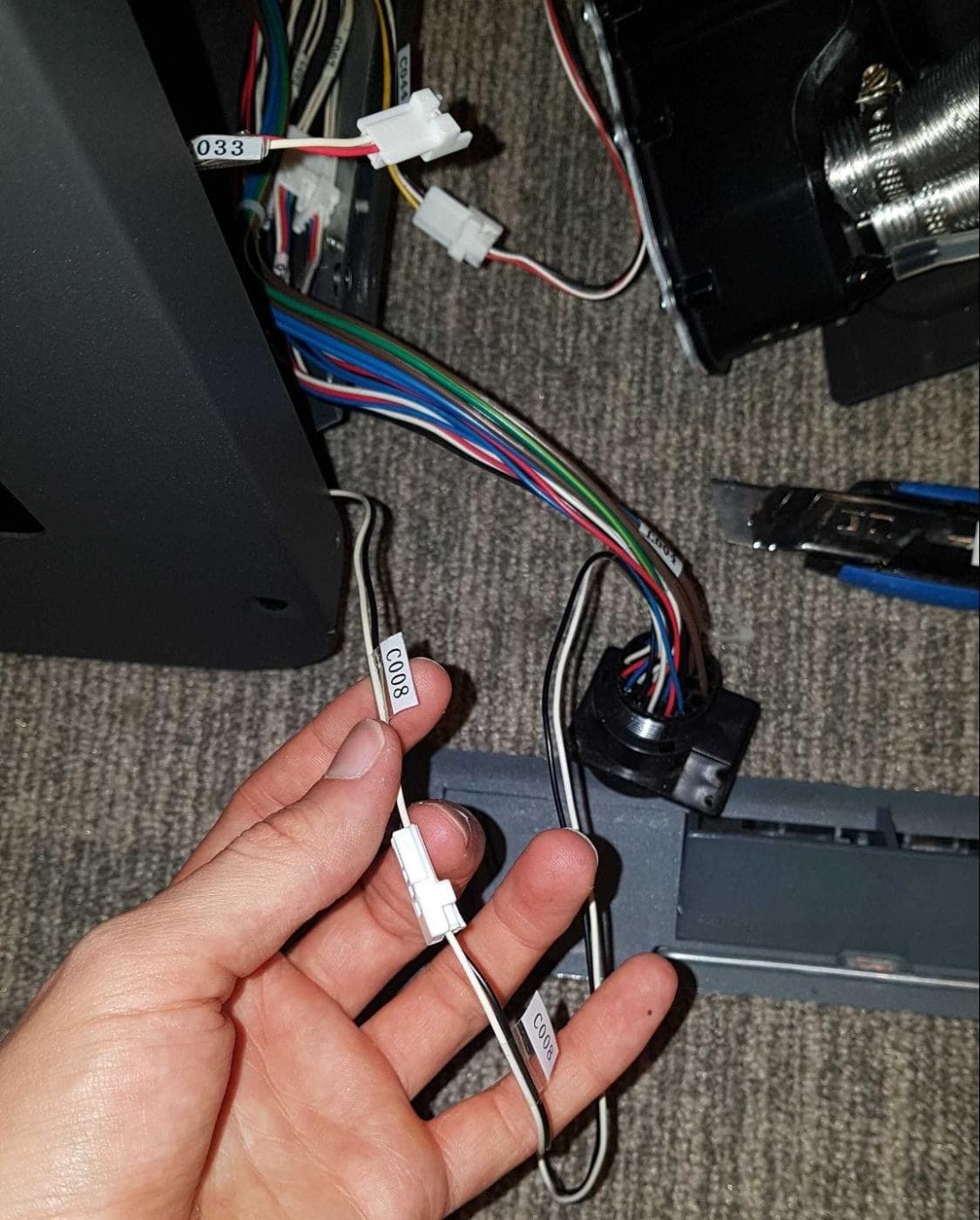

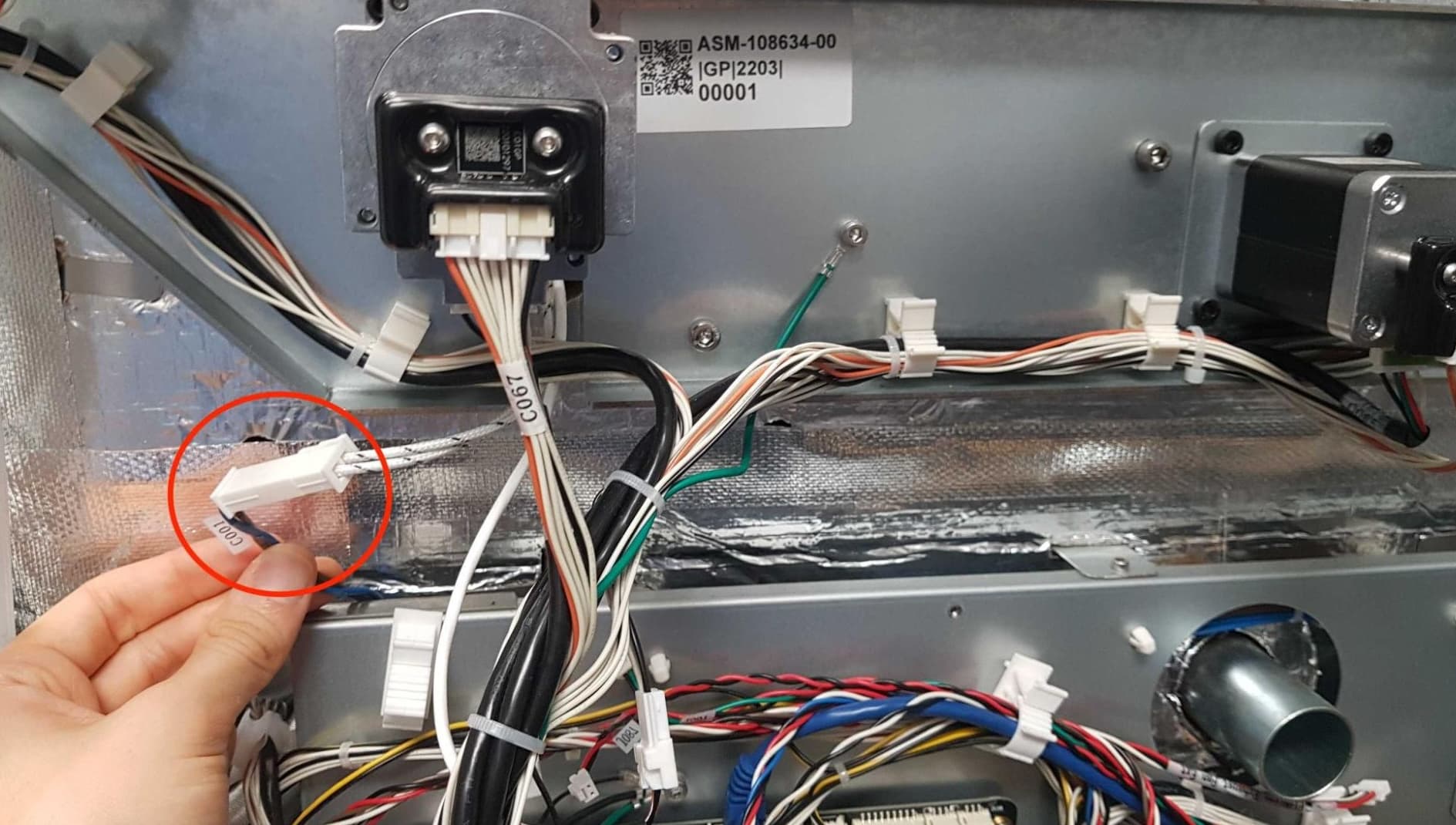

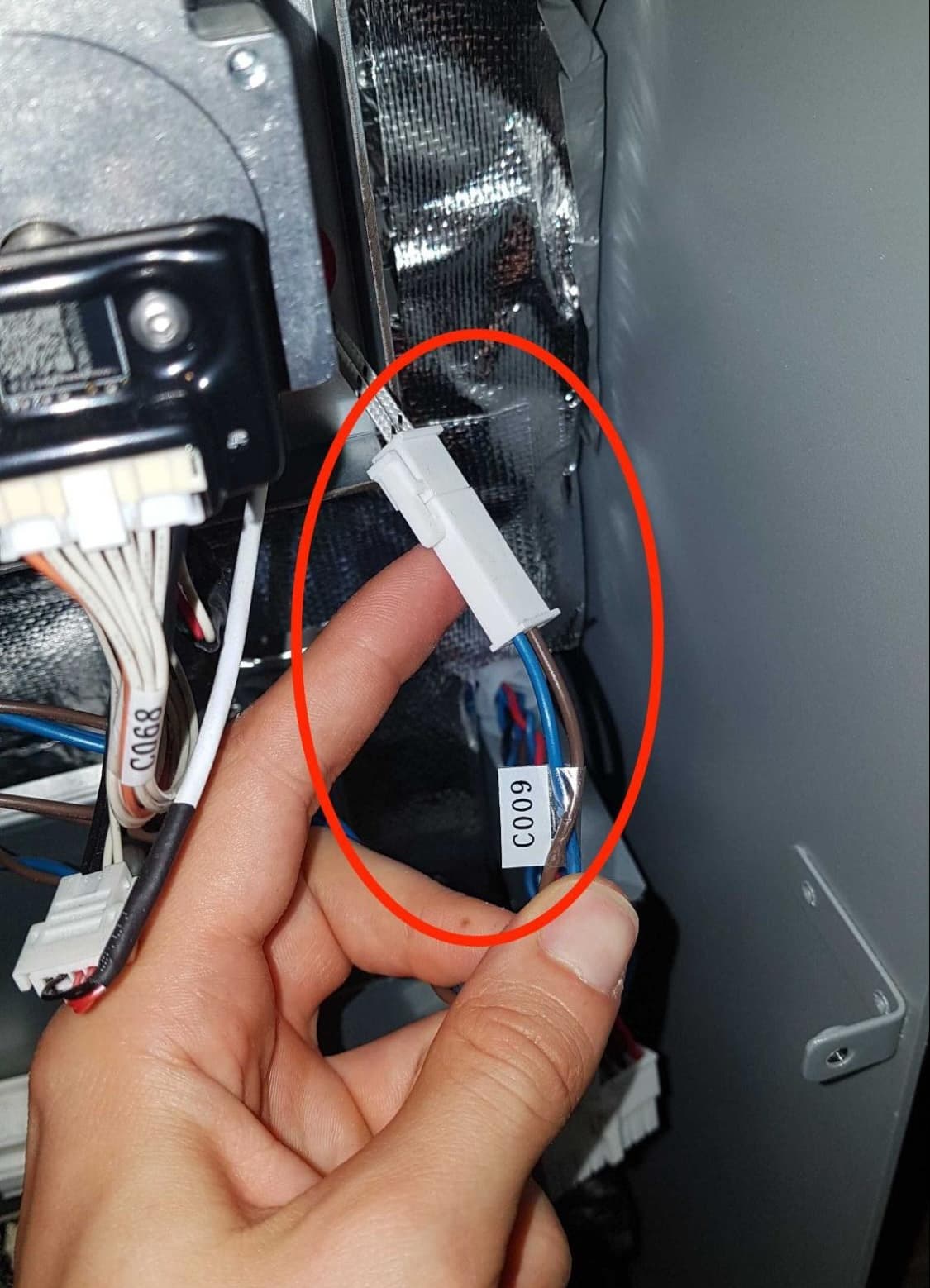

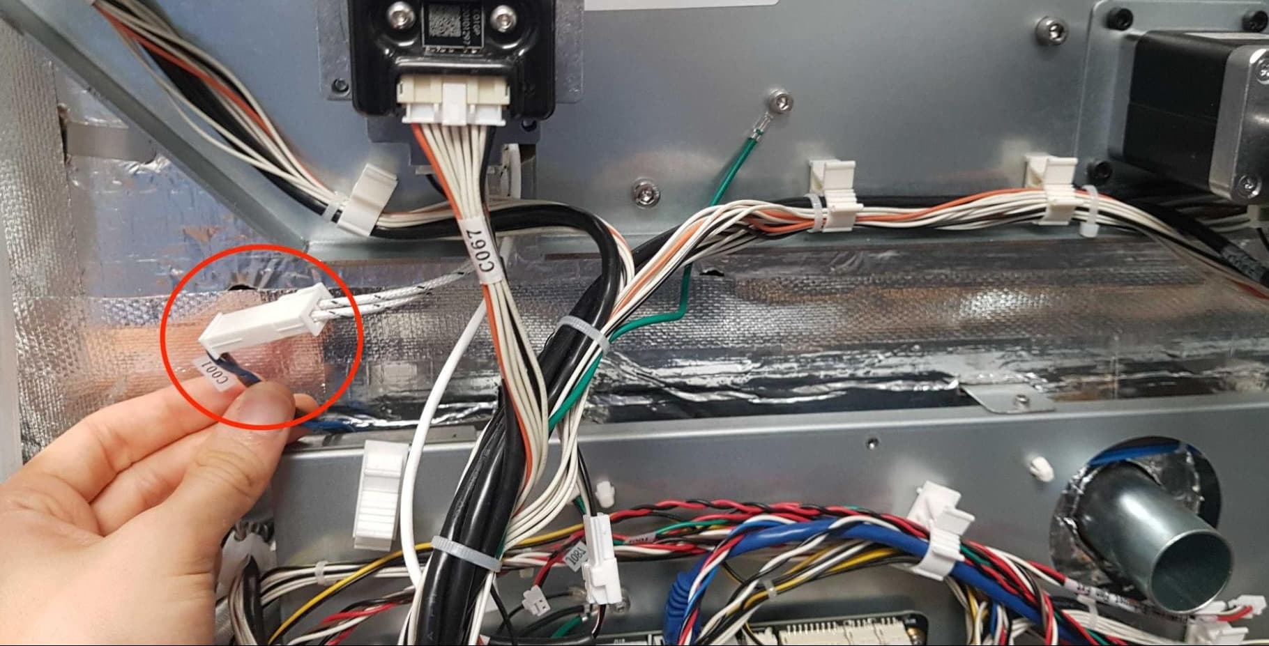

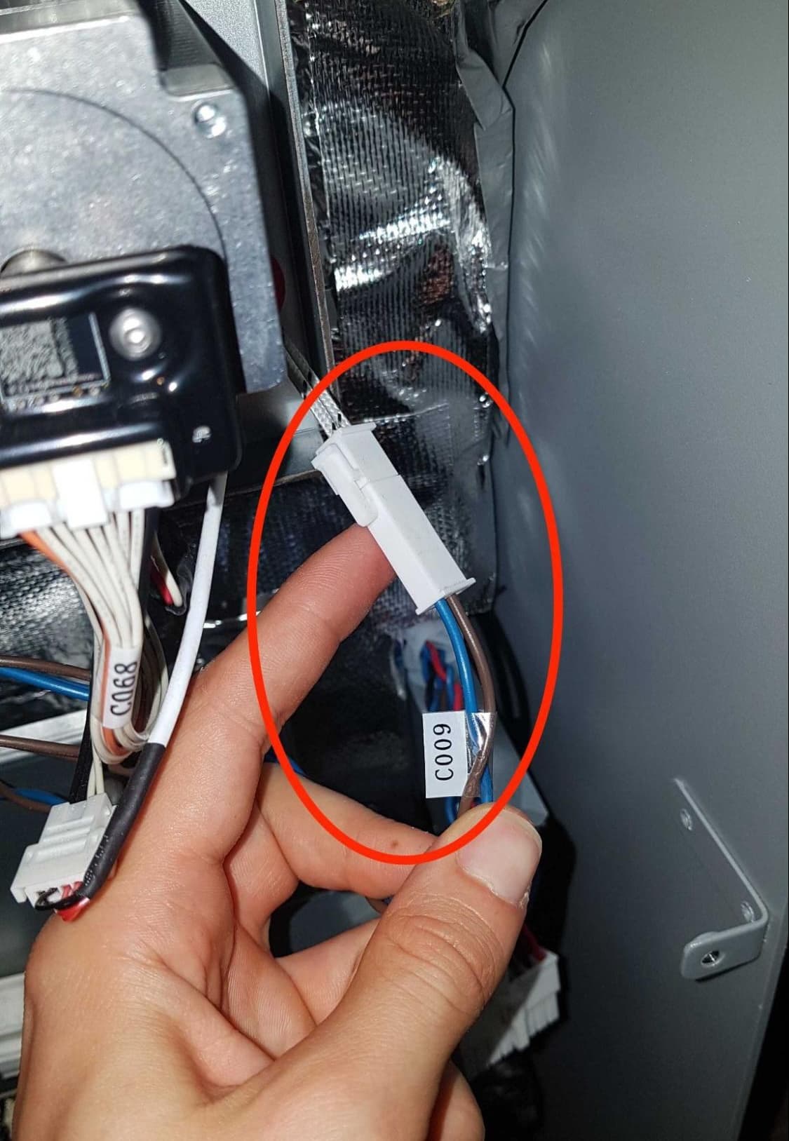

Step 6: Begin disconnecting the build chamber socket cables
Disconnect the cable labeled C008.

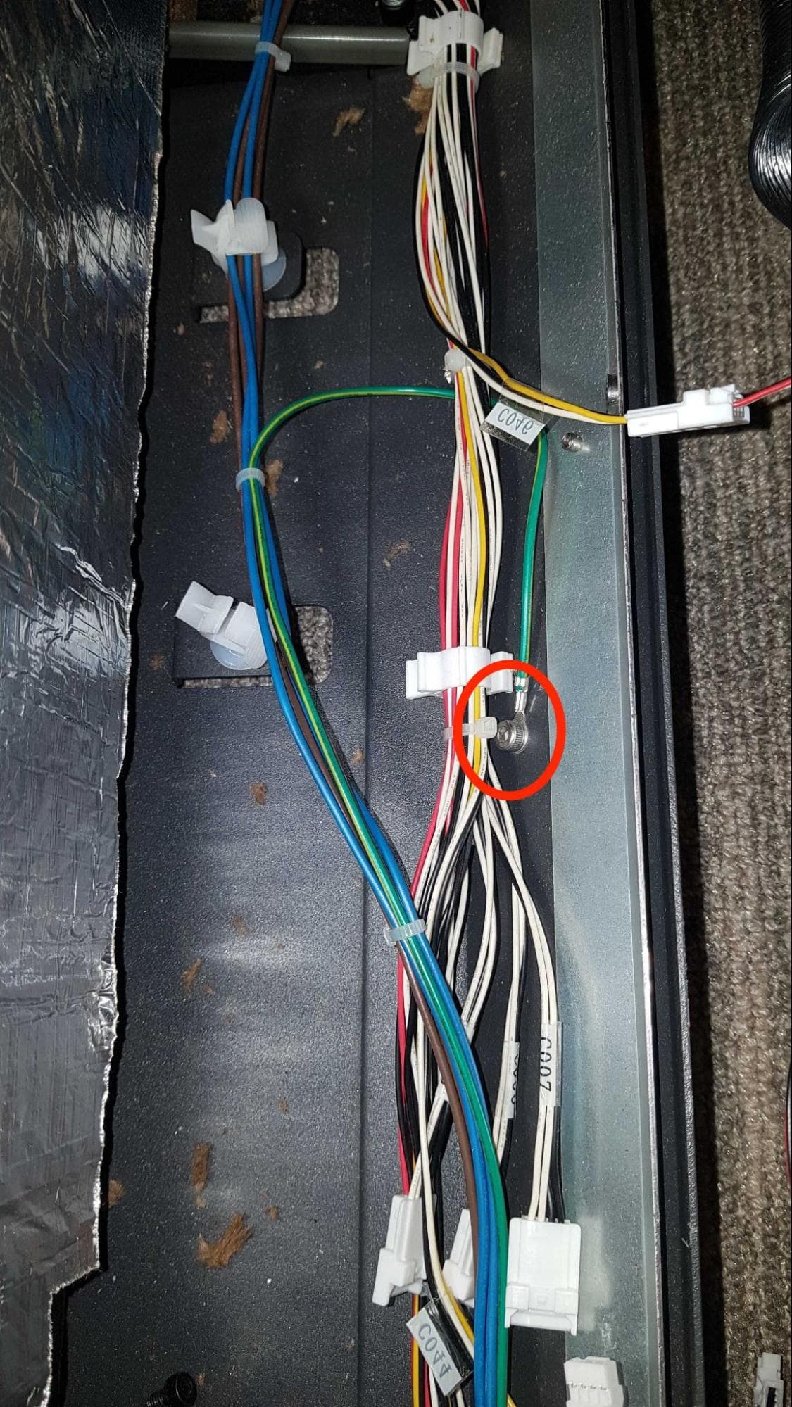

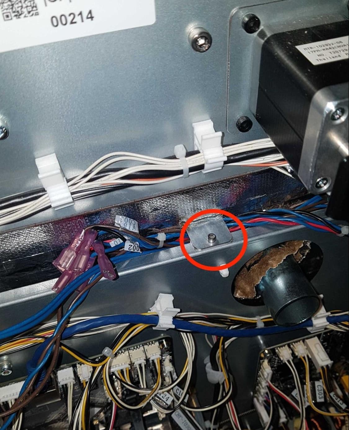

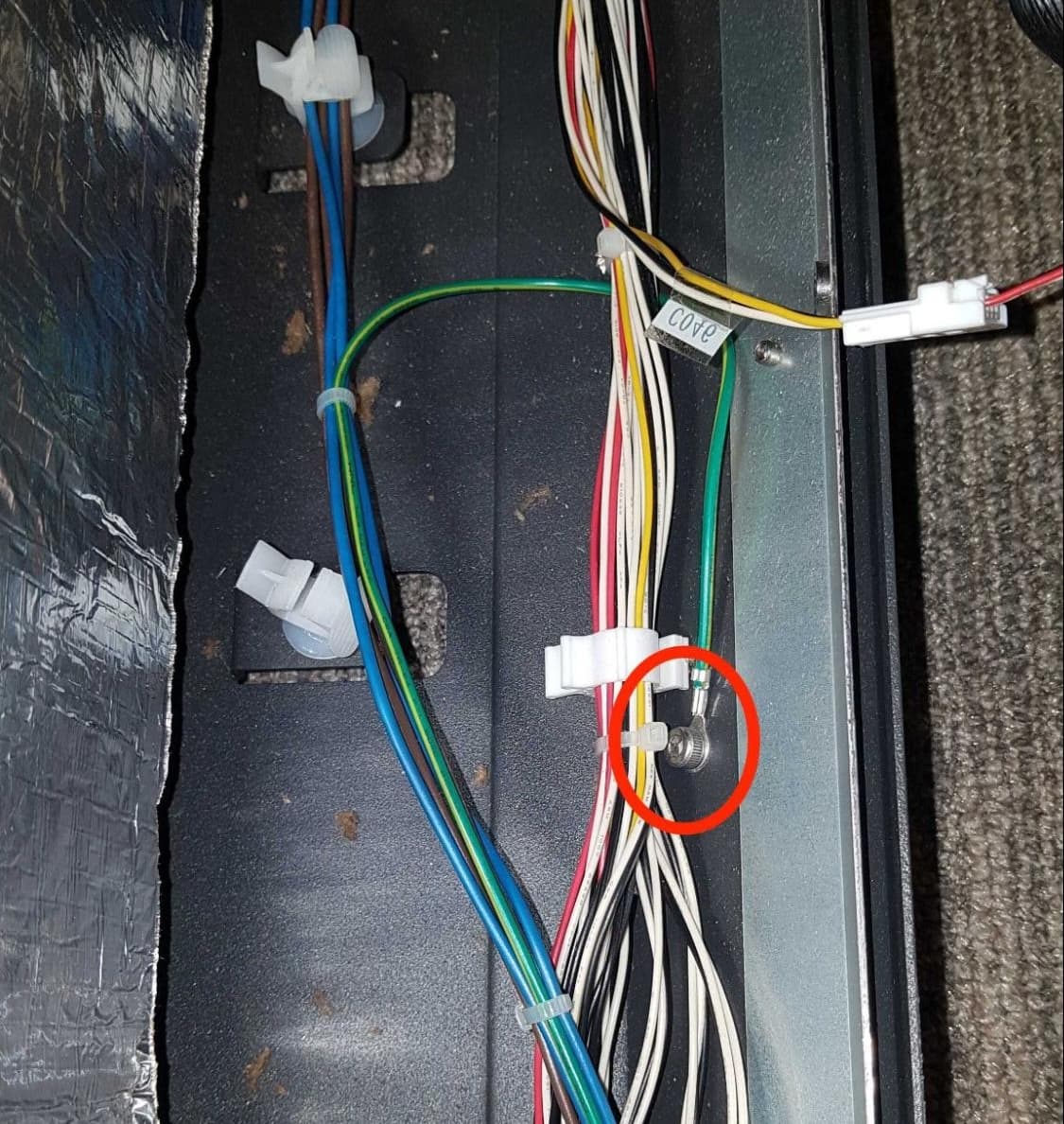

Step 7: Disconnect the grounding cable

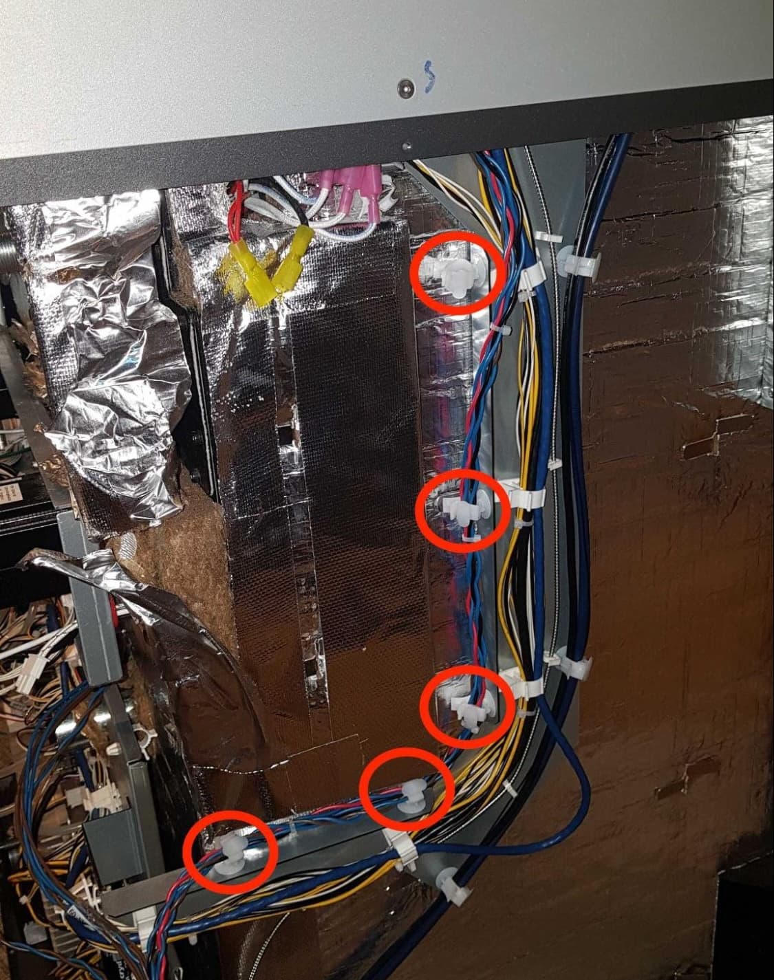

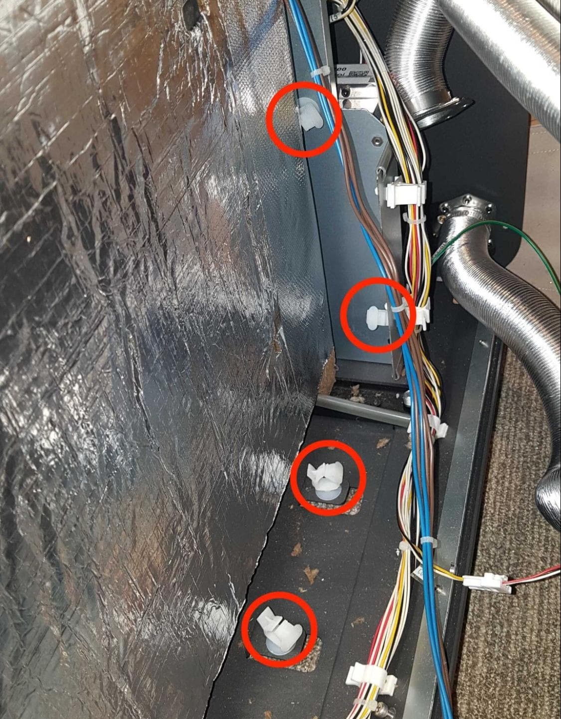

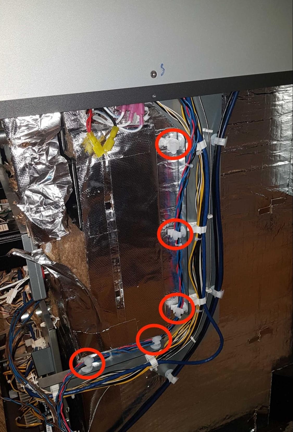

Free the blue and brown cable harness and the green ground cable from the four cable management clips along the hopper side of the printer. Unscrew the grounding wire screw using a 3 mm hex driver. Set the screw aside.

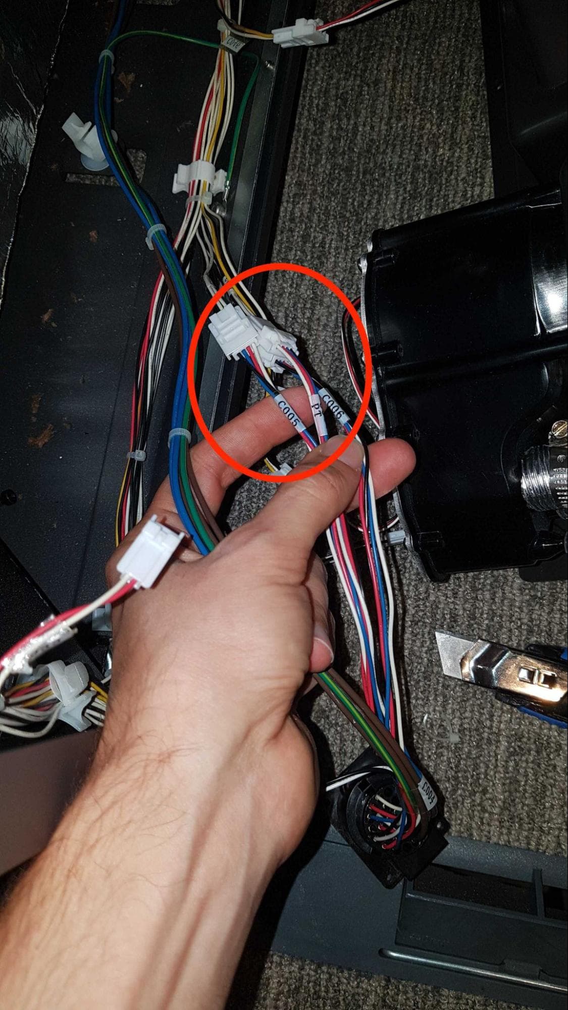

Locate a second set of cables extending from the build chamber socket. Disconnect the cables labeled C005 CWL, C007 PT, and C006 CWU. Release the cables from their cable management clips, as you did with the first set of cables.

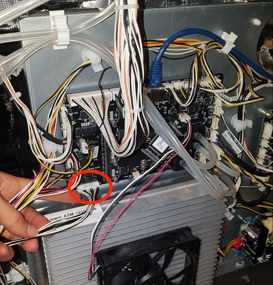

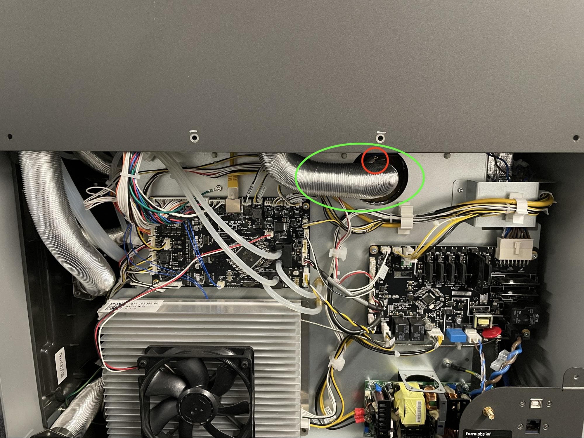

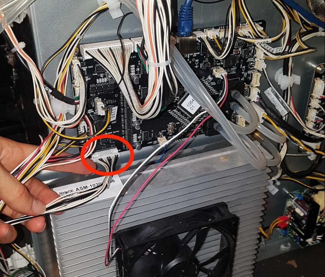

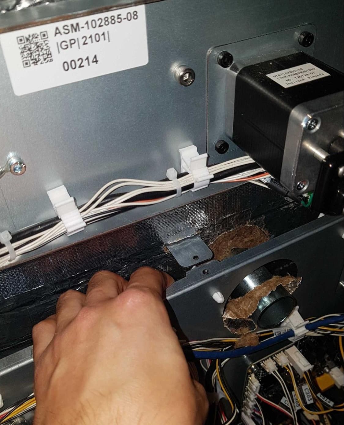

On the back of the printer, locate the motor and temperature controller board, positioned directly above the laser assembly heatsink. Disconnect the cable labeled C120. If necessary, cut any zip ties preventing you from disconnecting the cable, but take care not to damage any other cables.

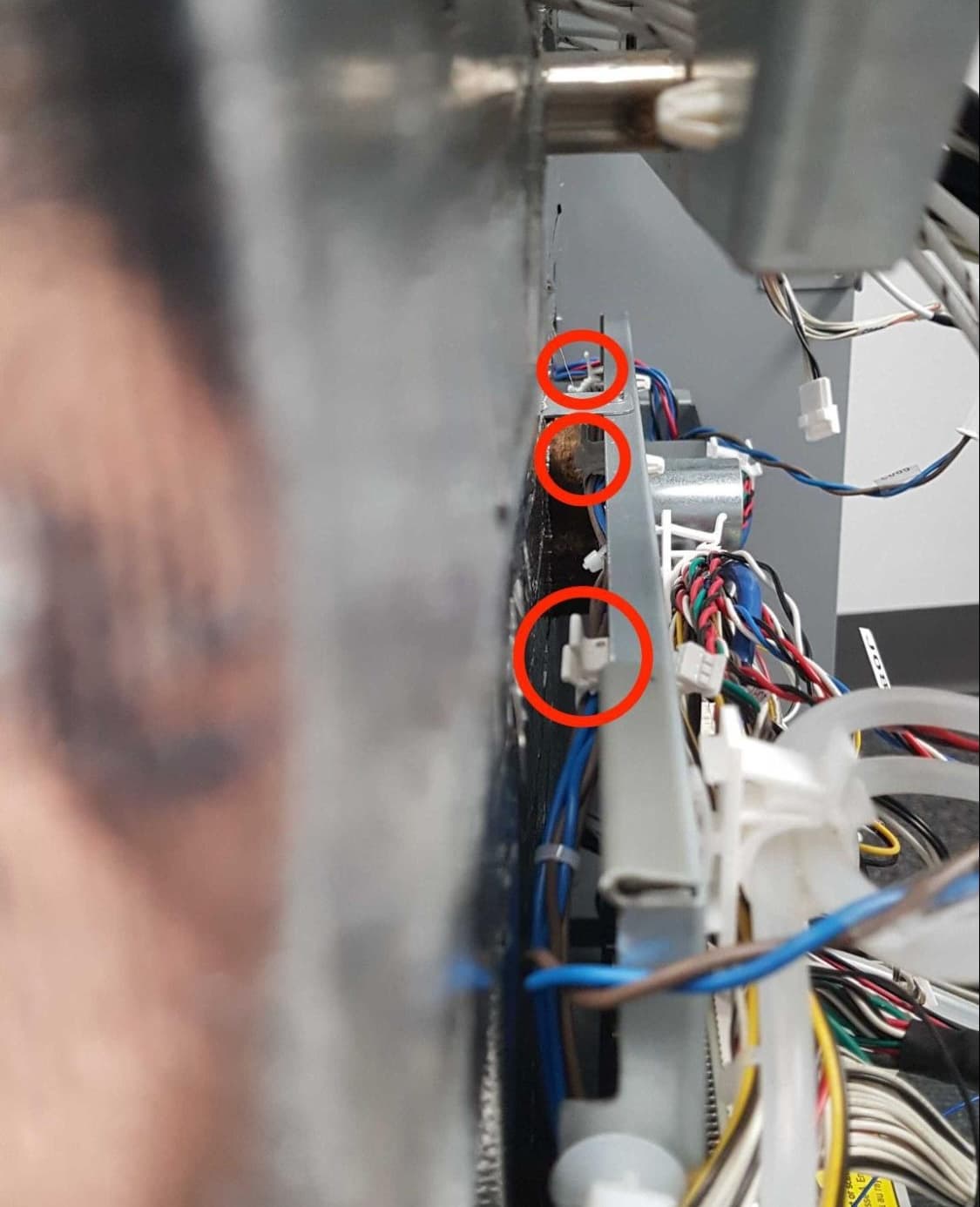

Step 10: Continue separating the build chamber socket harness from its cable management clips
The motor and temperature controller board, heater controller board, and several other printer components are mounted on a metal plate. The blue and brown cable harness mentioned in step 7 is routed through three cable management clips on the backside of this plate. Open the cable clips and separate the harness from them.

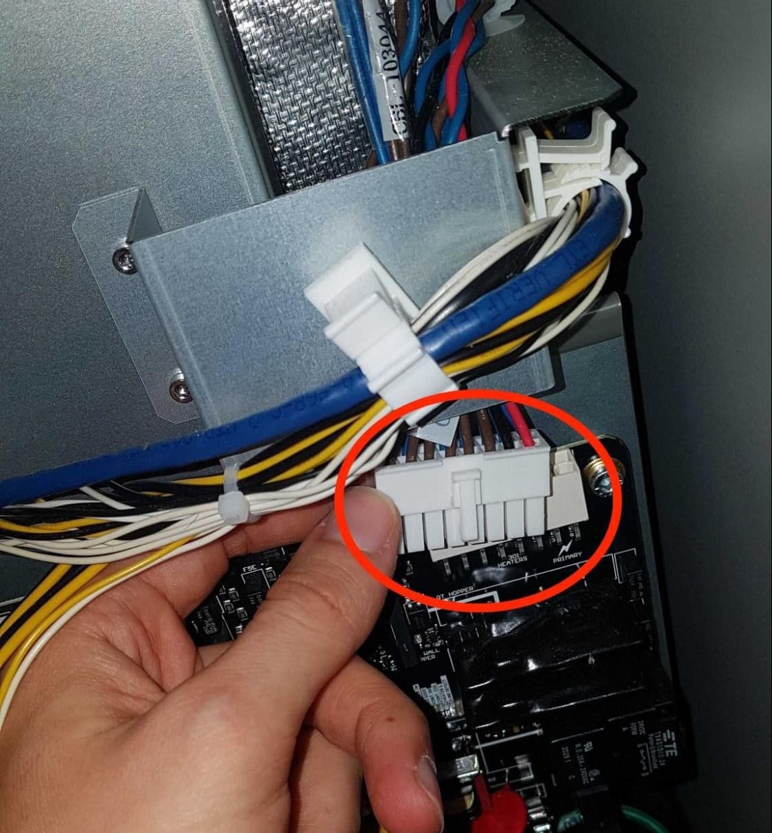

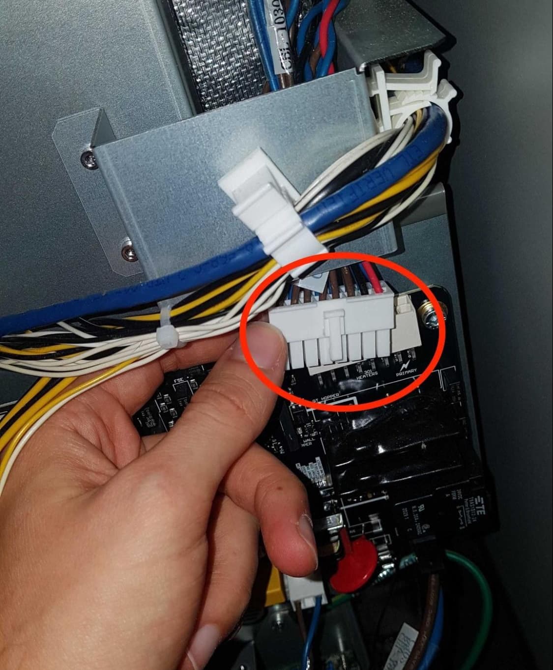

Locate the heater controller board, positioned to the right of the motor and temperature controller board. Disconnect the cable labeled C301 from the top-right corner of the heater controller board. Disconnect the cable labeled C001, directly above the heater controller board. Disconnect the cable labeled C009, directly above the motor and temperature controller board.

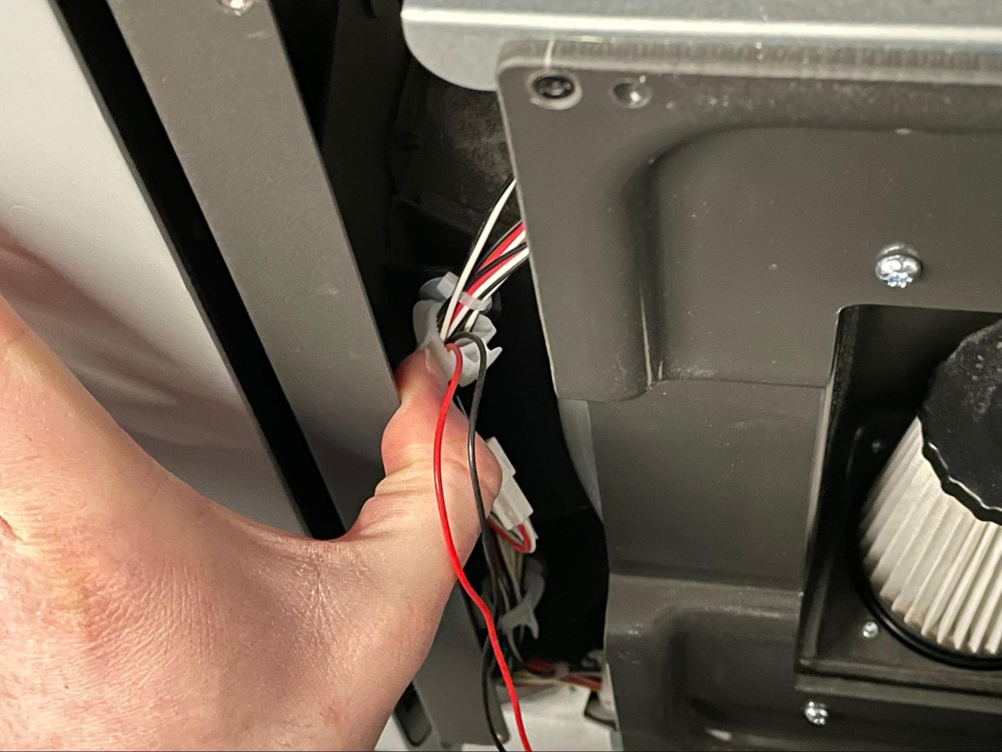

Step 12: Continue separating the build chamber socket harness from its cable management clips
Follow the wires running from the C301 connector from step 11 to the buffer side of the printer. Separate that cable harness from the five cable management clips it runs through.

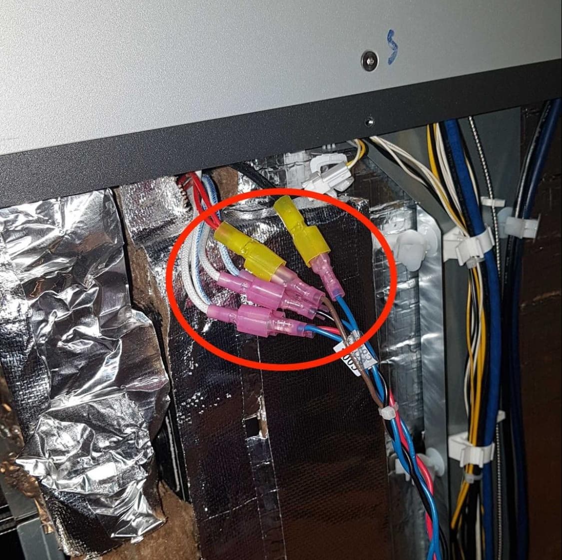

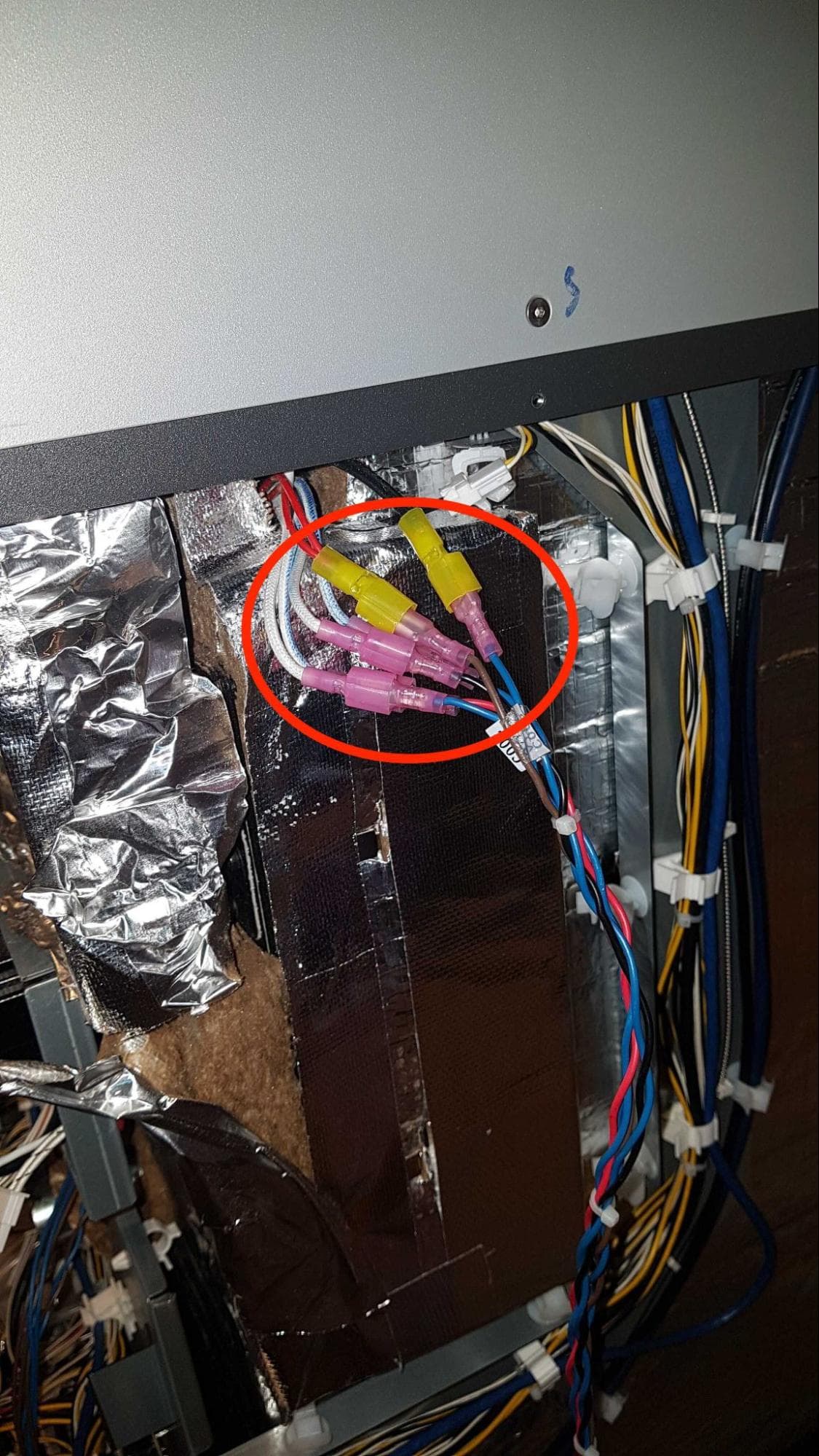

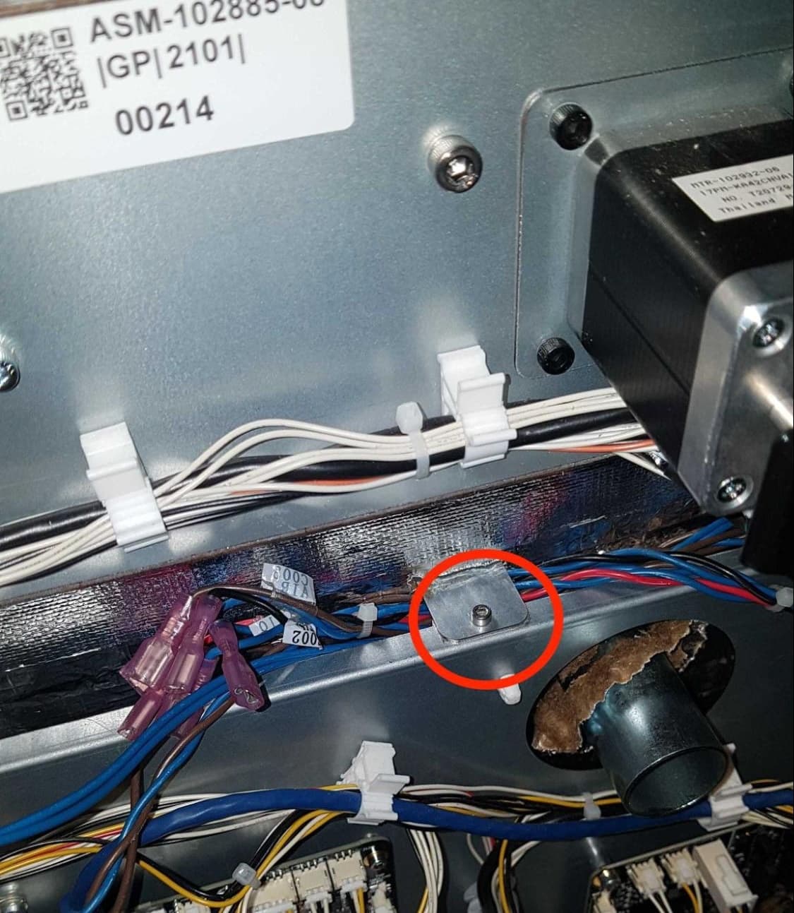

Step 13: Continue disconnecting the build chamber socket cables
At the end of the cable harness from the previous step, locate a set of spade connectors. Using a pair of needle nose pliers, disconnect all of the connectors labeled C003 air, C002QTH, and C010QTB. Label each of the corresponding cables on the printer side for easier reinstallation. Avoid pulling on the wires themselves; instead, pull on the crimped connectors.

On the buffer side of the printer, reconnect the spade connectors for the wires labeled C003 air, C002 QTH and C010QTB. Route these wires through the five cable management clips below the spade connectors.

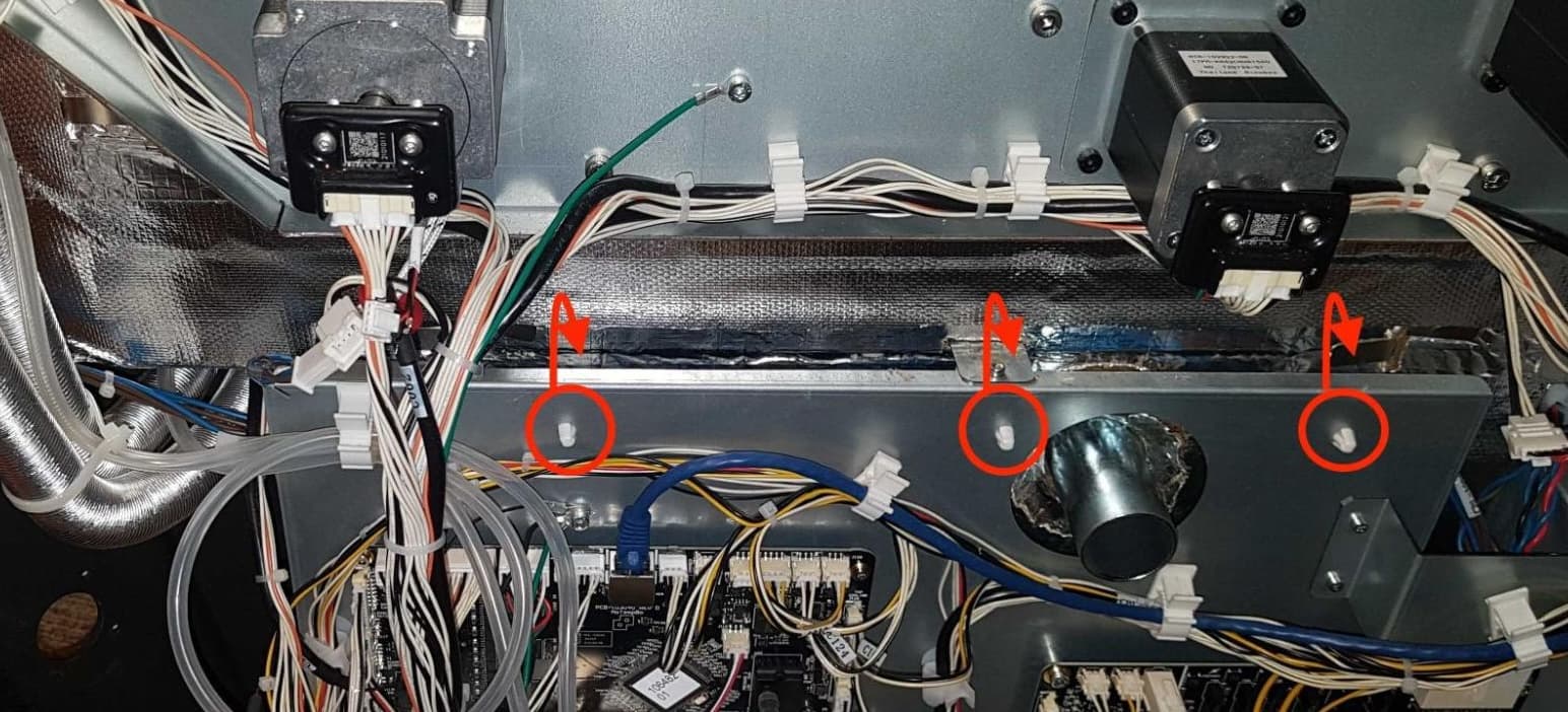

Step 3: Route the socket harness cables on the rear of the printer
Install the new build chamber socket & cable harness

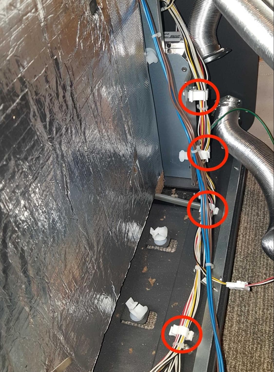

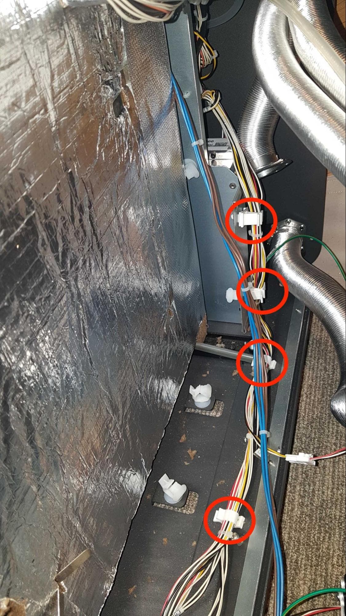

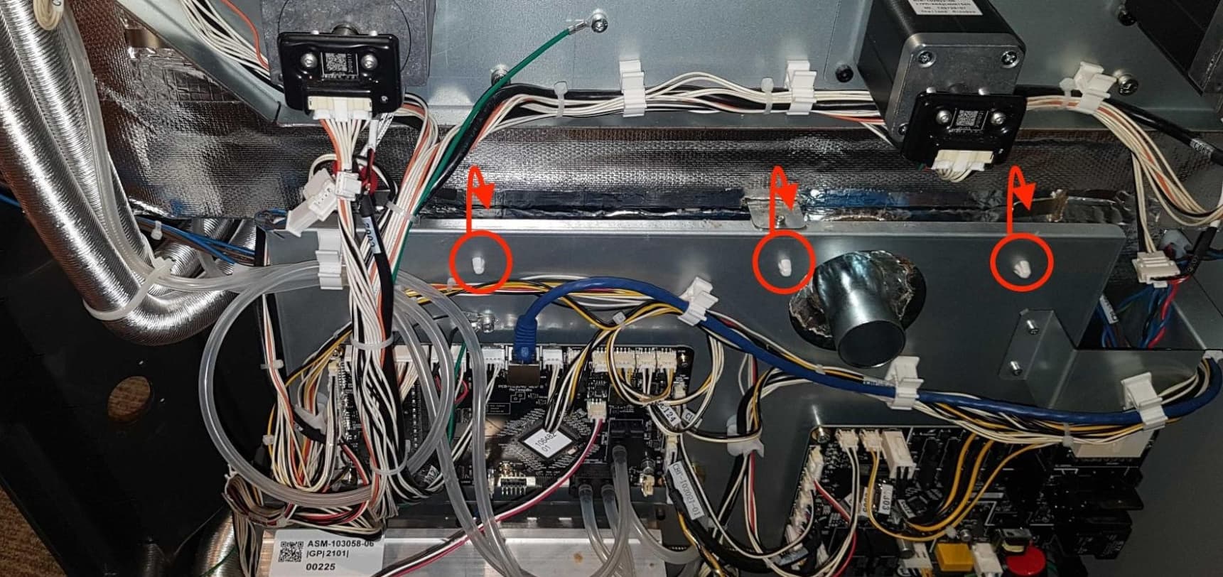

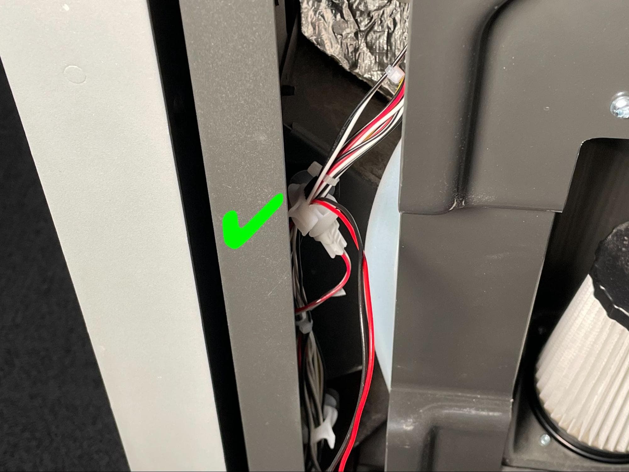

Route the blue and brown cable harness behind the metal plate at the rear of the printer. Secure it into the three cable management clips behind the metal plate. If necessary, unscrew the top mounting screw securing the metal plate using a 2.5 mm hex driver. Flex the top of the plate out of the way to let the cables pass by.
Step 4: Route the socket harness cables on the hopper side of the printer
On the hopper side of the printer, secure the blue and brown cable harness into the four cable management clips closer to the insulation panel. Secure the black and white harness (with cables labeled C005 CWL, C007 PT, and C006 CWU) into the four cable management clips further from the insulation panel.
Step 5: Reconnect the grounding cable
Secure the green grounding cable to its mount with its screw, then tighten with a 3 mm hex driver.

Step 1: Reconnect the interlock switch cable
Replace the top & hopper-side panels
Align the bottom of the hopper-side panel to the bottom of the printer and allow it to lean against you. Reconnect the interlock switch cable, labeled C033, to its receptacle. Route the cables into the cable clamp with the connector positioned below the clamp. If necessary, tuck the interlock cable slack into the side of the printer’s frame.
Step 2: Begin securing the hopper-side panel
Thread one M4 countersunk screw into each of the 10 screw holes in the hopper-side panel. Using a 2.5 mm hex driver, tighten until snug. For greatest convenience and ease of installation, thread and tighten in the following order:
  1. Four 6.0 mm screws below the hopper, circled in red
  2. Three 16.0 mm screws below the filter door, circled in green
  3. Three 12.0 mm screws above the filter door, circled in blue
Step 3: Continue securing the hopper-side panel
Thread the two black 8.0 mm M4 button head screws into the screw holes circled in red in the image here. Thread the chrome 8.0 mm M4 button head screw into the screw hole circle in blue here. Using a 2.5 mm hex driver, tighten until snug.

Step 1: Align the upper rear panel with the printer
Lift the upper rear panel and align it with the four screw holes on the top of the printer.
Step 2: Secure the upper rear panel top screws
Thread the four 6.0 mm screws into each of the screw holes on the top of the printer. Using a 2.5 mm hex driver, tighten the screws until finger tight. You may need to adjust the exhaust duct to correctly position the upper rear panel.
Step 3: Secure the buffer side panel screws
Thread the two 6 mm screws into the screw holes on the buffer side and the two 6 mm screws into the screw holes on the hopper side. Using a 2.5 mm hex driver, tighten the screws until snug.

Step 5: Secure the upper rear panel grounding screws
The two black upper rear panel screws are circled in red. The two chrome upper rear panel grounding screws are circled in blue.
Thread the panel screws into the indicated screw holes on the upper rear panel. Refer to the image for the correct locations of the black and chrome screws. Using a 2.5 mm hex driver, screw in the two black panel screws and two chrome grounding screws securing the upper rear panel to the printer.
Notice:
The placement of the chrome screws is critical to the printer's electrical grounding. Incorrect placement may lead to printer damage.
Step 6: Slide the exhaust duct into position
Slide the end of the exhaust duct with the ring clamp back onto the exhaust pipe. Ensure the exhaust duct presses against the insulation panel.
Step 7: Tighten the exhaust duct ring clamp
Using a 6.5 mm flathead screwdriver, tighten the ring clamp until finger tight.
Step 8: Secure the exhaust inlet screws
Open the filter cabinet door on the printer. Thread the four 8.0 mm screws into the screw holes. Using a 2.0 mm hex driver, screw in the four exhaust duct screws until finger tight.
Step 9: Check the exhaust duct seal
To ensure there is no gap between the exhaust duct’s mounting plate and the filter cabinet housing, shine a flashlight or other light source around the exhaust inlet inside the filter cabinet. If any light is visible behind the filter cabinet, the duct is not properly sealed. If necessary, use a 2.0 mm hex driver to tighten the exhaust duct screws. Close the filter cabinet door when finished.
Step 10: Secure the lower rear panel grounding screws
Thread the panel screws into the indicated screw holes on the lower rear panel. Refer to the image for the correct locations of the black and chrome screws. Using a 2.5 mm hex driver, screw in the six black panel screws and four chrome panel grounding screws securing the lower rear panel to the printer.
Notice:
