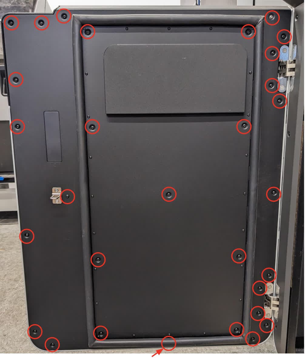

Step 1: Remove the inner door panel mounting screws
Using a 2.5 mm hex driver, loosen and remove the 30 M4 screws securing the inner door panel to the rest of the print enclosure door. You may need to move the door gasket to locate and remove the bottom-center screw.
Note:
The 10 screws inside the gasket are 10 mm long, while the 20 on the outside of the gasket are 6 mm long. The top-right screw is stainless steel, while the other 29 are black oxide-coated. Keep the sets of screws separate for easier reinstallation.

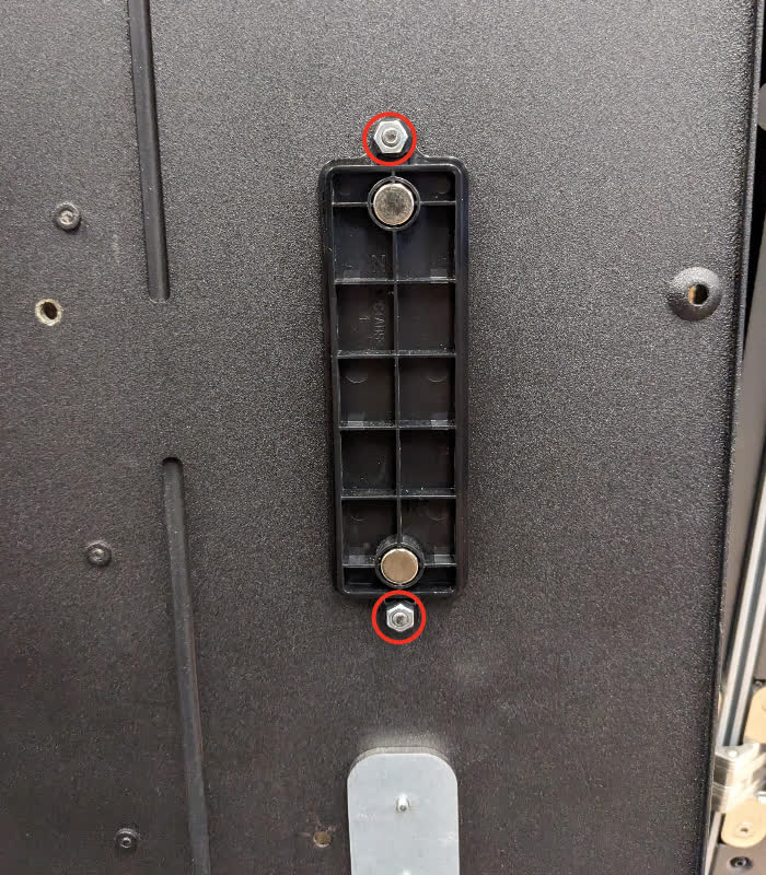

Step 3: Remove the interlock magnet assembly
Using a 7 mm socket driver, loosen and remove the two nuts securing the interlock magnet assembly to the inner door panel. Set the nuts aside. Set the interlock magnet assembly aside for disposal.

Step 1: Mount the new interlock magnet assembly
Orient the interlock magnet assembly vertically, with the two magnets facing you. Place it on the two threaded studs in the inner door panel.
Step 2: Secure the interlock magnet assembly
Thread one hex nut onto both of the threaded posts. Using a 7 mm socket wrench, tighten until snug.

Turn the inner door panel over so that the gasket faces you. Hold it against the inside of the print enclosure door, aligning the 30 screw holes in the inner door panel with the corresponding screw holes in the door itself.
Step 4: Secure the inner door panel
Thread one M4 screw into each of the 30 screw holes in the inner door panel. As noted previously, the 10 screws inside the gasket are 10 mm long, while the 20 on the outside of the gasket are 6 mm long. The top-right screw is stainless steel, while the other 29 are black oxide-coated. Using a 2.5 mm hex driver, tighten all 30 screws until snug.
