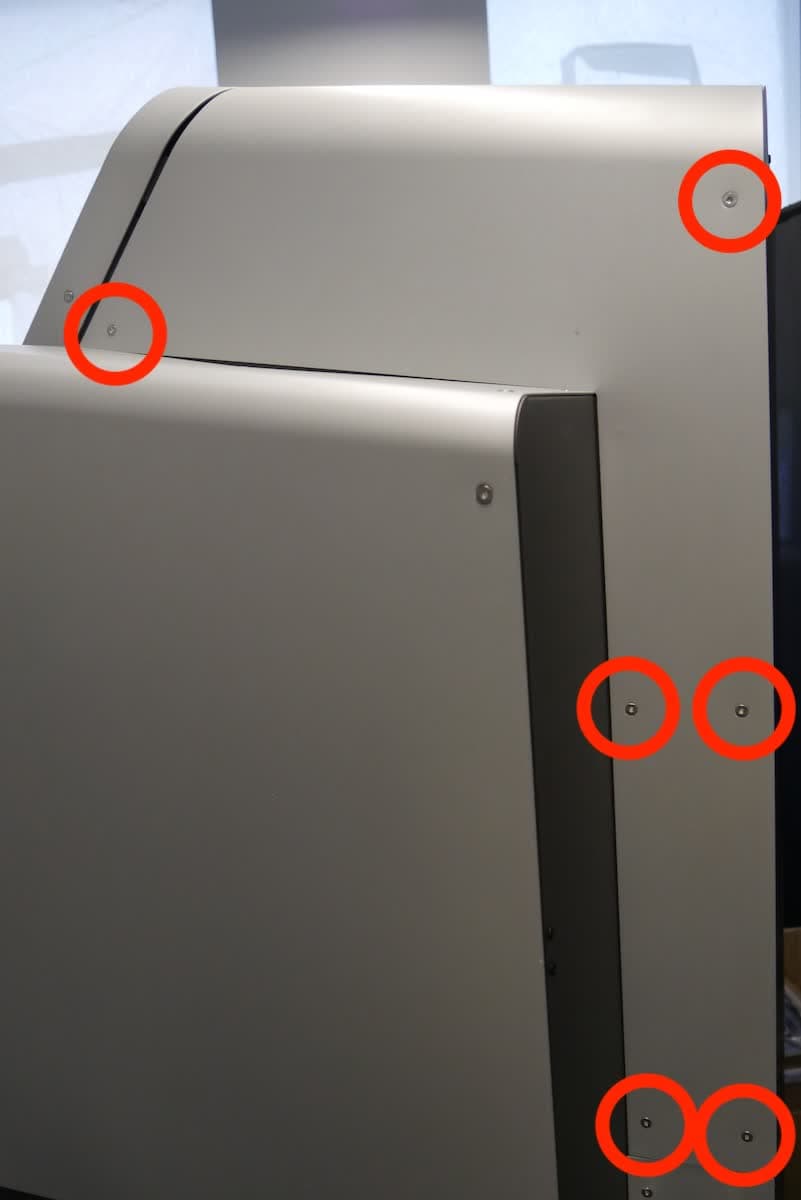

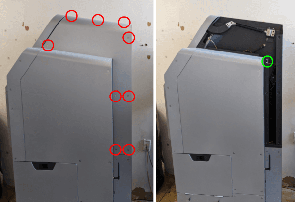

Step 1: Unscrew the right-rear panel mounting screws
Using a T20 Torx driver, loosen and remove the nine silver T20 Torx screws securing the right-rear panel to the Fuse Blast. Set the screws aside.
Step 2: Remove the right-rear panel
Slide the panel up to free its locating feature, then remove the panel and set it aside.

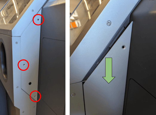

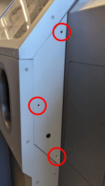

Step 3: Unscrew the right-front panel mounting screws
Using a T20 Torx driver, loosen and remove the three silver T20 Torx screws securing the right-front panel to the Fuse Blast. Set the screws aside.
Step 4: Separate the right-front panel from the Fuse Blast
Slide the panel down to release it, then tilt it to reveal its inner face.
Remove the Right Enclosure Panel

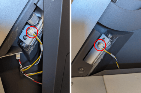

Step 1: Unplug the LED board
Locate the right-hand LED board. It is positioned partially behind the sidecar, with its ends visible behind the panels you removed in the previous steps. Unplug the cables from both ends of the LED board.

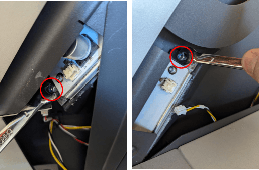

Step 2: Remove the LED board mounting nuts
Using a 7 mm box wrench or needle nose pliers, carefully remove the two hex nuts securing the LED board to the Fuse Blast. Set the nuts aside.

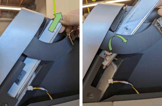

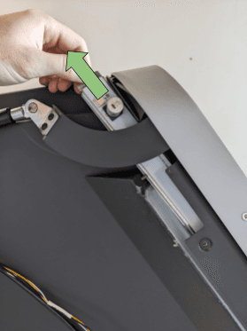

Step 3: Remove the LED board
With the nuts removed, slide the LED board assembly upwards. Rotate the assembly to remove it through the top of the machine. You may have to flex the door bracket to provide enough clearance for the assembly to slide through.
Remove the Right LED Board

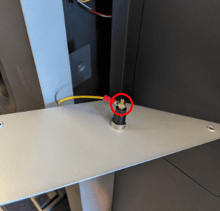

Step 1: Reattach the grounding wire
Attach the grounding wire to the post on the back of the right-front panel. Thread a 7 mm nut onto the post, then use a 7 mm box wrench or needle nose pliers to tighten until finger-tight.
Reconnect the Fuse Blast ground wire
Step 2: Reinstall the right-front panel
Hold the right-front panel against the side of the Fuse Blast, and push it upwards into place. Make sure that the three screw holes in the panel align with the corresponding screw holes in the machine. Thread one T20 Torx screw into each of the screw holes, then use a T20 Torx driver to tighten until snug.
Mount and secure the right-front panel

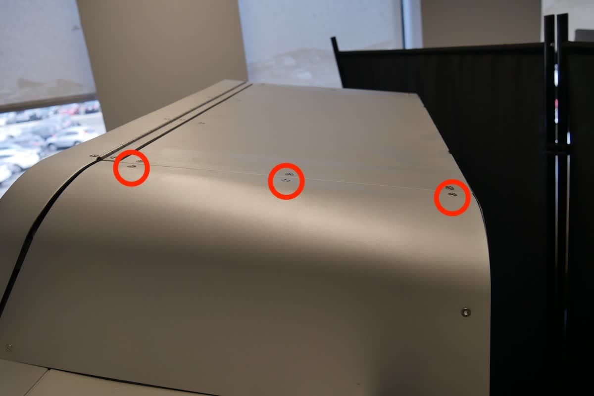

Step 3: Reinstall the right-rear panel
Fuse Blast right back shell screws
Fuse Blast right back shell locating slot
Mount the right-rear panel onto the machine, ensuring the locating feature on the shell aligns with the keyhole slot. Align the nine screw holes in the panel with the corresponding screw holes in the frame. Thread one T20 torx screw into each of the screw holes, then use a T20 Torx driver to tighten until snug.

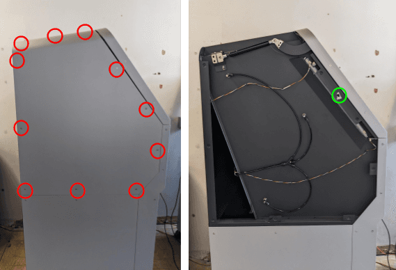

Step 1: Unscrew the front panel mounting screws
Using a T20 Torx driver, loosen and remove the 11 silver T20 screws securing the left panel to the Fuse Blast. Set the screws aside.
Step 2: Remove the left panel
Remove the Left Enclosure Shell

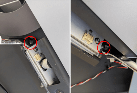

Remove the Left LED Board

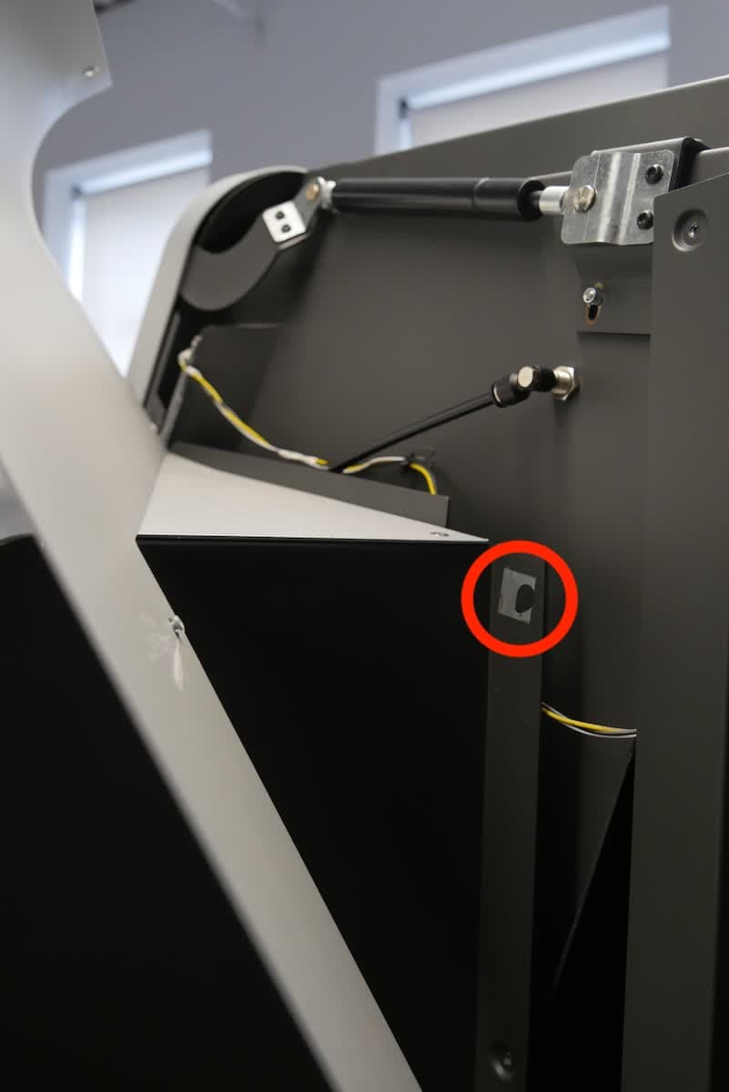

Step 1: Mount the left panel
Mount the left panel onto the machine, ensuring the locating feature on the shell aligns with the keyhole slot. Align the 11 screw holes in the panel with the corresponding screw holes in the frame.
Step 2: Secure the left panel
Thread one T20 Torx screw into each of the 11 screw holes, then use a T20 Torx driver to tighten until snug.
