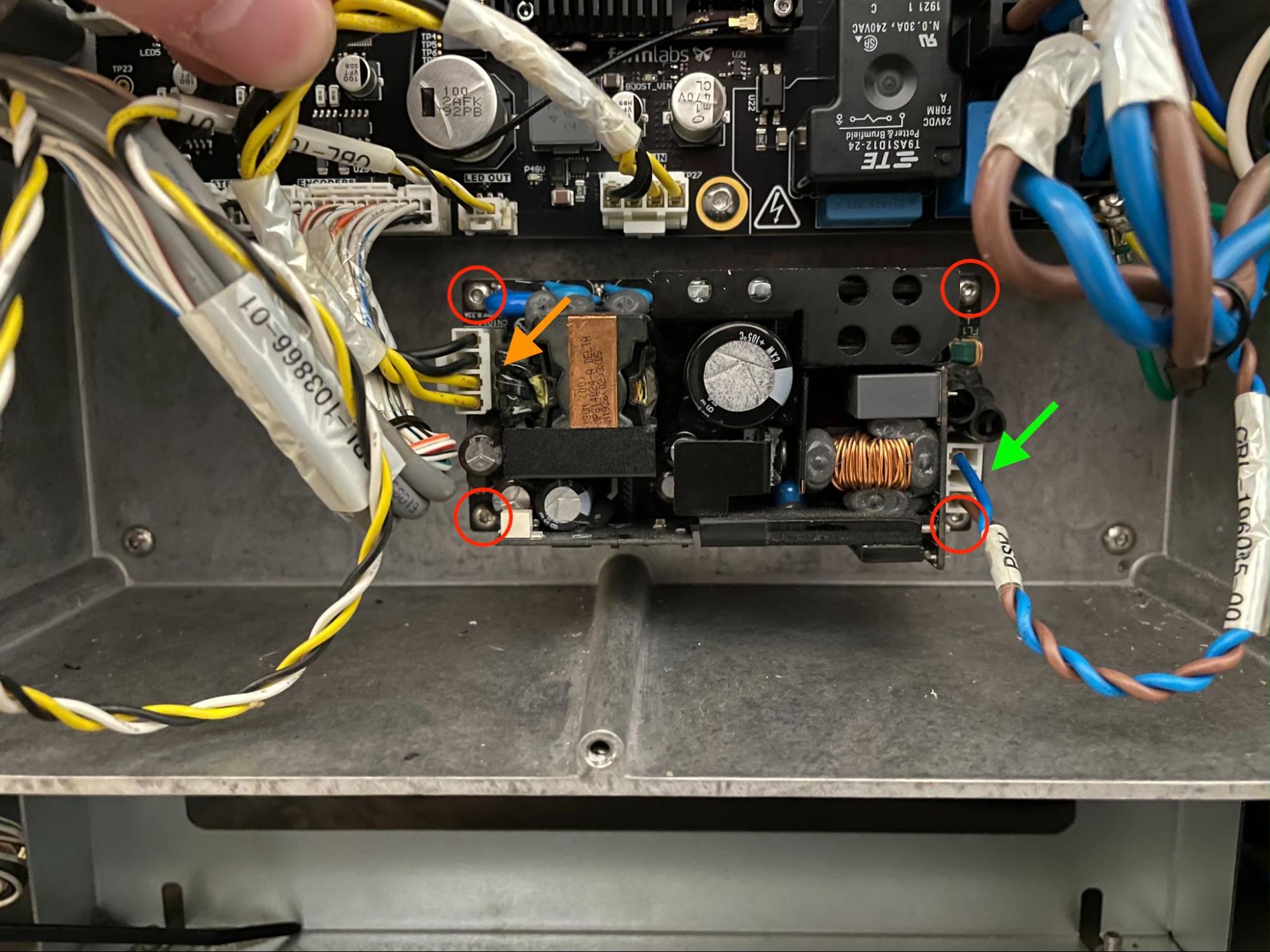

Remove the original power supply
Step 3: Disconnect the power supply cables
Disconnect the P24V and PSU Molex connectors from the power supply.
Step 4: Unscrew the power supply mounting screws
Using a 2.0 mm hex driver, loosen and remove the four 10.0 mm chrome M3 button head screws securing the power supply to the motherboard enclosure. Set the screws aside.
Step 5: Remove the power supply
Remove the original power supply and set it aside for disposal with electronic waste.

Step 1: Mount the new power supply
Orient the new power supply with the receptacle labeled PSU on the right. Place the power supply in the motherboard enclosure below the motherboard, aligning the four screw holes in the motherboard with the corresponding screw holes in the standoffs.
Step 2: Secure the power supply
Thread one 10.0 mm chrome M3 button head screw into each of the four screw holes in the power supply. Do not apply threadlocker to these screws or to any other screws inside the motherboard enclosure. Using a 2.0 mm hex driver, tighten until snug.
