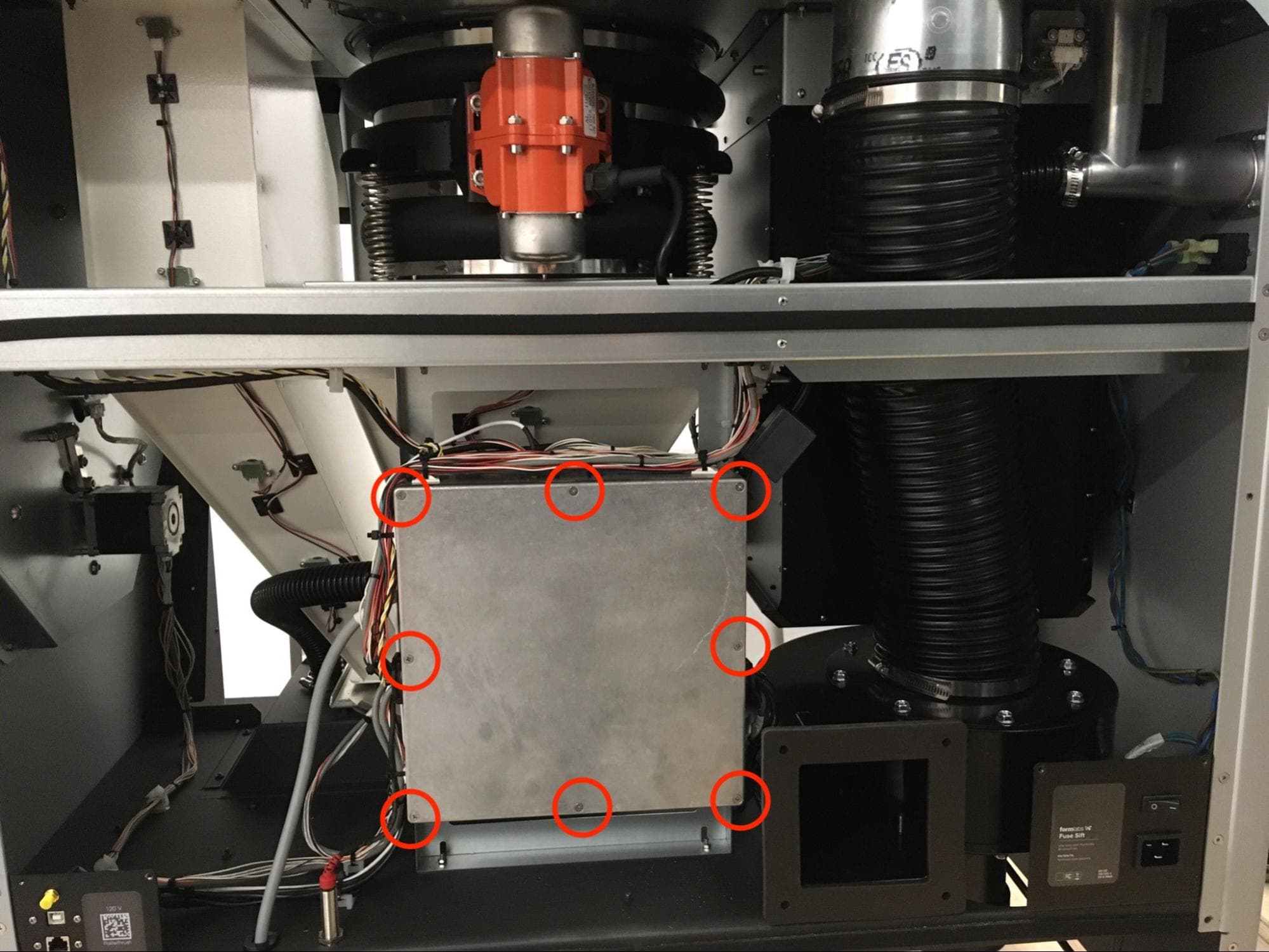

Using a #2 Phillips screwdriver, loosen and remove the eight 12.0 mm countersunk M3.5 screws securing the faceplate on the motherboard enclosure. Set the screws and faceplate aside.
Access the vacuum fuse

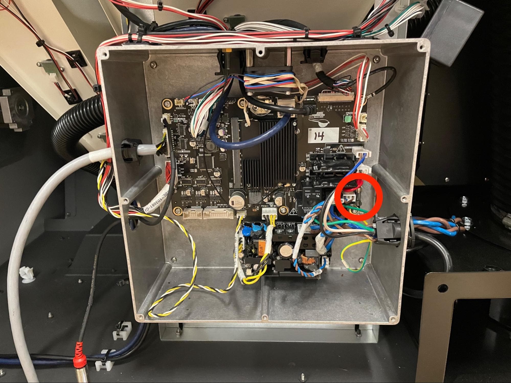

Locate the fuse receptacle on the bottom-right corner of the motherboard. Remove the original fuse from the receptacle and inspect for signs of damage. If the fuse is blackened, cracked, or completely blown, replace it with a new fuse.
