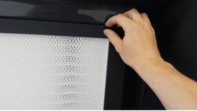

Unscrew and remove the six thumb screws that hold the filter grate in place.
Someone grips a grate thumb screw in preparation to turn

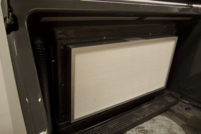

Step 3: Remove the filter
Pull out the filter that sits behind the grate.
The grate has been removed. Someone is reaching out to grip the side of the vent filter
Someone is pulling the vent filter away from the rear panel of the Fuse Sift

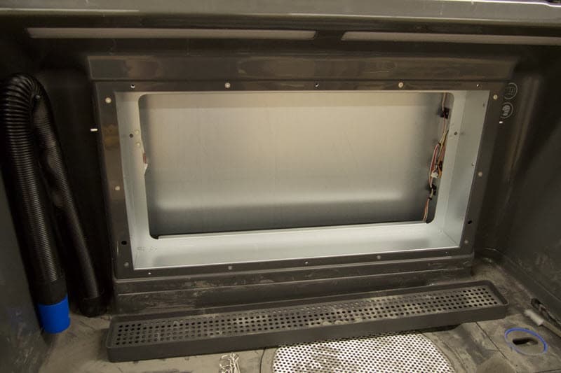

Step 4: Dispose of the filter
Dispose of the filter according to your local environmental regulations.
The back panel sits empty without a grate or filter

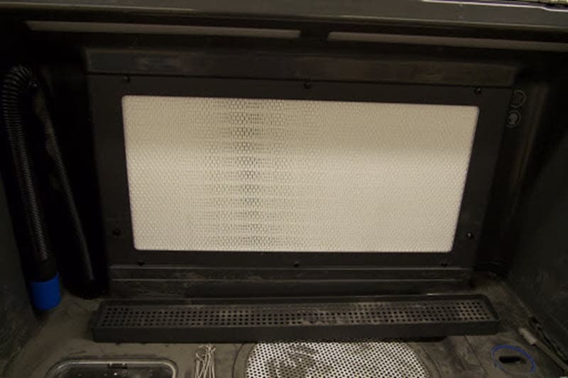

Step 5: Insert the new filter
Insert a new filter with the gasket pressed against the sheet metal receiver.
The back panel has a filter inserted without a grate
